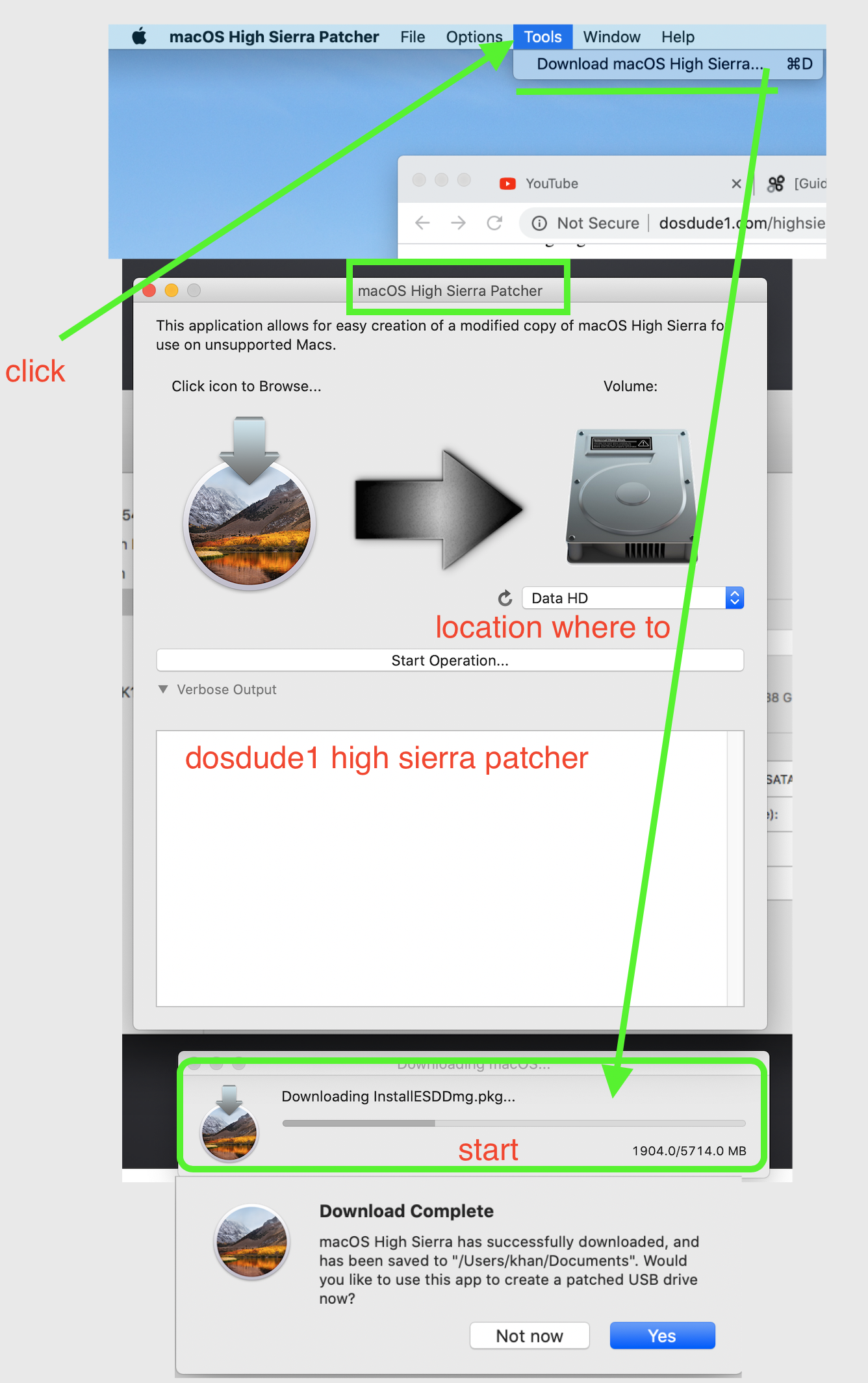

I'm doing some test and I'm having problems related with my saved high sierra dmg and updates with stupid security certificates. It's a known problem and it seems that the fix is re-downlad again de dmg.
Please, could anyone check if the update to download the high sierra installer stills available? From my high sierra temp installation, link does not show "download" button. (Only with high sierra. No problem with other versions) . I tried also from other macs with different so versions, and link does not open mac store. ¿?¿?¿?.
The webpage to download is here . The direct link is this one.
Edited by bilbo
Thank you Rockey!!! . I figured out the mystery. After a lot of time searching, I read is Apple forums that Applestore app , detect if you hace the app (whatever) in the HD, to show "open" or "download". And I realized that I had mounted the usb installer, with its macos installer app. The fix is simply, unmount the usb, and "download" button shows up. :blink:
Anyway, trying form other OS versions, Appstore doesn't open the link. Sometimes because is a old appstore (el capitan), or sometimes because is the new appstore (mojave). Even I tried to do from my old Sierra HD and the link didn't work either. That's mean, that we need High Sierra to download a High Sierra dmg. Seriously, Apple is, with every passing day, a more retarded company :thumbsdown_anim:.
I managed to install High Sierra with expired certifies, using a tip with the system date. The problem is updates wont install in a system with expired certifies. But , from this High Sierra installed, I copuld download the new updated dmg .
Those who appreciatte your stuff of SO, updates, etc, should download again all installers with renovated certifies.
Edited by bilbo

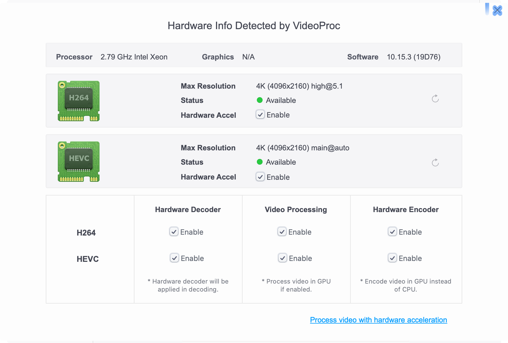

In the past few days I've noticed that my Radeon RX570 HW encoding/decoding capabilities weren't available on Catalina 10.15.3: both Hackintool and Videoproc reported issues (VDA not supported and unavailable H.264/HEVC).
After some research and LILU/WEG updates I've found that the issue was related to MacPro6,1 spec on my hackintosh so I decided to make some tests trying the MacPro7,1 SMBIOS and, with some USB issues, I managed to achieve full HW accelerated VDA according to Hackintool (VDA Decoder: Fully Supported) and Videproc (see screenshot):

The backdraw is that onboard USB 2.0 is fully unoperational and USB 3.0 is super-slow (20-30 MBps) but still good for keyboard and other slow peripherals.
I've a USB 3.1 card (ASM1142) that works perfectly and, maybe with the help of a good powered USB hub, I should be happy with this configuration.

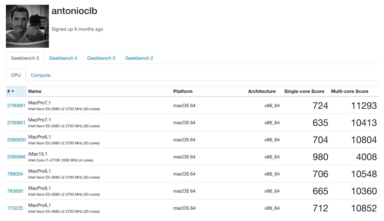

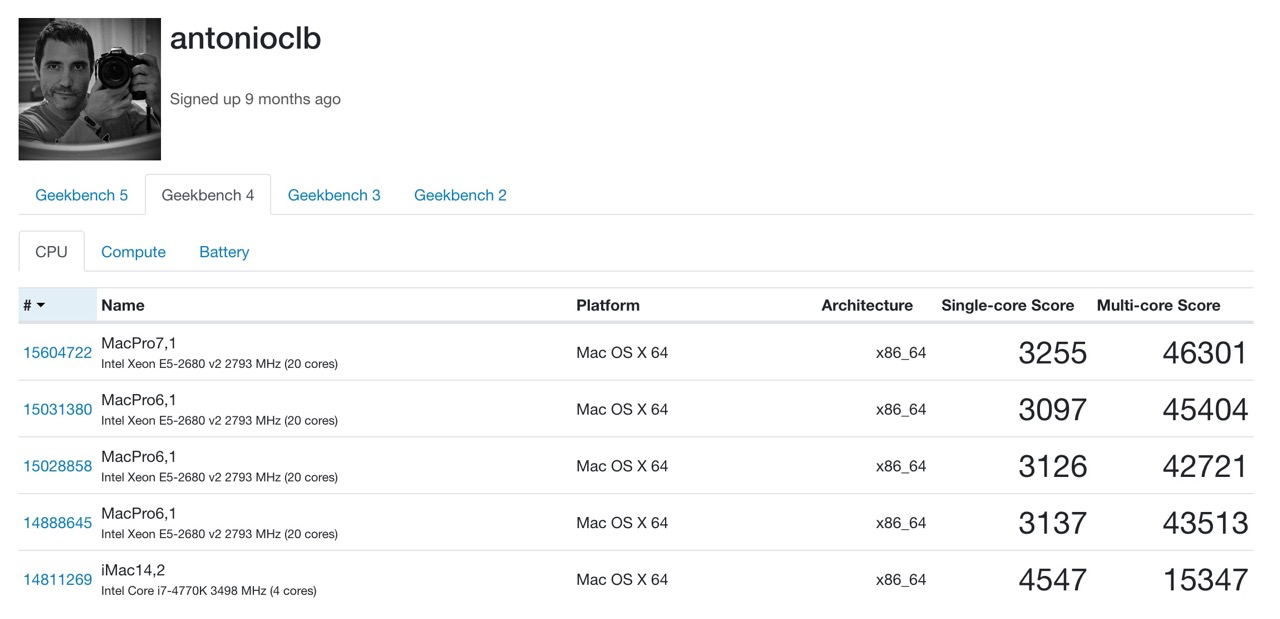

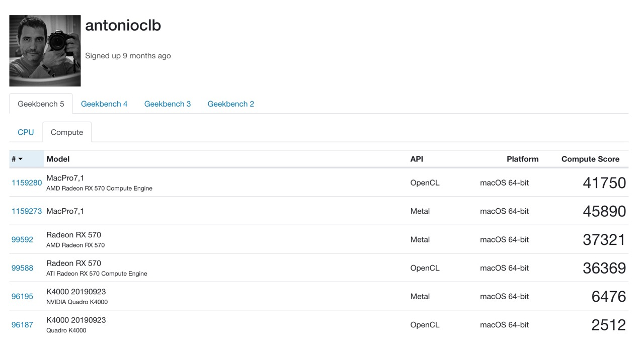

EDIT: a couple of benchmarks confirm better system performances (don't consider 2760851 on the second row: system was not idle).
Spoiler
Geekbench 5 (CPU and GPU tests):
Geekbench 4 (CPU only):
Cinebench R20:
Cool!
Have fun!

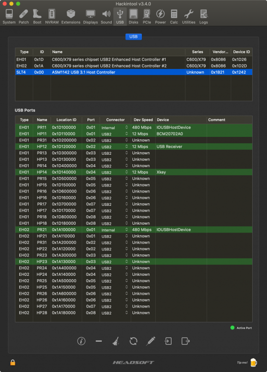

Hello folks!

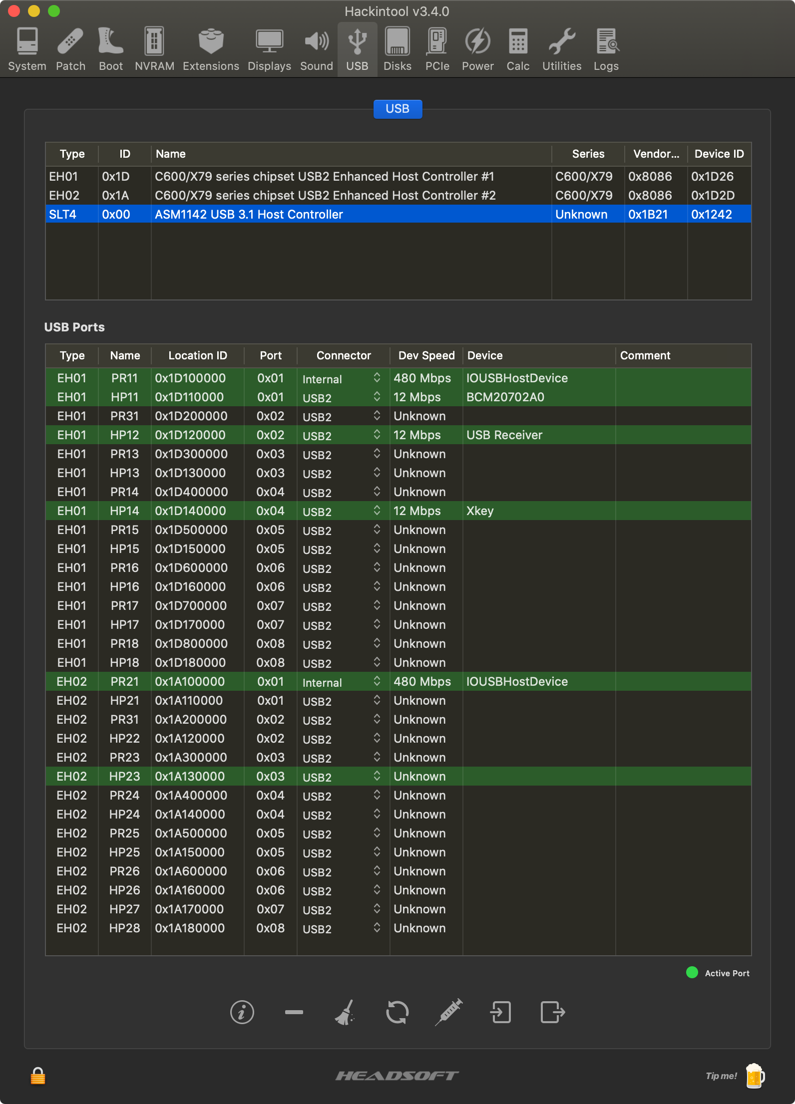

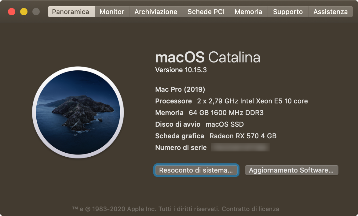

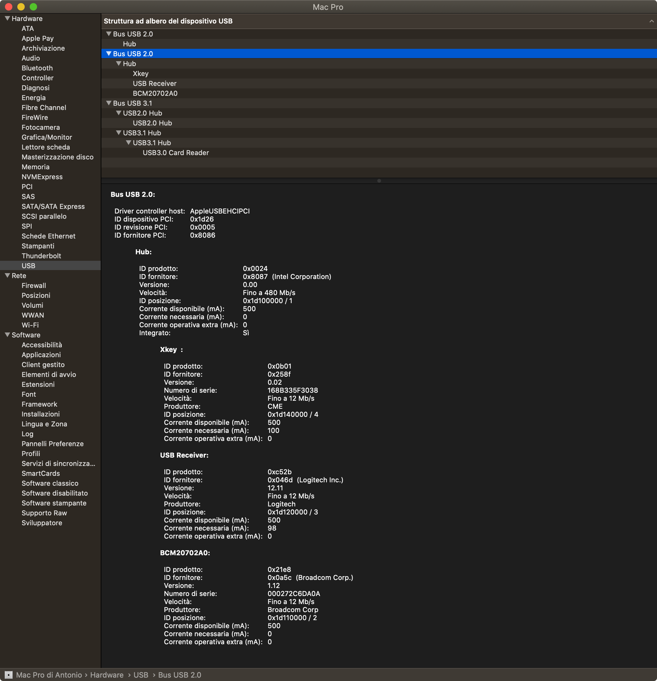

Regarding my previous post (SMBIOS MacPro7,1 on HP Z620) I have good news about USB!
I've found online this awesome USBInjectAll fork covering every SMBIOS present and give it a try.
Result: USB 2.0 is working perfectly as in MacPro6,1 SMBIOS (with the help of bilbo's SSDT-UIAC-ALL.aml)!
USB 3.0 (integrated) still working slow and without showing in System Profiler but this is not an issue: an ASMEDIA ASM1142, ASM1543 USB 3.1 gen2 PCIe card is doing its job giving me a blazing 10 Gbps bandwidth.
Here's a couple of screenshots:
Spoiler
Fully working Catalina 10.15.3 on MacPro7,1 SMBIOS here!!! ^__^
Have fun!
AC
Edited by antonio.clb

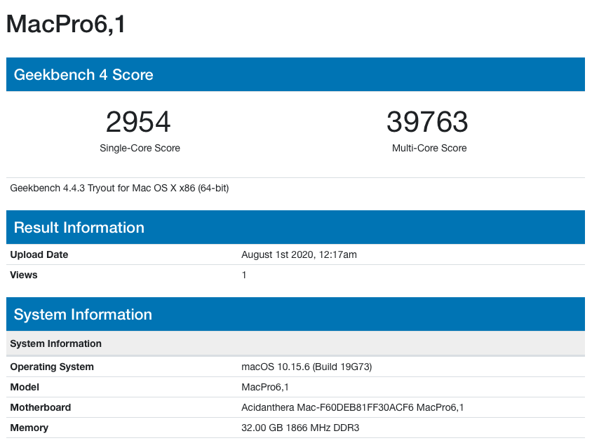

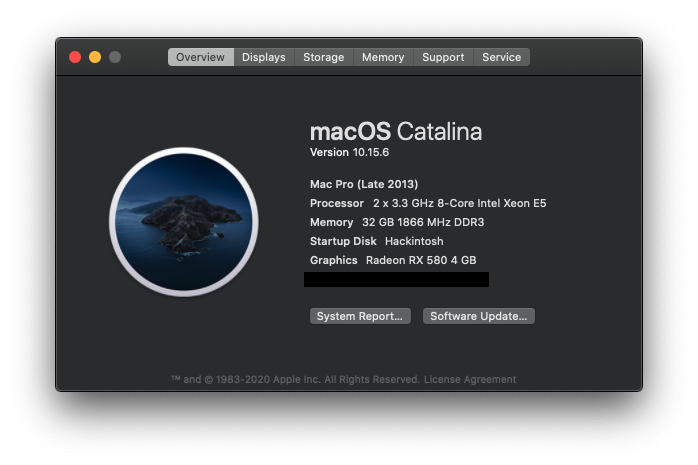

Ok, some updates after 1 whole day of testing...
1. Clover + gibMacOS is able to boot, but failed with installing on my SSD. I think this is because I used gibMacOS to download only the recovery image.
2. I ended up using OpenCore to boot, and surprisingly enough it works! All I needed to do is to follow the OpenCore Guide, do a DropOEM equivalent in OpenCore, add the SSDT, and it just works.
3. PM seems easy enough to set up, not sure if it actually works. Does this look like working PM?

Bilbo, thank you so much for the guide! Yes, I will proceed to patch the DSDT, but with the "correct" way OpenCore suggests. My OpenCore solution still took a lot of inspiration from the Clover solution.
Judging from my GeekBench 4 scores, it does seem like PM is working correctly. So Catalina is not a problem!
The best part is, I was able to use OpenCore to boot Mac OS with my installation media created in Linux. With previous clover experience, I would argue that OpenCore seems quite a bit more straightforward than Clover. I would recommend everyone to try it out.
