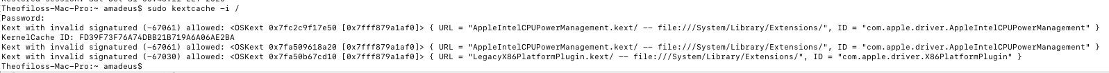

9 hours ago, amadeusex said:
Here's what i get from the kextcache command.
1800115919_ScreenShot2020-10-31at01_11_33.thumb.png.46c394a3c7c32ba8a332fe902e4a384a.png
I did run the repairpermission command with the -rt flag but to no avail.
So still no PM...

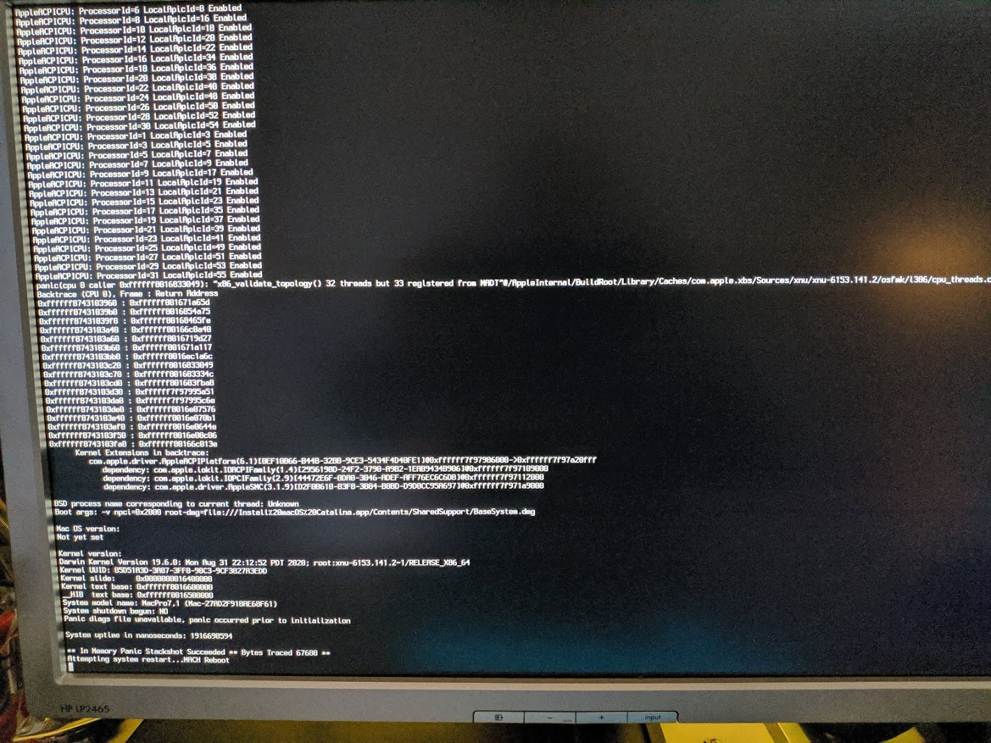

5 minutes ago, amadeusex said:
@antonio.clb What did you use to install Catalina ? OC or Clover (i'm referring to the installation media creation). I did give it a shot wit OC and had a Kernel Panic.
Right now i'm trying to create an USB installer with Clover.
As yo can see from my signature, I've switched to OC from Clover recently...
Mojave installation were made with Clover following the tutorial and then I upgraded to Catalina if remembering well...
What kind of KP do you receive? It would be useful to have a screenshot...

With disabled ACPI tables (SSDT DSDT etc) OC did boot only to the point to throw a kernel panic.

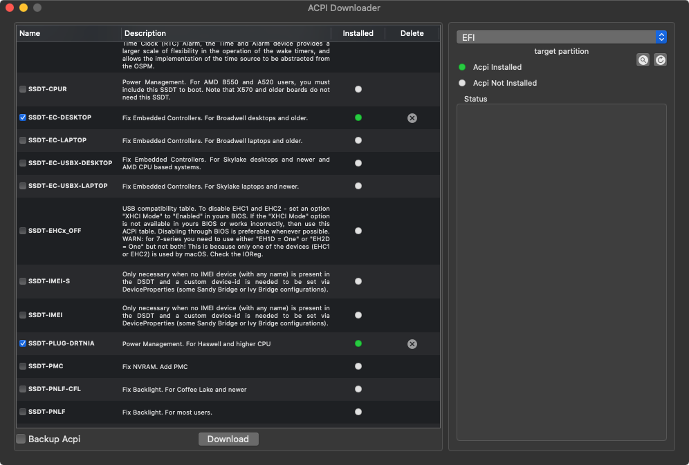

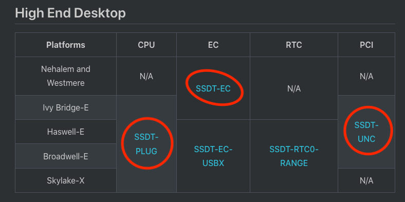

OK, looks like you need some basic SSDT.
According to Dortania's guide your Ivy Bridge-E CPUs need some basic files.
OCC (OpenCore Configurator) can download them for you. Heade to the ACPI section and click "Download/Update Acpi":
then download Dortania's recommended ones for your CPU architecture:
Spoiler
You have do manually download the third one here.
Give it a try and let us know!

Gave it a shot and no improvement.

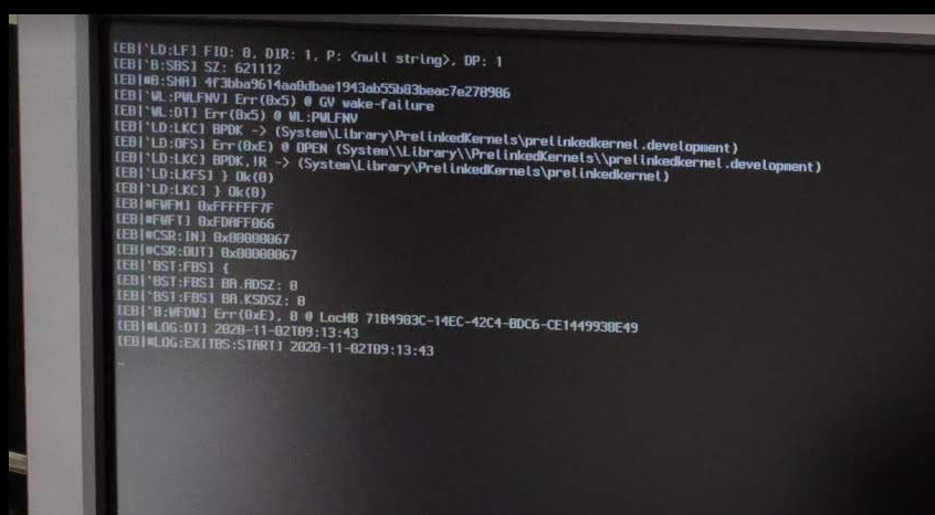

Any chance to see a screenshot of the KP with Clover too?
8 minutes ago, amadeusex said:
Sure :)
Freshly installed clover (last version) and only the USB stick plugged in. All drives are unplugged.
