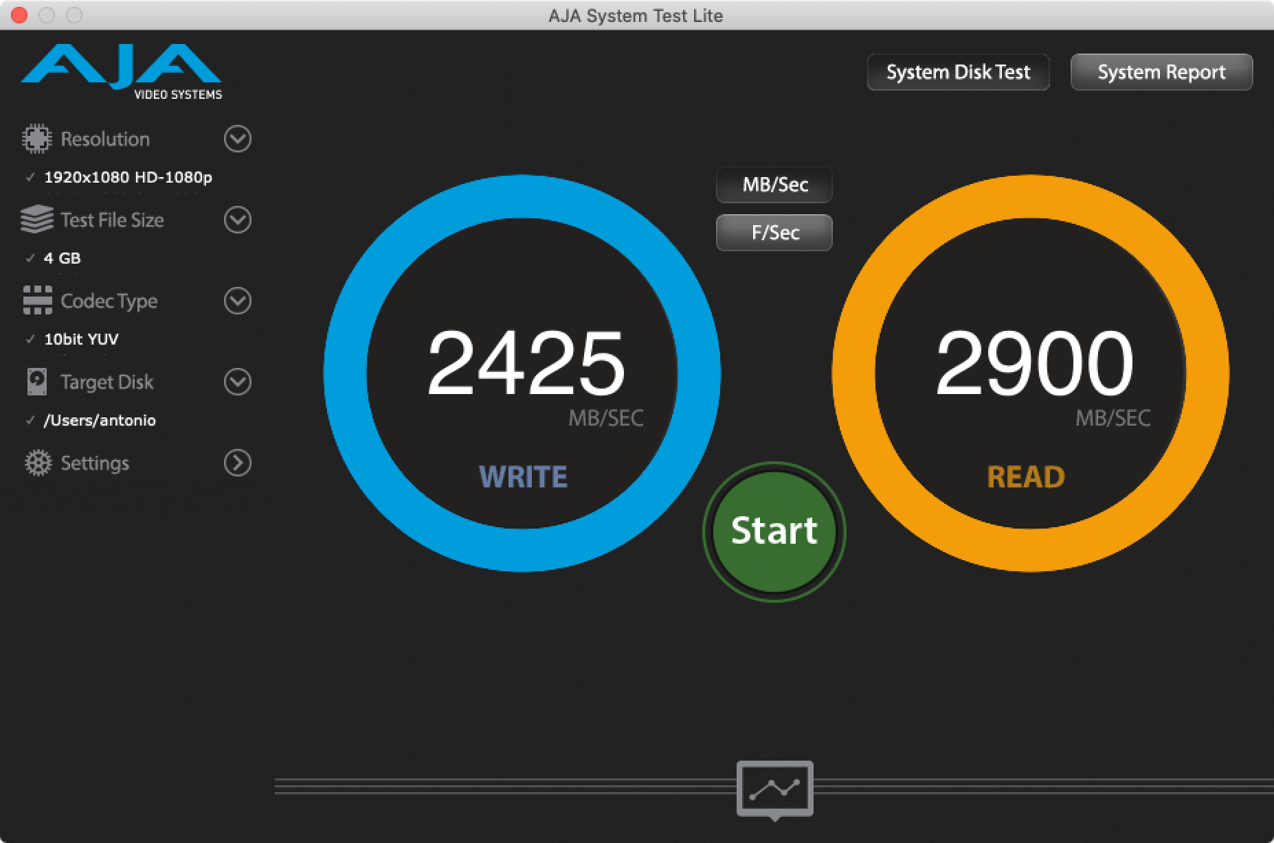

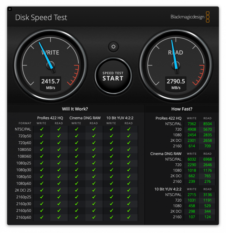

Hello!
XCPM is not working well (even after patching AICPM kext), I'm investigating. Thanks to @XLNC for pointing this out. Any clue?
To use NVMe SSD as system disk you have to install Clover on a boot-visible disk (in my case, both RAID-1 HDDs, taking care to manually mirror the EFI partition). Alternatively you can add a spare HDD in any SATA port or a USB drive on a USB 2.0 port and install Clover on it.
NVMe performace is good (not optimal), here's a couple of benchmarks:
Avoid Samsung EVO Plus series, looks like APple NVMe driver implementation is not supporting it well and system won't boot (tested on Mojave).
Hi,
Wow, those are really nice results, about 3-4x normal SATA3 SSD speeds.
Your Z620 works like lightning speed   :superman:
