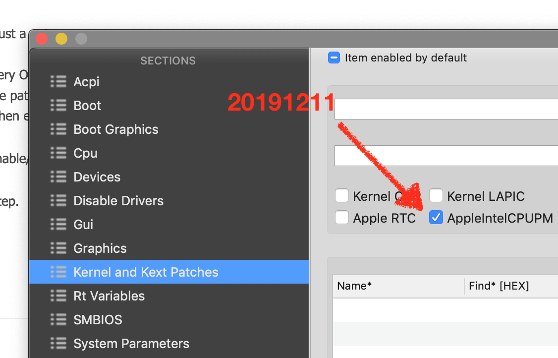

antonio.clb Posted December 12, 2019 Share Posted December 12, 2019 Gentlemen, something strange is happening... I've just made a quick check on my Mojave (18G2022) PM and it's working... OK, you'll say, what's the problem? The odd is that PM is working WITHOUT AICPM patching!!! Latest 18G2022 update went smoothly and PM is working as usual so I thouth AICPM.kext was untouched by this update... I've made a check using "sudo perl AICPMPatch.pl /System/Library/Extensions/AppleIntelCPUPowerManagement.kext/Contents/MacOS/AppleIntelCPUPowerManagement" command and it found the usual 10 wrmsr!!! AICPM is NOT patched but PM works perfectly according to HWSensors and AppleIntelInfo... Link to comment https://www.insanelymac.com/forum/topic/335860-guide-2018-z820-high-sierra-the-great-guide-sucess/page/15/#findComment-2700363 Share on other sites More sharing options...
antonio.clb Posted December 12, 2019 Share Posted December 12, 2019 (edited) I've extracted the relevant file from last two Mojave versions and ran AICPMPatch on both. Mac-Pro-di-Antonio:AICPMPatch antonio$ perl AICPMPatch.pl AppleIntelCPUPowerManagement_18G1012 AppleIntelCPUPowerManagement_18G1012 arch: x86_64 delta: 1 00000000000090e2 movl $0x000000e2,%ecx 00000000000090e7 wrmsr delta: 1 0000000000009195 movl $0x000000e2,%ecx 000000000000919a wrmsr delta: 1 00000000000091ab movl $0x000000e2,%ecx 00000000000091b0 wrmsr delta: 1 00000000000092c9 movl $0x000000e2,%ecx 00000000000092ce wrmsr delta: 1 0000000000009bea movl $0x000000e2,%ecx 0000000000009bef wrmsr delta: 1 000000000000a62f movl $0x000000e2,%ecx 000000000000a634 wrmsr delta: 1 000000000000aa3d movl $0x000000e2,%ecx 000000000000aa42 wrmsr delta: 1 00000000000102d7 movl $0x000000e2,%ecx 00000000000102dc wrmsr delta: 1 000000000001171e movl $0x000000e2,%ecx 0000000000011723 wrmsr delta: 1 0000000000012803 movl $0x000000e2,%ecx 0000000000012808 wrmsr found wrmsr at 90e7 found wrmsr at 919a found wrmsr at 91b0 found wrmsr at 92ce found wrmsr at 9bef found wrmsr at a634 found wrmsr at aa42 found wrmsr at 102dc found wrmsr at 11723 found wrmsr at 12808 wrmsr found: 10 wrmsr ignored: 0 Mac-Pro-di-Antonio:AICPMPatch antonio$ perl AICPMPatch.pl AppleIntelCPUPowerManagement_18G2022 AppleIntelCPUPowerManagement_18G2022 arch: x86_64 delta: 1 00000000000090e2 movl $0x000000e2,%ecx 00000000000090e7 wrmsr delta: 1 0000000000009195 movl $0x000000e2,%ecx 000000000000919a wrmsr delta: 1 00000000000091ab movl $0x000000e2,%ecx 00000000000091b0 wrmsr delta: 1 00000000000092c9 movl $0x000000e2,%ecx 00000000000092ce wrmsr delta: 1 0000000000009bea movl $0x000000e2,%ecx 0000000000009bef wrmsr delta: 1 000000000000a62f movl $0x000000e2,%ecx 000000000000a634 wrmsr delta: 1 000000000000aa3d movl $0x000000e2,%ecx 000000000000aa42 wrmsr delta: 1 00000000000102d7 movl $0x000000e2,%ecx 00000000000102dc wrmsr delta: 1 000000000001171e movl $0x000000e2,%ecx 0000000000011723 wrmsr delta: 1 0000000000012803 movl $0x000000e2,%ecx 0000000000012808 wrmsr found wrmsr at 90e7 found wrmsr at 919a found wrmsr at 91b0 found wrmsr at 92ce found wrmsr at 9bef found wrmsr at a634 found wrmsr at aa42 found wrmsr at 102dc found wrmsr at 11723 found wrmsr at 12808 wrmsr found: 10 wrmsr ignored: 0 Files are different (different MD5) but offsets are the same. Also notice my X86PlatformPlugin version 999.9.9 from LegacyX86PlatformPlugin.kext installed in S/L/E: Mac-Pro-di-Antonio:~ antonio$ kextstat|grep -y appleintelcpu 36 0 0xffffff7f8219b000 0x29000 0x29000 com.apple.driver.AppleIntelCPUPowerManagement (220.0.0) 08A60750-1932-37EB-B013-D44CF9C7AA88 <8 7 6 5 3 1> 48 0 0xffffff7f8221b000 0x3000 0x3000 com.apple.driver.AppleIntelCPUPowerManagementClient (220.0.0) 6D0BE484-5F90-3E3E-8E24-BDDC25483DB3 <8 7 6 5 3 1> Mac-Pro-di-Antonio:~ antonio$ kextstat|grep -y x86plat 118 1 0xffffff7f828e8000 0x18000 0x18000 com.apple.driver.X86PlatformPlugin (999.9.9) 3FE47AC9-96B1-3C82-8CDB-8CC2DFBCB3CD <117 71 23 14 12 8 7 6 5 3 1> 137 1 0xffffff7f82c7d000 0x7000 0x7000 com.apple.driver.X86PlatformShim (1.0.0) 5C294A2E-A3AC-3A73-A0E7-5E276254C04E <118 117 14 8 5 3> Mac-Pro-di-Antonio:~ antonio$ sysctl -n machdep.xcpm.vectors_loaded_count 0 Mac-Pro-di-Antonio:~ antonio$ sysctl -n machdep.xcpm.mode 0 At this point I think that Clover's AppleIntelCPUPM flag is suffcient at least on Mojave... Catalina is approaching... ^__^ Edited December 12, 2019 by antonio.clb Link to comment https://www.insanelymac.com/forum/topic/335860-guide-2018-z820-high-sierra-the-great-guide-sucess/page/15/#findComment-2700364 Share on other sites More sharing options...

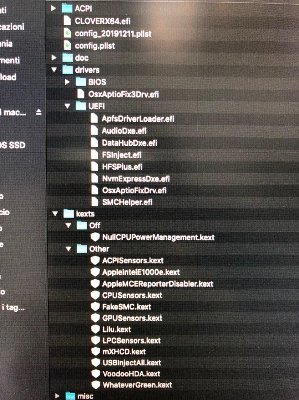

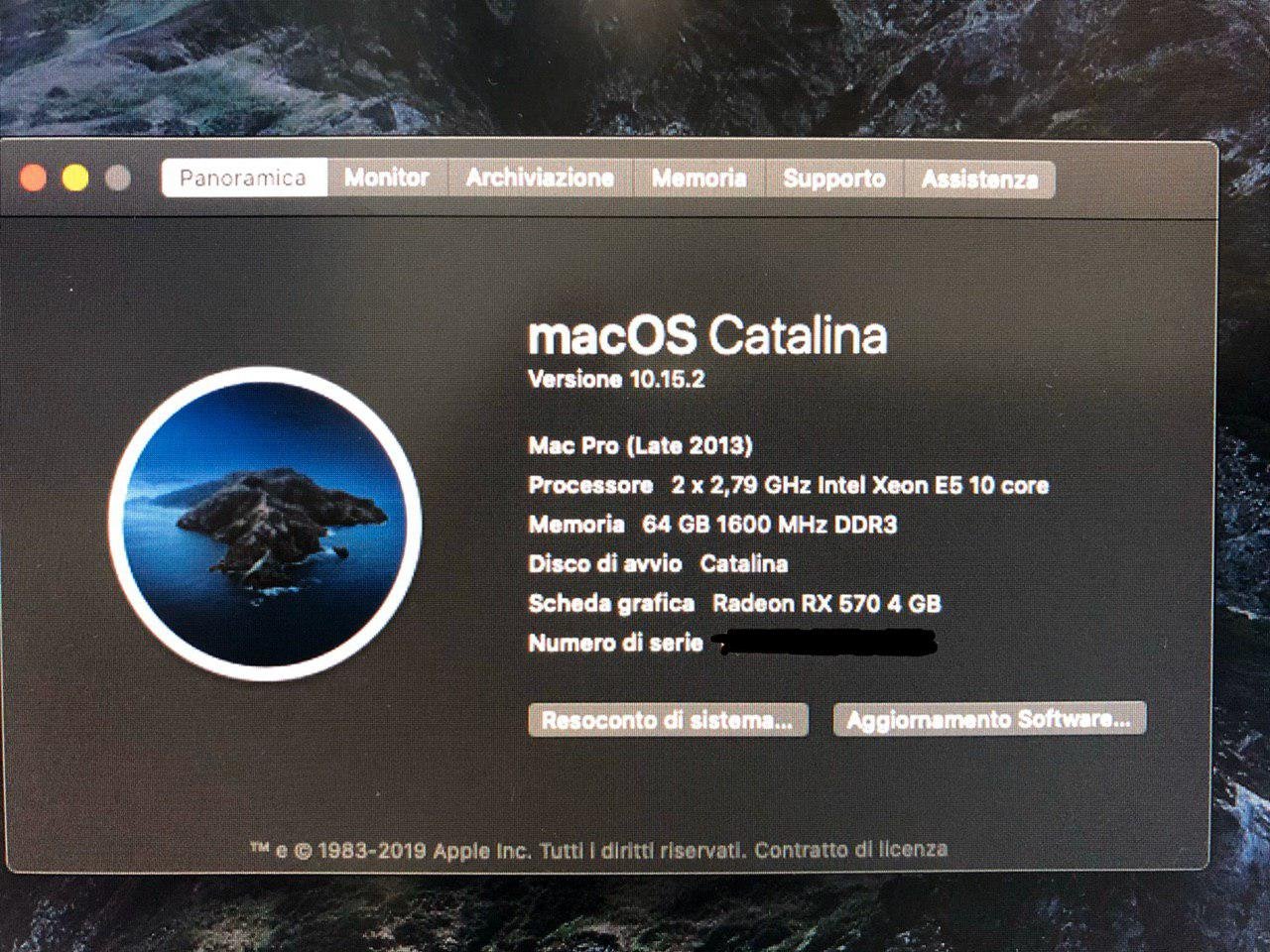

antonio.clb Posted December 12, 2019 Share Posted December 12, 2019 (edited) Today I feel very adventurous... 1) performed a vanilla Catalina 10.15.1 install to a spare SSD; 2) booted with my EFI without success (KP); 3) resolved KP by borrowing AppleMCEReporterDisabler.kext from AMD OS X Project (https://amd-osx.com/2019/10/10/macos-catalina-is-on-amd/); 4) booted and black screen; 5) resolved by updating Lilu and WhateverGreen to the latest versions; 6) succesfully booted Catalina (!); 7) successfully upgraded to 10.15.2 (on a totally black screen...); 8) the only not working thing is PM, I think AICPM has to be patched. Right now I'm backing up my Mojave SSD (booted with Catalina EFI without problems) and I'm planning to update... Stay tuned! Edited December 12, 2019 by antonio.clb Link to comment https://www.insanelymac.com/forum/topic/335860-guide-2018-z820-high-sierra-the-great-guide-sucess/page/15/#findComment-2700390 Share on other sites More sharing options...
