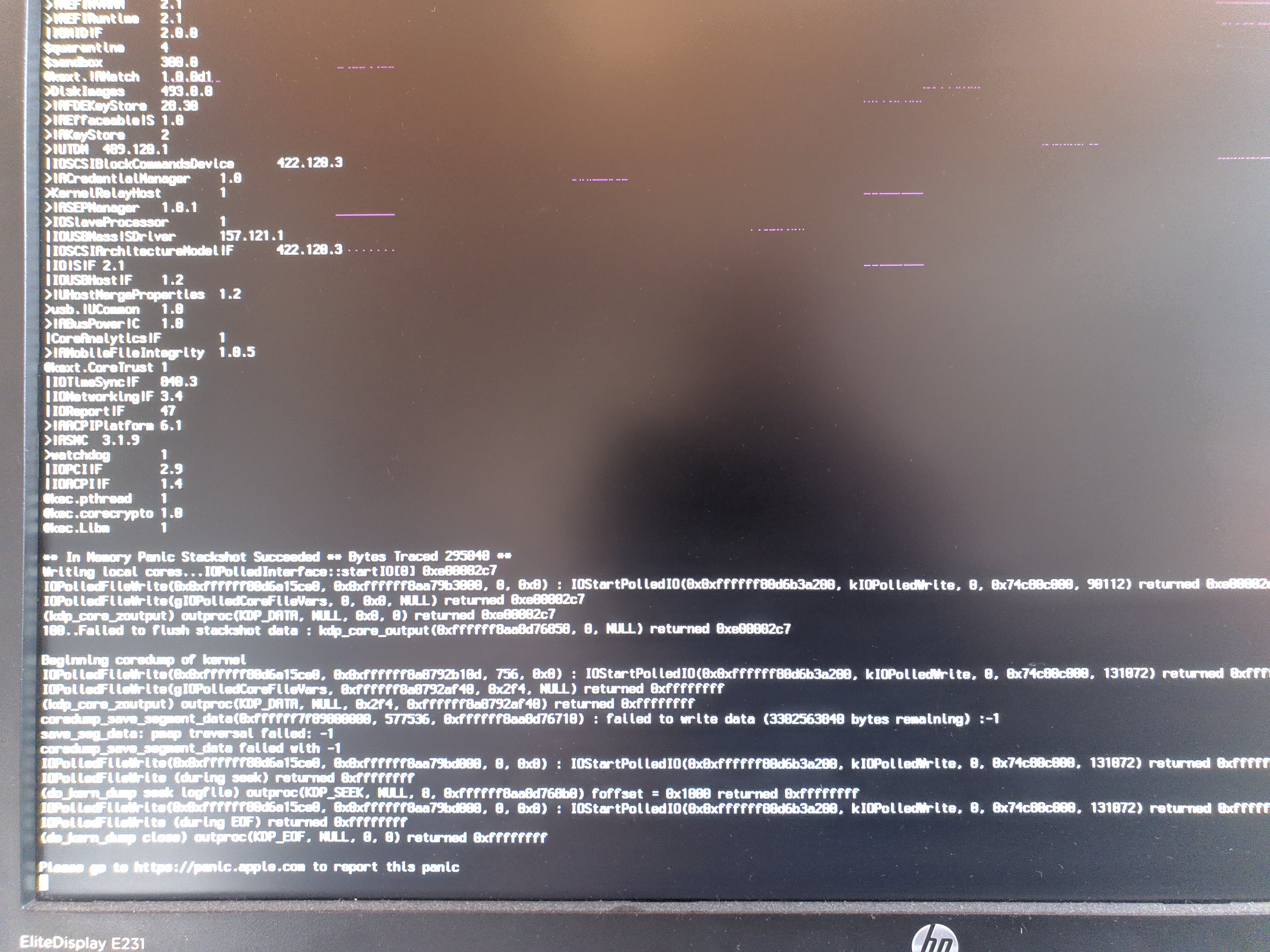

If you look at the screenshot, you can see it occurs practically when GPU is loaded (purple stripes), so basically between 80-99% of loading. I'm used to CPU ACPI errors popping up at the beginning, when FakeSMC/VirtualSMC try to load.

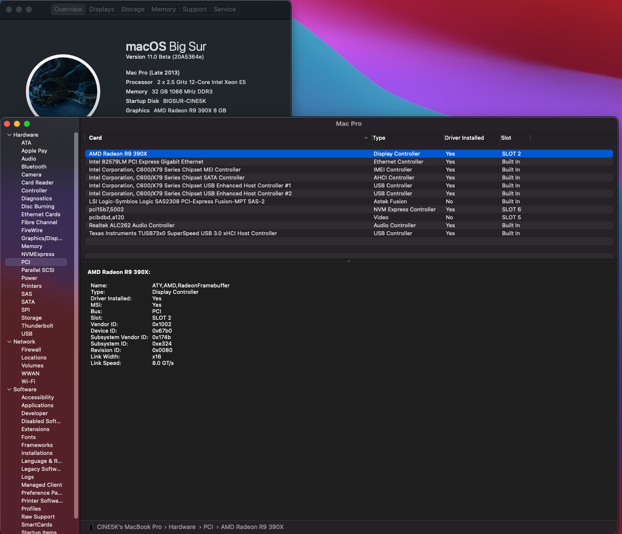

Just now, gigignopechegno said:
I installed Bigsur with the Macbook pro on ssd, to do faster.
Finally I added the CLover EFI folder.
my Hp z820 has 2 xeon 2696v2 with radeon 390x.
Everything works, except the internal SAS. I think kext is at its best for Mojave.
Thanks ;)

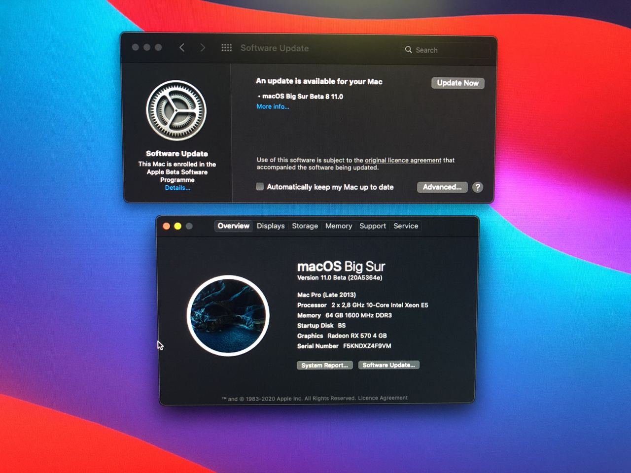

Hello to everybody!
A quick update on my OpenCore and Big Sur journeys on HP Z620.
I've managed to create a perfect OC EFI boot with OCBuilder (OC 6.2) and a couple of extra kexts!
Catalina 10.15.7 boots and works perfectly, MacPro7,1 SMBIOS, USB 2.0 works perfectly (with the new USBInjectAll.kext supporting MacPro7,1), USB 3.0 has issues (slow speed) but I don't use it, USB 3.1 gen 2 (Asmedia ASM1142) works OOB (no boot from this ports of course), FakeSMC (not VirtualSMC) with full CPU sensors (HWMonitor 6.26.1440 and its kexts), both NICS working (AppleIntelE1000e because with IntelMausi I have only one NIC), NVMe SSD wrongly seen as external can be patched by OC without needing extra SSDT.
I've also tried a Big Sur beta installation over an SSD from scratch with this EFI and it worked flawlessly! Big Sur beta 8 installed and updated to beta 9 yesterday without any issue! Installation tooks long due to "apfs_sealvolume" process during second phase...
HERE you can find my OC EFI folder (with freshly generated serial no. and UUID). Don't forget to replace DSDT and SSDT with yours in the ACPI folder.
Let me know!
Best regards.
AC

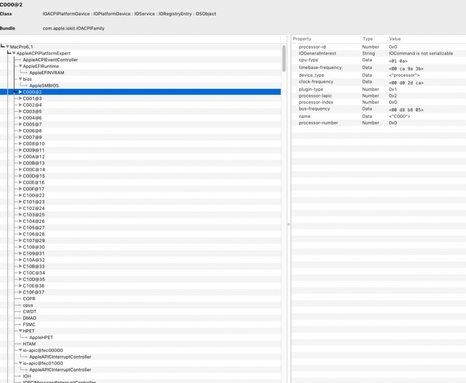

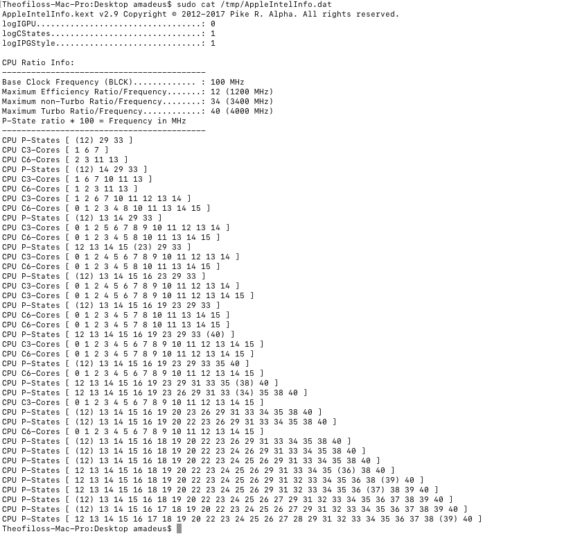

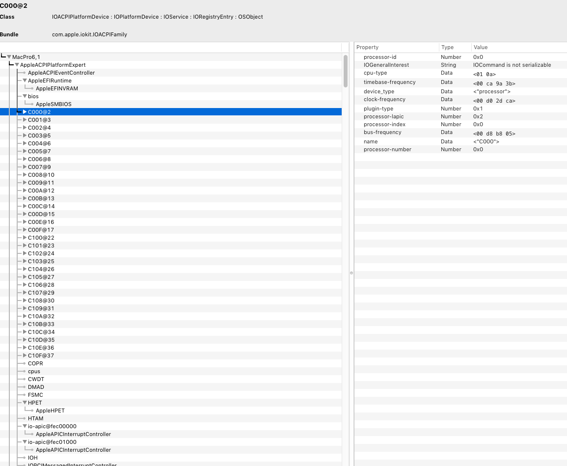

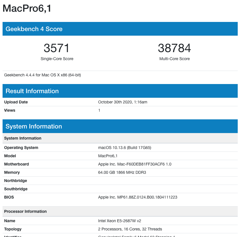

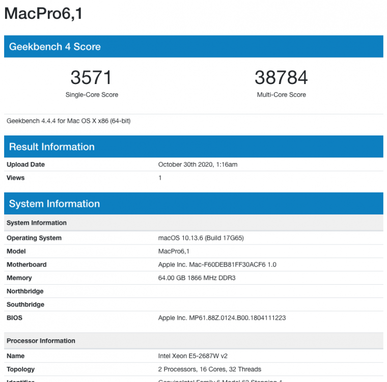

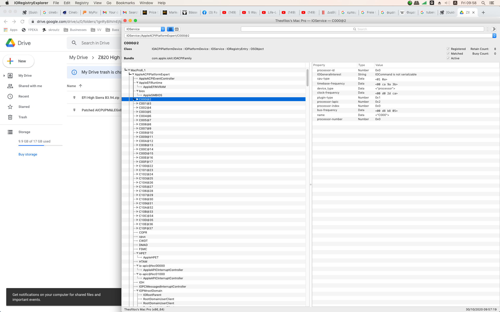

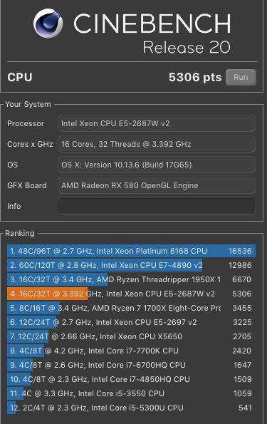

Cheers to everyone, i sincerely hope that all of You guys are well.
Here's an update on my journey to get proper Power management with my unicorn 2xE5-2687 v2 setup.
I did update my bios to 3.94 and because i'm with a lot of free time on my hands i gave it another shot.
If i recall correctly this is the ssdtPRGen command i used to get it done (there were countless attempts ...)
./ssdtPRGen.sh -mode custom -b Mac-F60DEB81FF30ACF6 -p 'E5-2687W v2' -l 32 -turbo 4000 -c 3 -target 1
Here's my EFI folder
EFI Folder (no serial number in config.plist !)
And here are some screenshots.
DSDT.aml
SSDT-1.aml
SSDT.aml
Edited by amadeusex
