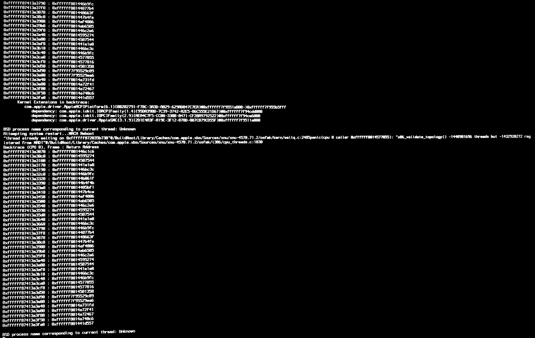

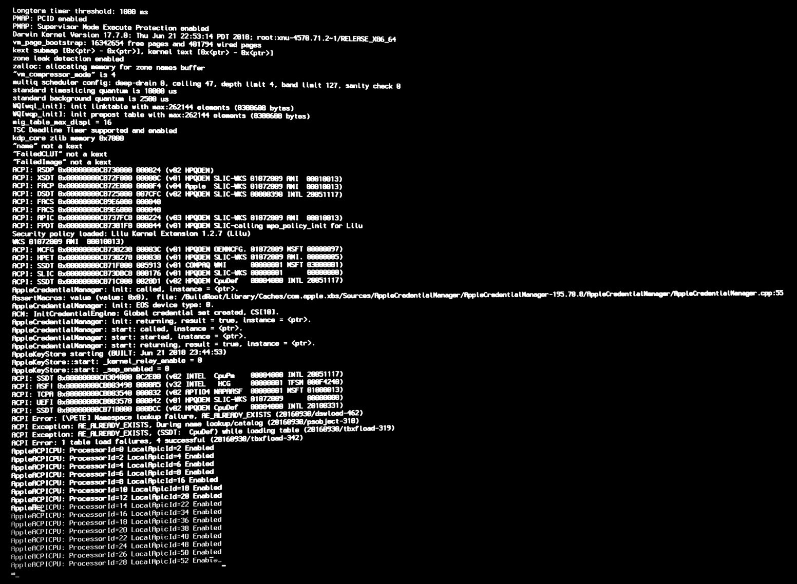

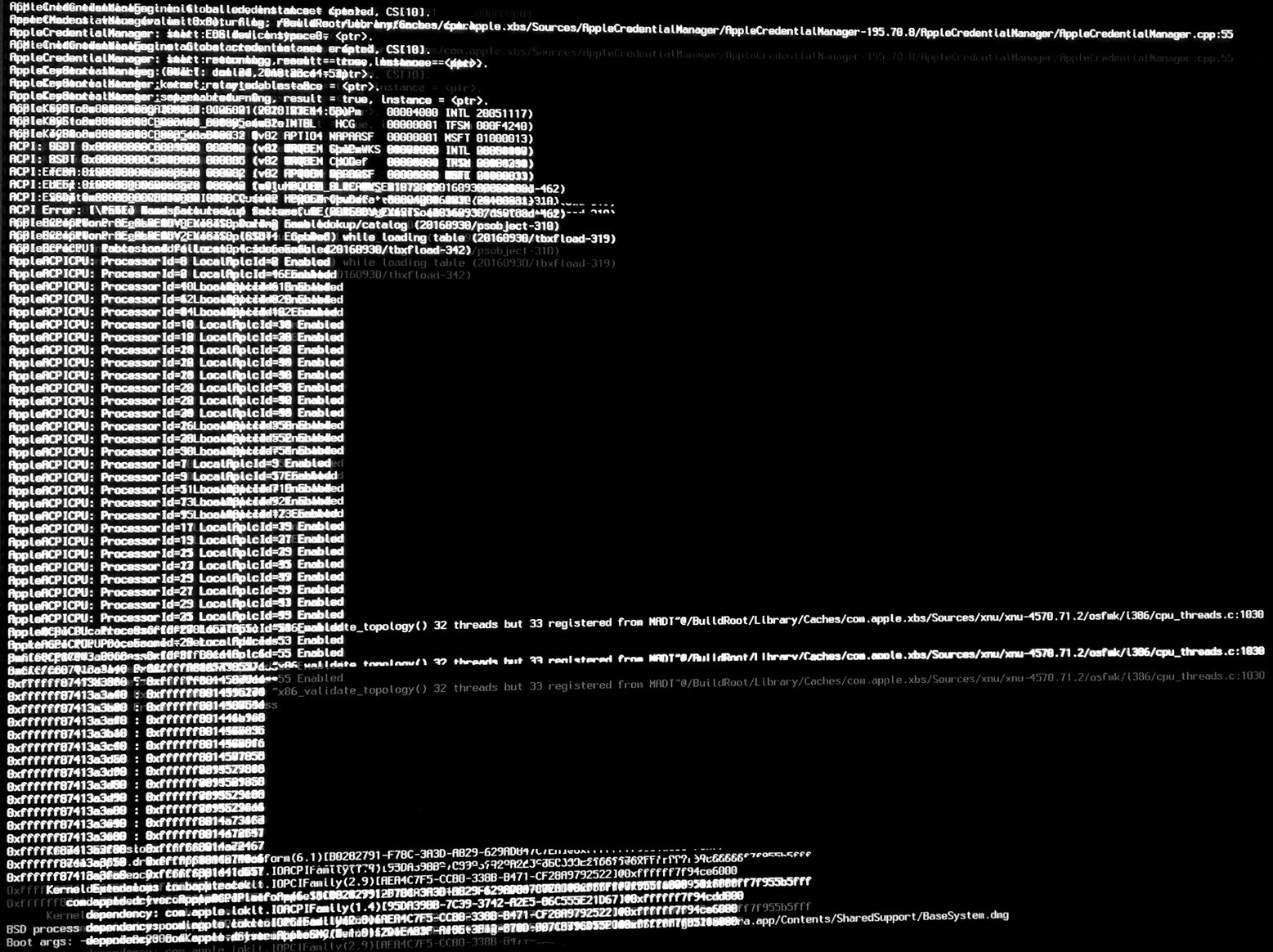

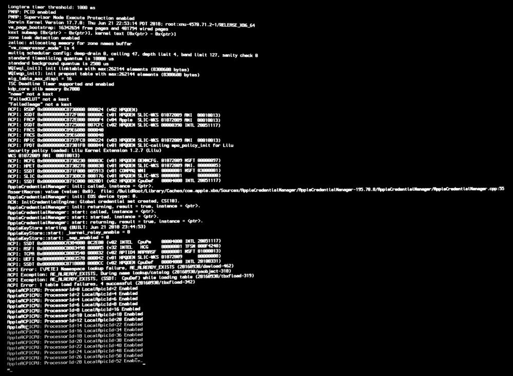

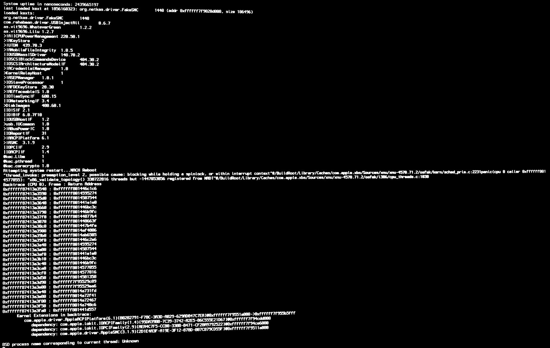

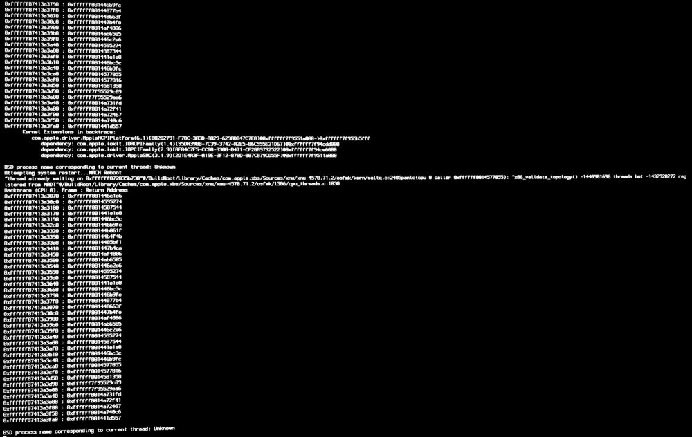

glow9 Posted May 17, 2019 Share Posted May 17, 2019 Tried different things today but with no success. 1. used different usb-stick 2. boot with and without DSDT-1 3. disabled Lilu.kext and WhateverGreen 4. added nv_disable=1 to the boot arguments Here is what I got for pictures during boot and kernel panic: Link to comment Share on other sites More sharing options...
bilbo Posted May 17, 2019 Author Share Posted May 17, 2019 (edited) wow. I'm not an expert, it's hard to me say something. In some screens, I can read clearly the error related with the acpi legacy tables and the ssdt patched and also the boot is rejecting load the patched SSDT. But I don't know what's going on. I'll try to test with your clover files, to discard things. But I'm a bit lost Please, repeat again the F4 process, (checking again that you have set the "load legacy acpi tables" option is enabled and send me all files collected in in /clover/acpi/original. Edited May 17, 2019 by bilbo Link to comment Share on other sites More sharing options...

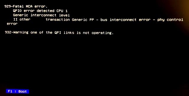

glow9 Posted May 23, 2019 Share Posted May 23, 2019 (edited) After I put the second CPU back in the Z820 I have an error message during every boot. I checked with „intel-processor-diagnostic-tool" https://downloadcenter.intel.com/de/download/19792/Intel-Processor-Diagnostic-Tool. It does not find any errors. Did anyone here experience similar and is there something I can do about it? Edited May 23, 2019 by glow9 Link to comment Share on other sites More sharing options...
