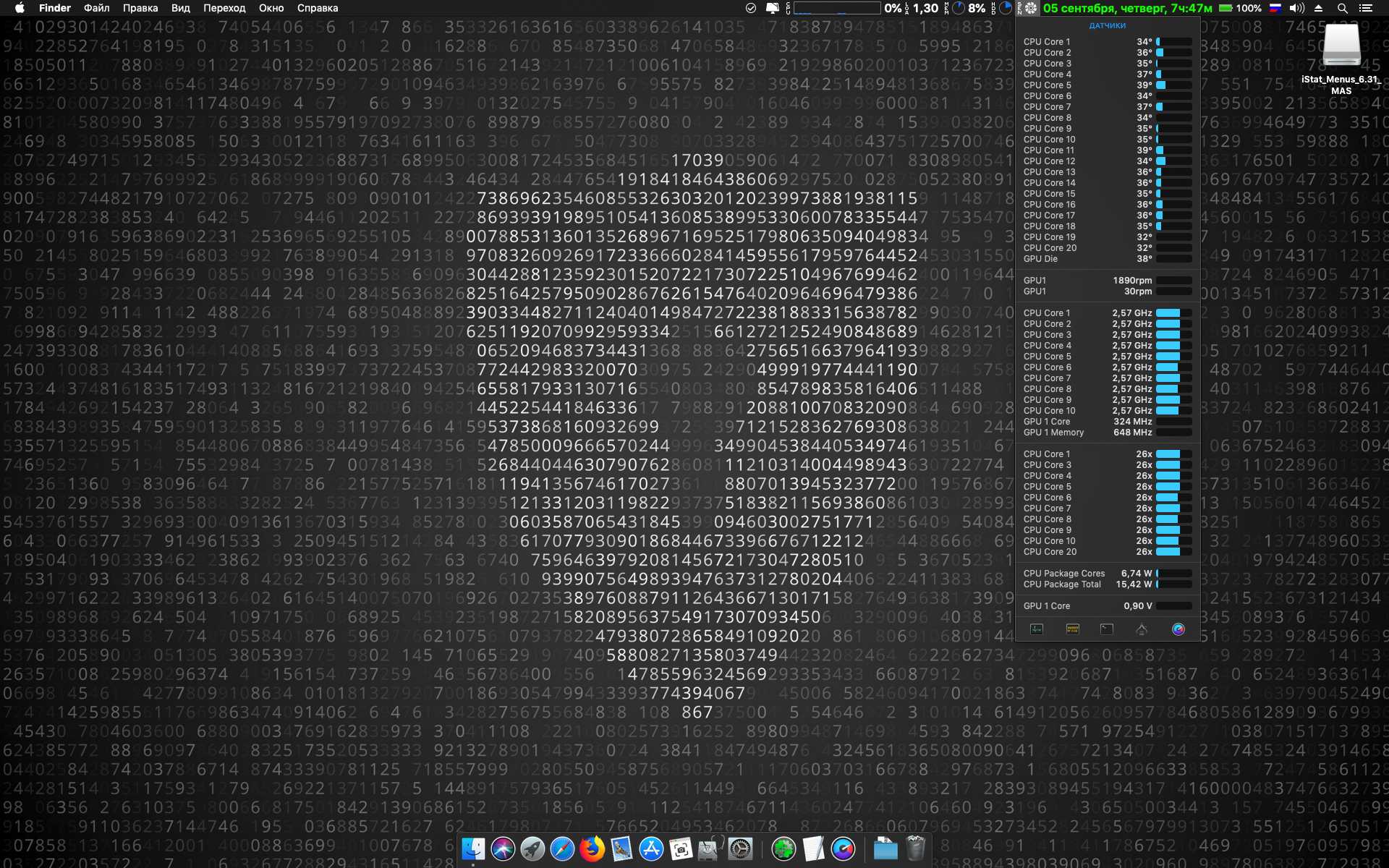

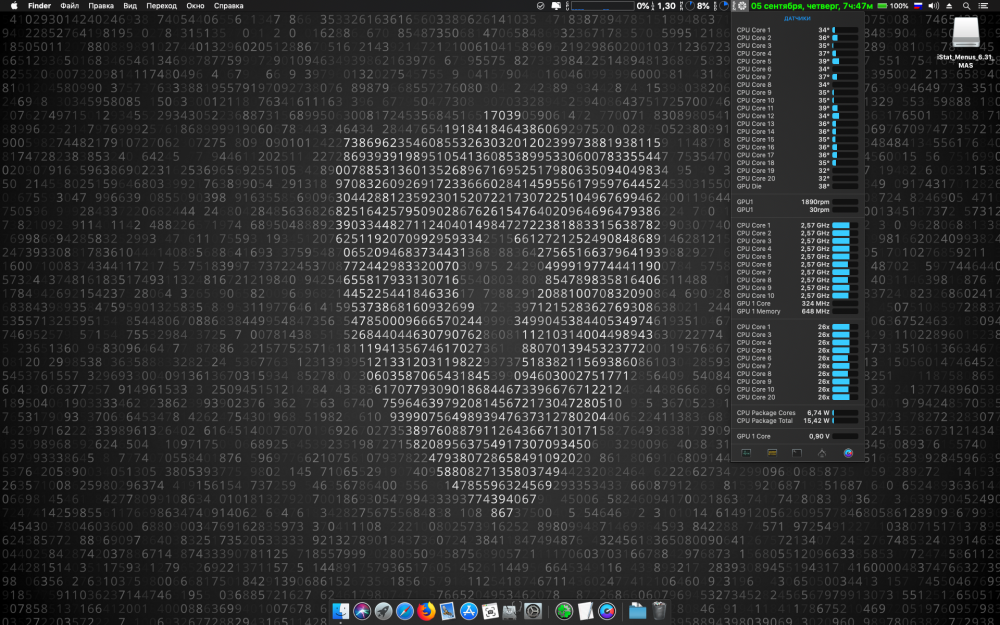

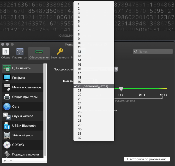

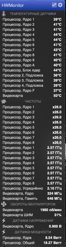

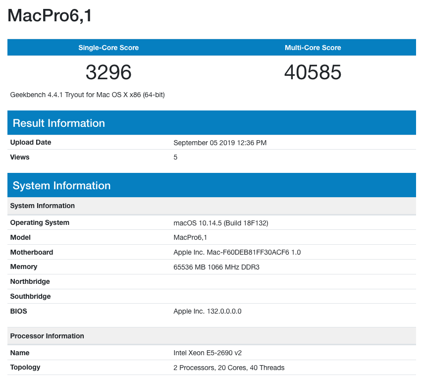

Sebaxakerhtc Posted September 5, 2019 Share Posted September 5, 2019 Hi to all! My BIOS is 3.94. I have a Z820 v2 with 2 x 2690 v2 (10 cores, 20 threads) I followed step by step guide and have working PM and 38000 geekbench. BUT!!! I have just 32 cores of 40. In HWSensors i see 8 cores temp and in parallels just 32 cores. Where is the problem? i try to turn on and off Legacy ACPI tables in BIOS, but no luck. Help me, please. EFI.zip Link to comment https://www.insanelymac.com/forum/topic/335860-guide-2018-z820-high-sierra-the-great-guide-sucess/page/13/#findComment-2688790 Share on other sites More sharing options...
antonio.clb Posted September 5, 2019 Share Posted September 5, 2019 (edited) 25 minutes ago, Sebaxakerhtc said: Hi to all! My BIOS is 3.94. I have a Z820 v2 with 2 x 2690 v2 (10 cores, 20 threads) I followed step by step guide and have working PM and 38000 geekbench. BUT!!! I have just 32 cores of 40. In HWSensors i see 8 cores temp and in parallels just 32 cores. Where is the problem? i try to turn on and off Legacy ACPI tables in BIOS, but no luck. Help me, please. EFI.zip Hello! Your configuration is really similar to mine. Could you please post the output of the following two commands issued in a terminal window? sysctl hw.physicalcpu sysctl hw.logicalcpu Here's mine: Mac-Pro-di-Antonio:~ antonio$ sysctl hw.physicalcpu hw.physicalcpu: 20 Mac-Pro-di-Antonio:~ antonio$ sysctl hw.logicalcpu hw.logicalcpu: 40 Additionally, have you specified the number of cores at the time you generated the SSDT.aml file? Something like this: ./ssdtPRGen.sh -cpus 2 -p 'E5-2690 v2' -x 1 -target 1 -turbo 3600 -c 3 -cpus 2 -l 40 -mode custom -d 3 Your SSDT: Method (_INI, 0, NotSerialized) // _INI: Initialize { Store ("ssdtPRGen version.....: 21.5 / Mac OS X 10.14.5 (18F132)", Debug) Store ("custom mode...........: 1", Debug) Store ("host processor........: Intel(R) Xeon(R) CPU E5-2690 v2 @ 3.00GHz", Debug) Store ("target processor......: E5-2690 v2", Debug) Store ("number of processors..: 2", Debug) Store ("baseFrequency.........: 1200", Debug) Store ("frequency.............: 3000", Debug) Store ("busFrequency..........: 100", Debug) Store ("logicalCPUs...........: 40", Debug) Store ("maximum TDP...........: 130", Debug) Store ("packageLength.........: 25", Debug) Store ("turboStates...........: 6", Debug) Store ("maxTurboFrequency.....: 3600", Debug) Store ("CPU Workarounds.......: 3", Debug) Store ("machdep.xcpm.mode.....: 0", Debug) Store ("number of ACPI scopes.: 2", Debug) } My SSDT: Method (_INI, 0, NotSerialized) // _INI: Initialize { Store ("ssdtPRGen version.....: 21.5 / Mac OS X 10.14.6 (18G95)", Debug) Store ("custom mode...........: 1", Debug) Store ("host processor........: Intel(R) Xeon(R) CPU E5-2680 v2 @ 2.80GHz", Debug) Store ("target processor......: E5-2680 v2", Debug) Store ("number of processors..: 2", Debug) Store ("baseFrequency.........: 1200", Debug) Store ("frequency.............: 2800", Debug) Store ("busFrequency..........: 100", Debug) Store ("logicalCPUs...........: 40", Debug) Store ("maximum TDP...........: 115", Debug) Store ("packageLength.........: 25", Debug) Store ("turboStates...........: 8", Debug) Store ("maxTurboFrequency.....: 3600", Debug) Store ("CPU Workarounds.......: 3", Debug) Store ("machdep.xcpm.mode.....: 1", Debug) } Notice the lack of the "machdep.xcpm.mode" flag... Let us know! Edited September 5, 2019 by antonio.clb 1 Link to comment https://www.insanelymac.com/forum/topic/335860-guide-2018-z820-high-sierra-the-great-guide-sucess/page/13/#findComment-2688793 Share on other sites More sharing options...
Sebaxakerhtc Posted September 5, 2019 Share Posted September 5, 2019 1 hour ago, antonio.clb said: Hello! ... Let us know! Mac-Pro-sebaxakerhtc:~ sebaxakerhtc$ sysctl hw.physicalcpu hw.physicalcpu: 20 Mac-Pro-sebaxakerhtc:~ sebaxakerhtc$ sysctl hw.logicalcpu hw.logicalcpu: 40 As i know -xcpm_ipi not work, but i have it and generate with -x 1. I don't really know, why is 0 Link to comment https://www.insanelymac.com/forum/topic/335860-guide-2018-z820-high-sierra-the-great-guide-sucess/page/13/#findComment-2688811 Share on other sites More sharing options...
Sebaxakerhtc Posted September 5, 2019 Share Posted September 5, 2019 1 hour ago, antonio.clb said: Additionally, have you specified the number of cores at the time you generated the SSDT.aml file? Something like this: ./ssdtPRGen.sh -cpus 2 -p 'E5-2690 v2' -x 1 -target 1 -turbo 3600 -c 3 -cpus 2 -l 40 -mode custom -d 3 Make a new SSDT by this command, but no luck. I have good result with geekbench, but i very confused with parallels and HWSensors... Link to comment https://www.insanelymac.com/forum/topic/335860-guide-2018-z820-high-sierra-the-great-guide-sucess/page/13/#findComment-2688813 Share on other sites More sharing options...

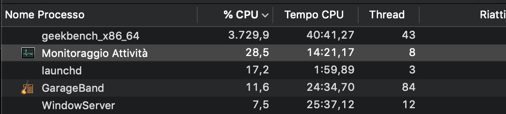

antonio.clb Posted September 5, 2019 Share Posted September 5, 2019 (edited) 12 minutes ago, Sebaxakerhtc said: Make a new SSDT by this command, but no luck. I have good result with geekbench, but i very confused with parallels and HWSensors... HWsensors behaves like mine (showing the first 10 cores i think...). Same for Parallels: 32 cores is the maximum value I can see in that menu too... Your 20 cores/40 threads are working well... Try some cpu-stress test and monitor it with Activity Monitor, you should see, at some point near the end, your CPU usage running at 3600% or so... Just like this: Edited September 5, 2019 by antonio.clb 1 Link to comment https://www.insanelymac.com/forum/topic/335860-guide-2018-z820-high-sierra-the-great-guide-sucess/page/13/#findComment-2688815 Share on other sites More sharing options...
Sebaxakerhtc Posted September 5, 2019 Share Posted September 5, 2019 4 minutes ago, antonio.clb said: some point near the end, your CPU usage running at 3600% or so... Just like this: All work very well and with my old ssdt. My problem is just parallels I need to give to virtual Windows 10 all threads... Anyway thank you. I will lookink for an answer Link to comment https://www.insanelymac.com/forum/topic/335860-guide-2018-z820-high-sierra-the-great-guide-sucess/page/13/#findComment-2688819 Share on other sites More sharing options...
antonio.clb Posted September 5, 2019 Share Posted September 5, 2019 (edited) 2 minutes ago, Sebaxakerhtc said: All work very well and with my old ssdt. My problem is just parallels I need to give to virtual Windows 10 all threads... Anyway thank you. I will lookink for an answer https://kb.parallels.com/120658 Additionally, using all available CPUs in a VM is a no-no... Edited September 5, 2019 by antonio.clb 1 Link to comment https://www.insanelymac.com/forum/topic/335860-guide-2018-z820-high-sierra-the-great-guide-sucess/page/13/#findComment-2688820 Share on other sites More sharing options...
Sebaxakerhtc Posted September 5, 2019 Share Posted September 5, 2019 7 minutes ago, antonio.clb said: Additionally, using all available CPUs in a VM is a no-no... Thank you for this: In Parallels Desktop 13 for Mac Pro/Business Editions the maximum number of CPUs is 32. I try the VirtulBox - same result. I don't use all, but about 90% Link to comment https://www.insanelymac.com/forum/topic/335860-guide-2018-z820-high-sierra-the-great-guide-sucess/page/13/#findComment-2688823 Share on other sites More sharing options...
Sebaxakerhtc Posted September 5, 2019 Share Posted September 5, 2019 57 minutes ago, antonio.clb said: HWsensors behaves like mine (showing the first 10 cores i think...). Insall iStatMenus and... it's work perfect! Link to comment https://www.insanelymac.com/forum/topic/335860-guide-2018-z820-high-sierra-the-great-guide-sucess/page/13/#findComment-2688839 Share on other sites More sharing options...

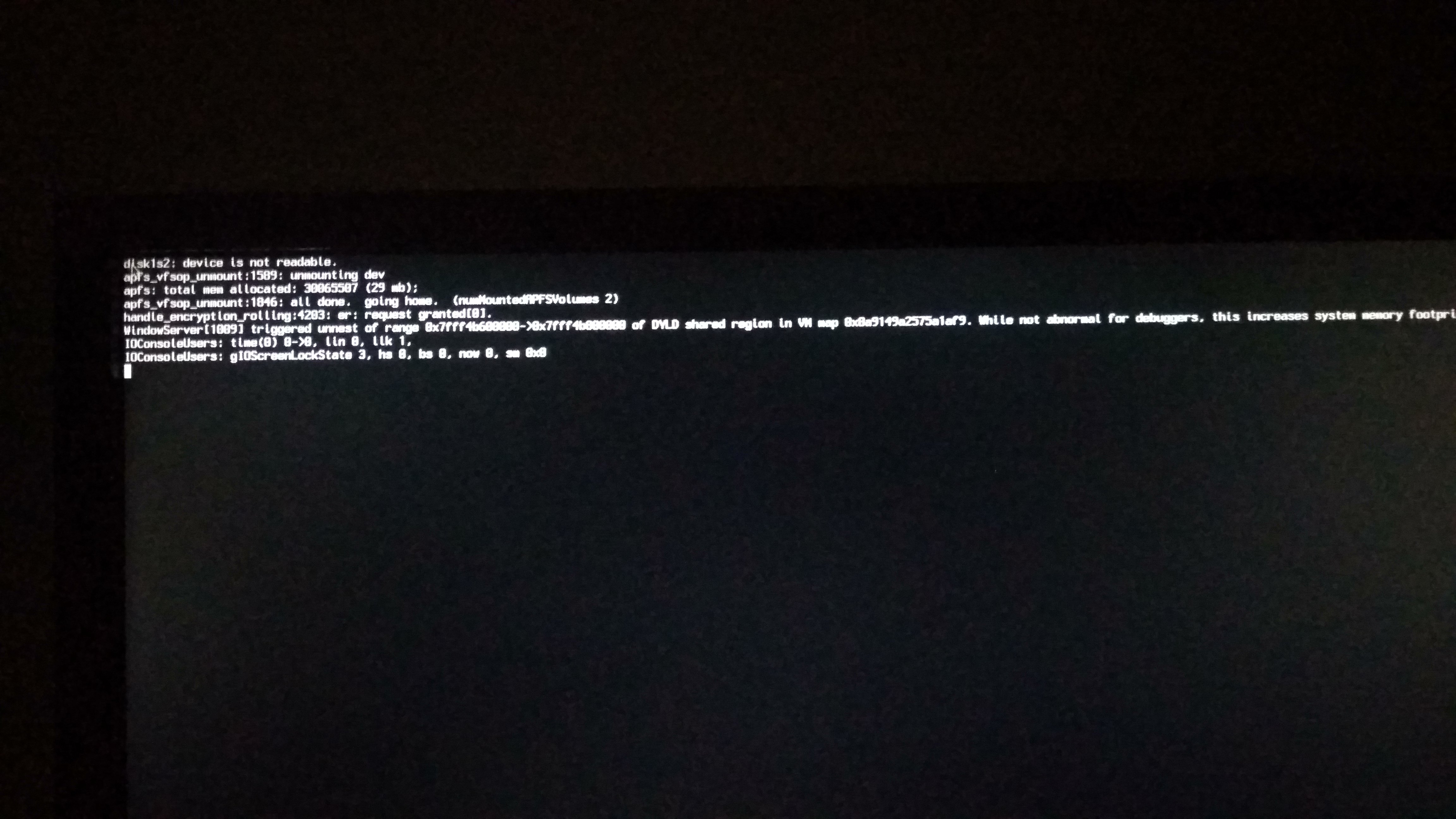

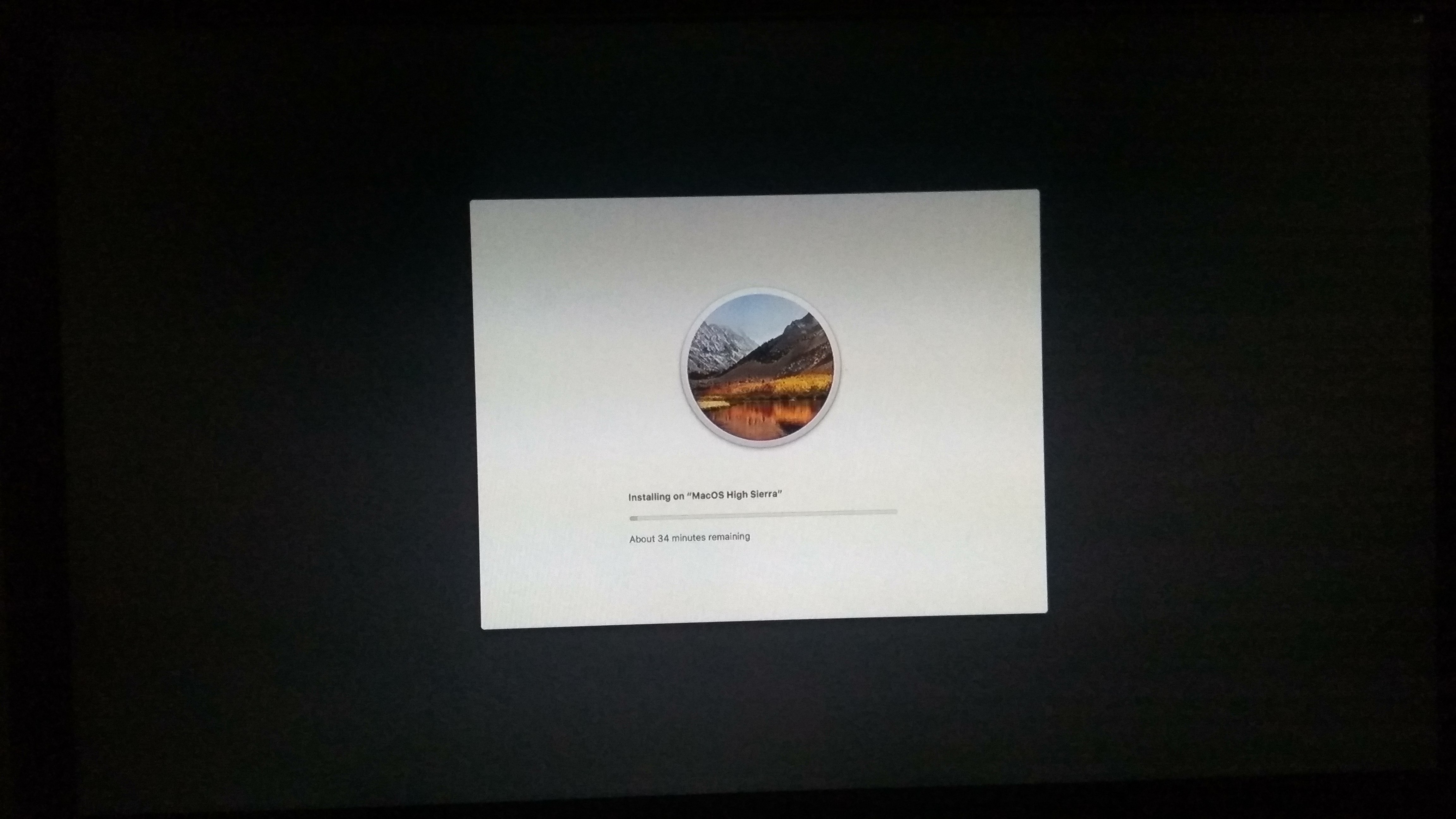

Lynx khan Posted September 21, 2019 Share Posted September 21, 2019 Hi! Bilbo thanks for all the new information you shared on this thread I was eventually able boot into Mac recovery via usb and did the install on my internal SSD Although with some trouble in the second step of install after restart, however it completed the installation process.(image,01) No again while trying to boot on "boot from MacOS High Sierra it gets stuck at.... "WindowServer triggered unnest of range ...." (Image, 02) Anyone please if have any idea at all how I could possibly work around that... I have read may post on different forums regarding windowServer on Mac I do know it has something to do with display of apps but I have no idea how to play with Clover to help resolve this. I have tried FixDisplay once, and also nvideanoefi, as I have quadro 4000 GPU but I was unable to set video options ROM to efi. Link to comment https://www.insanelymac.com/forum/topic/335860-guide-2018-z820-high-sierra-the-great-guide-sucess/page/13/#findComment-2690846 Share on other sites More sharing options...
TheBloke Posted September 22, 2019 Share Posted September 22, 2019 (edited) On 9/21/2019 at 4:55 AM, Lynx khan said: No again while trying to boot on "boot from MacOS High Sierra it gets stuck at.... "WindowServer triggered unnest of range ...." (Image, 02) Anyone please if have any idea at all how I could possibly work around that... I don't (yet) have a Z820 but I just thought I'd mention that I have this exact same message, regarding WindowServer and DYLD shared region on my old X58 system, and I believe it is not related to your problem. I have Googled on the message in the past and believe it's an informational message, and not specific to WindowServer. There's a bug thread for Chrome where someone raised it as a bug that Chrome prints the same DYLD message, and a developer said that this is just informational logging by the system, and "this message is completely harmless." Also, this is not the last message in your log, so this is not where it gets stuck. I'm afraid I have no idea what your problem is, but I thought I'd mention this as I don't think researching on this WindowServer log line is likely to help. Edited September 22, 2019 by TheBloke Link to comment https://www.insanelymac.com/forum/topic/335860-guide-2018-z820-high-sierra-the-great-guide-sucess/page/13/#findComment-2690932 Share on other sites More sharing options...

bilbo Posted September 29, 2019 Author Share Posted September 29, 2019 (edited) On 9/21/2019 at 5:55 AM, Lynx khan said: No again while trying to boot on "boot from MacOS High Sierra it gets stuck at.... Hi Lynx!! Glad to read you here. I see you handled yourself to boot and install HighSierra successfuly. Time after we were sharing info, I realized that your problem was caused probably by the ssdt problem of the non 26x0 models. But I couldn't test and research until and user helped me to test it. If I'm not wrong, you solved your problem using the fixed ssdt-1 file. Really glad to read it. About your problem, it's not related to "WindowServer triggered unnest of range"at all. It's the black screen issue and 6,1 smbios . It's described in the guide. The system is not to able to launch the graphical interface and end the boot process showing the logging window. I quote myself: Quote WhateverGreen.kext (from here, 1.2.2 version) old NvidiaGraphicsFixup proyect has been integrated into this proyect. It's useful for nvidia and amd graphics cards This couple of kexts avoid black screen booting with 6,1 smbios. Is quite important keep in mind the versions of these kexts keeping the right versions among this kexts. Prior to update some of them, you have to check in original websites if it's is compatible with the rest. These versions are ready to work with 10.13.6. and: Quote Also, if you have two monitors, (as me) and one is connected via DVI port, probably you will have problems. Booting with both monitors, black screen. The fix is turn off the other monitor during the boot. The conflict is DVI port + any other port. ( in my case, the other one is connected via DP ). I fixed it buying one (cheap) dvi to hdmi adapter. What you can do: If you use DVI, change to hdmi, or Display Port , if they are available in your graphic card and they are compatible with your monitor. If you have two monitors , unplug one of them. Check and use lasts version of WhateverGreen.kext ...and , important, check what is the right version of Lilu.kext to work with WhateverGreen.kext. If I'm not wrong, just updating both of them to last versions is enough. You don't have to re-install anything. Only change the kexts of clover folder, mounting the hd in other mac Edited September 29, 2019 by bilbo Link to comment https://www.insanelymac.com/forum/topic/335860-guide-2018-z820-high-sierra-the-great-guide-sucess/page/13/#findComment-2691743 Share on other sites More sharing options...
