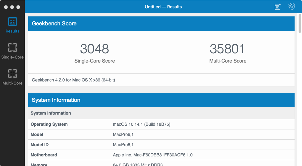

Geekbench gives out ~18000 score, so i guess cpu is not optimized. I'll start digging SSDT next to get PM working..
my cpu is E5-2630v2(if any advices, would help, thanks)  I think i saw in boot error that 0x3e cpu not supported for PM.

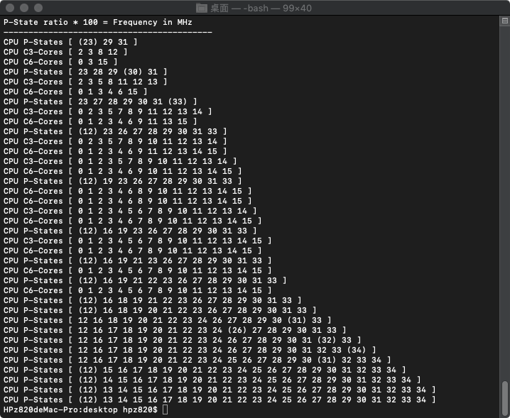

My first attempt on getting PM to work failed. Got a lot of Unknown states C1,C2, etc..
Then LiLu gives some weird error on prelinked kernel, and system reboots.
Ill try again later this week. Cpu i have is E5-2630v2, so it should be supported for PM, right?

i finally got pm to work, but cpu speed did not increase much in geekbench 4. only 21000 multi-score.
AppleIntelInfo.kext v2.9 Copyright © 2012-2017 Pike R. Alpha. All rights reserved.
logIGPU..................................: 0
logCStates...............................: 1
logIPGStyle..............................: 1
CPU Ratio Info:
Base Clock Frequency (BLCK)............. : 100 MHz
Maximum Efficiency Ratio/Frequency.......: 12 (1200 MHz)
Maximum non-Turbo Ratio/Frequency........: 26 (2600 MHz)
Maximum Turbo Ratio/Frequency............: 31 (3100 MHz)
P-State ratio * 100 = Frequency in MHz
CPU P-States [ (12) 25 29 ]
CPU C3-Cores [ 0 1 8 9 ]
CPU C6-Cores [ 4 ]
CPU P-States [ 12 (23) 25 29 ]
CPU C3-Cores [ 0 1 2 3 8 9 ]
CPU C6-Cores [ 0 3 4 6 ]
CPU C6-Cores [ 0 3 4 6 8 9 ]
CPU P-States [ 12 21 23 25 (26) 29 ]
CPU C3-Cores [ 0 1 2 3 8 9 10 11 ]
CPU C6-Cores [ 0 2 3 4 5 6 7 8 9 ]
CPU P-States [ 12 (19) 21 23 25 26 29 ]
CPU C6-Cores [ 0 2 3 4 5 6 7 8 9 11 ]
CPU C6-Cores [ 0 1 2 3 4 5 6 7 8 9 11 ]
CPU P-States [ (12) 16 19 21 23 25 26 29 ]
CPU P-States [ 12 16 19 21 23 24 25 26 (29) ]
CPU P-States [ (12) 16 19 21 22 23 24 25 26 29 ]
CPU C6-Cores [ 0 1 2 3 4 5 6 7 8 9 10 11 ]
CPU P-States [ 12 16 19 21 22 23 24 25 26 29 (30) ]
CPU P-States [ (12) 16 19 20 21 22 23 24 25 26 29 30 ]
Anyway.. thanks bilbo for awesome guide. sorry for a lot of silly questions. It was my first time installing hackintosh. I guess now ill start using it. :)
