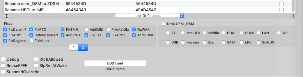

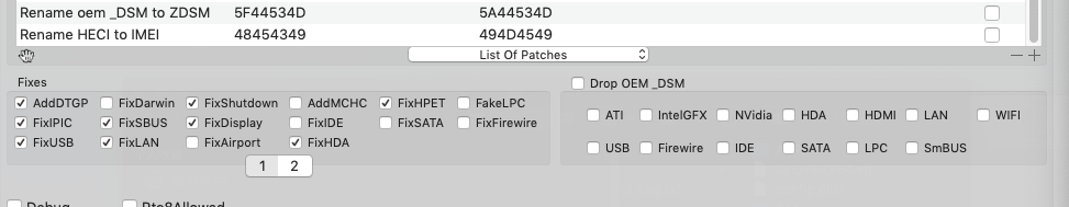

@Pingyes, my first attemp with your settings to test SLEEP, gave me a KP.  The patches  "rename _DSM... " and "rename HECI...." don't make sense for me. The patches ticked in clover, either. Some of them are obsolete, or unnecessary after clean the dsdt, ... honestly I don't understand anything. Anyway, as I said, I get a KP.
 Could you elaborate a bit the reason of those patches? Are essential all of them?
Edited by bilbo

I don't understand what they mean. These are just the default configuration of the clover. I have given up on sleep. I think your configuration is the most reasonable.

I tested the patches of pingyes screens. The "fixUSB" patch is the reason of KP. Testing with the rest of options, no way.

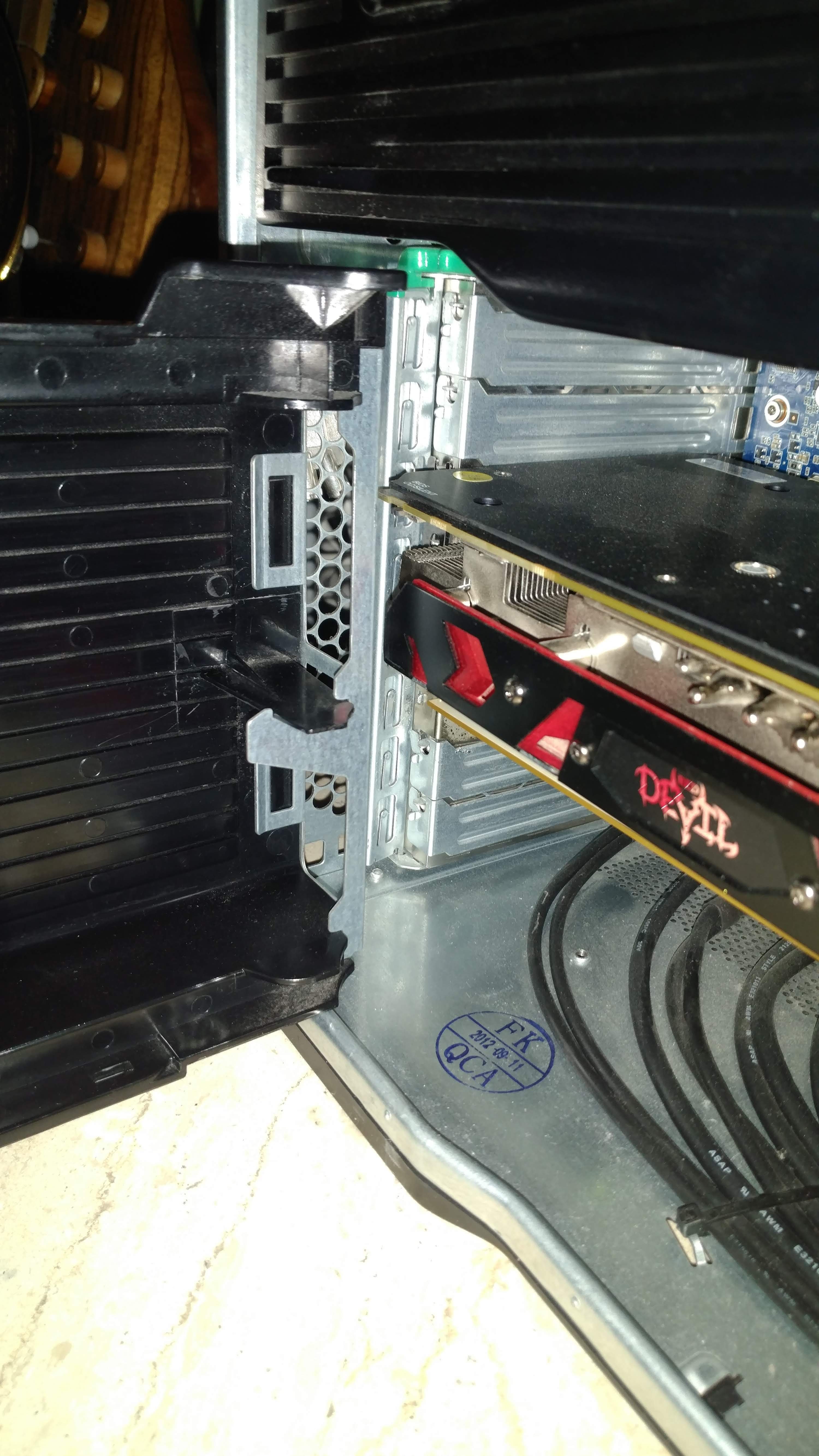

But with that being said the cover inside the z280 doesn't fit anymore.
Does anyone of you guys know a hack to put it back in? (with the GPU still installed of course)
Could you please post a couple of pictures?
With the 1080 ti, I had to leave out the bottom cover also. The card has enough room to fit, but the power connectors placed at the long side (not at back /short side) prevent close it wit the bottom cover. I don´t care that. With the main side cover is enough. Maybe the air flow is not so perfect, now, but I don´t notice wrong with temps or fans. Works 100%.
