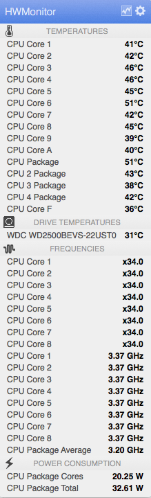

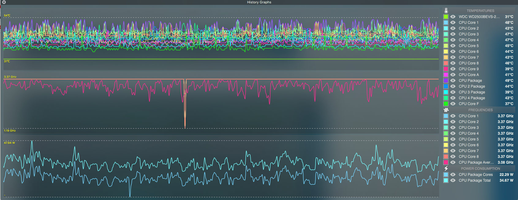

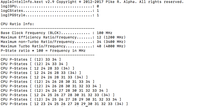

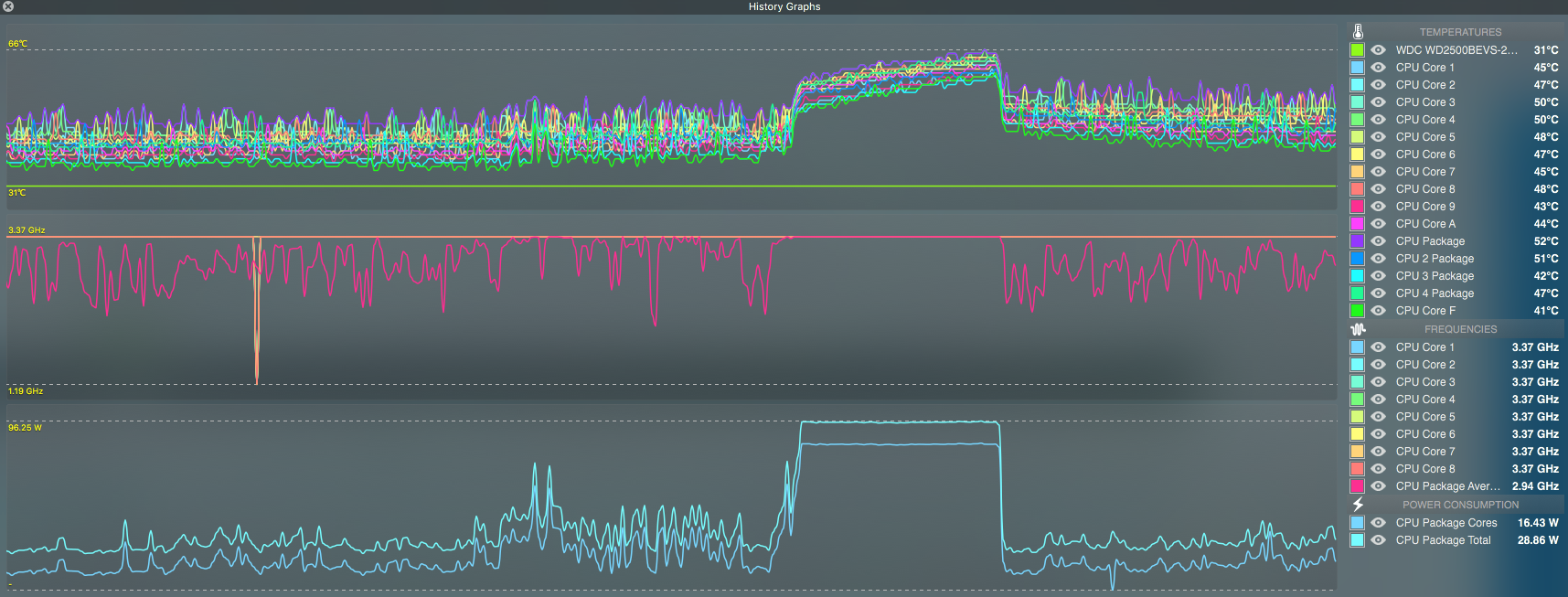

Hi

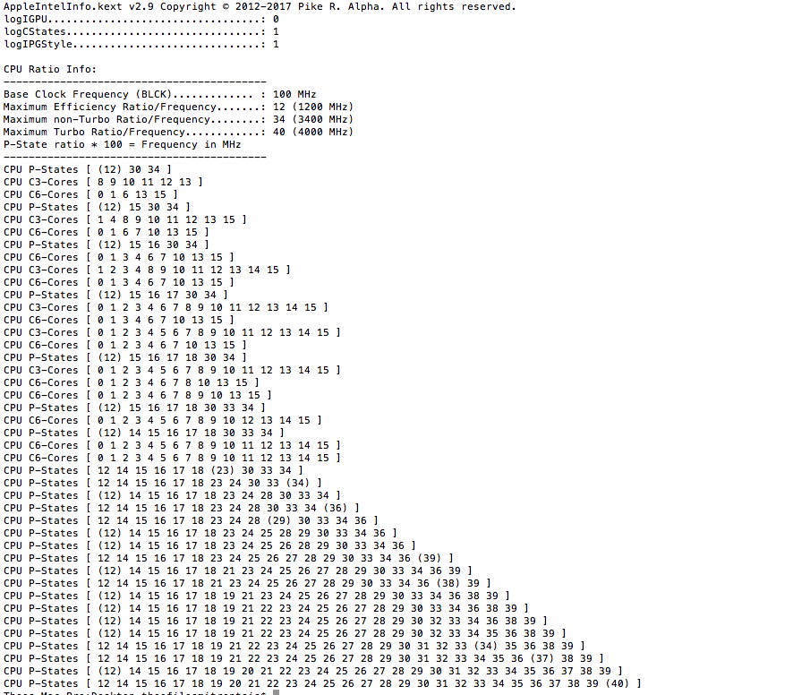

Well that's not that easy to answer - according to HW Monitor there's activity on the Graph but the nominal readouts stay at 3.37 GHz - Have a look.
The 1st screenshot is Idle with Chrome open. - the 2nd shows a cinebench multicore run (@ 2/3 in the graph timeline )
Turbo gets never activated - even with the cinebench single core bechmark the frequency never goes over 3.37. (dropdown screenshot)
IDLE
CINEBENCH RUN
In the non-graph the readout of the cpu CPU cores 1-8 stays always at x34 and 3.37 GHz. Only Cpu-Package average and the Power Consumption readouts fluctuate.
Edited by amadeusex
More clarification

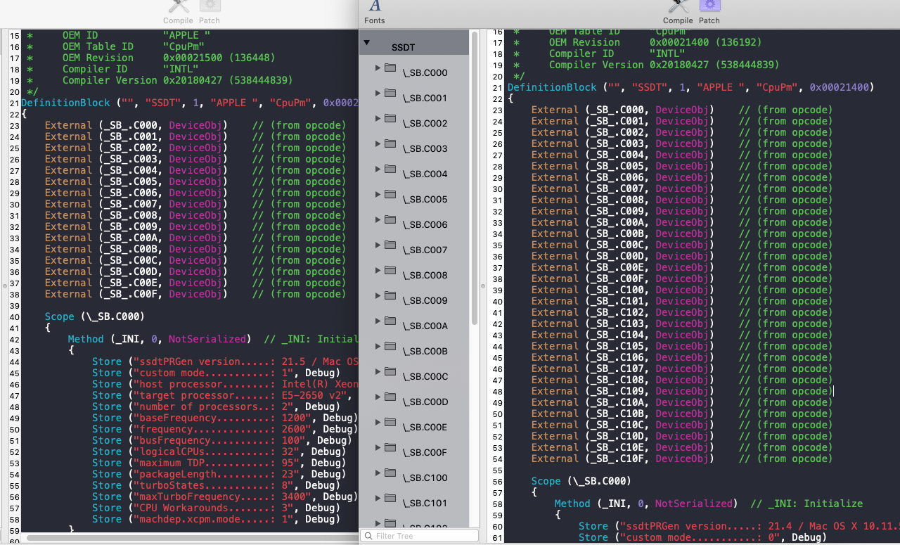

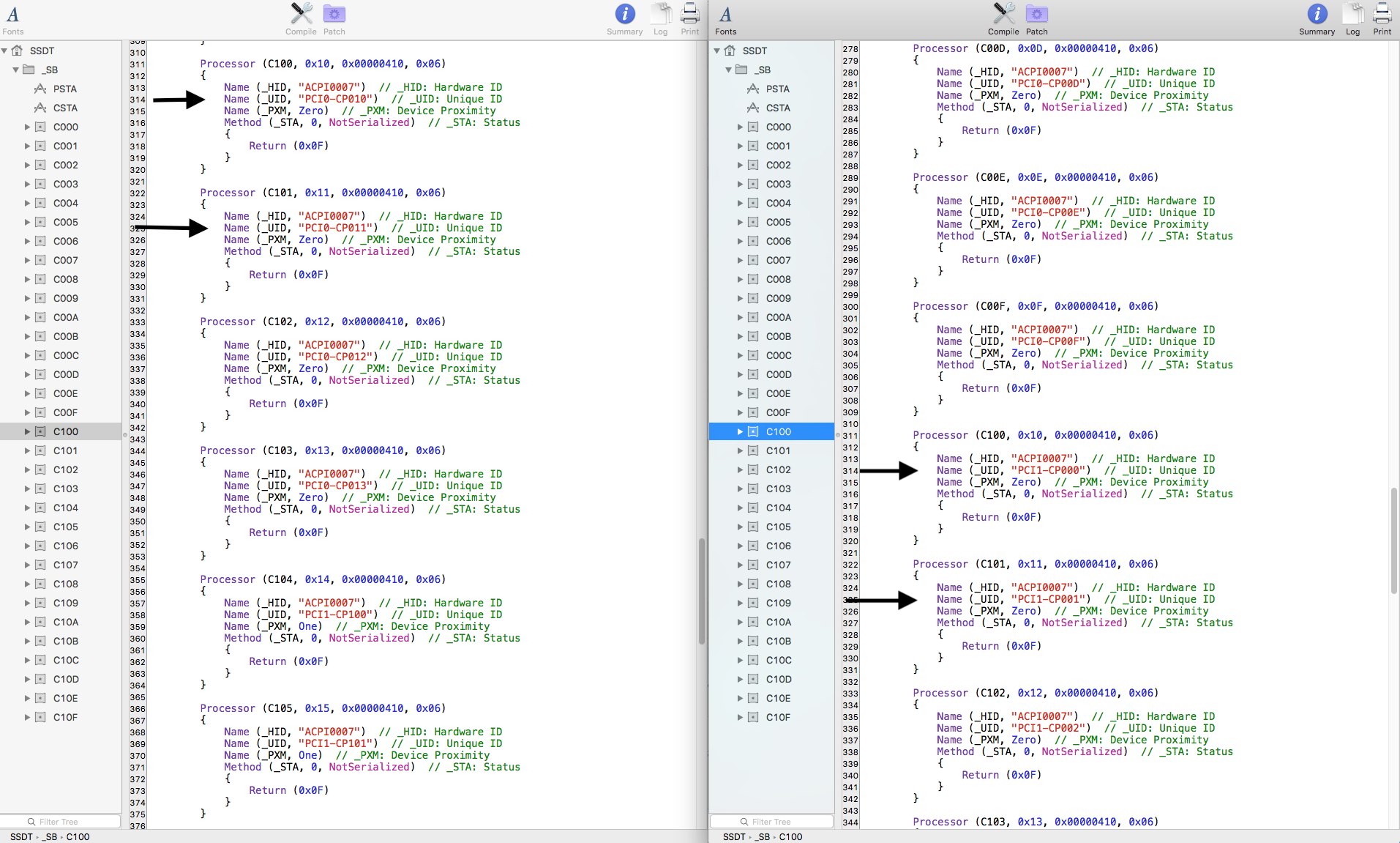

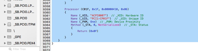

On another note I've edited Your SSDT-1.aml because there was something i've noticed with the scopes.
Here's the (supposedly) corrected SSDT-1.aml
SSDT-1.aml
Edited by amadeusex
39 minutes ago, amadeusex said:
Which was wrong - here's another one.
SSDT-1.aml

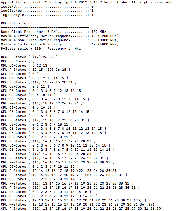

Now if this isn't going to drive me crazy I don't know what is ...
I had a HDD failure while trying to get working PM. I also had an old SSD with High Sierra from my other machine z820 v1 with the dual sandy bridge 2670 v1.
Now ... I thought it is worth a shot and booted up with the USB drive and copied the EFI from the z820 v2 to the SSD.
The elaborate SSDT and DSDT combo didn't work of course so i tried an earlier combo and take a guess - C-states are still not working but the CPU now runs up to 3.8 GHz.
My best guess is that (i remember reading somewhere about it but can't remember where) the 2687w v2 needs the also the sandy-bridge patch (step 1 of stinga's  tutorial - step 28 of bilbo's guide)
because i left the AICPUPM.kext i've patched for the 2670v1 (<- Sandy Bridge CPU) untouched on purpose.

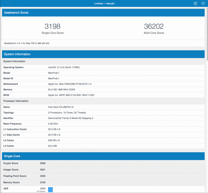

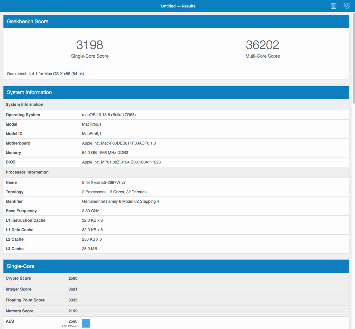

Strange though is that albeit the single-core performance climbed from 3100 to 3500 in geekbench 4 the multicore sacked to 26700 (from 37-38k).
... to be continued - sigh !
Edit - Do we have PM ?
Edited by amadeusex
That looks like PM, can't say for sure why your performance is down, but at least it looks like you're getting proper power states.

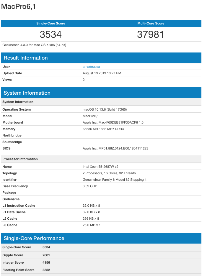

Here's geekbench 4 without c-states btw ...

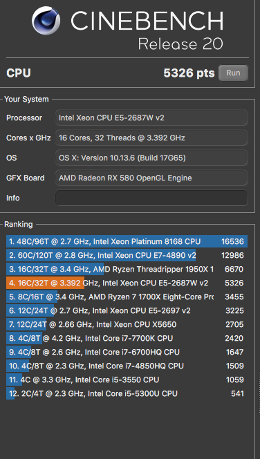

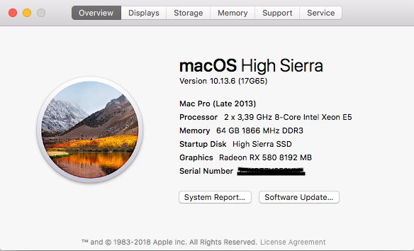

z820v2 with 3.92 Bios dual Xeon E5 2687W v2 64GB ram and a Radeon Red Devil RX-580 8 GB
My EFI Folder - EFI.zip
My aicpupm.kext AICPUPM.kext
My patched LegacyX86PlatformPlugin.kext LegacyX86PlatformPlugin.kext Put both Kexts to S/L/E and repair permissions.
ssdrPRGen command used : ./ssdtPRGen.sh -m custom (ssdt-1.aml provided by @bilbo renamed to SSDT.aml and placed to Desktop together with APIC.aml)
What did the trick was to use both patches mentioned in bilbos guide under point 28 !
What remains now is to reinstall High Sierra on a bigger disk or maybe even just restore the one i have to another SSD (i know bilbo doesn't like the idea but this is going to save a lot of time).
Thanks to @bilbo for the excellent guide and all the effort and to  @hugodlc for taking the time and all the back and forth tinkering !

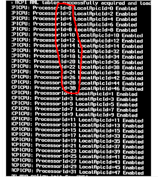

I studied your working SSDT and I believe that your CPU's probably show up out of order in IORegistry explorer, but that doesn't seem to be a problem for PM. I think this is because the new SSDTs generated behave like you have 1 CPU with 32 cores and everything clocks to the first CPU core.

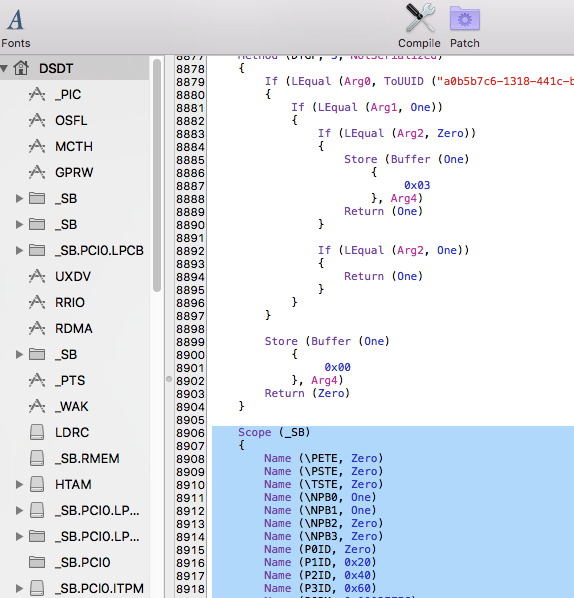

I inserted my SSDT-1 details at the bottom of my main DSDT like we had to do before, and then ran the ssdrPRGen command, but I see there's either a bug or a condition with this dual CPU config and the script.
If I run it without the 'cpus 2' flag, it builds the SSDT with a ton of errors, but with all the CPU's.
If I run it with the flag, I get no errors, but only CPU cores 1-16.
So in the end I had to manually add the missing cores to the version without errors.

Paste it at the end of your DSDT file just before the last closing bracket
etc...

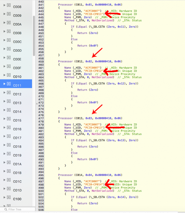

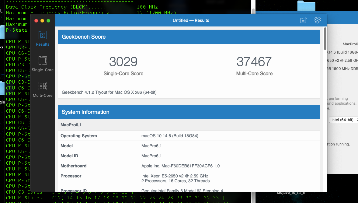

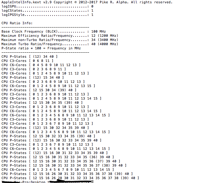

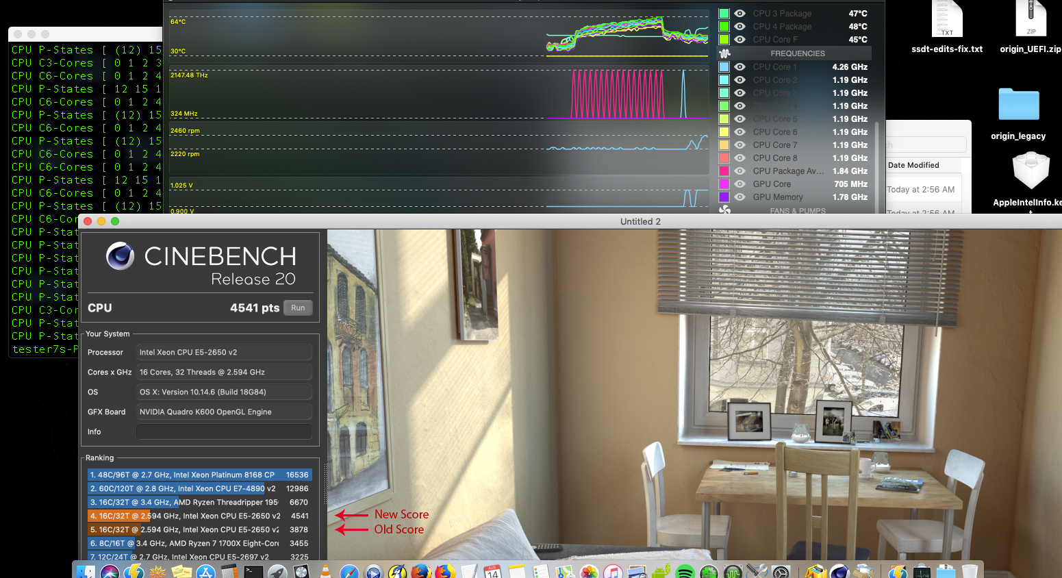

Holy {censored}! I think I've made progress. I had to manually add more processor entries in my SSDT after the ssdtPRgen would only add 16 logical cores. I duplicated the first block of 16 logical entries C000-C00F and numerated each entry from C100 to C10F for the second block.
These are the flag/switches I fed ssdtPRGen.
ssdtPRGen.sh -mode custom -p 'E5-2650 v2' -b Mac-F60DEB81FF30ACF6 -c 3 -x 1 -cpus 2 -l 32 -target 1
This resulted in the first part of the screenshot below. Only 16 logical cores were defined in that block. My scores were very low. Didn't have low power or turbo modes. Speeds were stuck at 2.6ghz. Low and behold, with the edited SSDT (on the right side of the screenshot). Speeds fluctuated between 1.10ghz, and 3.4ghz as demanded. This resulted in higher scores for both GB4 and cinemabench. Now I have to test it for stability.
Edited by gawdemmet
typoes and poor grammar
