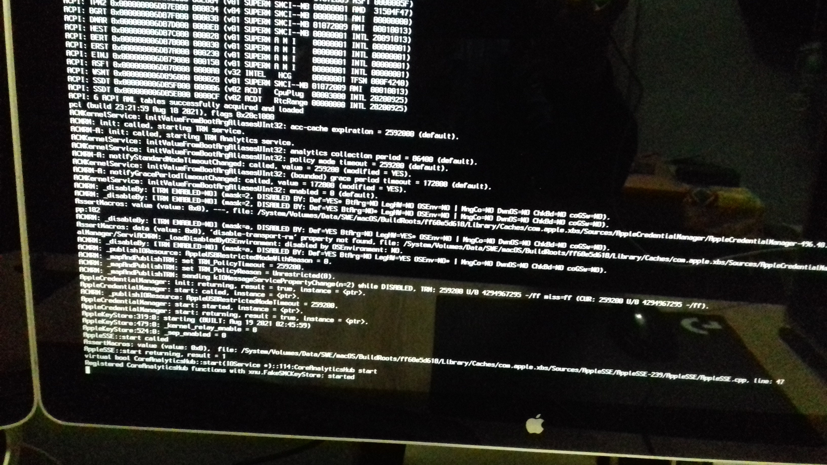

yapan4 Posted September 17, 2021 Share Posted September 17, 2021 (edited) @etorix Please look... Stop always on this place... P.S. Where are our s4189 posts from X299 theme? ACPI from X11sra-f.zip preboot.log Edited September 17, 2021 by yapan4 Link to comment https://www.insanelymac.com/forum/topic/335193-help-installing-mojave-on-xeon-w-2175-and-asus-ws-c422-mobo/page/33/#findComment-2766694 Share on other sites More sharing options...
etorix Posted September 17, 2021 Share Posted September 17, 2021 (edited) Earlier today I had a vision it could be that… And, yes, it is! BIOS v2.4: Device (CP00) { Name (_HID, "ACPI0007" /* Processor Device */) // _HID: Hardware ID Method (_UID, 0, NotSerialized) // _UID: Unique ID { Return (CUID (0x00, 0x00)) } BIOS v2.4 defines ACPI 6.3 processor devices. OS X expects ACPI 6.2 2.0 processor objects, as in BIOS v2.3 Processor (CP00, 0x00, 0x00001810, 0x06) { Name (_HID, "ACPI0007" /* Processor Device */) // _HID: Hardware ID Name (_UID, "SCK0-CP00") // _UID: Unique ID So X11SRA-F v2.4 requires CPU wrapping, like Metacollin's X11DAi or my Gigabyte C621-SU8 with BIOS F7/F8. Welcome to the club! PS It looks like our C621A posts have been completely deleted. Moderators are quite strict over there, and admittedly these posts were dragging the thread off-topic. But it is strange that the moderators feel the need to clean a few posts when popular thread can grow to thousands of pages and become impossible to read. Oh well, let's wait for Ramazarusx to initiate a new thread when he finds a board for his Xeon W-3335 QS. Edited November 6, 2021 by etorix correction 1 1 Link to comment https://www.insanelymac.com/forum/topic/335193-help-installing-mojave-on-xeon-w-2175-and-asus-ws-c422-mobo/page/33/#findComment-2766712 Share on other sites More sharing options...
yapan4 Posted September 17, 2021 Share Posted September 17, 2021 Thank you, @etorix So far I'm still on version 2.3. Next - let's see... Link to comment https://www.insanelymac.com/forum/topic/335193-help-installing-mojave-on-xeon-w-2175-and-asus-ws-c422-mobo/page/33/#findComment-2766715 Share on other sites More sharing options...
