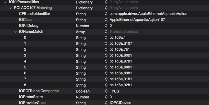

yapan4 Posted May 13, 2021 Share Posted May 13, 2021 (edited) @etorix I have some progress with SATA, USB, Above 4G Decoding. No progress with sound and Marvell-Aquantia AQC-108 5Gb/s Ethernet... I continue to research but, I confess, some help would not hurt Update: Sound fixed by change alcid to alcid=28. I'm not sure is it correct layout, but layout 7 from ASUS that has same codec don't work. Edited May 15, 2021 by yapan4 Link to comment https://www.insanelymac.com/forum/topic/335193-help-installing-mojave-on-xeon-w-2175-and-asus-ws-c422-mobo/page/31/#findComment-2757948 Share on other sites More sharing options...
rolandino Posted May 15, 2021 Share Posted May 15, 2021 On 5/13/2021 at 6:15 PM, yapan4 said: @etorix I have some progress with SATA, USB, Above 4G Decoding. No progress with sound and Marvell-Aquantia AQC-108 5Gb/s Ethernet... I continue to research but, I confess, some help would not hurt Update: Sound fixed by change alcid to alcid=28. I'm not sure is it correct layout, but layout 7 from ASUS that has same codec don't work. I have the X11SRA running on two systems. Regarding the AQC-108: you need a special Apple firmware to make it work. Unfortunately as far as I know the only way to get this firmware on the Aquantia chip is to install 10.13.3 Did you find a way to boot with Above 4G Decoding enabled? Link to comment https://www.insanelymac.com/forum/topic/335193-help-installing-mojave-on-xeon-w-2175-and-asus-ws-c422-mobo/page/31/#findComment-2758224 Share on other sites More sharing options...
yapan4 Posted May 15, 2021 Share Posted May 15, 2021 1 hour ago, rolandino said: I have the X11SRA running on two systems. My X11SRA-F motherboard has PCB revision 1.02 and BIOS v2.3. Some BIOS settings and motherboard behavior may differ depending on the revision and BIOS version! 1 hour ago, rolandino said: Regarding the AQC-108: you need a special Apple firmware to make it work. Unfortunately as far as I know the only way to get this firmware on the Aquantia chip is to install 10.13.3 I know about this method but have not seen any reports with a positive result, only one negative from the Asrock motherboard... 1 hour ago, rolandino said: Did you find a way to boot with Above 4G Decoding enabled? Yes, but I did not get the positive effect as on Asus when Above 4G Decoding is enabled, so the feasibility of this option on Supermicro is questionable. Do you have any ideas? Link to comment https://www.insanelymac.com/forum/topic/335193-help-installing-mojave-on-xeon-w-2175-and-asus-ws-c422-mobo/page/31/#findComment-2758232 Share on other sites More sharing options...

rolandino Posted May 16, 2021 Share Posted May 16, 2021 21 hours ago, yapan4 said: I know about this method but have not seen any reports with a positive result, only one negative from the Asrock motherboard... It does work on my X11SRA boards. Link to comment https://www.insanelymac.com/forum/topic/335193-help-installing-mojave-on-xeon-w-2175-and-asus-ws-c422-mobo/page/31/#findComment-2758293 Share on other sites More sharing options...

yapan4 Posted May 16, 2021 Share Posted May 16, 2021 (edited) @rolandino There are some side effects? Can you make screenshots please? Edited May 17, 2021 by yapan4 Link to comment https://www.insanelymac.com/forum/topic/335193-help-installing-mojave-on-xeon-w-2175-and-asus-ws-c422-mobo/page/31/#findComment-2758326 Share on other sites More sharing options...

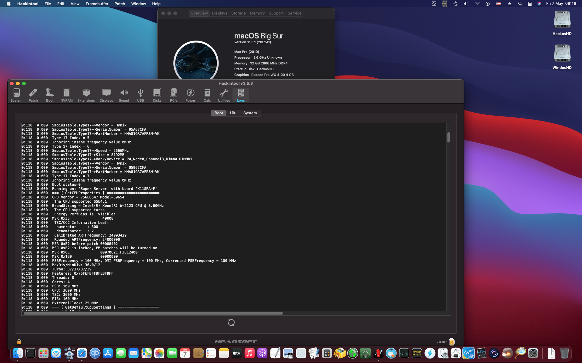

yapan4 Posted May 17, 2021 Share Posted May 17, 2021 (edited) Ok, my configuration: Motherboard: Supermicro X11SRA-F, PCB revision v.1.02(Cascade Lake ready), BIOS v.2.3, PSU SuperMicro PWS-865-PQ(DPS-860CB-A) CPU: Xeon W-2123 RAM: 32Gb(4x8GB) ECC Registered 2xSamsung M393A1K43BB1-CTD + 2xHynix HMA81GR7AFR8N-VK GPU: Radeon Pro WX4100, 2xApple LED Cinema Display (24"), Mini DisplayPort connections HDD: 2x250Gb SSD Samsung 860 Evo(SATA), macOS + Windows 10 Network: Intel i210 1GB/s + Aquantia-Marvell AQC108 5GB/s, temporary no WI-FI Soft: MacPro7,1 SMBIOS, macOS 11.4RC(20F71), Clover r5135 Add: DVD-RW, Fire-Wire 400 Card, 500GB HDD for backup, USB Bluetooth 4.0 CSR Logitech USB keyboard + Logitech USB Mouse EFI Folder for already installed Big Sur (attached). Note: motherboard has locked MSR 0x0E2 register so KernelPM must be enabled, in my case Clover automatically enable this patch BIOS Settings - Coming soon(How to save BIOS settings into file???) 1. BMC Graphic disabled by jumper. 2. Press F3 to load optimised defaults then press F4 to save and reboot. NOTE: My Hackintosh from signature temporarily unavailable because both machine shared some parts. X11SRA-F_yapan4_EFI.zip bootlog.txt Edited May 17, 2021 by yapan4 Link to comment https://www.insanelymac.com/forum/topic/335193-help-installing-mojave-on-xeon-w-2175-and-asus-ws-c422-mobo/page/31/#findComment-2758424 Share on other sites More sharing options...
rolandino Posted May 17, 2021 Share Posted May 17, 2021 20 hours ago, yapan4 said: @rolandino There are some side effects? Can you make screenshots please? Nope, no side effects, just works without any patches then. I did this three years ago. What screenshots do you want? Link to comment https://www.insanelymac.com/forum/topic/335193-help-installing-mojave-on-xeon-w-2175-and-asus-ws-c422-mobo/page/31/#findComment-2758444 Share on other sites More sharing options...
yapan4 Posted May 17, 2021 Share Posted May 17, 2021 7 minutes ago, rolandino said: Nope, no side effects, just works without any patches then. I did this three years ago. What screenshots do you want? I wonder about DevID after flash because current AppleEthernetAquantiaAqtion.kext has no DevID D108 Link to comment https://www.insanelymac.com/forum/topic/335193-help-installing-mojave-on-xeon-w-2175-and-asus-ws-c422-mobo/page/31/#findComment-2758448 Share on other sites More sharing options...
rolandino Posted May 17, 2021 Share Posted May 17, 2021 2 minutes ago, yapan4 said: I wonder about DevID after flash because current AppleEthernetAquantiaAqtion.kext has no DevID D108 It has device id 107 after flash and system profiler reports AQC107-AFW 2 hours ago, yapan4 said: Note: motherboard has locked MSR 0x0E2 register so KernelPM must be enabled, in my case Clover automatically enable this patch You can unlock MSRs 0x0E2 and 0x1AA with UEFIPatch. See zip file attached. I do not have my machines with me right now, but I think, I use BIOS version 2.1 Must likely it will work with 2.3 too. UEFIPatch_0.27.0_mac.zip 1 Link to comment https://www.insanelymac.com/forum/topic/335193-help-installing-mojave-on-xeon-w-2175-and-asus-ws-c422-mobo/page/31/#findComment-2758450 Share on other sites More sharing options...
