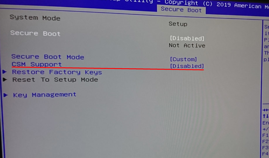

yapan4 Posted February 18, 2020 Share Posted February 18, 2020 (edited) 14 hours ago, obus said: Sorry if I'am a little bit confused but are you saying that you actually can boot (in to black screen) in verbose mode with 3003 bios? Yes, with OEM v.1202 DSDT.aml in /EFI/Clover/ACPI/patched (dumped by Clover F4 button) my system with v.3003 has more no stop during boot, verbose mode run as usual but just ignore load video drivers and macOS GUI at all and remained in text mode. 14 hours ago, obus said: And if so have you checked if you can connect remotely from another Mac or Pc? I'm trying remote control over IPMI, no success because one more "surprise" in v.3003 from ASUS - not available BOOT -> Primary Display option. PrimaryDisplay1202.BMP Also i can try do Apple Remote Desktop in v.1202 and then flash v.3003 and try connect. I will be try also different DSDT files. Also I notice reinit process for video card in Windows during first boot after BIOS update, so something changed in CPU PCIe subsystem. PCIe x1 Video Card can help if connect it in PCH PCIe slot. Onboard ASpeed video is such but... I will experimentalize... Edited February 18, 2020 by yapan4 Link to comment Share on other sites More sharing options...

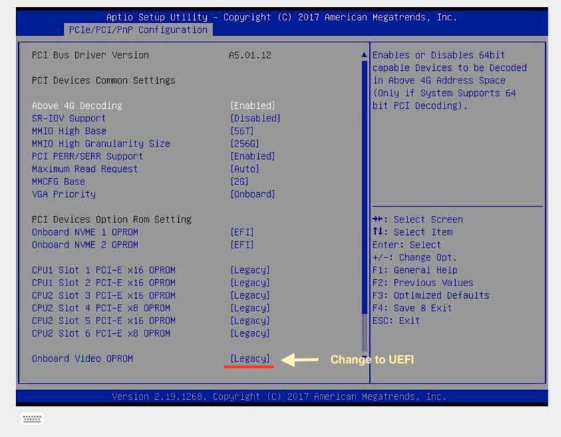

obus Posted February 18, 2020 Author Share Posted February 18, 2020 (edited) 10 hours ago, yapan4 said: Also I notice reinit process for video card in Windows during first boot after BIOS update, so something changed in CPU PCIe subsystem. PCIe x1 Are you running Mac Pro7,1 SMBIO:s? And if so is it the same behaviour with iMac Pro1,1 SMBIO:s? Edited February 18, 2020 by obus Link to comment Share on other sites More sharing options...
yapan4 Posted February 18, 2020 Share Posted February 18, 2020 (edited) Last time I test only MacPro7,1 SMBIOS. Now I'm not sure, probably past times I tested with iMacPro1,1 SMBIOS and was different behaviour during boot kernel, different kernel_patches or so on... sorry, i do not remember... Edited February 18, 2020 by yapan4 Link to comment Share on other sites More sharing options...
obus Posted February 18, 2020 Author Share Posted February 18, 2020 5 minutes ago, yapan4 said: Last time I test only MacPro7,1 SMBIOS. Now I'm not sure, probably past times I tested with iMacPro1,1 SMBIOS and was different behaviour during boot kernel, different kernel_patches or so on... sorry, i do not remember... Ok. I will test myself a little bit more. I'm still having a discussion with ASUS about the Bios 3003 and the locked MSR 0xE2 register. I still think this could be the culprit at least in our case. 1 Link to comment Share on other sites More sharing options...
yapan4 Posted February 18, 2020 Share Posted February 18, 2020 I agree, it's important. I now again in v.1202, if you in v.3003 check please Primary Display option, if also unavailable then it's second major bug from ASUS in this BIOS. Link to comment Share on other sites More sharing options...
obus Posted February 18, 2020 Author Share Posted February 18, 2020 1 minute ago, yapan4 said: I agree, it's important. I now again in v.1202, if you in v.3003 check please Primary Display option, if also unavailable then it's second major bug from ASUS in this BIOS. I will test the 1202 DSDT in OC 0.5.5 with 3003 bios now. Link to comment Share on other sites More sharing options...
yapan4 Posted February 18, 2020 Share Posted February 18, 2020 6 minutes ago, obus said: I will test the 1202 DSDT in OC 0.5.5 with 3003 bios now. Don't forget just one patch of the kernel is working for me in Clover in v.3003 and MP7,1: xcpm_bootstrap © Pike R. Alpha 8D43C43C 227722 8D435E3C 227722 Link to comment Share on other sites More sharing options...
yapan4 Posted February 18, 2020 Share Posted February 18, 2020 (edited) ... and connect VGA Display(if you have) to onboard ASpeed video. If you have problems with OC, then you can use my Clover EFI EFI.zip Edited February 19, 2020 by yapan4 Link to comment Share on other sites More sharing options...

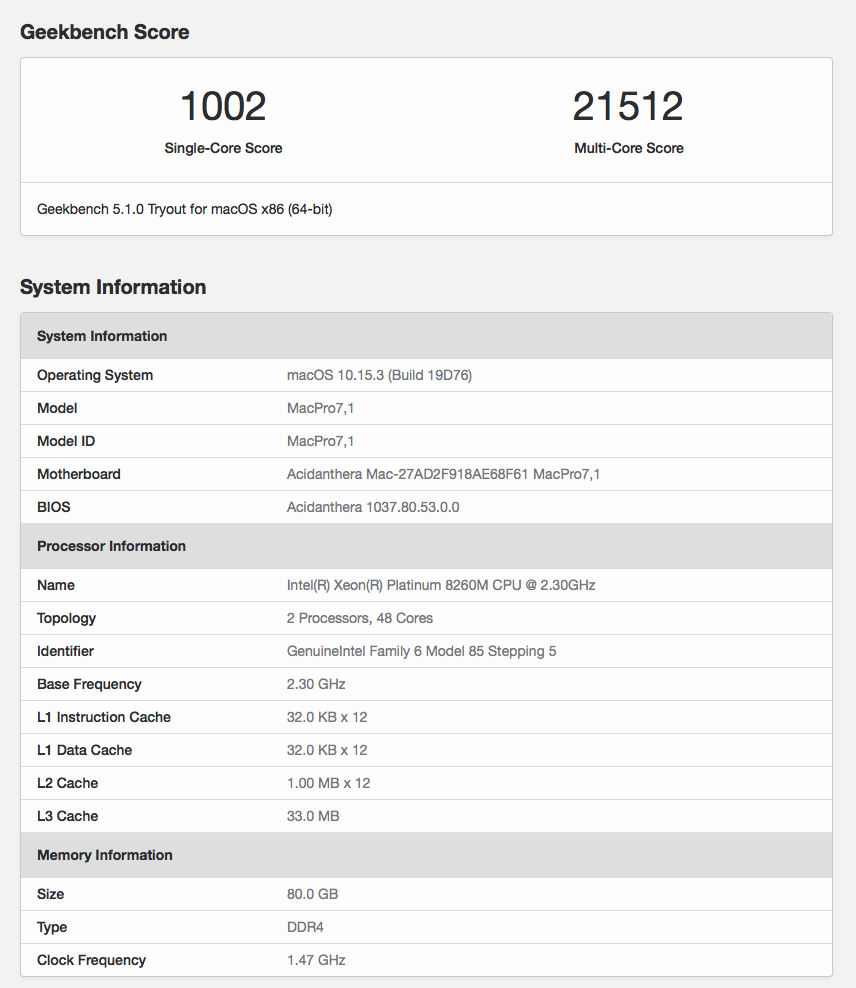

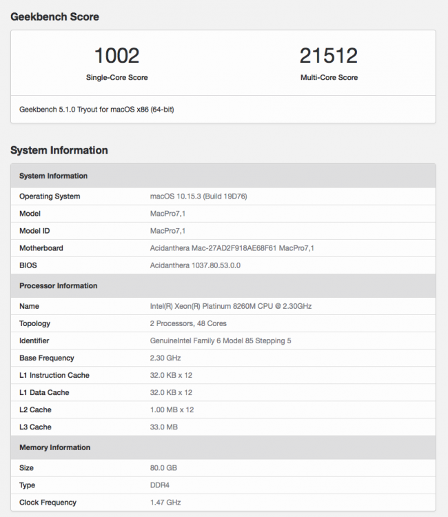

metacollin Posted February 23, 2020 Share Posted February 23, 2020 (edited) In case anyone was wondering, Cascade Lake-SP does in fact work with native power management and HWP on Catalina, no fake cpuid needed. Even missing the last 2 sticks of RAM, leaving 2 memory channels empty and preventing full interleaving (due to an unbalanced memory topology), which is causing substantially degraded memory performance at the moment, it didn't matter. I still handily crushed the top-tier Mac Pro's multicore Geekbench 5 score (19172): https://browser.geekbench.com/v5/cpu/1288154 Once those last 2 sticks come in the mail, I expect ~800-1000 more points on the multicore score. Also, @eritius, I added support for the C620 series audio to AppleALC and have audio for our motherboards working. It isn't in the most recent release, but if you download the latest source from github and compile AppleALC and just use this ssdt, full working audio is yours: /* * Intel ACPI Component Architecture * AML/ASL+ Disassembler version 20180427 (64-bit version)(RM) * Copyright (c) 2000 - 2018 Intel Corporation * * Disassembling to non-symbolic legacy ASL operators * * Disassembly of iASLmnVdyy.aml, Sun Feb 23 11:22:44 2020 * * Original Table Header: * Signature "SSDT" * Length 0x000000D8 (216) * Revision 0x01 * Checksum 0x28 * OEM ID "toleda" * OEM Table ID "amicavs1" * OEM Revision 0x00003000 (12288) * Compiler ID "INTL" * Compiler Version 0x20180427 (538444839) */ DefinitionBlock ("", "SSDT", 1, "toleda", "amicavs1", 0x00003000) { External (_SB_.PC00, DeviceObj) // (from opcode) External (_SB_.PC00.CAVS._ADR, IntObj) // (from opcode) Scope (\_SB.PC00) { Device (HDEF) { Name (_ADR, 0x001F0003) // _ADR: Address Method (_INI, 0, NotSerialized) // _INI: Initialize { Store (Zero, \_SB.PC00.CAVS._ADR) } Method (_PRW, 0, NotSerialized) // _PRW: Power Resources for Wake { Return (Package (0x02) { 0x0D, 0x05 }) } Method (HDEF._DSM, 4, NotSerialized) // _DSM: Device-Specific Method { If (LEqual (Arg2, Zero)) { Return (Buffer (One) { 0x03 }) } Return (Package (0x04) { "layout-id", Buffer (0x04) { 0x01, 0x00, 0x00, 0x00 }, "PinConfigurations", Buffer (Zero){} }) } } } } Edited February 23, 2020 by metacollin 2 Link to comment Share on other sites More sharing options...

aprilnine Posted February 24, 2020 Share Posted February 24, 2020 On 2/23/2020 at 8:13 PM, metacollin said: In case anyone was wondering, Cascade Lake-SP does in fact work with native power management and HWP on Catalina, no fake cpuid needed. Even missing the last 2 sticks of RAM, leaving 2 memory channels empty and preventing full interleaving (due to an unbalanced memory topology), which is causing substantially degraded memory performance at the moment, it didn't matter. Hi metacollin, can you help me with my hackintosh setup? I have a quite similar board as you (X11DPH-T) and run it with two Xeon 6142 Gold processors. It seems you solved the very same problems I'm having with the setup. I've tried my best to patch up the aml:s, but nothing seems to work. Looks like I can't get the EC running since I get no USB (observed from keyboard lights). Attached are my EFI folders and DSDT dump. Any help would be greatly appreciated DSDT.dsl EFI.zip Link to comment Share on other sites More sharing options...
