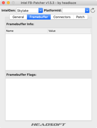

SavageAUS Posted October 23, 2018 Share Posted October 23, 2018 (edited) 38 minutes ago, headkaze said: I agree, done. Unless i got an old version the version number didnt change from 1.5.2 > 1.5.3 Edited October 23, 2018 by SavageAUS Link to comment https://www.insanelymac.com/forum/topic/334899-intel-framebuffer-patching-using-whatevergreen/page/9/#findComment-2642542 Share on other sites More sharing options...
headkaze Posted October 23, 2018 Author Share Posted October 23, 2018 1 minute ago, SavageAUS said: Unless i got an old version the version number didnt change from 1.5.2 > 1.5.3 Add "?1234" to the end of the download link to force a non-cached version. Link to comment https://www.insanelymac.com/forum/topic/334899-intel-framebuffer-patching-using-whatevergreen/page/9/#findComment-2642543 Share on other sites More sharing options...
SavageAUS Posted October 23, 2018 Share Posted October 23, 2018 12 minutes ago, headkaze said: Add "?1234" to the end of the download link to force a non-cached version. Adding that did not work but i did manage to get the new version. And to add, I now have HDMI working as it should. The only remaining issue which i am waiting for vit to look at is disabling the nvidia card. Link to comment https://www.insanelymac.com/forum/topic/334899-intel-framebuffer-patching-using-whatevergreen/page/9/#findComment-2642544 Share on other sites More sharing options...

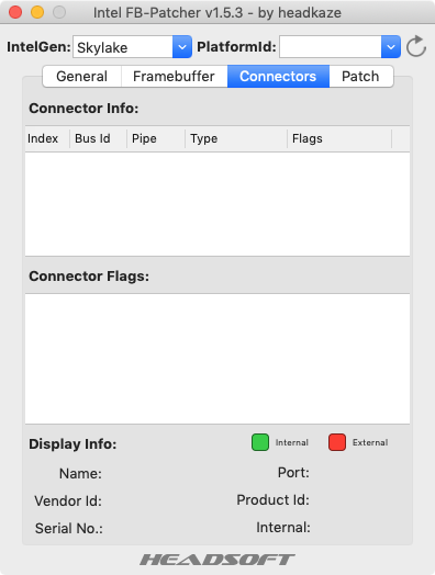

SavageAUS Posted October 23, 2018 Share Posted October 23, 2018 Is it normal to not get any info on some pages on my desktop? (In signature) Like no platformid? iGPU is enabled but i'm using my RX580. Link to comment https://www.insanelymac.com/forum/topic/334899-intel-framebuffer-patching-using-whatevergreen/page/9/#findComment-2642571 Share on other sites More sharing options...

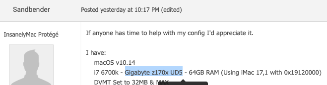

Sandbender Posted October 23, 2018 Share Posted October 23, 2018 (edited) If anyone has time to help with my config I'd appreciate it. I have: macOS v10.14 i7 6700k - Gigabyte z170x UD5 - 64GB RAM (Using iMac 17,1 with 0x19120000) DVMT Set to 32MB & MAX 2K Monitor - HDMI (con1 - type 8) 4K Monitor - DP (con3 - type 4) Lilu 1.2.7 Debug - WhateverGreen 1.2.3 Debug (Note I had a Nvidia 1070 installed but pulled it and removed the web drivers) Issues: 1. With or without Framebuffer patching macOS only recognizes 5MB of framebuffer 2. Both monitors work but they're at 1920x1280 and mirrored (I suspect this is because of the Framebuffer size) 3. I can't get the Framebuffer to dump using (have tried -igfxfbdump and -igfxdump) Any suggestions? clover-sandbender-24Oct18B.zip weglog.txt Edited October 23, 2018 by Sandbender Removed bad device-id setting Link to comment https://www.insanelymac.com/forum/topic/334899-intel-framebuffer-patching-using-whatevergreen/page/9/#findComment-2642664 Share on other sites More sharing options...
headkaze Posted October 23, 2018 Author Share Posted October 23, 2018 (edited) 11 hours ago, SavageAUS said: Is it normal to not get any info on some pages on my desktop? (In signature) Like no platformid? iGPU is enabled but i'm using my RX580. Yes it's normal Skylake data is not stored in local fb kexts anymore. Either use the Framebuffer menu or dump your data using the appropriate WEG boot flags (as per instructions). In future please place your FB-Patcher related questions in the official thread. Edited October 23, 2018 by headkaze Link to comment https://www.insanelymac.com/forum/topic/334899-intel-framebuffer-patching-using-whatevergreen/page/9/#findComment-2642681 Share on other sites More sharing options...
headkaze Posted October 23, 2018 Author Share Posted October 23, 2018 (edited) 1 hour ago, Sandbender said: DVMT Set to 32MB & MAX DVMT pre-alloc set to 32MB? You will need to patch for it then. 19MB stolenmem / 9MB fbmem framebuffer-stolenmem <00003001> framebuffer-fbmem <00009000> Edited October 23, 2018 by headkaze Link to comment https://www.insanelymac.com/forum/topic/334899-intel-framebuffer-patching-using-whatevergreen/page/9/#findComment-2642682 Share on other sites More sharing options...

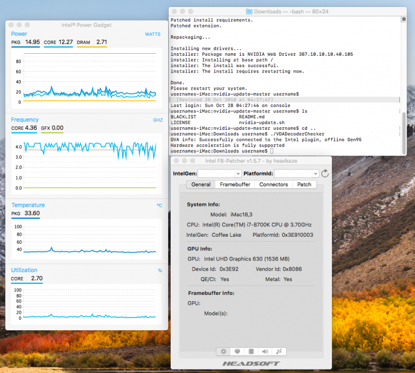

proresettt Posted October 26, 2018 Share Posted October 26, 2018 (edited) Hey everyone, hoping someone can help with this - I have been pulling my hair out for weeks trying to figure it out. I am building a video editing rig for a friend running High Sierra 10.13.6 with the following primary specs: Mobo: Asus Z370-A Prime CPU: Intel i7 8700k GPU: Nvidia 1070Ti The intention is for primary video out via the 1070TI (I now realise I should have gone ATI, but that is beside the point) with the onboard UHD 630 for compute tasks (aka quick sync). I have tried a whole lot of things to get the onboard UHD 630 working with quick sync to no avail. I have tried using the standard 10.13.6 build with a Mac18,3 SMBIOS and Clover Devices properties to set a Kaby Lake IGPU with platform-id 0x59120000, but whatever I try I get the following error during boot and the IGPU isn't recognised: [IGPU] Graphics driver failed to load: could not register with Framebuffer driver! I have currently got the IGPU half-working, in that it is recognised during boot and can be used for video output, by setting SMBIOS platform to MacbookPro15,1, installing Mac OS 10.13.6 (MacBookPro15 build 17G2208) and using platform-id 0x3E920007. Unfortunately when I check with VDADecoderChecker I get the following error: VDADecoderCreate failed. err: -12473 An error was returned by the decoder layer. This may happen for example because of bitstream/data errors during a decode operation. This error may also be returned from VDADecoderCreate when hardware decoder resources are available on the system but currently in use by another process. I would try with Mojave as I know it has better native support for the UHD 630 but the lack of Nvidia Cuda drivers is a dealbreaker just now. I have attached my current EFI folder (with some SMBIOS stuff stripped). I would definitely prefer to get this working with a faked Kaby Lake platform-id if I can, as then I would be able to use an iMac18,3 SMBIOS. I have also attached an IORegistry output. If anyone has any thoughts or comments they would be much appreciated, as I really want to get this finished so my friend can get to video editing! Thanks! EFI.zip ioregistry.zip Edited October 26, 2018 by proresettt Link to comment https://www.insanelymac.com/forum/topic/334899-intel-framebuffer-patching-using-whatevergreen/page/9/#findComment-2643267 Share on other sites More sharing options...
Andrey1970 Posted October 26, 2018 Share Posted October 26, 2018 (edited) @proresettt Use model iMac18,3. Delete Devices-Properties. Set Nvidia of the first in Bios. Set DVMT: 32MB. Set DVMT Total: Max. Build 17G2208 does not contain CFL framebuffer "0 connectors". You need to replace AppleIntelCFLGraphicsFramebuffer.kext on same from Mojave. The framebuffer "0 connectors" will be injected automatically by means of WEG. 10.14_AppleIntelCFLGraphicsFramebuffer.kext.zip Edited October 26, 2018 by Andrey1970 2 Link to comment https://www.insanelymac.com/forum/topic/334899-intel-framebuffer-patching-using-whatevergreen/page/9/#findComment-2643321 Share on other sites More sharing options...
proresettt Posted October 28, 2018 Share Posted October 28, 2018 @Andrey1970 Thanks so much! Using model iMac18,3 on a fresh install of 17G2208 and removing Device-Properties + replacing that Kext did the trick. Now I have both Nvidia and UHD 630 recognised with Quicksync support! Even sleep is working, which previously would always KP when trying to wake. Just one question - replacing the native kext by dropping the replacement into /EFI/CLOVER/kexts/Other didn't seem to work. I had to replace the native kext in /System/Library/Extensions and rebuild the kext cache (which is not ideal as it will probably get replaced by system updates). Is there a way to force macOS to preferentially load that kext from EFI rather than /S/L/E? If not then it's OK, I will just need to write a script for my friend that replaces that specific kext and rebuilds caches in the event he installs any macOS system updates that replace the Mojave kext. Thanks again - this has really been a rollercoaster of emotions repeatedly trying (and failing) to get it working. Link to comment https://www.insanelymac.com/forum/topic/334899-intel-framebuffer-patching-using-whatevergreen/page/9/#findComment-2643532 Share on other sites More sharing options...

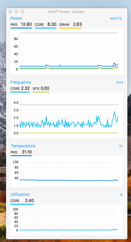

SavageAUS Posted October 28, 2018 Share Posted October 28, 2018 [mention=1202492]Andrey1970[/mention] Thanks so much! Using model iMac18,3 on a fresh install of 17G2208 and removing Device-Properties + replacing that Kext did the trick. Now I have both Nvidia and UHD 630 recognised with Quicksync support! Even sleep is working, which previously would always KP when trying to wake. Just one question - replacing the native kext by dropping the replacement into /EFI/CLOVER/kexts/Other didn't seem to work. I had to replace the native kext in /System/Library/Extensions and rebuild the kext cache (which is not ideal as it will probably get replaced by system updates). Is there a way to force macOS to preferentially load that kext from EFI rather than /S/L/E? If not then it's OK, I will just need to write a script for my friend that replaces that specific kext and rebuilds caches in the event he installs any macOS system updates that replace the Mojave kext. Thanks again - this has really been a rollercoaster of emotions repeatedly trying (and failing) to get it working. Off topic sorry. Do you cpu pm working? Looks like your cpu always high usage. Sent from my iPhone using Tapatalk Link to comment https://www.insanelymac.com/forum/topic/334899-intel-framebuffer-patching-using-whatevergreen/page/9/#findComment-2643549 Share on other sites More sharing options...
proresettt Posted October 28, 2018 Share Posted October 28, 2018 24 minutes ago, SavageAUS said: Off topic sorry. Do you cpu pm working? Looks like your cpu always high usage. Sent from my iPhone using Tapatalk Yeah I was doing other stuff in the background when I took that first grab. Seems to be working OK only using PluginType in clover ACPI config and nothing else. This is what it looks like when system is left idle. Link to comment https://www.insanelymac.com/forum/topic/334899-intel-framebuffer-patching-using-whatevergreen/page/9/#findComment-2643553 Share on other sites More sharing options...

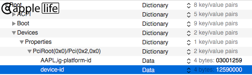

Andrey1970 Posted October 28, 2018 Share Posted October 28, 2018 2 hours ago, proresettt said: @Andrey1970 Thanks so much! Using model iMac18,3 on a fresh install of 17G2208 and removing Device-Properties + replacing that Kext did the trick. Now I have both Nvidia and UHD 630 recognised with Quicksync support! Even sleep is working, which previously would always KP when trying to wake. Just one question - replacing the native kext by dropping the replacement into /EFI/CLOVER/kexts/Other didn't seem to work. I had to replace the native kext in /System/Library/Extensions and rebuild the kext cache (which is not ideal as it will probably get replaced by system updates). Is there a way to force macOS to preferentially load that kext from EFI rather than /S/L/E? If not then it's OK, I will just need to write a script for my friend that replaces that specific kext and rebuilds caches in the event he installs any macOS system updates that replace the Mojave kext. Thanks again - this has really been a rollercoaster of emotions repeatedly trying (and failing) to get it working. From EFI this kext is loaded will not be. Replace kext is necessary. But it is possible to use masking under KBL and a frame of "0 connectors" as for KBL. device-id 12590000 AAPL,ig-platform-id 03001259 Then replace kext is not required and there will be no problems with updates. 1 Link to comment https://www.insanelymac.com/forum/topic/334899-intel-framebuffer-patching-using-whatevergreen/page/9/#findComment-2643569 Share on other sites More sharing options...
proresettt Posted October 28, 2018 Share Posted October 28, 2018 1 minute ago, Andrey1970 said: From EFI this kext is loaded will not be. Replace kext is necessary. But it is possible to use masking under KBL and a frame of "0 connectors" as for KBL. device-id 12590000 AAPL,ig-platform-id 03001259 Then replace kext is not required and there will be no problems with updates. Thank you again very much! I will try this on a fresh install shortly after I have finished doing some benchmarking. This community is the best! Link to comment https://www.insanelymac.com/forum/topic/334899-intel-framebuffer-patching-using-whatevergreen/page/9/#findComment-2643570 Share on other sites More sharing options...

proresettt Posted October 30, 2018 Share Posted October 30, 2018 (edited) @Andrey1970 Just wanna say that the device-id and AAPL;ig-platform-id worked perfectly. I now have the IGPU recognised with quick-sync capabilities on a native standard (non 17G2208) build of macOS. Thank you so much again! I want to add some search keywords incase anyone else is struggling with this: Whatevergreen 8700k UHD 630 device-id ig-platform-id High Sierra 10.13.6 Hopefully this can also help some others who arrive via search engine as this is a long thread to scan through. Is there anywhere I can donate to your dev efforts? Happy to send you some crypto or something. благодарю вас! Edited October 30, 2018 by proresettt 1 Link to comment https://www.insanelymac.com/forum/topic/334899-intel-framebuffer-patching-using-whatevergreen/page/9/#findComment-2644120 Share on other sites More sharing options...
