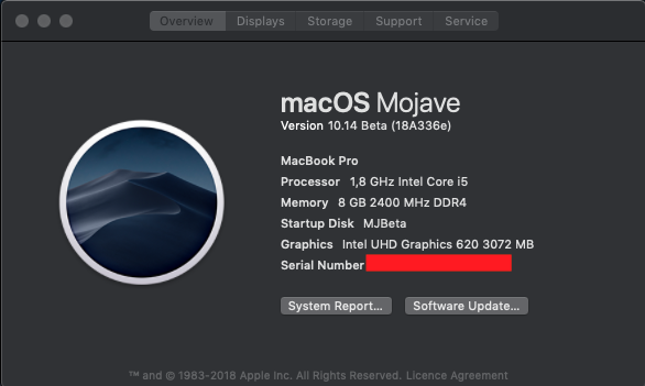

I'm having the same problem as you. My laptop has a KBL HD 620 and an eDP connector and no matter what I try I can't get the internal display working with the kaby lake framebuffer driver. Only brightness works and turning off cnconnectoralwaysenabled doesn't help in any way. What if I fake coffee lake ig-platform-id and fakeid intelgfx? Which id's to use?
I've tried faking as coffee lake and it did me no good. I tried 5-6 different coffee lake platform IDs and still just booted without QE/CI. Mine is the device ID issue. No matter what it will not allow me to take a different device ID. Mine is 59178086. And I need 59168086 for the uhd620. Anytime I add a device ID to clover/properties it locks at IOScreenLockState

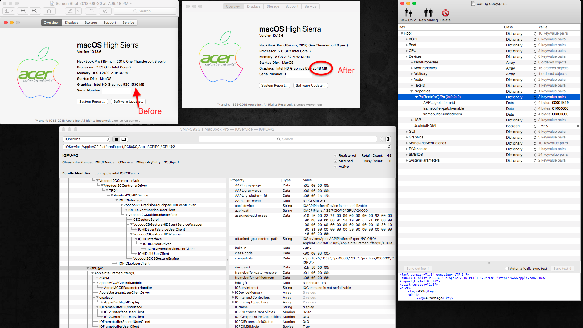

I gave the new FBpatcher a whirl. Awesome application. But when in add my Framebuffer_9_18.0 file and go to dvmt32 patching and allow for auto generate. It only creates a platformID, Device ID and a Connector Patch. Thats it.
AppleIntelFramebuffer_9_18.0
Do you have VRAM ticked under Patch->General?

No matter what I cannot get kbl drivers to load. Ive got dvmt32 set and device ID and platformID set and still lock at IOScreenLockState. DeviceID does it Everytime. If I remove deviceID I can boot without QE/CI. I'm using device ID 16590000.
Sent from my ONEPLUS A5010 using Tapatalk
I figured it out. Had a brain fart lol. Still doesn't seem to make a difference for my igpu. Still no QE/CI
Your CPU it technically Coffee Lake (That's 8th gen as in 8850u). Perhaps you could try the new Lilu option to force Kaby Lake CPU (lilucpu=7)?

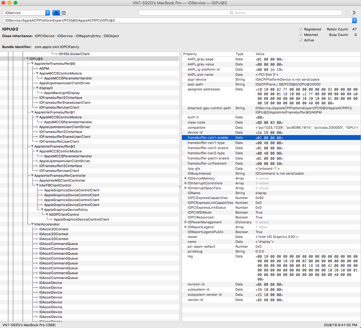

Hello headkaze et al.,
I have a Lenovo M93p mini-tower with an i5-4460 Haswell processor a monitor attached to the display port connector build from scratch with High Sierra and Clover.
If I boot without graphics acceleration (for instance with a dummy ig-platform-id), then my screen is detected and works properly but without acceleration (AppleIntelFramebufferAzul.kext and AppleIntelHD5000Graphics.kext not loaded)
But if I don't prevent these kexts from loading, then I have the following error messages:
- busy timeout, (60s) 'IGPU' 4 times
-gIOScreenLockState 3, hs 0, bs 0, now 0, sm 0x0 5 times
and the system ends-up booting with the screen remaining in text log mode, but I can Screen Share into the system and see that AppleIntelFramebufferAzul.kext and AppleIntelHD5000Graphics.kext are loaded and the video has the expected 1536 MB of memory.
When I let the system boot all the way (waiting over 5') and connect via screen sharing, the system doesn't have any EDID data (ioreg -l | grep "IODisplayEDID" returns… nothing - not even an error.)
I am attaching my IOreg output as well as my config.plist (without SNs and UUIDs) and the glog.txtw. Here are also the details of my configuration:
- Lenovo M93p mini tower with Intel Q87 chipset
- i5-4460 processor
- using onboard graphics, with Dell monitor connected to the display port
- Clover, macOS 10.13.6 post install with ##### 10.4.0
debug versions of Lilu + WhateverGreen (built with your script) both in L/E and in EFI/Clover/kexts/Other
Obviously, everything works fine under Windows 10 and Ubuntu 16.04.
My guess at this stage is that Lenovo is using a non standard mapping of its connectors and that my DisplayPort connected screen is not "seen" by the Apple driver  (I also tried with two screens on on each DisplayPort of the system: non detected).
I would be grateful for any help to make the screens work because everything else is functional under macOS and this would be a neat system.

I am testing in 10.13.6. Video patch works great! I can get 4k functionality and it is something I am not aware of from my HD530 laptop!
I am still getting around HDMI and DP audio, tho. Any write-up on audio yet?
Thanks in advance and awesome work!
