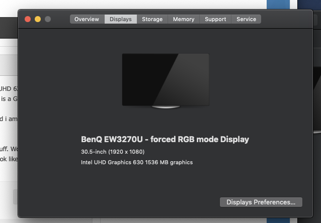

On 11/4/2019 at 4:57 AM, Andrey1970 said:
Read a manual: https://github.com/acidanthera/WhateverGreen/blob/master/Manual/FAQ.IntelHD.en.md
UHD620 0x5917 not native, use 0x5916
Delete # in device-id and set 16590000
Have it working now thanks to the two simple settings you suggested, but still have black screen on wake. Could you point me what to read about that? So far I found some guidelines, tried to follow but with no success:

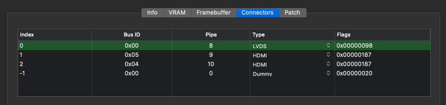

According to the ioreg and weg log, there are: unknown connector 0, hdmi connector 1 and dp connector 2. There's also connector 3, dunno what is it:

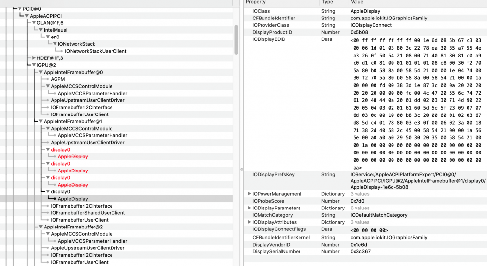

EDIT : I see what happened the configs injection for port 1 where the HDMI cable plugged in
had a pound sign in front that canceled it. The ioreg was showing DP on that port!
Thanks again for all the help and good work.

I am running a 4k display (BenQ EW3270U) on a hack-mac using i5 8600k with UHD 630 graphics using an HDMI 2.0 cable. The operating system is macOS 10.14.6 Mojave, the mainboard is a Gigabyte Z370 HD3.
Unfortunately, 4k does not work on my device currently the way I've set it up and i am starting to think, that the fix is discussed in this thread.
Is that a plausible assumption? I am gonna start playing with this frame buffer stuff. Would you please let me know, what software you use to display/edit your config.plist files? It does not look like clover to me. I'd appreciate that, thank you.
