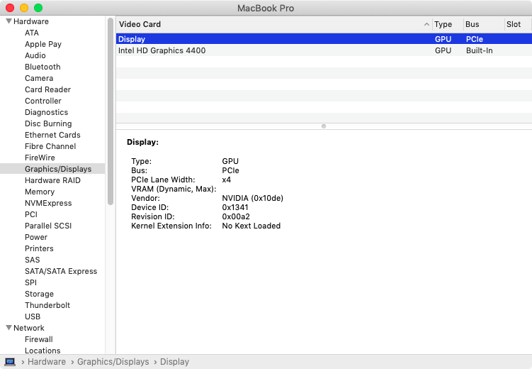

SavageAUS Posted October 22, 2018 Share Posted October 22, 2018 (edited) Add device-id 12040000 That solved that issue. Now to disable the nvidia card and test hdmi and see if I need to disable any ports etc. Do we still need boot flag nv_disable with WEG? EDIT: Im not sure if anything else needs patching yet. I havnt tested HDMI yet. Is WEG meant to disable the nvidia card in my laptop because it doesn't (disabled now with ssdt) Attached is ioreg, config and AppleIntelFramebuffer_6_18.2 Edit2: HDMI is not working, previously I was using fakepci hdmi kext. As soon as I plug in a hdmi cable my laptop goes all laggy, mouse barely moves and outputs nothing to external display. Was working before the change to WEG for framebuffer. Sent from my iPhone using Tapatalk framebuffer.zip Edited October 22, 2018 by SavageAUS Link to comment https://www.insanelymac.com/forum/topic/334899-intel-framebuffer-patching-using-whatevergreen/page/8/#findComment-2642321 Share on other sites More sharing options...

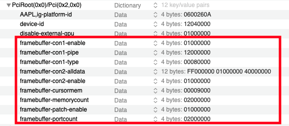

Andrey1970 Posted October 22, 2018 Share Posted October 22, 2018 (edited) 3 hours ago, SavageAUS said: That solved that issue. Now to disable the nvidia card and test hdmi and see if I need to disable any ports etc. Do we still need boot flag nv_disable with WEG? EDIT: Im not sure if anything else needs patching yet. I havnt tested HDMI yet. Is WEG meant to disable the nvidia card in my laptop because it doesn't (disabled now with ssdt) Attached is ioreg, config and AppleIntelFramebuffer_6_18.2 Edit2: HDMI is not working, previously I was using fakepci hdmi kext. As soon as I plug in a hdmi cable my laptop goes all laggy, mouse barely moves and outputs nothing to external display. Was working before the change to WEG for framebuffer. Sent from my iPhone using Tapatalk framebuffer.zip I remade your patches from Clover in WEG. config.plist.zip Edited October 22, 2018 by Andrey1970 Link to comment https://www.insanelymac.com/forum/topic/334899-intel-framebuffer-patching-using-whatevergreen/page/8/#findComment-2642359 Share on other sites More sharing options...

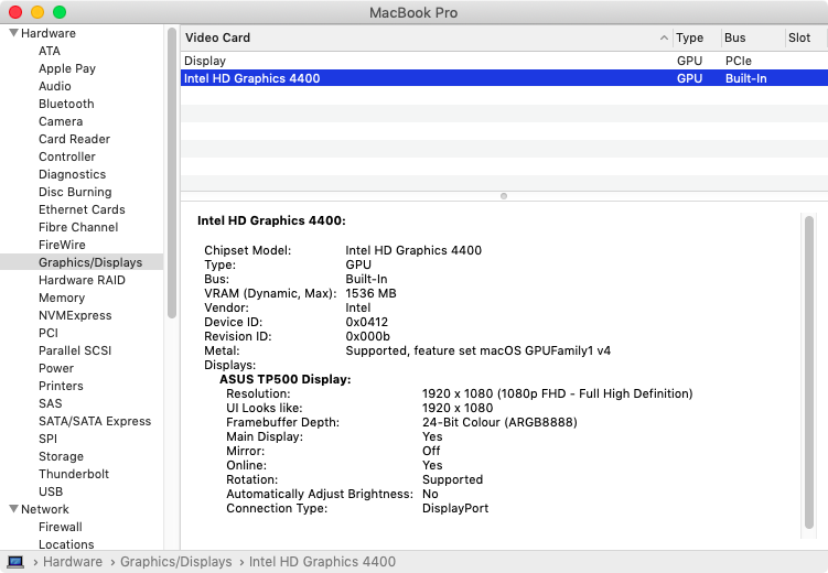

SavageAUS Posted October 22, 2018 Share Posted October 22, 2018 (edited) 58 minutes ago, Andrey1970 said: I remade your patches from Clover in WEG. config.plist.zip Thanks, added. Rebooting to test now. Yet to test HDMI, will update post when i do. Nvidia GPU still unable to disable. Edited October 22, 2018 by SavageAUS Link to comment https://www.insanelymac.com/forum/topic/334899-intel-framebuffer-patching-using-whatevergreen/page/8/#findComment-2642362 Share on other sites More sharing options...
Andrey1970 Posted October 22, 2018 Share Posted October 22, 2018 14 minutes ago, SavageAUS said: Thanks, added. Rebooting to test now. Yet to test HDMI, will update post when i do. Nvidia GPU still unable to disable. Use disable nvidia from ssdt. WEG disable not always works. Link to comment https://www.insanelymac.com/forum/topic/334899-intel-framebuffer-patching-using-whatevergreen/page/8/#findComment-2642367 Share on other sites More sharing options...
SavageAUS Posted October 22, 2018 Share Posted October 22, 2018 Use disable nvidia from ssdt. WEG disable not always works.Ok thanks for the info. I’ll keep searching how to enable hdmi and how to convert kexttopatch to WEG. Sent from my iPhone using Tapatalk Link to comment https://www.insanelymac.com/forum/topic/334899-intel-framebuffer-patching-using-whatevergreen/page/8/#findComment-2642370 Share on other sites More sharing options...
Andrey1970 Posted October 22, 2018 Share Posted October 22, 2018 (edited) 2 hours ago, SavageAUS said: Ok thanks for the info. I’ll keep searching how to enable hdmi and how to convert kexttopatch to WEG. Sent from my iPhone using Tapatalk Here full equivalent of patches AzulPatcher4600. config.plist.zip Edited October 22, 2018 by Andrey1970 update config.plist Link to comment https://www.insanelymac.com/forum/topic/334899-intel-framebuffer-patching-using-whatevergreen/page/8/#findComment-2642397 Share on other sites More sharing options...

Andrey1970 Posted October 22, 2018 Share Posted October 22, 2018 (edited) 40 minutes ago, SavageAUS said: Will these work for HD4400 as well? Yes of course. You wrote that used AzulPatcher4600 earlier. Pay attention: AzulPatcher4600 or this equivalent patches are made specially only for AAPL,ig-platform-id 0600260A You can check my equivalent patches, having compared them to patches in the source code. Edited October 22, 2018 by Andrey1970 Link to comment https://www.insanelymac.com/forum/topic/334899-intel-framebuffer-patching-using-whatevergreen/page/8/#findComment-2642502 Share on other sites More sharing options...
SavageAUS Posted October 23, 2018 Share Posted October 23, 2018 Yes of course. You wrote that used AzulPatcher4600 earlier. Pay attention: AzulPatcher4600 or this equivalent patches are made specially only for AAPL,ig-platform-id 0600260A You can check my equivalent patches, having compared them to patches in the source code.I think that was@Dragster27 who was using AzulPatcher4600Sent from my iPhone using Tapatalk Link to comment https://www.insanelymac.com/forum/topic/334899-intel-framebuffer-patching-using-whatevergreen/page/8/#findComment-2642518 Share on other sites More sharing options...

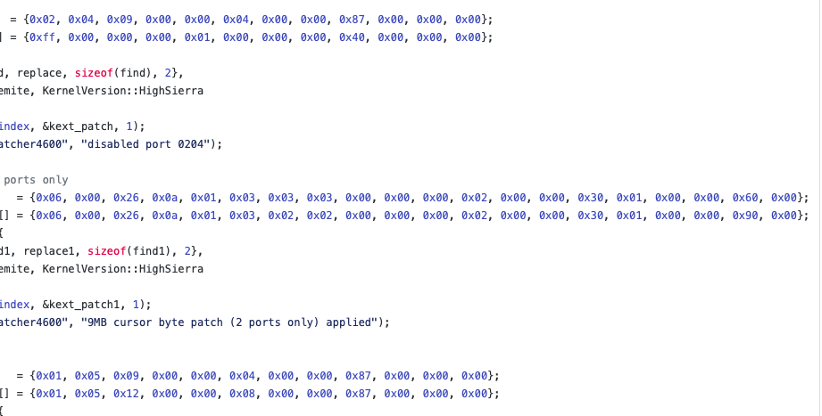

SavageAUS Posted October 23, 2018 Share Posted October 23, 2018 Also how do i go about converting these 2 patches to use into WEG? <dict> <key>Comment</key> <string>0x0a260006 disable 0204 port, change 0105 DP port to 0204 HDMI (RehabMan)</string> <key>Disabled</key> <true/> <key>Find</key> <data>AQUJAAAEAACHAAAAAgQJAAAEAACHAAAA</data> <key>InfoPlistPatch</key> <false/> <key>Name</key> <string>AppleIntelFramebufferAzul</string> <key>Replace</key> <data>AgQJAAAIAACHAAAA/wAAAAEAAABAAAAA</data> </dict> <dict> <key>Comment</key> <string>Enable 9MB cursor bytes, 0x0a260006</string> <key>Disabled</key> <true/> <key>Find</key> <data>BgAmCgEDAwMAAAACAAAwAQAAYAA=</data> <key>InfoPlistPatch</key> <false/> <key>Name</key> <string>com.apple.driver.AppleIntelFramebufferAzul</string> <key>Replace</key> <data>BgAmCgEDAwMAAAACAAAwAQAAkAA=</data> </dict> They are only disabled to get working with WEG. Link to comment https://www.insanelymac.com/forum/topic/334899-intel-framebuffer-patching-using-whatevergreen/page/8/#findComment-2642534 Share on other sites More sharing options...
headkaze Posted October 23, 2018 Author Share Posted October 23, 2018 (edited) 1 hour ago, SavageAUS said: Also how do i go about converting these 2 patches to use into WEG? I've just uploaded a new version of Intel FB-Patcher. It has a new menu item Patch->AzulPatcher4600 The two patches you have are basically the same as AzulPatcher4600 but with an additional step. So here are some instructions: 1. Run Intel FB-Patcher and select Patch->AzulPatcher4600 2. Select Patch->Import KextsToPatch and enter: Find: 010509000004000087000000 Replace: 020409000008000087000000 3. File->Export->Clover config.plist (overwrite your existing one) Edited October 23, 2018 by headkaze 1 Link to comment https://www.insanelymac.com/forum/topic/334899-intel-framebuffer-patching-using-whatevergreen/page/8/#findComment-2642536 Share on other sites More sharing options...
