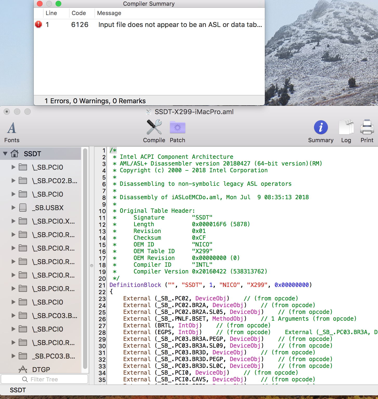

I am getting a lot of error trying to implement it with you original ssdt. can you please compile it and send it to me. thanks.1222592362_ScreenShot2018-07-09at8_43_30AM.thumb.png.128f0c560a16d6c48fdbecce01bc47f0.png

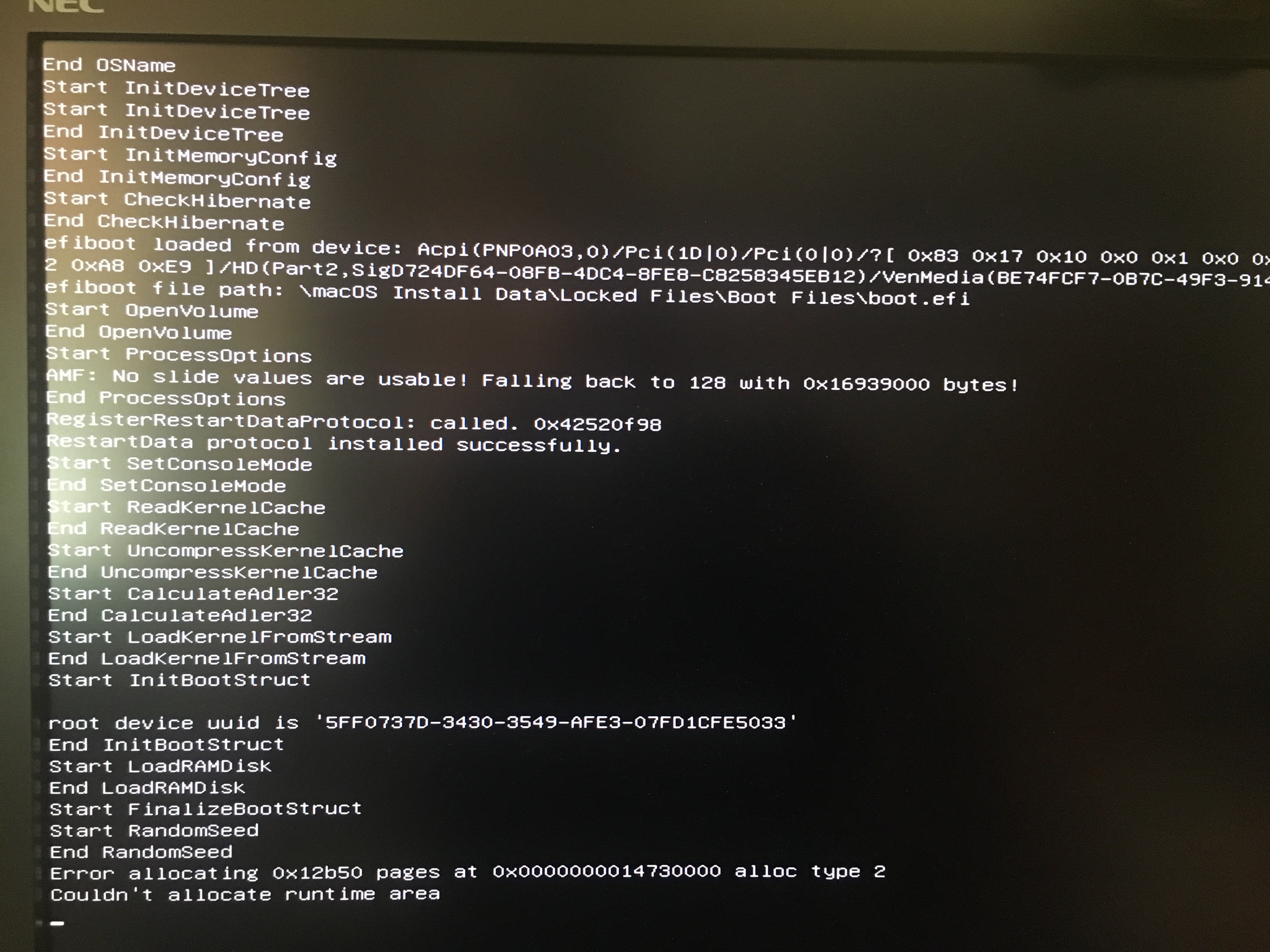

I'm trying to upgrade from (my perfectly stable) 10.13.4 to 10.13.6 but I get stuck with 'couldn't allocate runtime area' errors when I boot the the upgrade installer. The same EFI folder boots 10.13.4 perfectly fine. So then I thought I'd try the latest EFI folder from this thread: same error. Latest EFI folder with the full 10.13.6 installer: same error. Now, the guide on page 1 mentions the OsxAptioFix3Drv-64.efi but the latest 10.13.6 EFI folder does not contain that one. So I am a bit puzzled which driver to use, and why my 10.13.4 boots ok, but the upgrader doesn't. Any suggestions ???
13 hours ago, Peerke said:
Hi all,

Hi KGP-imacPro,
Sorry, I should have mentioned that I am using AptiomemoryFix.efi. I had tried OsxAptioFix3Drv-64.efi as well, but that gave similar result. This is the screen I am getting when booting the upgrade installer or the full 10.13.6 installer. I have also enclosed my EFI folder. The Clover I am using is 4449, but I get the same with 4617. If you can have a look at the EFI folder, I'd really appreciate it. Vielen dank.
EFI.zip
5 hours ago, Peerke said:
Hi KGP-imacPro,
EFI.zip

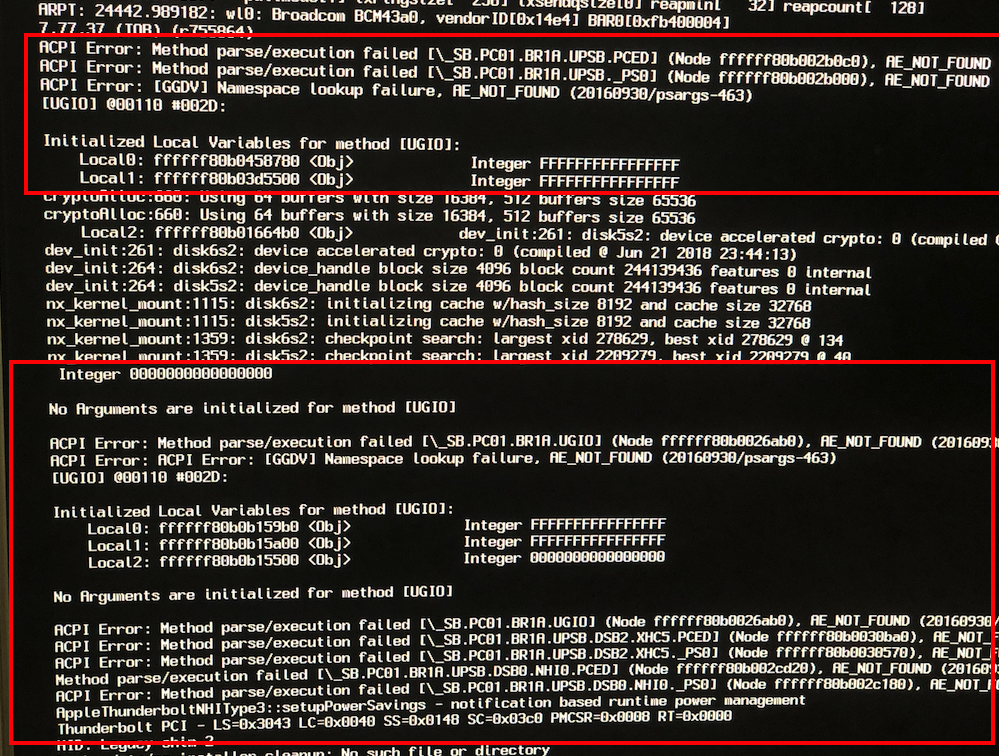

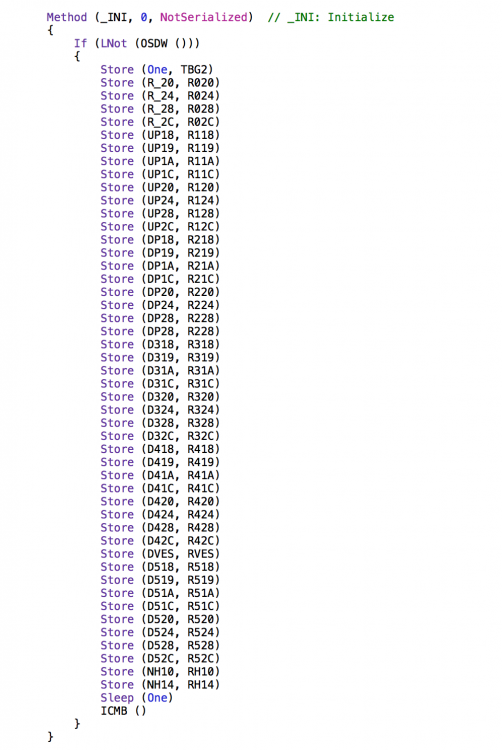

Remaining key problem for new hopefully successful TB implementation..
40781109_ScreenShot2018-08-04at18_52_37.thumb.png.5a10fb1aefb32865dab6058bfd693dd9.png
can somebody help me in solving the remaining key problem with method _INI..
        Name (EICM, Zero)

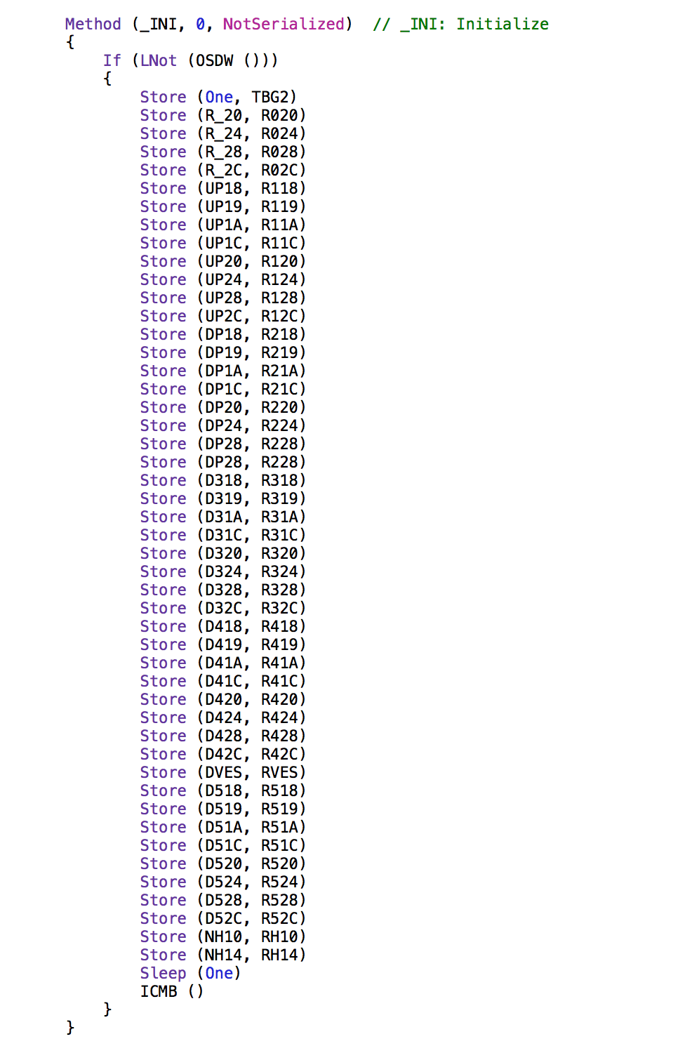

        Method (_INI, 0, NotSerialized)  // _INI: Initialize
            If (LNot (OSDW ()))
                Store (One, TBG2)
                Store (R_20, R020)
                Store (R_24, R024)
                Store (R_28, R028)
                Store (R_2C, R02C)
                Store (UP18, R118)
                Store (UP19, R119)
                Store (UP1A, R11A)
                Store (UP1C, R11C)
                Store (UP20, R120)
                Store (UP24, R124)
                Store (UP28, R128)
                Store (UP2C, R12C)
                Store (DP18, R218)
                Store (DP19, R219)
                Store (DP1A, R21A)
                Store (DP1C, R21C)
                Store (DP20, R220)
                Store (DP24, R224)
                Store (DP28, R228)
                Store (DP28, R228)
                Store (D318, R318)
                Store (D319, R319)
                Store (D31A, R31A)
                Store (D31C, R31C)
                Store (D320, R320)
                Store (D324, R324)
                Store (D328, R328)
                Store (D32C, R32C)
                Store (D418, R418)
                Store (D419, R419)
                Store (D41A, R41A)
                Store (D41C, R41C)
                Store (D420, R420)
                Store (D424, R424)
                Store (D428, R428)
                Store (D42C, R42C)
                Store (DVES, RVES)
                Store (D518, R518)
                Store (D519, R519)
                Store (D51A, R51A)
                Store (D51C, R51C)
                Store (D520, R520)
                Store (D524, R524)
                Store (D528, R528)
                Store (D52C, R52C)
                Store (NH10, RH10)
                Store (NH14, RH14)
                Sleep (One)
                ICMB ()

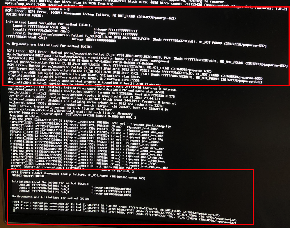

which crashes my TB-SSDT during boot?
In the system DSDT.aml of the iMac Pro dump, I found an additional WAK method to TBG2, but there it becomes really complicated as with PNOT(), also the CPU's get involved, which apparently furthermore requires the integration of nearly the entire iMac Pro DSDT + iMac pro AMLs...
Method _ini.. a short code snippet, which apparently opens Pandora's box...

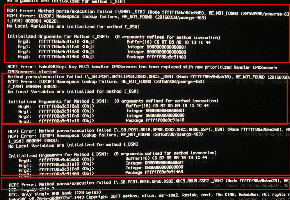

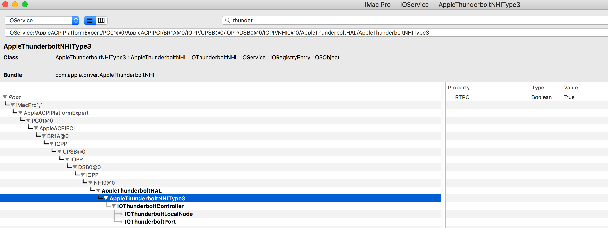

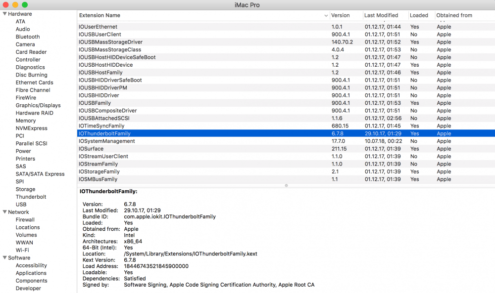

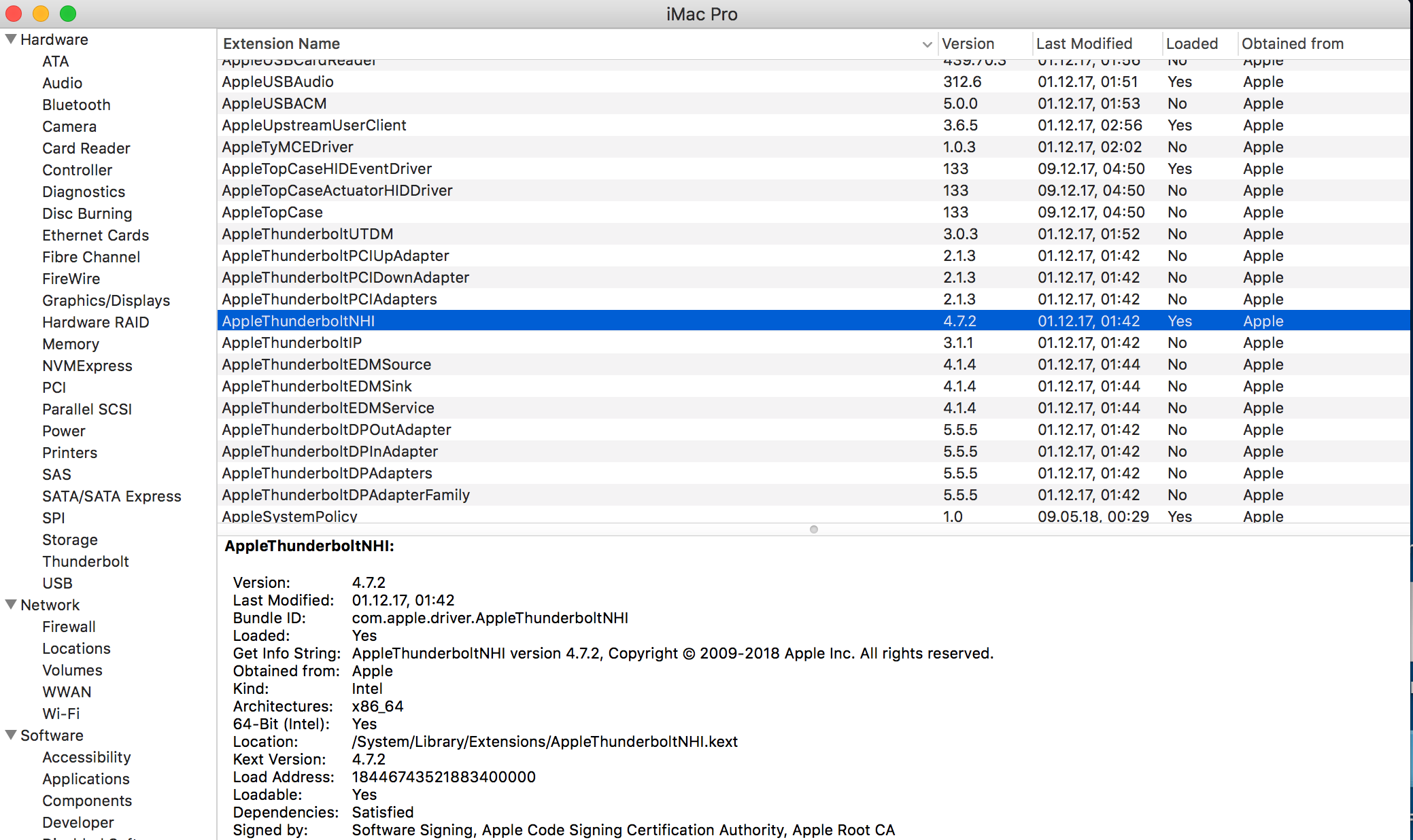

SSDT-9.aml, apparently the one and only key for a complete and successful TB Hackintosh implementation...
In order to demonstrate that I am not yet totally insane with my guesses and ideas, let's demonstrate below that SSDT-9.aml seems to be one of possible cornerstone for reaching full Hackintosh functionality on a iMac Pro Hackintosh system.
However, due to the missing method "_ini" implementation (port and device initialisation/configuration) in SSDT-9.aml and likely also due to other missing Apple iMac Pro SSDT/DSDT ACPI implementations, my modified SSDT-9.aml yet fails in implementing the basic system essentials for a complete TB Hackintosh configuration and results in plenty of ACPI errors, Name Space Lookup failures and variable or argument errors during boot..
Nevertheless, few essential things are added when inspecting IOREG or Apple's system report..

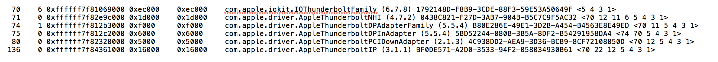

While from the TB-kexts used on a real iMacPro only com.apple.driver.AppleThunderboltNHI.kext is active on our Hackintosh systems, SSDT-9.aml so far also loads at least com.apple.iokit.IOThunderboltFamily.kext.
1874498372_ScreenShot2018-08-05at12_45_06.thumb.png.15bfc841a44aee053ba11c6df6f22c3b.png
1095452198_ScreenShot2018-08-05at12_46_48.thumb.png.d1532ba198f35aa70941e30d6ccb8650.png
However, com.apple.driver.AppleThunderboltDPAdapterFamily, com.apple.driver.AppleThunderboltIP.kext, com.apple.driver.AppleThunderboltDPInAdapter, com.apple.driver.AppleThunderboltPCIDownAdapter remain without function due to frequent ACPI errors (Namespace Lookup errors, argument and variable errors, etc.) during boot, which are supposedly due to the yet missing Method "_ini" (port/device implementation/configuration) in my most actual SSDT-9.aml distribution and lacking related ACPI implementations...
2065633793_ScreenShot2018-08-05at13_01_23.thumb.png.87beb428b8153932d10c508a1a654fb0.png
Most essentially, with my current SSDT-9.aml, also the "RTPC true" entry adds under AppleThuderboltNHIType3..
2115289141_ScreenShot2018-08-05at12_47_31.thumb.png.a9faee1fe71d0817e35a71fd216a55b0.png
One might also find the one or other interesting IOREG add-ons under in all other TB PCI device implementations...
Please find linked here my current AML TB implementations for experts only (!!!), i.e. SSDT9.aml, SSDT-DTPG.amlSSDT-GNVS.amlSSDT-GG/SG-Methods.aml, SSDT-OSDW.aml and SSDT-SBUS.aml,  I also link once more @TheOffcialGypsy 's most recent iMac Pro dump, where you find the original SSDT-9.aml (BTW.. SSDT-10.aml might be noteworthy in addition)  besides the iMac Pro DSDT and other iMacPro SSDT implementations... linked as well the IOREG save of the original iMac Pro...
@TheOfficialGypsy, any more recent dump under 10.13.6 or 10.14 PB4 available?
I guess, it rapidly might become evident that the complexity of the problem apparently exceeds the capacities and knowledge of one single person... What about active collaborators, here online or maybe also within some small local "insitu" and "hands-on" workgroup in the Berlin/Germany area?
@apfelnico, @nmano, or who ever is interested and is able to join this endeavour?
I really don't know if there is any valid chance for a successful SSDT-9.aml Hackintosh TB implementation.. However, we should give it a try..
