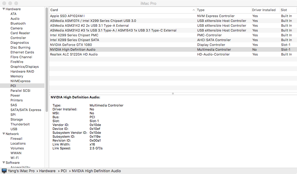

i took the EFI and i added some more amls and now my PCI info is like this:
i tried different ways to get the HDA driver to load but no luck. I have my injector set to 7 i tried the kext replace, but i see you removed it in the new config.plist.
my mouse now works on powerup, but it seems the last several times that i rebooted it needs to be unplugged to work, so strange.
Edited by sensite
I don't understand to which HDA driver you are referring. Following your "PCI" screenshot, the PCI driver for the Realtek ALC S1220A onboard audio controller is properly implemented and loaded.
You seem to have a problem with HDAU though.. The respective PCI driver is not loaded. Usually Whatevergreen.kext fixes this issue. You can try to enable and adopt the com.apple.driver.AppleHDAController kext patch in your config.plist. Replace HEX value in this patch must be system-id under GFX0 apparent in IOREG.
Ah, I didn’t realize whatevergreen would be the problem. I will try without whatevergreen. Thank you!
No you misunderstood.. Whatevergreen.kext is definitely not the problem! The opposite is the case.. Usually Whatevergreen.kext makes the DPI/HDMI HDAU Audio kext patch obsolete, which however does not seem to happen in your case.  That's why you likely have to enable and properly adopt the DPI/HDMI HDAU Audio kext patch for your particular Nvidia GPU.

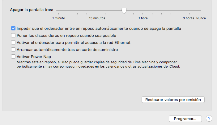

This is a minor problem but I have not found any similar cases. (it's not a sleep and wake problem, this  not a laptop...)
One thing more, all HDD probed are 2T 7200rpm  3,5". Don't probe with 2,5".

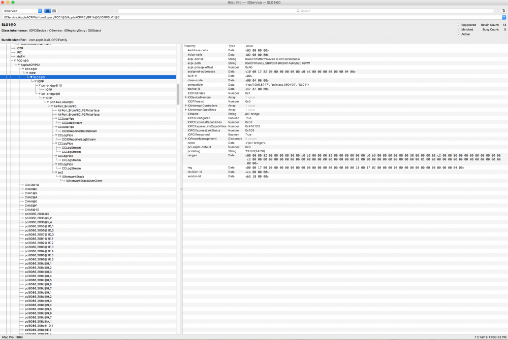

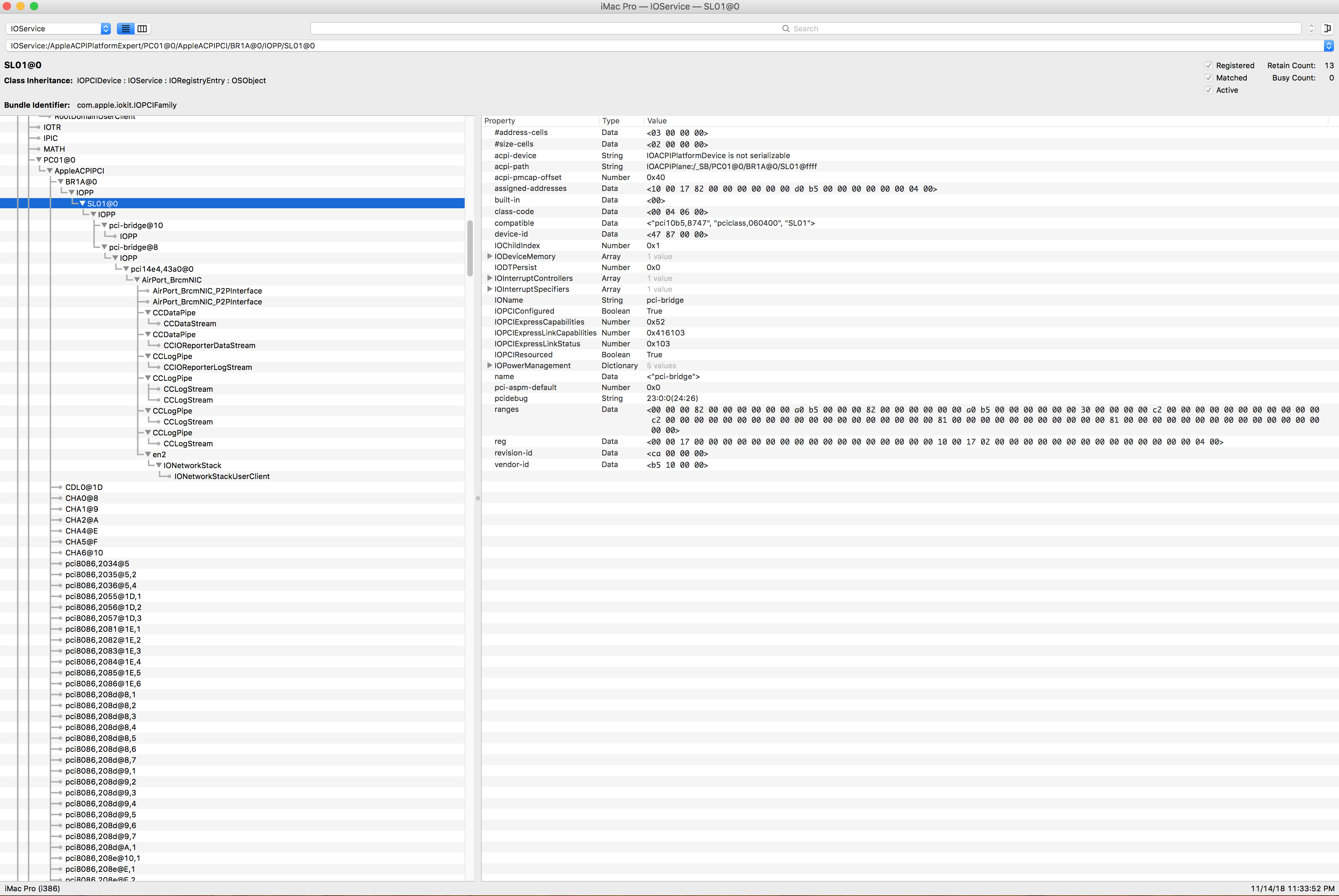

Hey guys I'm kind a stuck on the ARPT SSDT, did I do something wrong?
DefinitionBlock ("", "SSDT", 1, "KGP", "X299ARPT", 0x00000000)
    External (_SB_.PC01.BR1A, DeviceObj)    // (from opcode)
    External (_SB_.PC01.BR1A.PEGP, DeviceObj)    // (from opcode)
    External (_SB_.PC01.BR1A.SL01, DeviceObj)    // (from opcode)
    External (DTGP, MethodObj)    // 5 Arguments (from opcode)
    Scope (_SB.PC01.BR1A)
        Scope (SL01)
            Name (_STA, Zero)  // _STA: Status
        Scope (PEGP)
        Device (ARPT)
            Name (_ADR, Zero)  // _ADR: Address
            Method (_DSM, 4, NotSerialized)  // _DSM: Device-Specific Method
                Store (Package (0x0E)
                        "built-in",
                        Buffer (One)
                             0x00
                        "device-id",
                        Buffer (0x04)
                             0xA0, 0x43, 0x00, 0x00
                        "AAPL,slot-name",
                        Buffer (0x07)
                            "Slot-7"
                        "device_type",
                        Buffer (0x13)
                            "AirPort Controller"
                        "model",
                        Buffer (0x4A)
                            "Broadcom BCM94360CD 802.11 a/b/g/n/ac + Bluetooth 4.0 Controller"
        Scope (SL01)
        Scope (PEGP)
        Device (ARPT)
                        "built-in",
                        Buffer (One)
                             0x00
                        "device-id",
                        Buffer (0x04)
                        "AAPL,slot-name",
                        Buffer (0x07)
                            "Slot-7"
                        "device_type",
                        Buffer (0x13)
                        "model",
                        Buffer (0x4A)
                        "compatible",
                        Buffer (0x0D)
                            "pci14e4,43a0"
                        "name",
                        Buffer (0x10)
                            "AirPort Extreme"
                    }, Local0)
                Return (Local0)
1757624308_Screenshot2018-11-1423_34_45.thumb.png.b23f2b06e0183720166340d20434bc77.png
Errors:
1.) your device-id apparently is not 0xA0, 0x43, 0x00, 0x00 but 0x47, 0x87, 0x00, 0x00
2.) compatible is not pci14e4, 43a0 but pci10b5,8747
3.) are you sure that when nulling SL01, the latter is replaced by PEGP? Have a look to you original ACPI table implementation for PC01.BR1A in IOREG under IOACPIPlane! Alternatively, you can also investigate your DSDT.aml.
4.) any additional SL01 -> ARPT replacements in you config.plist? If so, remove!
5.) You are also using SSDT-DTPG.aml, correct?
Good luck,
KGP
Edited by KGP-iMacPro
23 minutes ago, KGP-iMacPro said:
Errors:
        Damn I'm blind, I've missed that, will fix it.
I don't think there is PEG, the image from IOReg is clean one without the SSDT for ARPT. It is being replaced by PEGP@0
None
Yes I am.
Also on the side note for Audio, I'm using Scarlet USB so the onboard audio wasn't the issue for me, but would like to get it up and running.
Can you guys point me out to the Toleda's guide for S1220A, the kext and SSDT doesn't work for some odd reason.
Edited by Balamut
If you think there is no pegp, why do you null it then? You only can see if there is also pegp besides SL01 by switching in IOREG to the IOACPIPlane! You cannot see that under IOService!
I am sure you also messed something within the HDEF implementation.
Can you upload and link your complete EFI-Folder and an IOREG.save of your systems ACPI table without any SSDT in your EFI-Folder?
I encourage to stay away from AppleHDA.kext patching. Try to keep your system vanilla!
So LiLu method?
IOReg is virgin without any SSDTs, in the EFI folder I have the SSDTs and original DSDT file dumps from clover.
Balamut-EFI-IOReg.zip
Edited by Balamut
