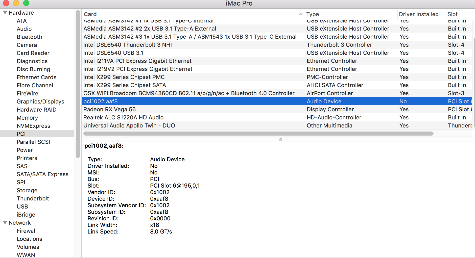

21 minutes ago, blast44 said:
I went and get the Asus Strix RX Radeon Vega 64 GPU but now I am having problems with the SSDT I had to move the wifi and the thunderbolt card one slot down because the GPU is so big that it is covering up slot 3 according to your nomenclature posted in your guide. can you please help me out. I will definitely buy you a beer at the end. thanks.
I have started working on the ssdt.
SSDT-SLEEP.aml
SSDT-TB3-L02-BR1X.aml
SSDT-X299-iMacPro.aml
SSDT-X299-TB3-iMacPro-KGP.aml
Can you still use the TB adapter in Slot-4? You can move the Wifi card to any other PCIe slot...
To help you, I would need your original DSDT.aml, a save of your IOREG and a list with the exact device slot population.
Edited by KGP-iMacPro
the wifi card only works in slot 3 and 4. i attached my original dsdt but its not allowing me to attach my ioreg.
I got my graphics card to work and show up the wifi works too but the thunderbolt works as well but it does not show up in system profile. the graphics card on the other hand, while it works, the fans are spinning at high speed most times.
DSDT.aml

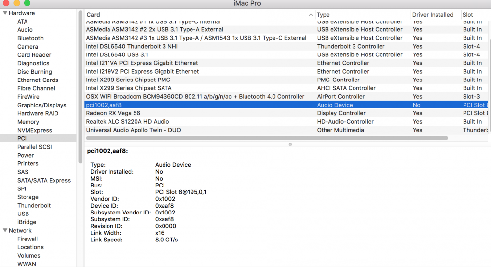

DSDT.aml
Why does your Wifi card only on work in Slot-3 or 4? I strongly recommend to use the TB-Adopter in Slot-4!
I am not able to do anything without your IOREG. And once more, I need your exact slot population.
cant upload ioreg because its more than 10mb.
why do i see pci-bridge instead ox gfx0 for graphics or nhci for thunder bolt?

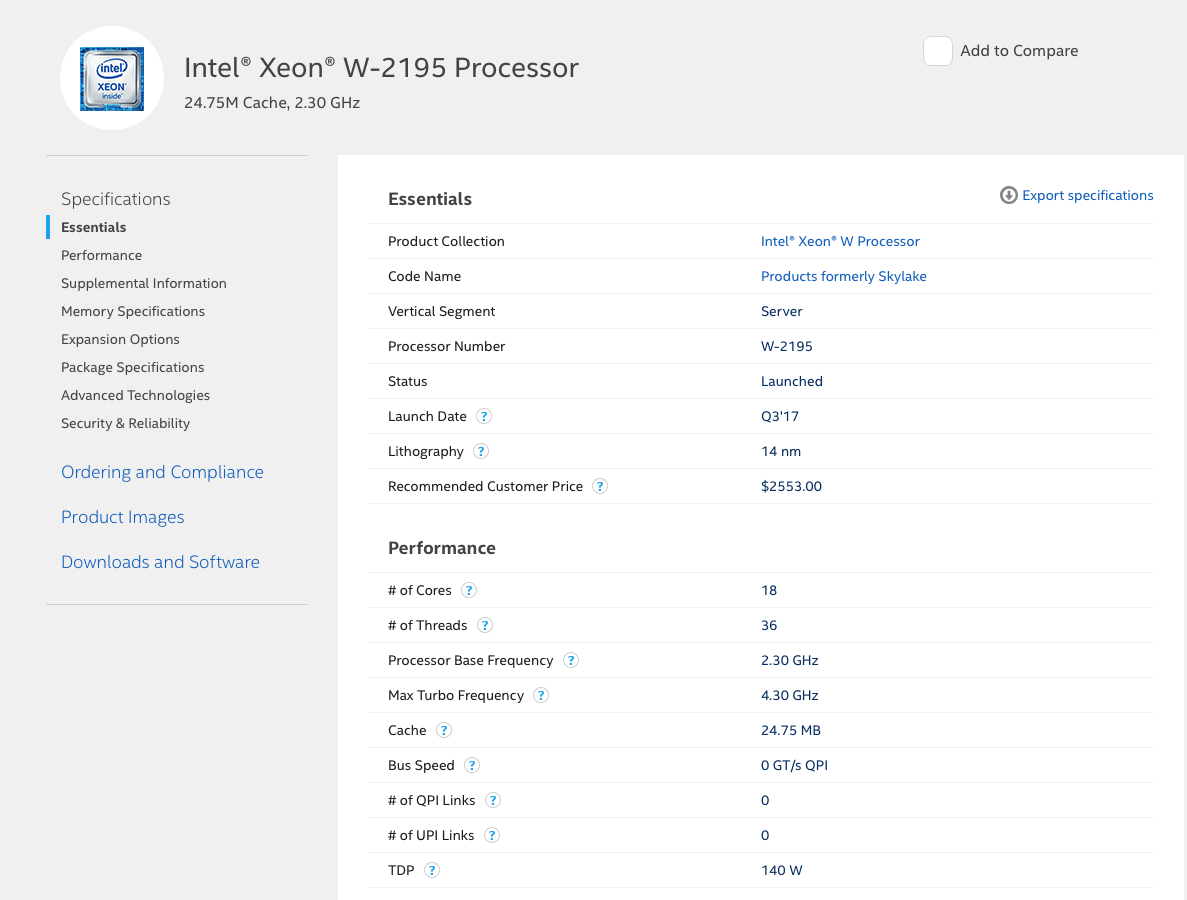

Hey guys couple of questions;
I’m putting together a new build so I’m between Xeon W-2195 and i9-7980xe.
Does Xeon needs any xcmp patches?
Works like a charm? Sleep? System lag? Android emulator works fast?
The only reason I’m thinking of going with Xeon is because of this:
https://www.asus.com/us/Commercial-Servers-Workstations/WS-C422-SAGE-10G/
Any suggestions?

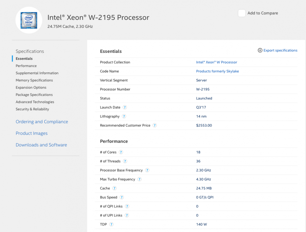

Any suggestions?
Hi, man! :wink_anim:
You know that with a Xeon you won't be able to apply any OC? ECC Ram is costive and slow in addition..
WS-C422-Sage-10G is a nice thing to have... But...
What about https://www.asus.com/Motherboards/WS-X299-SAGE-10G/ ? :drool:
Xeon won't need any XCPM patches, as Skylake-X also does not require any XCPM patches...
With Skylake-X/X299 and Vega we have nearly reached vanilla system status .. :P
And yes.. in my opinion everything works like a charm, including sleep/wake.. :yes:
But this question rather should be answered by others :wink_anim:.. I am not a fan of self promotion...
No clue what is Android emulator..  I am on iPhone X and IOS 11, rather  focusing on hands-off, airdrop and continuity, which perfectly works with my OSXWIFI..

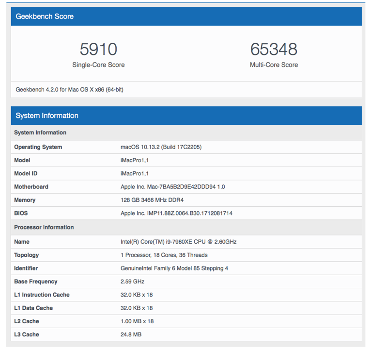

19 minutes ago, surfinchina said:
I'll chip in as well :)
Your choice should be fully about what you use it for.
For example, I run a CAD software that mainly uses a couple of cores per open tab (like an elevation tab, a plan tab, a 3d window etc). Then sometimes I do renders which use all CPU cores flat out. So a CPU that can hit nearly 5gHz works best for my workflow. More cores is a bit pointless and can slow things down with lower clocks. I tried 24 cores last year and it was painfully slow.

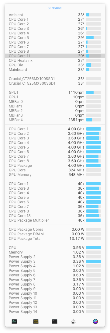

I am happy with my i9-7980XE though and a Geekbench score of >65.000 with 18 cores is not painfully slow.. In any case I guess you won't be able to run a Xeon W-2195 @ something faster than 2.3 Ghz, which might lack any comparison with the 4.7 GHz (sync all cores) of a i9-7980XE.
And I guess that's the key answer to @Balamut 's originating question.
Although Intel specs state 4.3 Ghz turbo frequency for the Xeon W-2195.. Thus  I might be wrong with my assumptions?
1592526714_ScreenShot2018-06-29at22_00_12.thumb.png.7d131e0939f02653d5c01740ee6e2af1.png

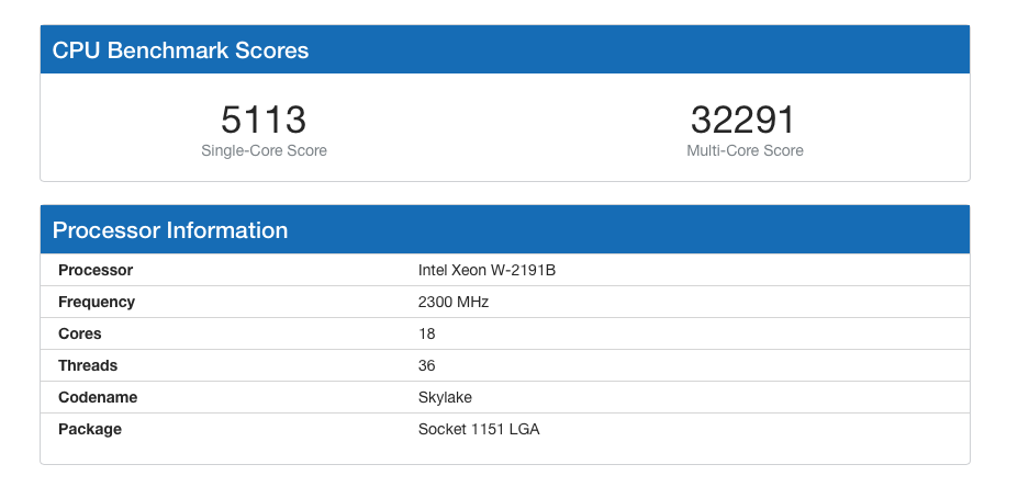

I think 4.3Ghz is Max for 1 core only.
Maxed out iMacPro
https://browser.geekbench.com/v4/cpu/7051891
i9-7980xe
https://browser.geekbench.com/v4/cpu/7267634
Thats a huge jump. Although the memory speed is higher here too.
Thank you fellas for all your inputs, it was more then helpful.
Edited by Balamut
Fixing weird spaces.
 manage to get everything in the right slot, but now I cannot get HDMI Audio to work, how do I enable HDMI Audio with Radeon Vega? Thanks.
10.13.5 and 10.14: Vega HDAU seems to work exclusively with Whatevergreen.kext v.1.1.7

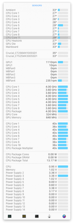

My ASUS TUF X299 Mark 1 is stable now. Yay!
I have to do more testing for sure.
I have two problems to solve now:
1. Any USB device can wake up a computer, but nothing charges during sleep. External disks are losing connection and "Disk Not Ejected Properly" is shown on wake up. Including Time Machine disk, unfortunately. It looks like USB current during sleep is too low. I'm trying to find a solution, but out of ideas. The problem's wider than I thought at first. Needs more investigation.
2. Not all temperature, rpm, etc. sensors are available for motherboard configuration in Contents/Info.plist. I'm investigating this right now. Commented this later.
Edited by Napka
9 hours ago, KGP-iMacPro said:
What about removing the Nvidia HDAU kext patch from the config.plist? Or maybe you need a slightly different HDAU kext patch for the Vega, what I doubt as natively implemented? Although your entire HDAU implementation seems to fail at present due to unknown reason .. Please check once more your HDAU implementation by means of IOREG!
nothing shows up in ioreg when I type in "HDAU"
and when I type in "Display" in ioreg  I get: PCO2@0>BR2A@0>SLO5@0>pic-bridge@0>display@0
Shouldn't I see something like GFX@0? thanks.
Your GFX SSDT implementation is not working and that's why also your HDAU SSDT implementation fails..
Wait for the update of iStat Menus..

20 hours ago, KGP-iMacPro said:
iStatMenus 6.20 Beta
Thanks for the link! No CPU cores mess anymore.
But I yet need to jump into sensors source code. Lots of motherboard/external temperature sensors and some fan headers still missing. That was expected, other tools do not display them too.
Edited by Napka
