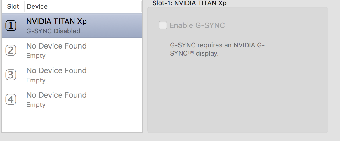

kgp Posted November 15, 2018 Author Share Posted November 15, 2018 43 minutes ago, Balamut said: Thank you very much, so far everything except the Wireless works like a charm, even got the little boost on the CPU/GPU side, so I guess WhateverGreen was needed. On the USB part I don't have only 9 USB ports on the motherboard if I'll add 6 more from the USB3 Pcie card that'll be exactly 15. With SSDT-ARPT my wifi gets disabled. And when removed: The only thing I'm wondering is why HDMI didn't stick, and will be fun to do second GPU. Can you upload once more an IOREG.save, this time with all SDDTs in your EFI-Folder during boot? Link to comment https://www.insanelymac.com/forum/topic/331658-how-to-build-your-own-imac-pro-successful-buildextended-guide/page/26/#findComment-2647770 Share on other sites More sharing options...
kgp Posted November 15, 2018 Author Share Posted November 15, 2018 1 hour ago, Balamut said: Thank you very much, so far everything except the Wireless works like a charm, even got the little boost on the CPU/GPU side, so I guess WhateverGreen was needed. On the USB part I don't have only 9 USB ports on the motherboard if I'll add 6 more from the USB3 Pcie card that'll be exactly 15. With SSDT-ARPT my wifi gets disabled. And when removed: The only thing I'm wondering is why HDMI didn't stick, and will be fun to do second GPU. There have been still errors in both SSDT-X299-Nvidia.aml and SSDT-X299-ARPT.aml. Please find both files once more attached below. If HDAU still does not work try Device (HDAU) { Name (_ADR, One) // _ADR: Address instead of Device (HDAU) { Name (_ADR, Zero) // _ADR: Address In principle both files should work now properly. I also once more uploaded the complete EFI-Folder including the revised version of SSDT-X299-Nvidia.aml and SSDT-X299-ARPT.aml. Here the corresponding LINK for download. SSDT-X299-ARPT.aml.zip SSDT-X299-Nvidia.aml.zip 1 Link to comment https://www.insanelymac.com/forum/topic/331658-how-to-build-your-own-imac-pro-successful-buildextended-guide/page/26/#findComment-2647777 Share on other sites More sharing options...

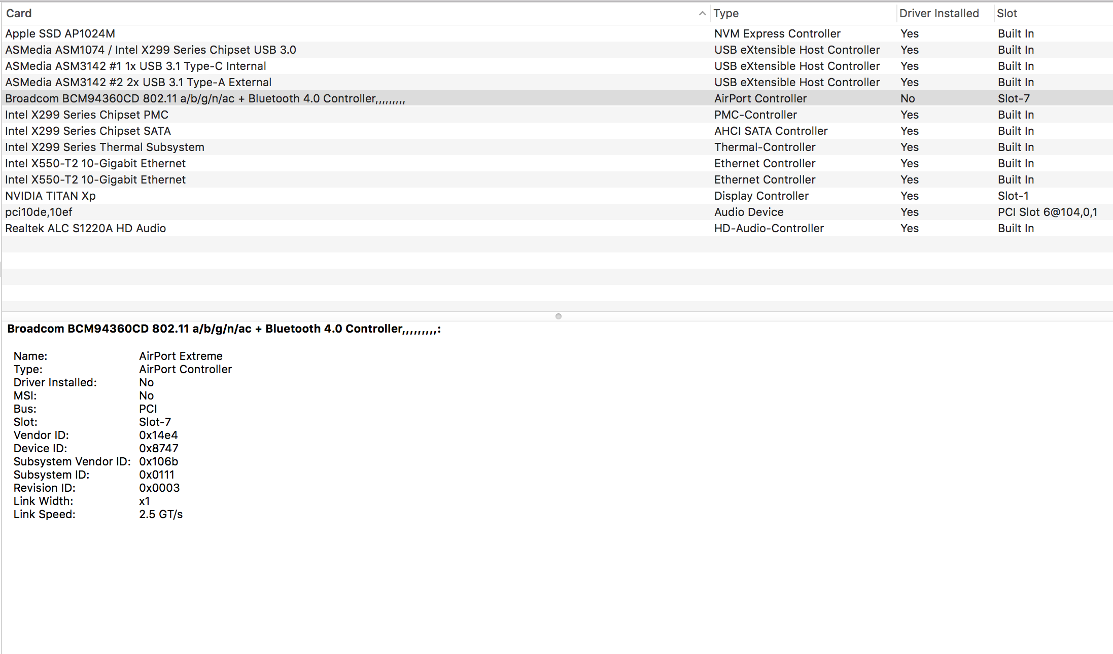

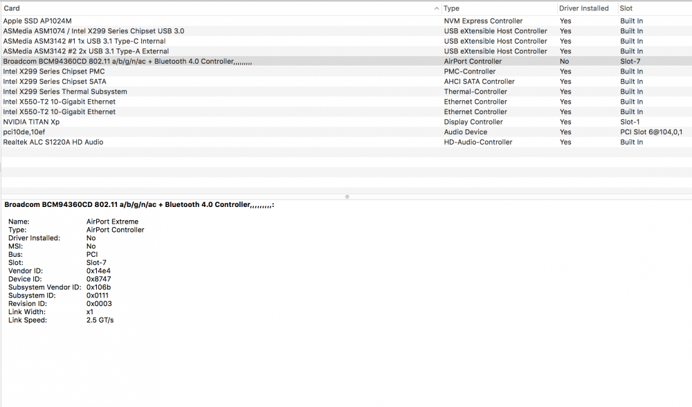

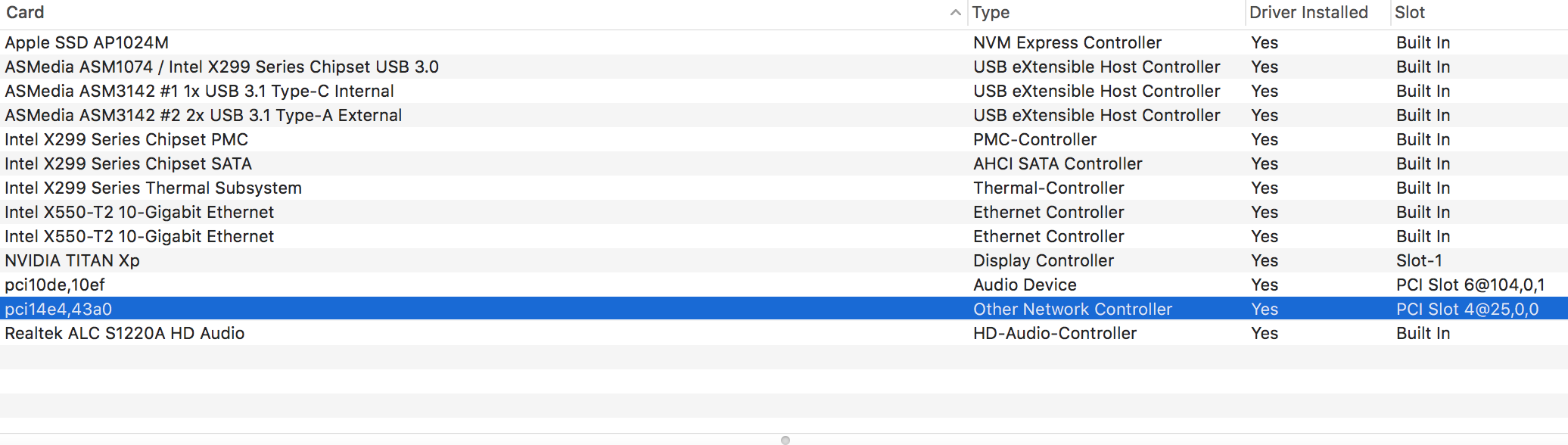

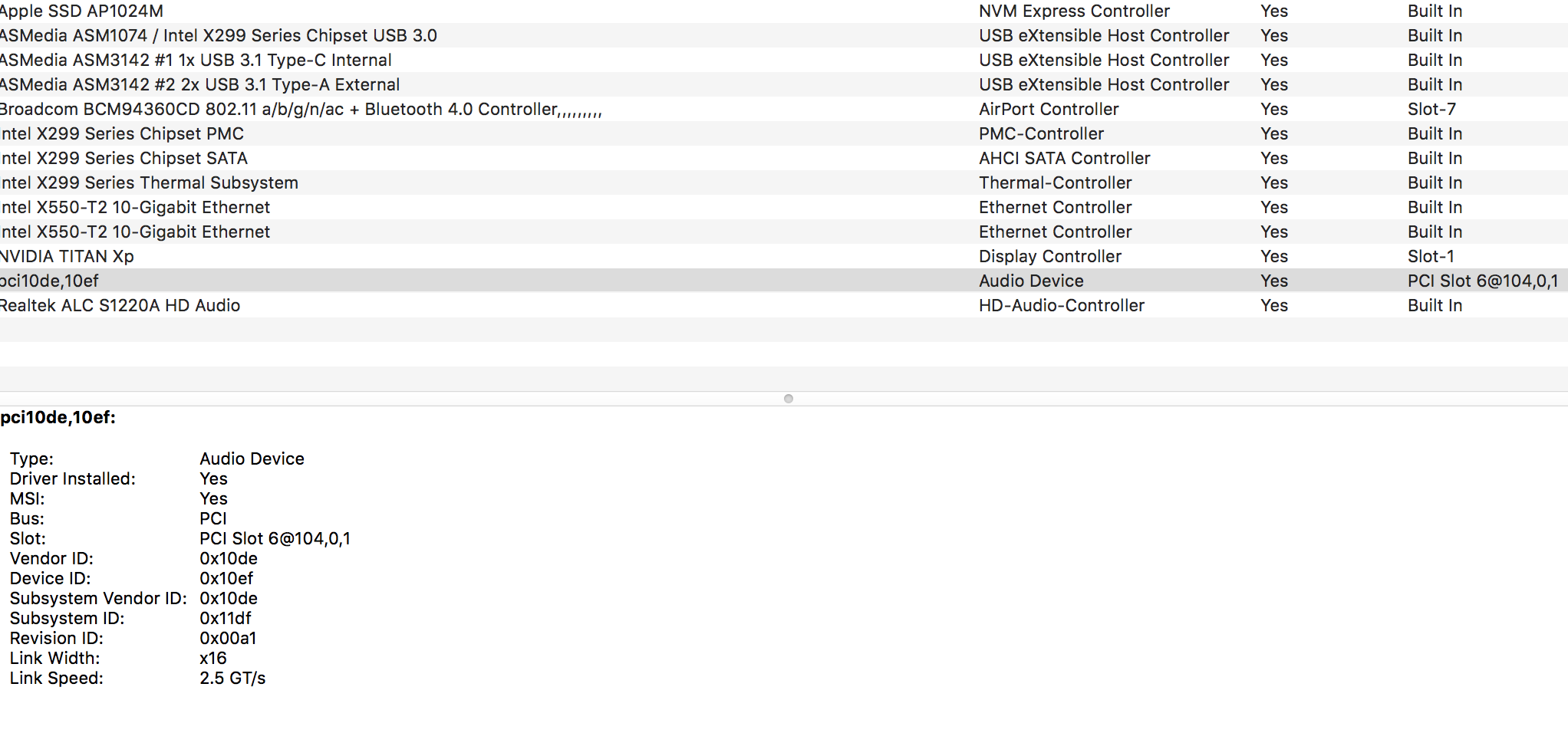

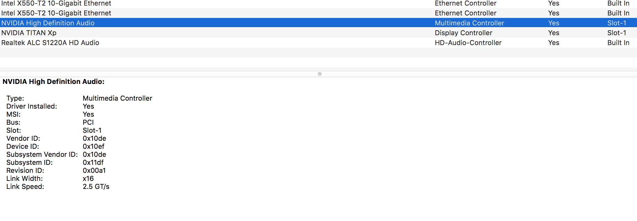

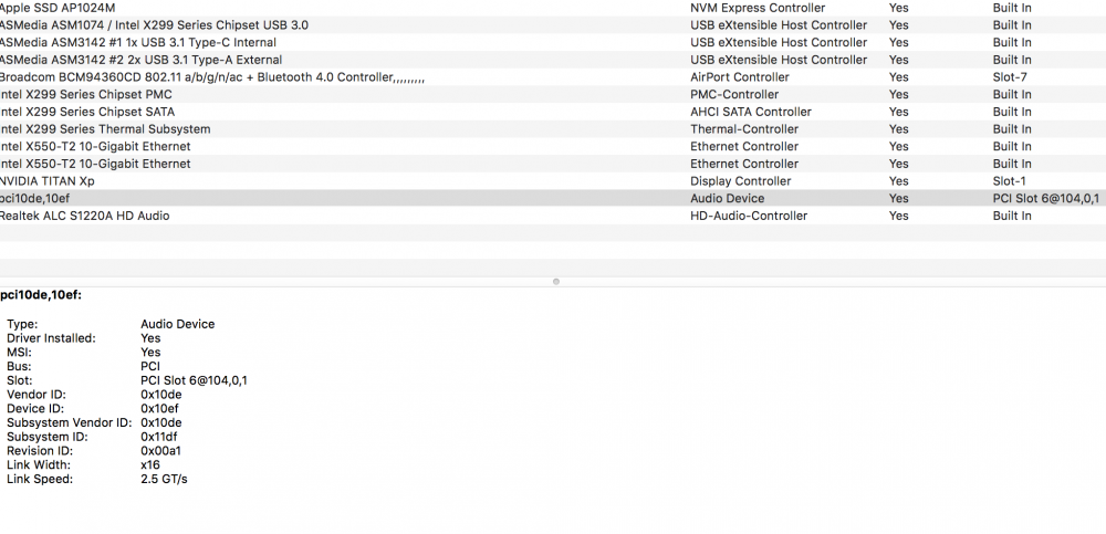

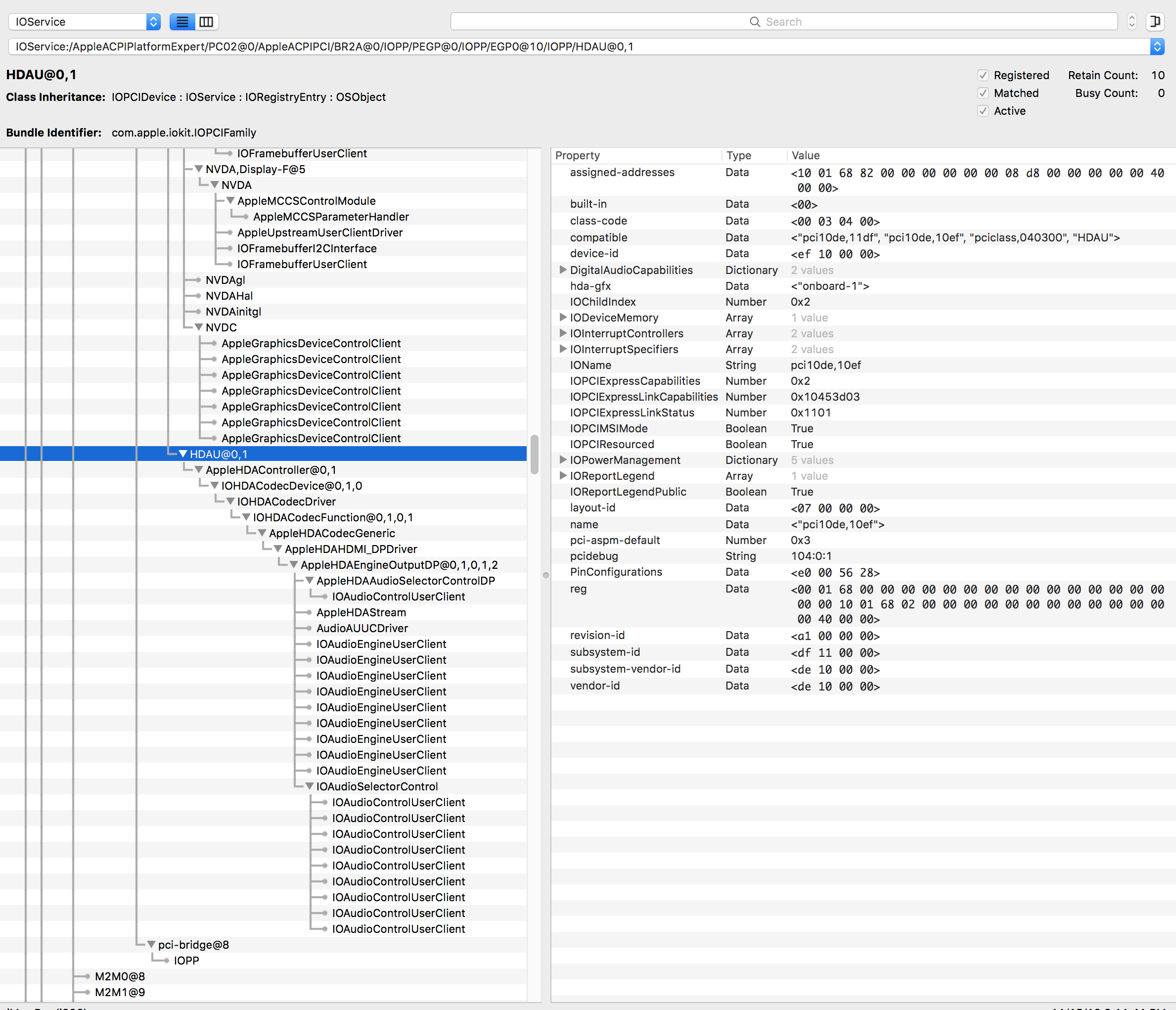

Balamut Posted November 15, 2018 Share Posted November 15, 2018 (edited) Weird, I had to redo my post twice. Wifi worked like a charm, but HDAU still shows weirdly even though it is registered in the IOReg. Also got this errors: 2018-11-15 15:08:45.887269-0800 0x71 Default 0x0 0 0 kernel: (AppleACPIPlatform) GPE _L6B has no implementation 2018-11-15 15:08:45.887270-0800 0x71 Default 0x0 0 0 kernel: (AppleACPIPlatform) GPE _L6B has no implementation 2018-11-15 15:09:06.200715-0800 0x34e Default 0x0 0 0 kernel: (IOPlatformPluginFamily) X86PlatformPlugin::configResourceCallback - DeepSleep is not supported! 2018-11-15 15:09:06.200716-0800 0x34e Default 0x0 0 0 kernel: (IOPlatformPluginFamily) X86PlatformPlugin::configResourceCallback - DeepSleep is not supported! This I'm assuming is normal: 2018-11-15 15:09:07.960067-0800 0x5e5 Default 0x0 0 0 kernel: (AppleACPIPlatform) ACPI Warning: \_SB.PC02.BR2A.PEGP.EGP0.GFX0._DSM: 2018-11-15 15:09:07.960067-0800 0x5e5 Default 0x0 0 0 kernel: (AppleACPIPlatform) ACPI Warning: \_SB.PC02.BR2A.PEGP.EGP0.GFX0._DSM: 2018-11-15 15:09:07.960069-0800 0x5e5 Default 0x0 0 0 kernel: (AppleACPIPlatform) Argument #4 type mismatch - Found [Buffer], ACPI requires [Package] 2018-11-15 15:09:07.960070-0800 0x5e5 Default 0x0 0 0 kernel: (AppleACPIPlatform) Argument #4 type mismatch - Found [Buffer], ACPI requires [Package] Edited November 15, 2018 by Balamut Link to comment https://www.insanelymac.com/forum/topic/331658-how-to-build-your-own-imac-pro-successful-buildextended-guide/page/26/#findComment-2647863 Share on other sites More sharing options...
kgp Posted November 16, 2018 Author Share Posted November 16, 2018 8 hours ago, Balamut said: Weird, I had to redo my post twice. Wifi worked like a charm, but HDAU still shows weirdly even though it is registered in the IOReg. Also got this errors: 2018-11-15 15:08:45.887269-0800 0x71 Default 0x0 0 0 kernel: (AppleACPIPlatform) GPE _L6B has no implementation 2018-11-15 15:08:45.887270-0800 0x71 Default 0x0 0 0 kernel: (AppleACPIPlatform) GPE _L6B has no implementation 2018-11-15 15:09:06.200715-0800 0x34e Default 0x0 0 0 kernel: (IOPlatformPluginFamily) X86PlatformPlugin::configResourceCallback - DeepSleep is not supported! 2018-11-15 15:09:06.200716-0800 0x34e Default 0x0 0 0 kernel: (IOPlatformPluginFamily) X86PlatformPlugin::configResourceCallback - DeepSleep is not supported! This I'm assuming is normal: 2018-11-15 15:09:07.960067-0800 0x5e5 Default 0x0 0 0 kernel: (AppleACPIPlatform) ACPI Warning: \_SB.PC02.BR2A.PEGP.EGP0.GFX0._DSM: 2018-11-15 15:09:07.960067-0800 0x5e5 Default 0x0 0 0 kernel: (AppleACPIPlatform) ACPI Warning: \_SB.PC02.BR2A.PEGP.EGP0.GFX0._DSM: 2018-11-15 15:09:07.960069-0800 0x5e5 Default 0x0 0 0 kernel: (AppleACPIPlatform) Argument #4 type mismatch - Found [Buffer], ACPI requires [Package] 2018-11-15 15:09:07.960070-0800 0x5e5 Default 0x0 0 0 kernel: (AppleACPIPlatform) Argument #4 type mismatch - Found [Buffer], ACPI requires [Package] Can you try the revised SSDT-X299-Nvidia.aml attached below? If it still does not work try to change Device (HDAU) { Name (_ADR, Zero) // _ADR: Address to Device (HDAU) { Name (_ADR, One) // _ADR: Address SSDT-X299-Nvidia.aml.zip 1 Link to comment https://www.insanelymac.com/forum/topic/331658-how-to-build-your-own-imac-pro-successful-buildextended-guide/page/26/#findComment-2647909 Share on other sites More sharing options...

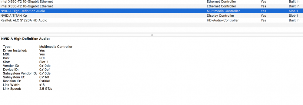

Balamut Posted November 16, 2018 Share Posted November 16, 2018 12 hours ago, KGP-iMacPro said: Can you try the revised SSDT-X299-Nvidia.aml attached below? If it still does not work try to change Device (HDAU) { Name (_ADR, Zero) // _ADR: Address to Device (HDAU) { Name (_ADR, One) // _ADR: Address SSDT-X299-Nvidia.aml.zip Worked like a charm! Monday will test out 2 GPUs, lets see how that works out. 1 Link to comment https://www.insanelymac.com/forum/topic/331658-how-to-build-your-own-imac-pro-successful-buildextended-guide/page/26/#findComment-2648060 Share on other sites More sharing options...

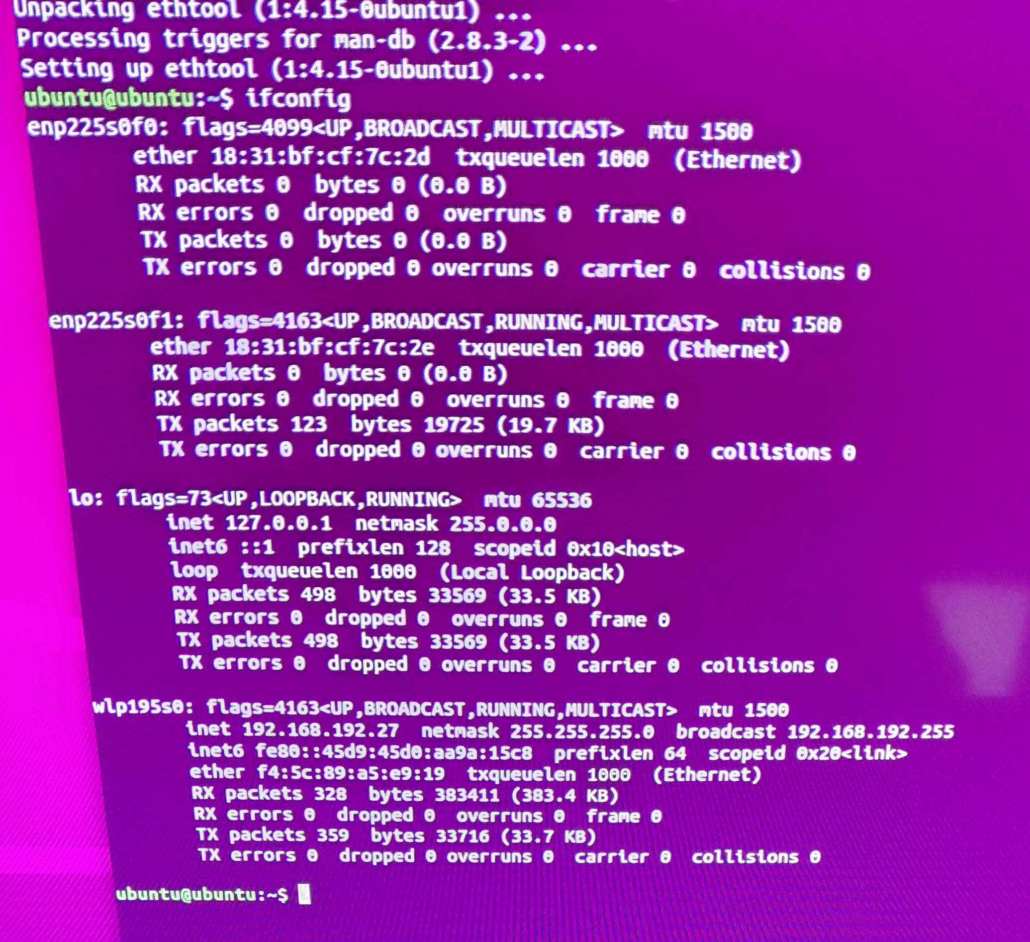

123456789323 Posted November 18, 2018 Share Posted November 18, 2018 (edited) @Balamut sudo ethtool -E enp225s0f0 magic 0x15638086 offset 0x242 value 0x0a sudo ethtool -E enp225s0f0 magic 0x15638086 offset 0x243 value 0x00 sudo ethtool -E enp225s0f1 magic 0x15638086 offset 0x242 value 0x0a sudo ethtool -E enp225s0f1 magic 0x15638086 offset 0x243 value 0x00 but check if your enp is correct. This example is from my WS X299 Sage/10G and this way it works on my build without any problems. Edited November 18, 2018 by DSM2 2 Link to comment https://www.insanelymac.com/forum/topic/331658-how-to-build-your-own-imac-pro-successful-buildextended-guide/page/26/#findComment-2648302 Share on other sites More sharing options...
kgp Posted November 18, 2018 Author Share Posted November 18, 2018 1 hour ago, DSM2 said: @Balamut sudo ethtool -E enp225s0f0 magic 0x15638086 offset 0x242 value 0x0a sudo ethtool -E enp225s0f0 magic 0x15638086 offset 0x243 value 0x00 sudo ethtool -E enp225s0f1 magic 0x15638086 offset 0x242 value 0x0a sudo ethtool -E enp225s0f1 magic 0x15638086 offset 0x243 value 0x00 but check if your enp is correct. This example is from my WS X299 Sage/10G and this way it works on my build without any problems. In fact I already provided @Balamut the correct patch for his enp already in post: sudo ethtool -E enp179s0f1 magic 0x15638086 offset 0x242 value 0x0a sudo ethtool -E enp179s0f1 magic 0x15638086 offset 0x243 value 0x00 This patch in fact already considers two LAN ports (0x0a and 0x00). Thus I am somewhat surprised that the to onboard LAN connectors of the WS X299 Sage/10G seem to be assigned to two different enp controllers. Based on the previous info provided by @Balamut, his patches might be then: sudo ethtool -E enp179s0f0 magic 0x15638086 offset 0x242 value 0x0a sudo ethtool -E enp179s0f0 magic 0x15638086 offset 0x243 value 0x00 sudo ethtool -E enp179s0f1 magic 0x15638086 offset 0x242 value 0x0a sudo ethtool -E enp179s0f1 magic 0x15638086 offset 0x243 value 0x00 He just needs to confirm that his second enp is indeed enp179s0f0. So far he only provided info for enp179s0f1. 1 Link to comment https://www.insanelymac.com/forum/topic/331658-how-to-build-your-own-imac-pro-successful-buildextended-guide/page/26/#findComment-2648316 Share on other sites More sharing options...
123456789323 Posted November 18, 2018 Share Posted November 18, 2018 @KGP-iMacProThere are two entries and have to be patched both... otherwise it will not work! Like I see he use aswell an WS X299 Sage/10G so it can't be different then on my build Besides from the enp of course... 1 Link to comment https://www.insanelymac.com/forum/topic/331658-how-to-build-your-own-imac-pro-successful-buildextended-guide/page/26/#findComment-2648332 Share on other sites More sharing options...
kgp Posted November 18, 2018 Author Share Posted November 18, 2018 (edited) 7 minutes ago, DSM2 said: @KGP-iMacProThere are two entries and have to be patched both... otherwise it will not work! Like I see he use aswell an WS X299 Sage/10G so it can't be different then on my build Besides from the enp of course... Sure.. that's what I was saying. Following your recent information, it seems that due to unknown reason the 2 10GB LAN connectors are distributed over two separate enp controllers. Thus the patch I provided in post in fact needs to be applied twice for both enps as you did... If the former enp info provided by @Balamut was correct, his patches should properly read: sudo ethtool -E enp179s0f0 magic 0x15638086 offset 0x242 value 0x0a sudo ethtool -E enp179s0f0 magic 0x15638086 offset 0x243 value 0x00 sudo ethtool -E enp179s0f1 magic 0x15638086 offset 0x242 value 0x0a sudo ethtool -E enp179s0f1 magic 0x15638086 offset 0x243 value 0x00 no idea why the enps are different in his and your case under Linux. Edited November 18, 2018 by KGP-iMacPro 2 Link to comment https://www.insanelymac.com/forum/topic/331658-how-to-build-your-own-imac-pro-successful-buildextended-guide/page/26/#findComment-2648336 Share on other sites More sharing options...
