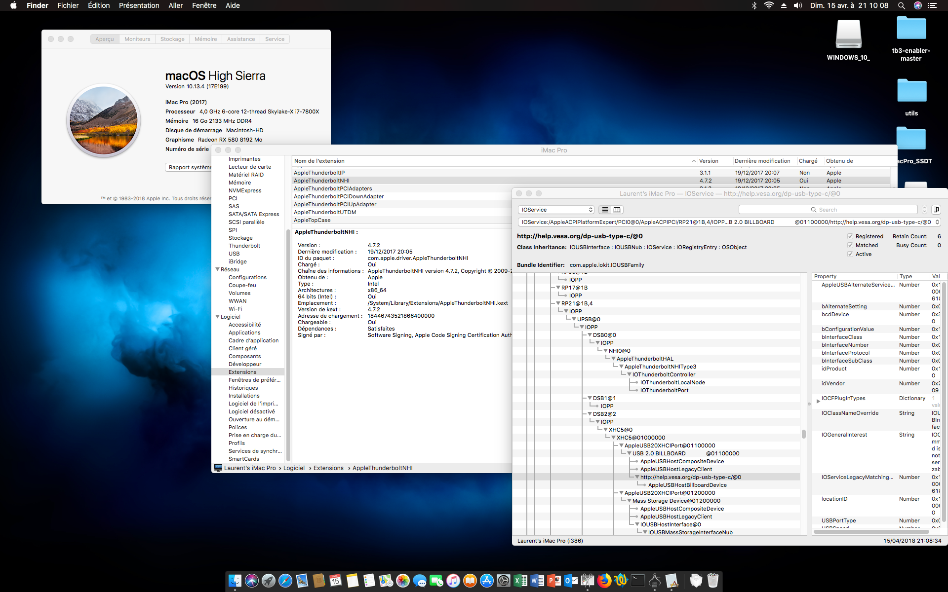

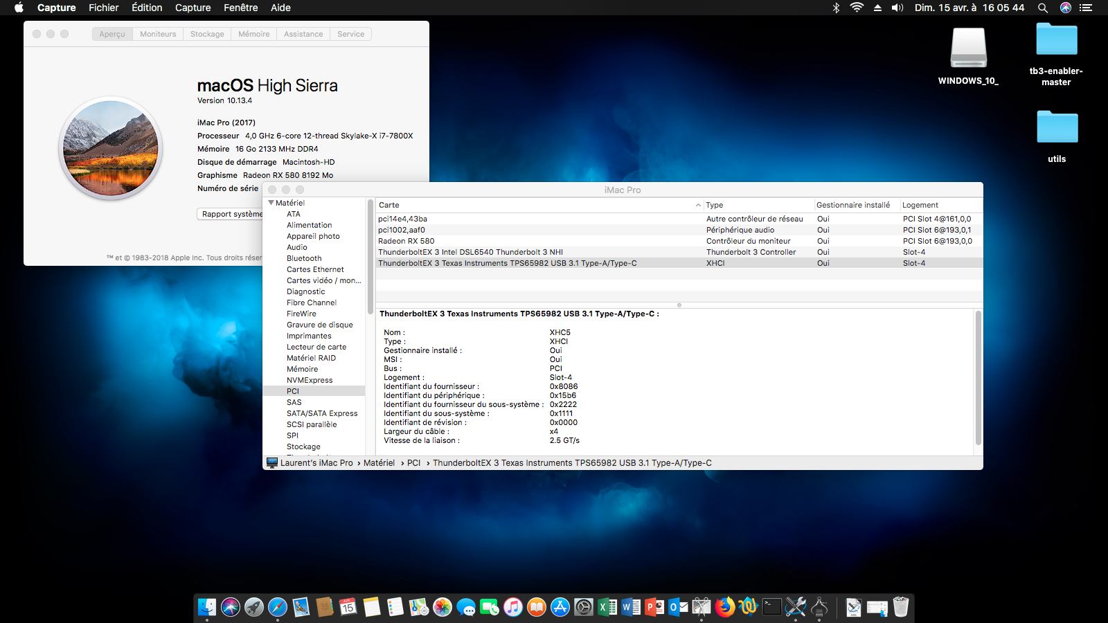

After a week of severals issues :
1/ Bios recommended parameters + Pci devices set as Legacy
2/ I added arbitrary lines on my config.plist
3/ I created my own SSDT
What is working :
- Hot plug USB or HDD pluged on USB 3.1 or USB C : eject and re-plug OK
Not working ( working in Windows 10 )
- Display sreen connected on USB C
Edited by Loloflat6
My issue is solved :
 jyavenard tell me to use Vega5KFixup kext  https://github.com/jyavenard/Vega5KFixup
I can boot with the ThunderboltEx 3 connected on USB C !
Nice day !
[Sapphire Radeon Nitro+ SE RX580 is fully supported on 10.13.4 : no boot flag/ no kext needed]
Edited by Loloflat6

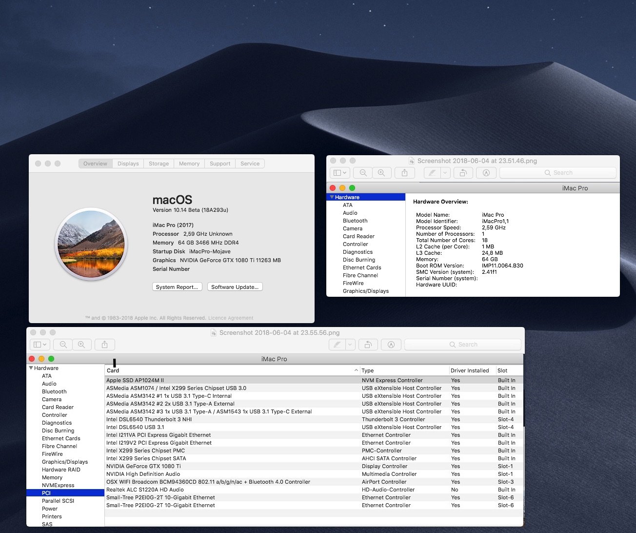

Adaptation of the TB SSDT device implementation for TB implementations different from the ASUS TBEX 3 (e.g. for two-port TB solutions)
After populating also DSB3 and DSB4, the respective TB SSDT implementation should now also be valid for TB solutions different from the ASUS TBEX 3 (also for two-port TB solutions). Note however that the TBEX 3 uses PCI lanes directly connected with the CPU, whereas other TB solutions might use PCH lanes. The latter TB implementations might need a TB device connected at boot to be recognised by the system, although hot plug should work subsequently also in this case after removing the THB_C cable.
Thanks to @lelet for all fruitful discussions and for testing the new TB SSDT implementation on his Z370.
The new SSDT-X299-iMacPro.aml is attached below and has also been implemented in the guide (originating post of this thread).

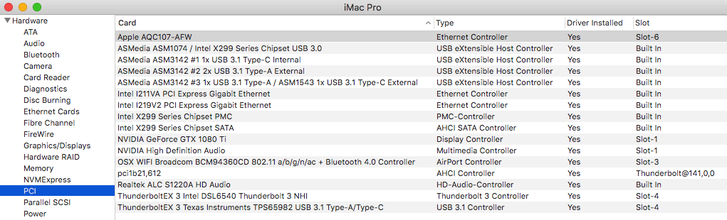

            Store (Package (0x08)
                    "AAPL,slot-name",
                    Buffer (0x09)
                        "Built In"
                    "built-in",
                    Buffer (One)
                         0x00
                    "name",
                    Buffer (0x14)
                        "AppleANS2Controller"
                    "model",
                    Buffer (0x12)
                        "Apple SSD AP1024M"
                }, Local0)
            Return (Local0)
    Name (_SB.PCI0.RP09.PXSX._STA, Zero)  // _STA: Status
    Scope (\_SB.PCI0.SAT1)
        Method (_DSM, 4, NotSerialized)  // _DSM: Device-Specific Method
            Store (Package (0x0C)
                    "AAPL,slot-name",
                    Buffer (0x09)
                        "Built In"
                    "built-in",
                    Buffer (One)
                         0x00
                    "name",
                    Buffer (0x16)
                        "Intel AHCI Controller"
                    "model",
                    Buffer (0x1F)
                        "Intel X299 Series Chipset SATA"
                    "device_type",
                    Buffer (0x15)
                        "AHCI SATA Controller"
                    "device-id",
                    Buffer (0x04)
                         0x82, 0xA2, 0x00, 0x00
                }, Local0)
            Return (Local0)
    Scope (\_SB.PCI0.ETH0)
            Store (Package (0x10)
                    "AAPL,slot-name",
                    Buffer (0x09)
                        "Built In"
                    "built-in",
                    Buffer (One)
                         0x00
                    "name",
                    Buffer (0x16)
                        "Intel I219V2 Ethernet"
                    "model",
                    Buffer (0x2A)
                        "Intel I219V2 PCI Express Gigabit Ethernet"
                    "location",
                    Buffer (0x02)
                        "1"
                    "subsystem-id",
                    Buffer (0x04)
                         0x72, 0x86, 0x00, 0x00
                    "device-id",
                    Buffer (0x04)
                         0xB8, 0x15, 0x00, 0x00
                    "subsystem-vendor-id",
                    Buffer (0x04)
                         0x43, 0x10, 0x00, 0x00
                }, Local0)
            Return (Local0)
    Scope (\_SB.PCI0.RP02.ETH1)
                    "AAPL,slot-name",
                    Buffer (0x09)
                        "Built In"
                    "built-in",
                    Buffer (One)
                         0x00
                    "name",
                    Buffer (0x16)
                        "Intel I211VA Ethernet"
                    "model",
                    Buffer (0x2A)
                        "Intel I211VA PCI Express Gigabit Ethernet"
                    "location",
                    Buffer (0x02)
                        "2"
                    "subsystem-id",
                    Buffer (0x04)
                         0xF0, 0x85, 0x00, 0x00
                    "device-id",
                    Buffer (0x04)
                         0x39, 0x15, 0x00, 0x00
                    Buffer (0x04)
                }, Local0)
            Return (Local0)
    Scope (_SB.PC03.BR3D.ARPT)
        OperationRegion (PCIS, PCI_Config, Zero, 0x0100)
        Field (PCIS, AnyAcc, NoLock, Preserve)
            PVID,   16,
            PDID,   16
        Method (_PRW, 0, NotSerialized)  // _PRW: Power Resources for Wake
            Return (GPRW (0x69, 0x04))
            Store (Package (0x0E)
                    "built-in",
                    Buffer (One)
                         0x00
                    "device-id",
                    Buffer (0x04)
                         0xA0, 0x43, 0x00, 0x00
                    "AAPL,slot-name",
                    Buffer (0x07)
                        "Slot-3"
                    "device_type",
                    Buffer (0x13)
                        "AirPort Controller"
                    "model",
                    Buffer (0x4A)
                        "OSX WIFI Broadcom BCM94360CD 802.11 a/b/g/n/ac + Bluetooth 4.0 Controller"
                    "compatible",
                    Buffer (0x0D)
                        "pci14e4,43a0"
                    "name",
                    Buffer (0x10)
                        "AirPort Extreme"
                }, Local0)
            Return (Local0)
    Scope (\_SB.PC01.BR1A)
        Scope (SL01)
            Name (_STA, Zero)  // _STA: Status
        Scope (PEGP)
        Device (UPSB)
            Name (_ADR, Zero)  // _ADR: Address
                If (LNot (Arg2))
                    Return (Buffer (One)
                         0x03
                Return (Package (0x02)
                    "PCI-Thunderbolt",
                    One
            Name (_RMV, One)  // _RMV: Removal Status
            Device (DSB0)
                    If (LNot (Arg2))
                             0x03
                        "PCIHotplugCapable",
                        One
                Device (NHI0)
                    Name (_STR, Unicode ("Thunderbolt"))  // _STR: Description String
                        If (LEqual (Arg2, Zero))
                                 0x03
                        Return (Package (0x0D)
                            "built-in",
                            Buffer (One)
                                 0x00
                            "device_type",
                            Buffer (0x19)
                                "Thunderbolt 3 Controller"
                            "AAPL,slot-name",
                            Buffer (0x07)
                                "Slot-4"
                            "model",
                            Buffer (0x30)
                                "ThunderboltEX 3 Intel DSL6540 Thunderbolt 3 NHI"
                            "name",
                            Buffer (0x37)
                                "ThunderboltEX 3 Intel DSL6540 Thunderbolt 3 Controller"
                            "power-save",
                            One,
                            Buffer (One)
                                 0x00
            Device (DSB1)
                Name (_ADR, 0x00010000)  // _ADR: Address
                Name (_SUN, 0x04)  // _SUN: Slot User Number
                OperationRegion (A1E0, PCI_Config, Zero, 0x40)
                Field (A1E0, ByteAcc, NoLock, Preserve)
                    AVND,   32,
                    BMIE,   3,
                    Offset (0x18),
                    PRIB,   8,
                    SECB,   8,
                    SUBB,   8,
                    Offset (0x1E),
                        ,   13,
                    MABT,   1
                Method (_BBN, 0, NotSerialized)  // _BBN: BIOS Bus Number
                    Return (SECB)
                Method (_STA, 0, NotSerialized)  // _STA: Status
                    Return (0x0F)
                Method (_RMV, 0, NotSerialized)  // _RMV: Removal Status
                    Return (Zero)
                Device (UPS0)
                    OperationRegion (ARE0, PCI_Config, Zero, 0x04)
                    Field (ARE0, ByteAcc, NoLock, Preserve)
                        AVND,   16
                        If (OSDW ())
                            Return (One)
                        Return (Zero)
                    Device (DSB0)
                            AVND,   32,
                            BMIE,   3,
                            Offset (0x18),
                            PRIB,   8,
                            SECB,   8,
                            SUBB,   8,
                            Offset (0x1E),
                                ,   13,
                            MABT,   1,
                            Offset (0x3E),
                                ,   6,
                            SBRS,   1
                            Return (SECB)
                            Return (0x0F)
                            Return (One)
                        Device (DEV0)
                                Return (0x0F)
                                Return (One)
                    Device (DSB1)
                            AVND,   32,
                            BMIE,   3,
                            Offset (0x18),
                            PRIB,   8,
                            SECB,   8,
                            SUBB,   8,
                            Offset (0x1E),
                                ,   13,
                            MABT,   1
                            Return (SECB)
                            Return (0x0F)
                            Return (One)
                        Device (DEV0)
                                Return (0x0F)
                                Return (One)
                    Device (DSB2)
                        Name (_ADR, 0x00020000)  // _ADR: Address
                            AVND,   32,
                            BMIE,   3,
                            Offset (0x18),
                            PRIB,   8,
                            SECB,   8,
                            SUBB,   8,
                            Offset (0x1E),
                                ,   13,
                            MABT,   1
                            Return (SECB)
                            Return (0x0F)
                            Return (One)
                        Device (DEV0)
                                Return (0x0F)
                                Return (One)
                    Device (DSB3)
                        Name (_ADR, 0x00030000)  // _ADR: Address
                            AVND,   32,
                            BMIE,   3,
                            Offset (0x18),
                            PRIB,   8,
                            SECB,   8,
                            SUBB,   8,
                            Offset (0x1E),
                                ,   13,
                            MABT,   1
                            Return (SECB)
                            Return (0x0F)
                            Return (One)
                        Device (DEV0)
                                Return (0x0F)
                                Return (One)
                    Device (DSB4)
                        Name (_ADR, 0x00040000)  // _ADR: Address
                            AVND,   32,
                            BMIE,   3,
                            Offset (0x18),
                            PRIB,   8,
                            SECB,   8,
                            SUBB,   8,
                            Offset (0x1E),
                                ,   13,
                            MABT,   1
                            Return (SECB)
                            Return (0x0F)
                            Return (One)
                        Device (DEV0)
                                Return (0x0F)
                                Return (One)
                    Device (DSB5)
                        Name (_ADR, 0x00050000)  // _ADR: Address
                            AVND,   32,
                            BMIE,   3,
                            Offset (0x18),
                            PRIB,   8,
                            SECB,   8,
                            SUBB,   8,
                            Offset (0x1E),
                                ,   13,
                            MABT,   1
                            Return (SECB)
                            Return (0x0F)
                            Return (One)
                        Device (DEV0)
                                Return (0x0F)
                                Return (One)
            Device (DSB2)
                Device (XHC5)
                                 0x03
                        Return (Package (0x12)
                            "built-in",
                            Buffer (One)
                                 0x00
                            "AAPL,slot-name",
                            Buffer (0x07)
                                "Slot-4"
                            "model",
                            Buffer (0x41)
                                "ThunderboltEX 3 Texas Instruments TPS65982 USB 3.1 Type-A/Type-C"
                            "name",
                            Buffer (0x31)
                                "ThunderboltEX 3 Texas Instruments XHC Controller"
                            "device_type",
                            Buffer (0x13)
                                "USB 3.1 Controller"
                            "device-id",
                            Buffer (0x04)
                                 0xB6, 0x15, 0x00, 0x00
                            "USBBusNumber",
                            Zero,
                            "UsbCompanionControllerPresent",
                            One,
                            "AAPL,XHCI-clock-id",
                            One
                    Device (RHUB)
                        Device (SSP1)
                            Name (_ADR, One)  // _ADR: Address
                            Name (_UPC, Package (0x04)  // _UPC: USB Port Capabilities
                                0xFF,
                                0x09,
                                Zero,
                                Zero
                            Name (_PLD, Package (0x01)  // _PLD: Physical Location of Device
                                Buffer (0x10)
                                    /* 0000 */  0x81, 0x00, 0x00, 0x00, 0x00, 0x00, 0x00, 0x00,
                                    /* 0008 */  0x31, 0x1C, 0x00, 0x00, 0x00, 0x00, 0x00, 0x00
                                         0x03
                                    "UsbCPortNumber",
                                    One
                        Device (SSP2)
                            Name (_ADR, 0x02)  // _ADR: Address
                                0xFF,
                                0x09,
                                Zero,
                                Zero
                                Buffer (0x10)
                                         0x03
                                    "UsbCPortNumber",
                                    0x02
                        Device (HS01)
                            Name (_ADR, 0x03)  // _ADR: Address
                                0xFF,
                                0x09,
                                Zero,
                                Zero
                                Buffer (0x10)
                        Device (HS02)
                            Name (_ADR, 0x04)  // _ADR: Address
                                0xFF,
                                0x09,
                                Zero,
                                Zero
                                Buffer (0x10)
            Device (DSB3)
                    AVND,   32,
                    BMIE,   3,
                    Offset (0x18),
                    PRIB,   8,
                    SECB,   8,
                    SUBB,   8,
                    Offset (0x1E),
                        ,   13,
                    MABT,   1
                    Return (SECB)
                    Return (0x0F)
                    Return (Zero)
                Device (UPS0)
                        AVND,   16
                        If (OSDW ())
                            Return (One)
                        Return (Zero)
                    Device (DSB0)
                            AVND,   32,
                            BMIE,   3,
                            Offset (0x18),
                            PRIB,   8,
                            SECB,   8,
                            SUBB,   8,
                            Offset (0x1E),
                                ,   13,
                            MABT,   1,
                            Offset (0x3E),
                                ,   6,
                            SBRS,   1
                            Return (SECB)
                            Return (0x0F)
                            Return (One)
                        Device (DEV0)
                                Return (0x0F)
                                Return (One)
                    Device (DSB1)

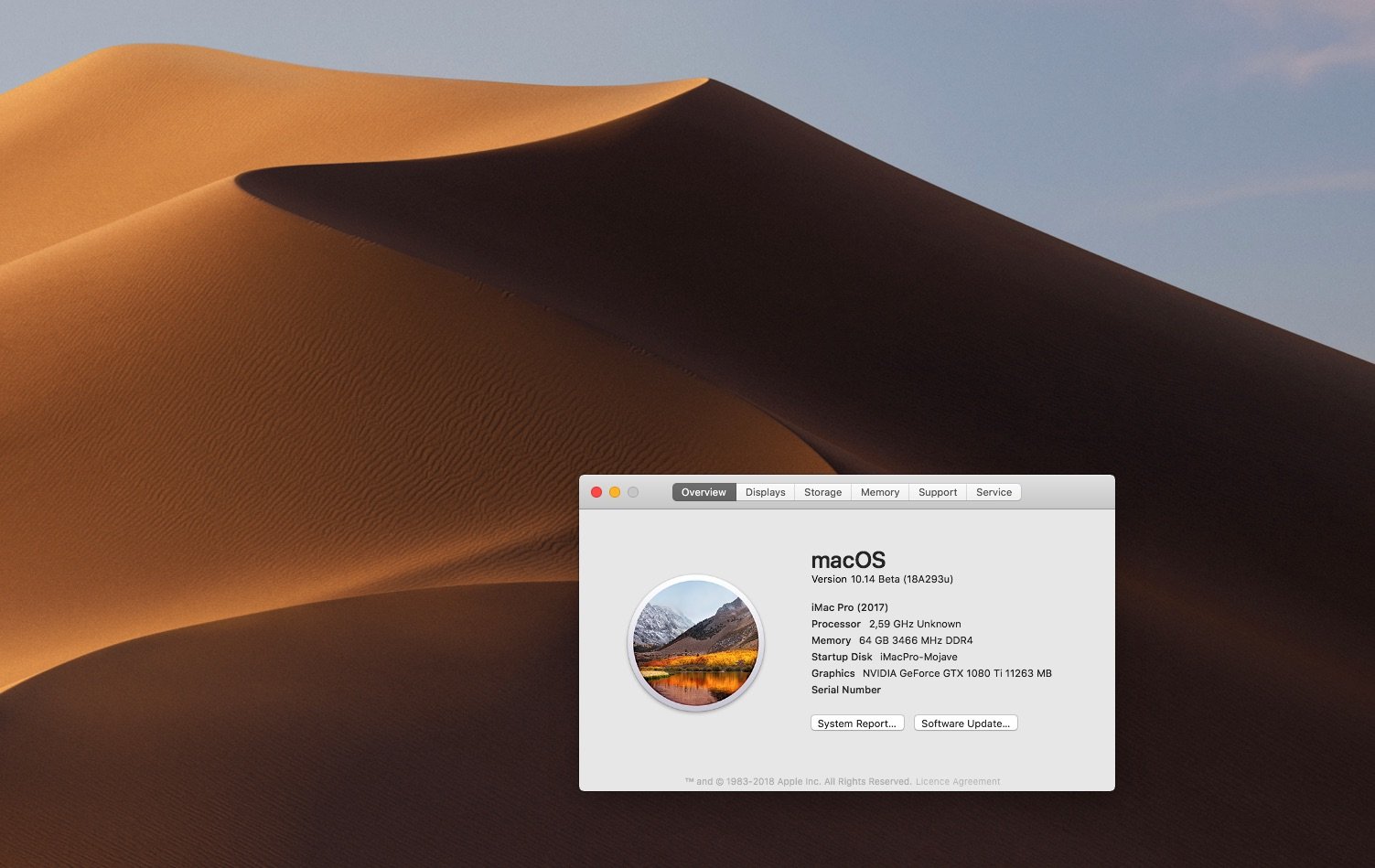

Let the show begin :thumbsup_anim: :superman:
installing....
That's it... :drool:
 594006741_Screenshot2018-06-04at23_34_04.thumb.jpg.e09831fcf35f24b0d909fa9f4b84f6c6.jpg
1037825373_Screenshot2018-06-04at23_57_13.thumb.jpg.63ecbd203908ad1d212aa065ce32b758.jpg
iMac Pro Skylake-X/X299 with macOS Mojave 10.14 DP1 (18A293u)  :thumbsup_anim:
Thanks to @PMHeart for providing the Clover.efi attached below. I also attach the 10.14 DP1 apsf.efi.

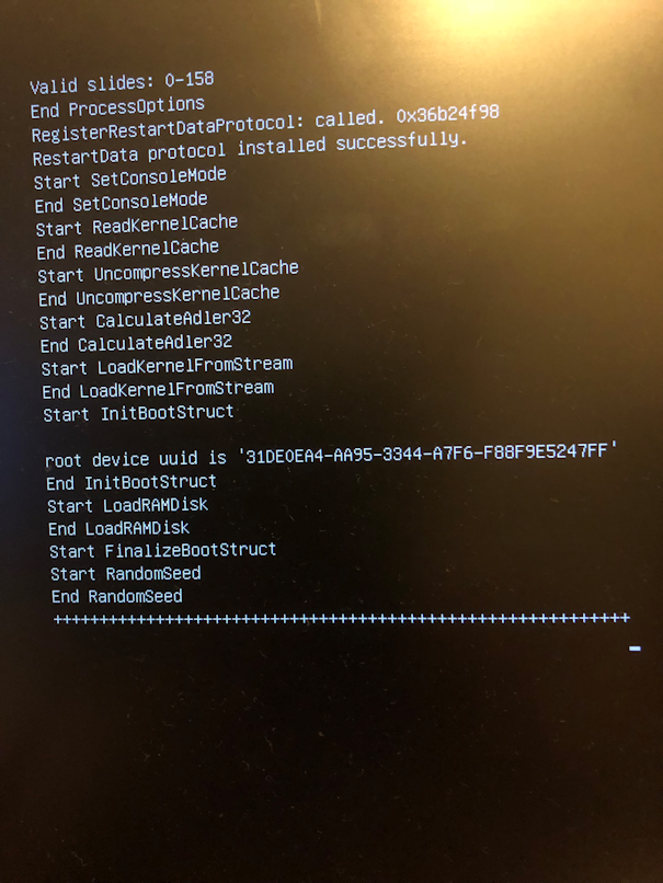

12 hours ago, KGP-iMacPro said:
Did you try completing and using the most recent EFi-Folder distribution, which I just published yesterday ABOVE?
yes. i get stuck with this... could my mobo be entering a sleep state!!!
would i need my BIOS patched?
