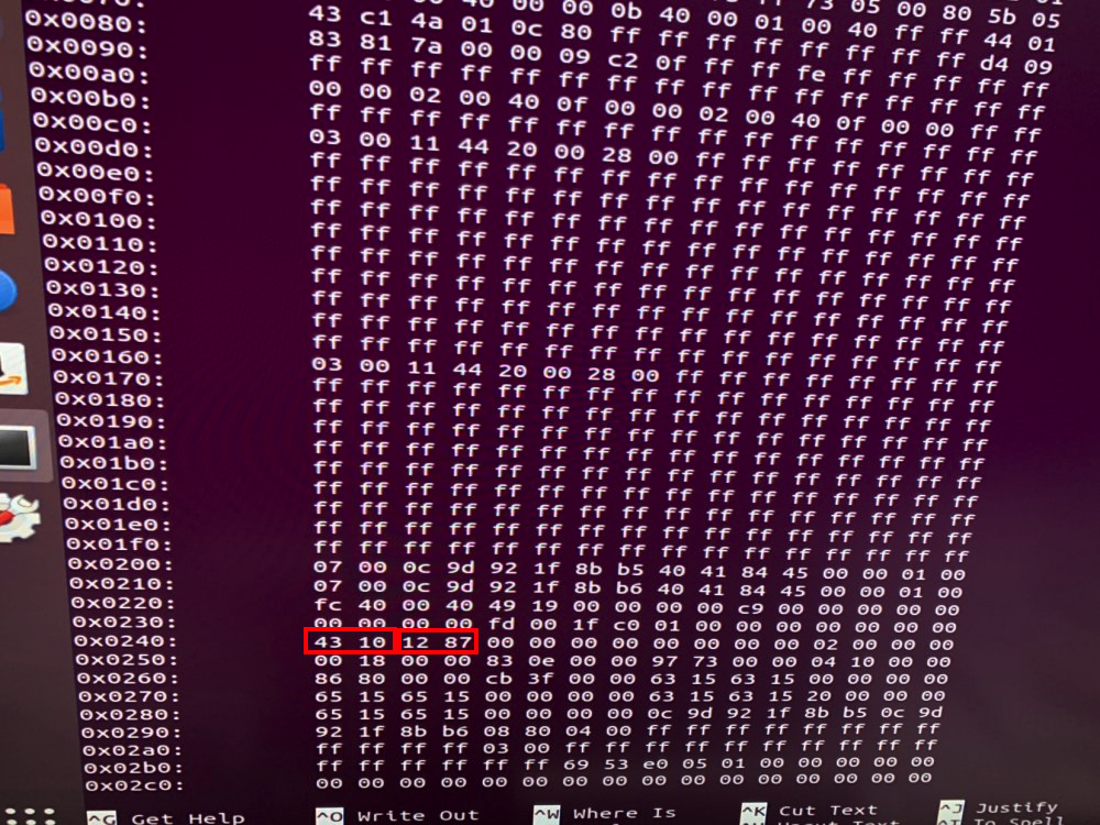

Hey guys can you help me out here, I’m having a blonde moment, I’ve got ws x299 sage/10g with dual x550 10g ports, subsystem is set as Asus and I’m having a very though time calculating the offset, help?
Offset 0x0240 second image

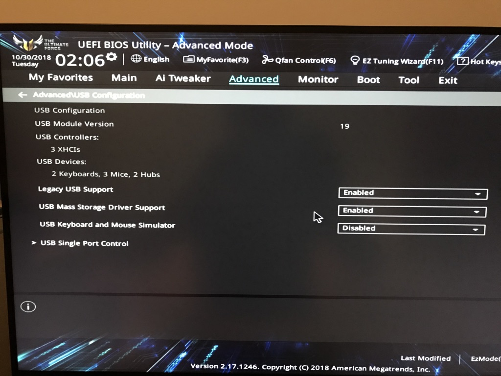

Hi, i'm kind of stuck on a strange problem. on a cold boot of my system my usb mouse(Corsair M65) most of the time does not work, i see it has power but does not move the pointer.  If i unplug it and plug it back in to the usb2 port on the motherboard everything works. Then on a warm reboot it will work most of the time.  Any idea where i should start looking? Just to add my usb keyboard always works, also a corsair. thanks in advance.
Edited by sensite
To provide any help I would need:
Detailed system specifications, Screenshots of your BIOS settings, EFI-Folder, IOREG.save, DSDT.aml, "PCI" screenshot of Apple's system report.
controller figures as 1043 instead of 8086, thus at your own risk... I also miss an ifconfig screenshot but from the other screenshot above I guess your 10g ports are assigned to enp179s0f1?
sudo ethtool -E enp179s0f1 magic 0x15638086 offset 0x242 value 0x0a
sudo ethtool -E enp179s0f1 magic 0x15638086 offset 0x243 value 0x00
Good luck..
Edited by KGP-iMacPro
Thanks man I'll give it a shot, I have 2 10G ports so I can experiment with one and see what happens, I was just having a really hard time calculating the offsets, its better ask then burn the thing.
On the 1043, yeah I saw it. its Asus Vendor ID, I might have to change it back to 8086, Ive seen this done couple of time with AMD a while back.
Thanks again.
1 minute ago, KGP-iMacPro said:
@Balamut, there was still an error in the two commands, please see revised post above!
This ?
5 minutes ago, Balamut said:
This ?
Yes that's hopefully the correct patch.. I am somewhat worried though..  the chip shows up as ASUS and not as Intel.. at your own risk, ok?
Are you sure that you need to modify the eprom to make this chip work? Anyway it might be really a good idea just to patch one port at first place.
Please verify once more both patches above by means of my example in my guide.
Yeah I do, it won't work without it. Asus change the vendor from Intel, changing that won't affect anything except maybe drivers under windows. its X550
Thats the plan, patch just one port and see what happens and if all goes well the second one.
Edited by Balamut

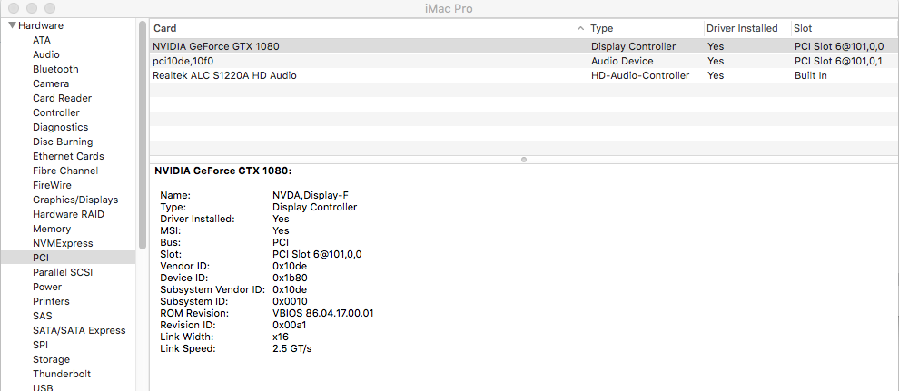

PCI Screen:
Bios:
i tried both Legacy enabled and disabled, and simulator enable/disabled.
