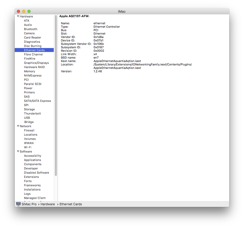

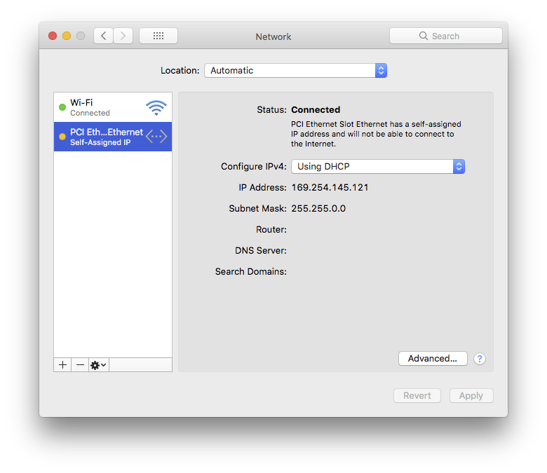

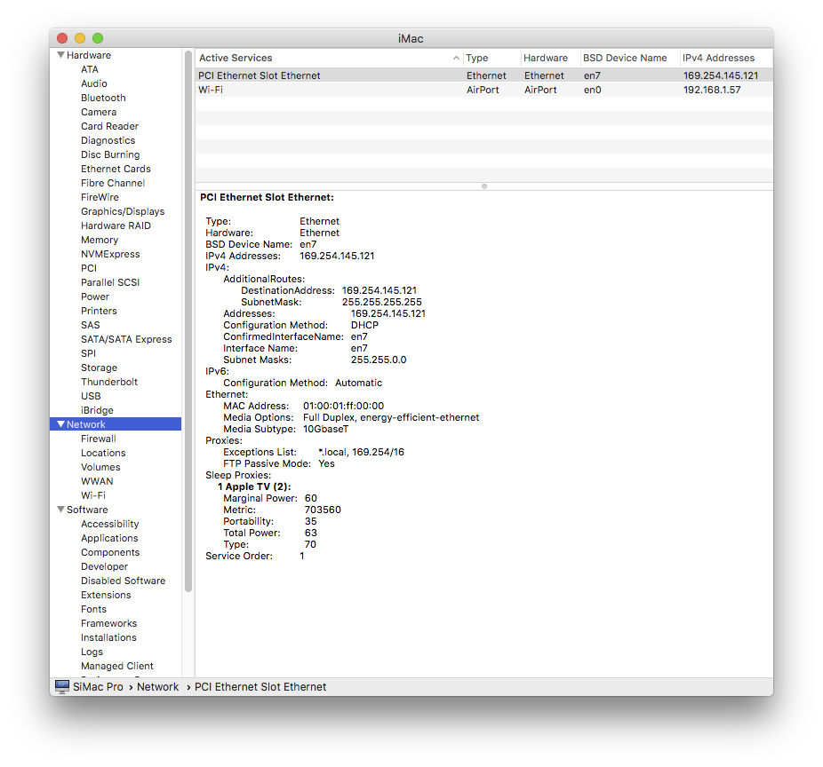

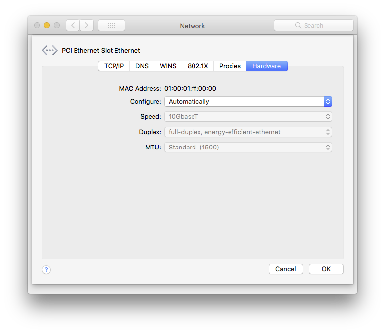

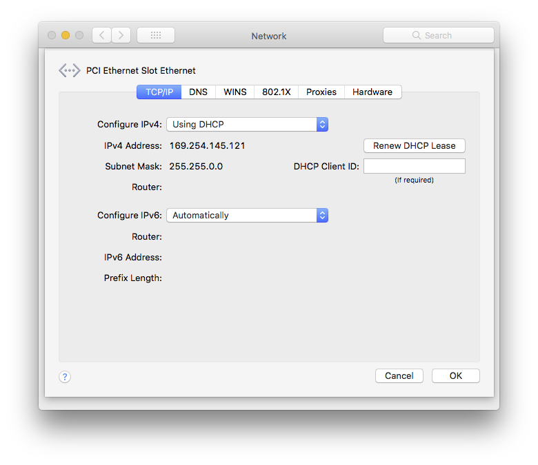

nainokami Posted March 18, 2018 Share Posted March 18, 2018 Hi I'm having a bit of trouble getting the ASUS XG-C100C to work in my hackintosh. I'm running 10.13.3 and it seems the card has successfully been patched as it's showing as an Apple AQC107-AFW, but the card has a bogus MAC of 01:00:01:ff:00:00 and only gets a self-assigned IP. Assigning an IP doesn't help. However, it negotiates the speed correctly... What am I missing? Link to comment https://www.insanelymac.com/forum/topic/330614-marvell-aquantia-10-gb-ethernet-support-thread/page/5/#findComment-2604004 Share on other sites More sharing options...

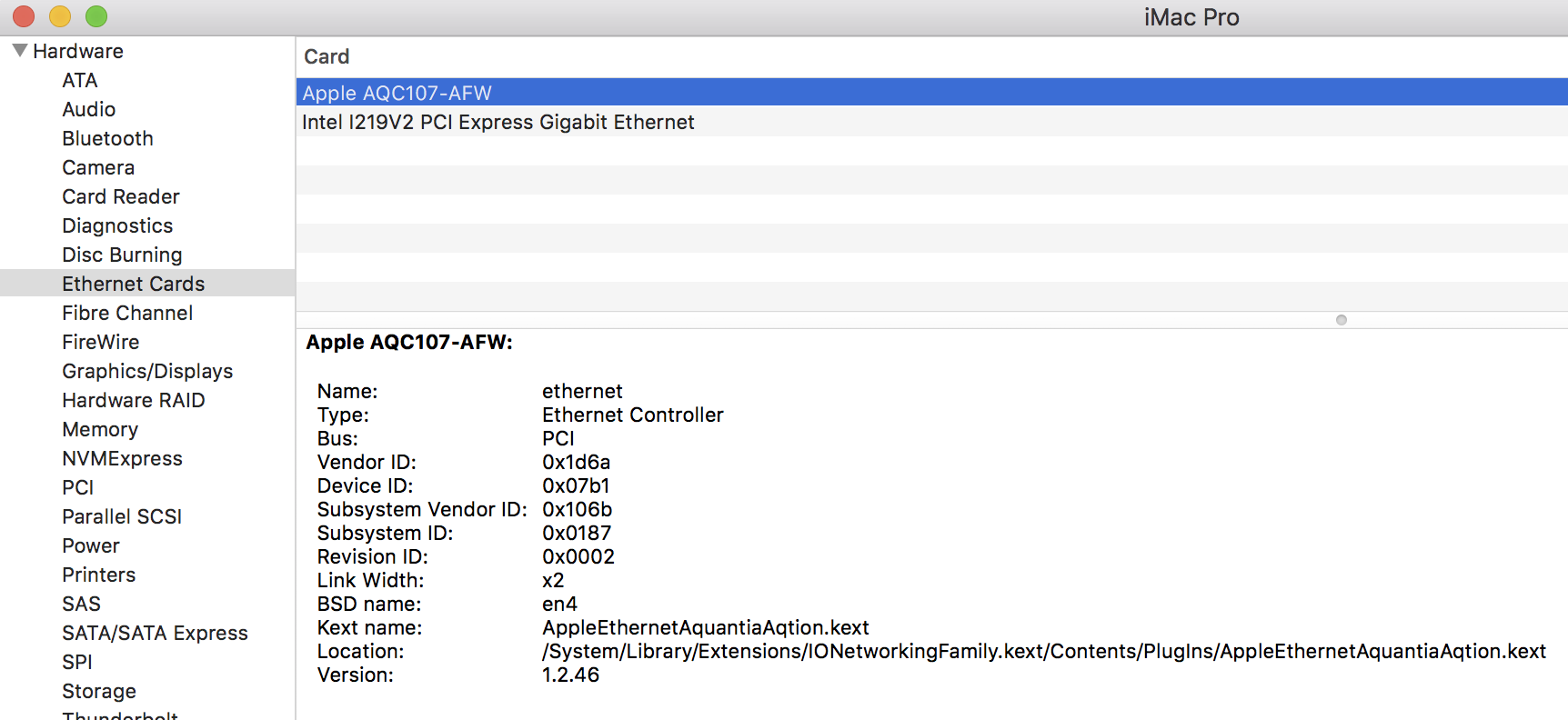

123456789323 Posted March 21, 2018 Share Posted March 21, 2018 Goodness... For all where it doesn’t work any more!!! Just Install or reinstall the Apple bootcamp drivers for this card and that’s it! It will work! Bootcamp driver : https://www.dropbox.com/s/94p4wsxgkbegeck/Aquantia64v2.0.015.0.zip?dl=0 Link to comment https://www.insanelymac.com/forum/topic/330614-marvell-aquantia-10-gb-ethernet-support-thread/page/5/#findComment-2604761 Share on other sites More sharing options...
d5aqoep Posted March 21, 2018 Author Share Posted March 21, 2018 1 hour ago, DSM2 said: Goodness... For all where it doesn’t work any more!!! Just Install or reinstall the Apple bootcamp drivers for this card and that’s it! It will work! Bootcamp driver : https://www.dropbox.com/s/94p4wsxgkbegeck/Aquantia64v2.0.015.0.zip?dl=0 LMAO! You sir are on a different tangent all together. We are talking about getting this card to work in macOS which is the point of this forum. Right now from macOS 10.13.4 Beta 3, the card stopped getting detected. Everyone knows that the card works with that driver you posted in Windows. The same link is already there on the first post of this topic. However, with those Bootcamp drivers for Windows, my card shows network cable unplugged if my PC boots into Windows from a shutdown. If I restart Windows, it works as intended. Link to comment https://www.insanelymac.com/forum/topic/330614-marvell-aquantia-10-gb-ethernet-support-thread/page/5/#findComment-2604767 Share on other sites More sharing options...
123456789323 Posted March 21, 2018 Share Posted March 21, 2018 Oh well if you still don’t get It... you have to install it again in windows and afterwards it will work with the newest beta aswell... Link to comment https://www.insanelymac.com/forum/topic/330614-marvell-aquantia-10-gb-ethernet-support-thread/page/5/#findComment-2604789 Share on other sites More sharing options...
d5aqoep Posted March 21, 2018 Author Share Posted March 21, 2018 (edited) No it doesn't work. Tried it twice. It's absurd logic for me. Someone else got it to work? @DSM2 The screenshot of driver version you are showing is from 10.13.3 (1.2.46) In 10.13.4 betas, they regressed to driver version (1.0.49) 10.13.2 Final -> 1.0.32 10.13.3 Final -> 1.2.46 10.13.4 Beta -> 1.0.49 Edited March 21, 2018 by d5aqoep Link to comment https://www.insanelymac.com/forum/topic/330614-marvell-aquantia-10-gb-ethernet-support-thread/page/5/#findComment-2604799 Share on other sites More sharing options...
ydeng Posted March 21, 2018 Share Posted March 21, 2018 2 hours ago, DSM2 said: Oh well if you still don’t get It... you have to install it again in windows and afterwards it will work with the newest beta aswell... You have funny link width x2. Link to comment https://www.insanelymac.com/forum/topic/330614-marvell-aquantia-10-gb-ethernet-support-thread/page/5/#findComment-2604824 Share on other sites More sharing options...

123456789323 Posted March 21, 2018 Share Posted March 21, 2018 (edited) To be honest I‘ve did not test it on my own rig. i‘ve uploaded the files for an other member ( boot camp drivers and also if I remember correct the old Kext ). He send me the picture after he had installed it. He was before doing that on the latest beta but maybe he installed 10.13.3 again. I will ask him later. Sorry for inconvenience... But maybe I can help you guys anyway. Since there is a new MacOS driver even in beta, there should also be one as a bootcamp driver. Will download the latest one later. Maybe there is also a new version out. Edited March 21, 2018 by DSM2 Link to comment https://www.insanelymac.com/forum/topic/330614-marvell-aquantia-10-gb-ethernet-support-thread/page/5/#findComment-2604850 Share on other sites More sharing options...
nainokami Posted March 21, 2018 Share Posted March 21, 2018 On 3/20/2018 at 2:59 AM, meaganmargaret said: Try assigning a static ip and see if it can transfer data. My first Aquantia came up like yours, and a static ip fixed it. But then after a few system restarts, DHCP started to work on it. Thanks, Mieze! Sadly, I've had no luck with either countless restarts or assigning a static IP... It says it's connected if I assign it a manual IP, router and DNS, but nothing's coming through. Link to comment https://www.insanelymac.com/forum/topic/330614-marvell-aquantia-10-gb-ethernet-support-thread/page/5/#findComment-2604875 Share on other sites More sharing options...
