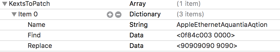

Mieze Posted March 30, 2018 Share Posted March 30, 2018 As promised, I started reverse engineering the driver after installing the final release of 10.13.4 and found the following code section in the drivers start() routine. 14c8: e8 55 20 00 00 callq 3522 <AppleEthernetAquantiaAqtion::checkConfigSupport(int&, int&)> 14cd: 41 83 3c 24 00 cmpl $0x0,(%r12) 14d2: 0f 84 c0 03 00 00 je 1898 <AppleEthernetAquantiaAqtion::start(IOService*)+0x5e6> In earlier versions the driver already checked certain hash values in order to identify Apple devices but with 10.13.4 they added a new function called checkConfigSupport() where they perform these checks and they have added more hash values to check helping to distinguish original Apple NICs from flashed 3rd party device and in case checkConfigSupport() returns 0, the driver will refuse the device. I haven't found the time to reverse engineer checkConfigSupport() in detail but I patched the "je" instruction which causes the driver to fail in case of the return value 0. Now it works. Here is the Clover patch I created. As you can see, the Aquantia NIC shows up in System Profiler and successfully acquires an IP address. Next step would be a complete reverse engineering of checkConfigSupport() but I haven't found time for it. In order to enable the driver's debug output, you might want to add "apple-axge-debug=0xff" to your kernel flags. Have fun! Mieze 6 3 Link to comment https://www.insanelymac.com/forum/topic/330614-marvell-aquantia-10-gb-ethernet-support-thread/page/6/#findComment-2606530 Share on other sites More sharing options...
tech8086 Posted March 30, 2018 Share Posted March 30, 2018 Thanks Mieze, that works great. Link to comment https://www.insanelymac.com/forum/topic/330614-marvell-aquantia-10-gb-ethernet-support-thread/page/6/#findComment-2606557 Share on other sites More sharing options...

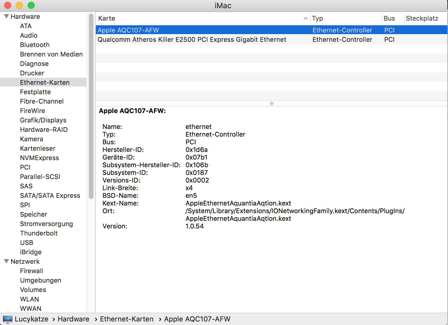

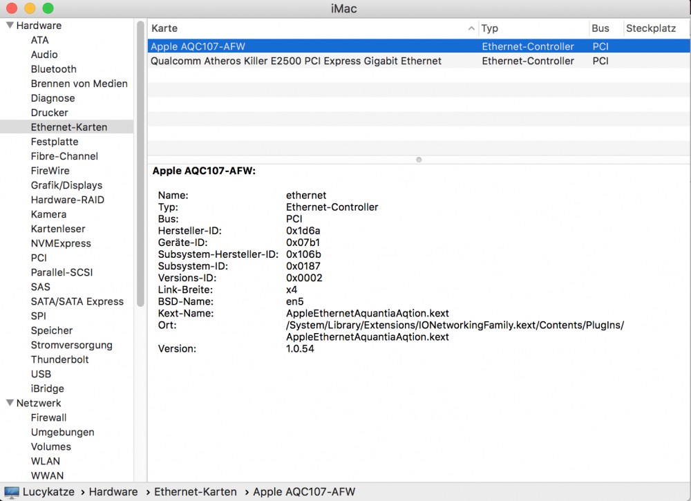

d5aqoep Posted April 2, 2018 Author Share Posted April 2, 2018 Aquantia engineer managed to Flash updated firmware on my ASUS Card and changed the subsystemID back to original. So with the new patch on 10.13.4 my card is getting detected as this Network cable comes up as unplugged and forceful firmware upgrade is not taking place because my card is already on higher firmware version. Now what can be done to get rid of cable unplugged problem? I may need to spoof it as Apple card. Link to comment https://www.insanelymac.com/forum/topic/330614-marvell-aquantia-10-gb-ethernet-support-thread/page/6/#findComment-2607138 Share on other sites More sharing options...

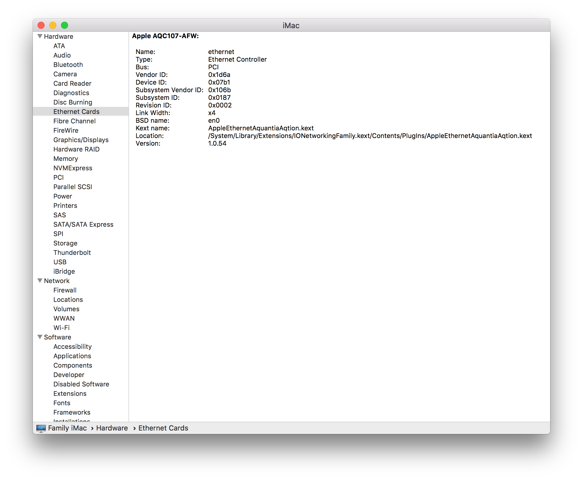

hnak Posted April 2, 2018 Share Posted April 2, 2018 On 2018/3/31 at 1:18 AM, jya said: It's not showing up in the PCI device list? It exists as a PCI device, of course. Thanks to the Mieze patch, it now appears as an Ethernet card on 10.13.4. Link to comment https://www.insanelymac.com/forum/topic/330614-marvell-aquantia-10-gb-ethernet-support-thread/page/6/#findComment-2607158 Share on other sites More sharing options...
