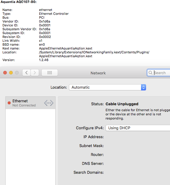

Dogman Posted February 6, 2018 Share Posted February 6, 2018 I installed 10.13.2 and updated with the combo updater, but still the same result: device id is 0x0001 As long as I have the Asus card in my hackintosh, some boots crash somewhere around the Aquantia kexts. Next boot seems to be fine. Where can I find the boot log? I can't find the lines from above in my system.log Link to comment https://www.insanelymac.com/forum/topic/330614-marvell-aquantia-10-gb-ethernet-support-thread/page/4/#findComment-2585585 Share on other sites More sharing options...
vicmarto Posted February 6, 2018 Share Posted February 6, 2018 I installed 10.13.2 and updated with the combo updater, but still the same result: device id is 0x0001 As long as I have the Asus card in my hackintosh, some boots crash somewhere around the Aquantia kexts. Next boot seems to be fine. Where can I find the boot log? I can't find the lines from above in my system.log Hello Dogman, Did you tried the "macOS High Sierra 10.13.3 Update for iMac Pro"? https://support.apple.com/kb/DL1952 Or the normal "macOS High Sierra 10.13.3 Combo Update" https://support.apple.com/kb/DL1954 But, I'm not sure if this makes a difference... Link to comment https://www.insanelymac.com/forum/topic/330614-marvell-aquantia-10-gb-ethernet-support-thread/page/4/#findComment-2585597 Share on other sites More sharing options...
Dogman Posted February 6, 2018 Share Posted February 6, 2018 I used the normal update, I guess. d5aqoep told me to update via the App Store, but I don't have an internet connection when I only enable the Asus NIC. Maybe I could download it, reboot and then start the update? Link to comment https://www.insanelymac.com/forum/topic/330614-marvell-aquantia-10-gb-ethernet-support-thread/page/4/#findComment-2585612 Share on other sites More sharing options...
d5aqoep Posted February 6, 2018 Author Share Posted February 6, 2018 I installed 10.13.2 and updated with the combo updater, but still the same result: device id is 0x0001 As long as I have the Asus card in my hackintosh, some boots crash somewhere around the Aquantia kexts. Next boot seems to be fine. Where can I find the boot log? I can't find the lines from above in my system.log Is your ASUS card on en0 ? Link to comment https://www.insanelymac.com/forum/topic/330614-marvell-aquantia-10-gb-ethernet-support-thread/page/4/#findComment-2585668 Share on other sites More sharing options...
Dogman Posted February 6, 2018 Share Posted February 6, 2018 Yes, I disabled onboard LAN and checked before updating: it's en0 Link to comment https://www.insanelymac.com/forum/topic/330614-marvell-aquantia-10-gb-ethernet-support-thread/page/4/#findComment-2585675 Share on other sites More sharing options...
d5aqoep Posted February 6, 2018 Author Share Posted February 6, 2018 Yes, I disabled onboard LAN and checked before updating: it's en0 Something wrong with your Device ID and Subsystem ID both are 0x0001 Compare that to my card before firmware upgrade Link to comment https://www.insanelymac.com/forum/topic/330614-marvell-aquantia-10-gb-ethernet-support-thread/page/4/#findComment-2585689 Share on other sites More sharing options...
Dogman Posted February 6, 2018 Share Posted February 6, 2018 Do you think I could fake my device id to 0xd107 to get the update? Link to comment https://www.insanelymac.com/forum/topic/330614-marvell-aquantia-10-gb-ethernet-support-thread/page/4/#findComment-2585711 Share on other sites More sharing options...
d5aqoep Posted February 6, 2018 Author Share Posted February 6, 2018 If you can but for me and most of us, we did not need to fake any Device ID. What device ID does it show in Windows 10's Device manager? Link to comment https://www.insanelymac.com/forum/topic/330614-marvell-aquantia-10-gb-ethernet-support-thread/page/4/#findComment-2585734 Share on other sites More sharing options...
Dogman Posted February 7, 2018 Share Posted February 7, 2018 Windows 7 Looks fine:PCI\VEN_1D6A&DEV_D107&SUBSYS_87411043&REV_02Maybe it the second revision that creates the problem? EDIT: now macOS displays Vendor 0x1d6a Device 0xd107 SubsystemVendor 0x1043 and Subsytem id 0x8741 But my cable is still "unplugged". Will look into this later... Link to comment https://www.insanelymac.com/forum/topic/330614-marvell-aquantia-10-gb-ethernet-support-thread/page/4/#findComment-2586406 Share on other sites More sharing options...
Mieze Posted February 7, 2018 Share Posted February 7, 2018 Windows 7 Looks fine: PCI\VEN_1D6A&DEV_D107&SUBSYS_87411043&REV_02 Maybe it the second revision that creates the problem? EDIT: now macOS displays Vendor 0x1d6a Device 0xd107 SubsystemVendor 0x1043 and Subsytem id 0x8741 But my cable is still "unplugged". Will look into this later... As the subsystem vendor ID shows, the update failed. 0x1043 is ASUStek but it should be 0x106b for Apple after a successful firmware update. Mieze Link to comment https://www.insanelymac.com/forum/topic/330614-marvell-aquantia-10-gb-ethernet-support-thread/page/4/#findComment-2586673 Share on other sites More sharing options...
d5aqoep Posted February 7, 2018 Author Share Posted February 7, 2018 Windows 7 Looks fine: PCI\VEN_1D6A&DEV_D107&SUBSYS_87411043&REV_02 Maybe it the second revision that creates the problem? EDIT: now macOS displays Vendor 0x1d6a Device 0xd107 SubsystemVendor 0x1043 and Subsytem id 0x8741 But my cable is still "unplugged". Will look into this later... Try restarting macOS 2-3 times. Many have had luck once the firmware update is complete. Make sure you have bare minimal clover patches and kexts in hopes that some patch or kext is preventing successful firmware update. Link to comment https://www.insanelymac.com/forum/topic/330614-marvell-aquantia-10-gb-ethernet-support-thread/page/4/#findComment-2586725 Share on other sites More sharing options...
