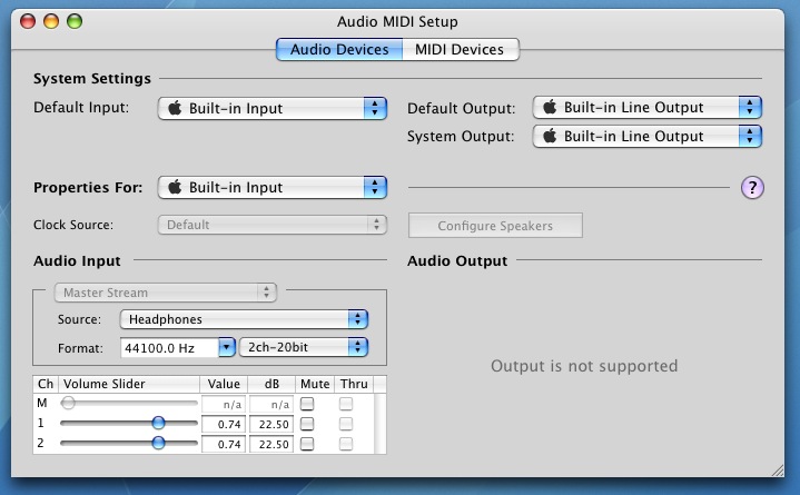

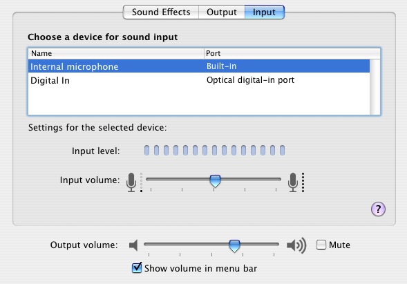

Stiffy Posted December 5, 2006 Share Posted December 5, 2006 Here my audio-midi setup: Link to comment https://www.insanelymac.com/forum/topic/32859-applehda-solution-work-in-progress/page/15/#findComment-248840 Share on other sites More sharing options...

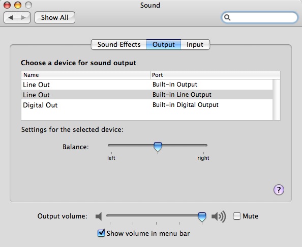

skippyretard Posted December 5, 2006 Share Posted December 5, 2006 stiffy, I need output info not input, thanks... have you tried ALC883/888Alpha on your AsRock mobo? geo2002, do you have anything listed in Preferences>Sound>Output ? the kext seems to detect ports using the digital port as a guide. I think that is why most laptops do not work, they have no pin config for a digital port. Taruga, can you confirm this? Link to comment https://www.insanelymac.com/forum/topic/32859-applehda-solution-work-in-progress/page/15/#findComment-248845 Share on other sites More sharing options...

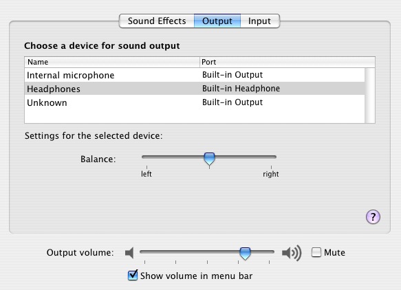

geo2002 Posted December 5, 2006 Share Posted December 5, 2006 stiffy, I need output info not input, thanks... have you tried ALC883/888Alpha on your AsRock mobo? geo2002, do you have anything listed in Preferences>Sound>Output ? the kext seems to detect ports using the digital port as a guide. I think that is why most laptops do not work, they have no pin config for a digital port. Taruga, can you confirm this? I've fixed my previous post. Your driver works fine! It was my mistake - I've forgotten to fix mode and owner for the kexts. Now all works. Thanks! Link to comment https://www.insanelymac.com/forum/topic/32859-applehda-solution-work-in-progress/page/15/#findComment-248856 Share on other sites More sharing options...

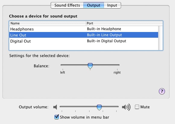

skippyretard Posted December 6, 2006 Share Posted December 6, 2006 (edited) Aberracus, blue output is not working yet if thats what your asking. I have this one setup to test 5.1 sound, but I don't have anybody who knows how to test it. skeewiff, what audio codec do you have? geo2002, I'm happy to hear you got it working! that is now 2 laptops reported working. anyone test on ALC888 yet? Sigmatel Alpha for 9220/9223 attached <KEXT REMOVED> Edited December 22, 2006 by skippyretard Link to comment https://www.insanelymac.com/forum/topic/32859-applehda-solution-work-in-progress/page/15/#findComment-248864 Share on other sites More sharing options...
Sabr Posted December 6, 2006 Share Posted December 6, 2006 Here my audio-midi setup: Stiffy, please could you outline the steps you did in order to get these kexts working? I'm running the DS3 and I can't get them to work at all. SABR. Link to comment https://www.insanelymac.com/forum/topic/32859-applehda-solution-work-in-progress/page/15/#findComment-248897 Share on other sites More sharing options...
Stiffy Posted December 6, 2006 Share Posted December 6, 2006 Alpha combo for ALC883/888. If you downloaded ALC883Alpha2 you do not need to download this, nothing has changed for 883. I may have possibly but not sure added support for 888 users to the same kext. This is for all Intel chipsets(ICH6, ICH7 and ICH8). If it works for both I will try to add support for VIA and nVidia chipsets. If you have this or ALC883Alpha2 working on a desktop board, please look in /Applications/Utilities/Audio MIDI Setup and tell me if either output has 4ch sound. Report: ALC888 on Asrock 945G-DVI, still no kexts loaded, no input/output devices in System Preferences! Stiffy, please could you outline the steps you did in order to get these kexts working? I'm running the DS3 and I can't get them to work at all. SABR. I just uncompressed the 2 kexts to Extensions directory and repaired permissions / update kextcache, reboot. Link to comment https://www.insanelymac.com/forum/topic/32859-applehda-solution-work-in-progress/page/15/#findComment-248899 Share on other sites More sharing options...

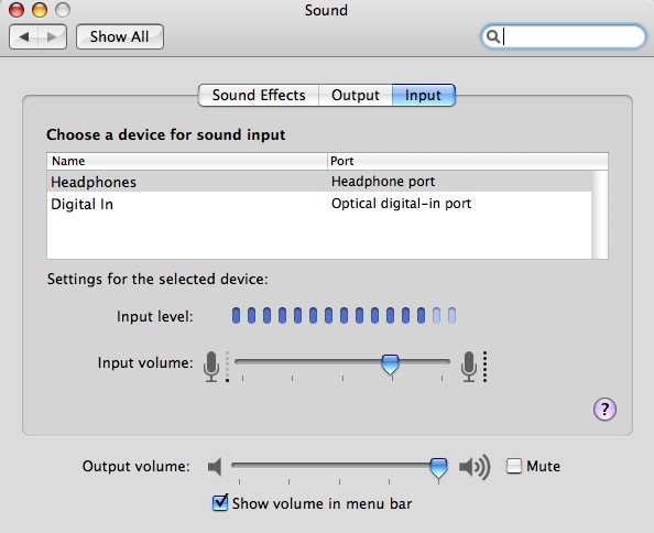

Ezhoon Posted December 6, 2006 Share Posted December 6, 2006 Skippy's Alc883alpha2 works on my Gigabyte 965P DS3 mobo Mobo: Gigabyte 965P-DS3 South-Bridge: ICH8 Codec: ALC883 OSX: Jas 10.4.8 reseed Kernel: Mifki 8.8.1 (DaemonES modded) 2 channel stereo output works but, there is no mic-in displayed under input section. only input device shown is "headphone port" Now, I am convinced that this AppleHDA.kext just produces better sound than AppleAzalia.kext. I watched Blade trinity HD, the dialog is much clearer, well separated and the base is firmer too. Thanks Skippy for your work, really appreciated! Link to comment https://www.insanelymac.com/forum/topic/32859-applehda-solution-work-in-progress/page/15/#findComment-249116 Share on other sites More sharing options...

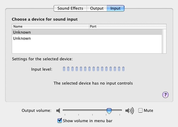

tokra128 Posted December 6, 2006 Share Posted December 6, 2006 well, tested on a sigmatel 9220, and still nothing, the kext give no errors, but ... it is not working ! no device show on the control center Link to comment https://www.insanelymac.com/forum/topic/32859-applehda-solution-work-in-progress/page/15/#findComment-249179 Share on other sites More sharing options...
