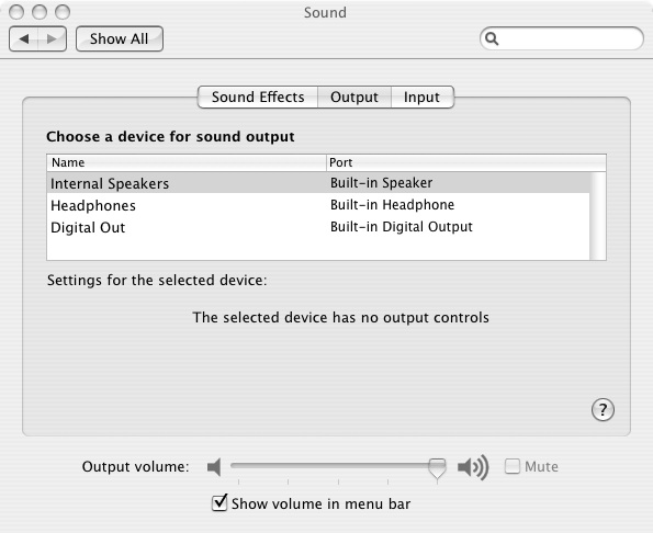

I've installed AppleHDAPatcher 1.20 with a ALC888 dumb, sound works only on 2 channels, microphone and digital output.

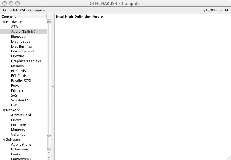

but! AUDIO dosent working! intel High Definition Audio (AD1986A)!
but ist not the only problem!  the wifi is not working and the integrated web cam!
maby somebpdy know what to do? please!
iv tried to install the ad1986a thru the patcher but the system is crashing!

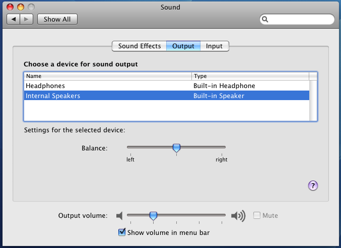

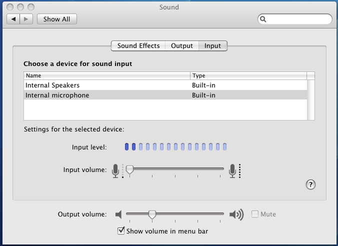

ufter instaling the ad1986 (AD1986 0x11d41986 for testing)
and this what i geting! still no sound! but until now there wasent even that!
i have ad1986a
ok! i have sound! from the headphones only!
and the sound quallty is horreble!
no sound from speachkers and in mic.
