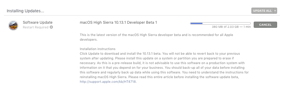

fantomas Posted September 27, 2017 Share Posted September 27, 2017 New seed... macOS High Sierra 10.13.1 beta (17B25c) 7 Link to comment https://www.insanelymac.com/forum/topic/327625-pre-release-macos-high-sierra-10131/ Share on other sites More sharing options...
mnfesq Posted September 27, 2017 Share Posted September 27, 2017 Wow! 2.03 GB update. 1 Link to comment https://www.insanelymac.com/forum/topic/327625-pre-release-macos-high-sierra-10131/#findComment-2502160 Share on other sites More sharing options...

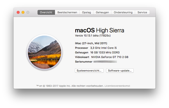

Kynyo Posted September 28, 2017 Share Posted September 28, 2017 System Version: macOS 10.13.1 (17B25c) Kernel Version: Darwin 17.2.0 Boot Volume: macOS Boot Mode: Normal Secure Virtual Memory: Enabled System Integrity Protection: Disabled Time since boot: 3 minutes All good. Installed just NVWebDriverLibValFix.kext to be safe. Not any patches at all. iMac 14,2. Ozmosis. 1 Link to comment https://www.insanelymac.com/forum/topic/327625-pre-release-macos-high-sierra-10131/#findComment-2502907 Share on other sites More sharing options...

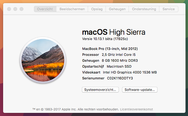

Guest ricoc90 Posted September 28, 2017 Share Posted September 28, 2017 What was the fix for "OSInstall.mpkg appears to be missing or damaged" again? Trying to install the 10.13.1 beta 1 update, but it gives me this error. Never had this before Clover r4223, Legacy in ESP. EDIT: Strange. The update went without any issues on my Probook, but on my Optiplex 790 I keep getting the above error. All drives (except macOS of course) disconnected EDIT2: Cleared nvram cache, redownloaded the update (again...) and now it installed fine. Link to comment https://www.insanelymac.com/forum/topic/327625-pre-release-macos-high-sierra-10131/#findComment-2503007 Share on other sites More sharing options...

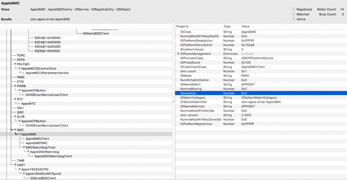

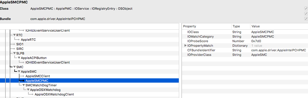

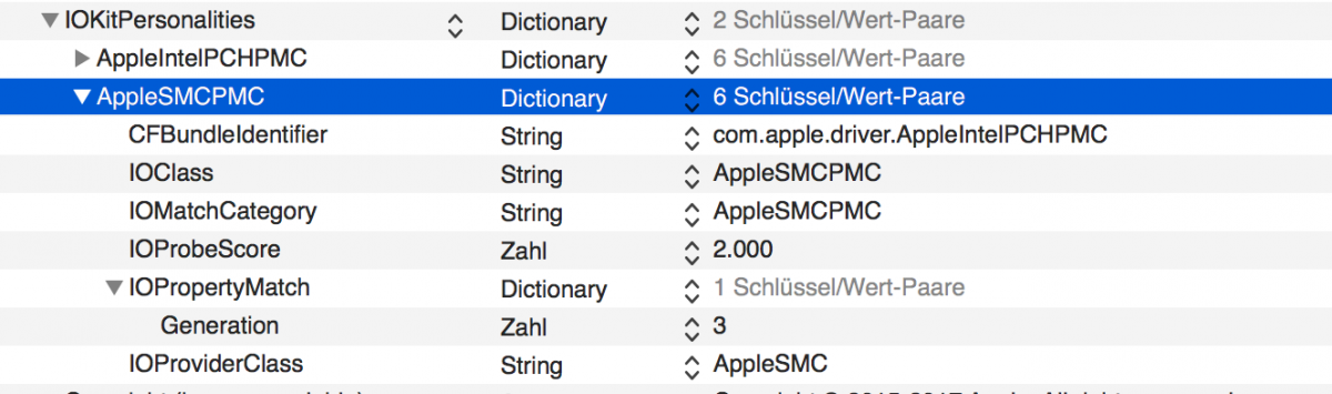

truemac Posted September 28, 2017 Share Posted September 28, 2017 new 'AppleSMCPMC' Required SMC Generation 3 to load. 1 Link to comment https://www.insanelymac.com/forum/topic/327625-pre-release-macos-high-sierra-10131/#findComment-2503609 Share on other sites More sharing options...
Allan Posted September 28, 2017 Share Posted September 28, 2017 Required SMC Generation 3 to load. How we can know which generation we have? Link to comment https://www.insanelymac.com/forum/topic/327625-pre-release-macos-high-sierra-10131/#findComment-2503634 Share on other sites More sharing options...
truemac Posted September 29, 2017 Share Posted September 29, 2017 How we can know which generation we have? you see it in ioregexplorer i believe that you have generation 2? but you can change it via smc-key RGEN [ui8 ] 3 (bytes 03 1 Link to comment https://www.insanelymac.com/forum/topic/327625-pre-release-macos-high-sierra-10131/#findComment-2503673 Share on other sites More sharing options...
mitch_de Posted September 29, 2017 Share Posted September 29, 2017 Do i understand rigth, the new AppleSMCPMC (new in HS?) needs an new smc-key RGEN [ui8 ] to get loaded. And that key will be added by some newer Fakesmc versions? But for what is AppleSMCPMC used and what happens (most didt have it) if it isnt loaded.? Thanks Link to comment https://www.insanelymac.com/forum/topic/327625-pre-release-macos-high-sierra-10131/#findComment-2503774 Share on other sites More sharing options...
SavageAUS Posted September 29, 2017 Share Posted September 29, 2017 My laptop took the .1 beta with no issues but has caused nothing but grief with my desktop. Desktop refuses to finish .1 beta installation, boots to nothing. Maybe ill just stick to testing on my laptop on keep desktop for official point releases. Link to comment https://www.insanelymac.com/forum/topic/327625-pre-release-macos-high-sierra-10131/#findComment-2503820 Share on other sites More sharing options...

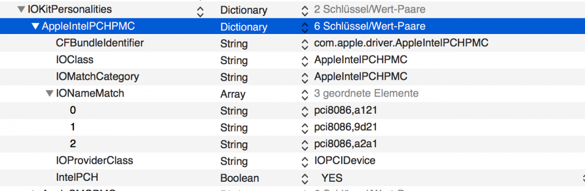

truemac Posted September 29, 2017 Share Posted September 29, 2017 Do i understand rigth, the new AppleSMCPMC (new in HS?) needs an new smc-key RGEN [ui8 ] to get loaded. And that key will be added by some newer Fakesmc versions? But for what is AppleSMCPMC used and what happens (most didt have it) if it isnt loaded.? Thanks the Generation smc-key is used since first beta of HS and the AppleSMCPMC Client since 10.13.1. and can be added to any fakesmc. i think but I'm not sure that has something to do with power management, we need more test to know it. Edit: its a part of AppleIntelPCHPMC.kext by the way apple added pci8086,a2a1 device id for intel 200 series chipset into AppleIntelPCHPMC.kext 4 Link to comment https://www.insanelymac.com/forum/topic/327625-pre-release-macos-high-sierra-10131/#findComment-2503888 Share on other sites More sharing options...

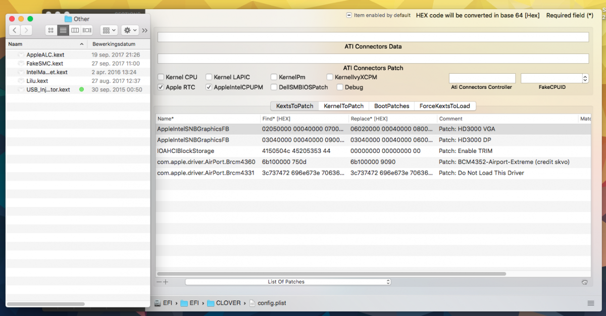

macq Posted September 29, 2017 Share Posted September 29, 2017 Hi, @Sherlocks, Neodarkman, Others has there been a change in the broadcom wireless patches for 10.13.1 or something? Back to not being able to turn the wifi on. My card is Broadcom BCM4352 Azurewave AW-CE123H WiF i+ BT 867Mbps Bluetooth 4.0 Hackintosh. older patches produce kernel panic. am on clover 4223 Please help Link to comment https://www.insanelymac.com/forum/topic/327625-pre-release-macos-high-sierra-10131/#findComment-2504008 Share on other sites More sharing options...
Slice Posted September 29, 2017 Share Posted September 29, 2017 you see it in ioregexplorer i believe that you have generation 2? but you can change it via smc-key RGEN [ui8 ] 3 (bytes 03 Interesting found! Link to comment https://www.insanelymac.com/forum/topic/327625-pre-release-macos-high-sierra-10131/#findComment-2504042 Share on other sites More sharing options...
Allan Posted September 29, 2017 Share Posted September 29, 2017 you see it in ioregexplorer i believe that you have generation 2? but you can change it via smc-key RGEN [ui8 ] 3 (bytes 03 Hmm I'll check it here. My hack uses the 3º gen of Intel CPUs, that's why I'm worried about. Problems with PM get me nuts! Thanks for the info buddy 1 Link to comment https://www.insanelymac.com/forum/topic/327625-pre-release-macos-high-sierra-10131/#findComment-2504452 Share on other sites More sharing options...
mitch_de Posted September 29, 2017 Share Posted September 29, 2017 What in meaning "generation"? SMC generation (like SMC version) or cpu generation (IVY, SANDY, SKYLAKE, ...) or intel chipset generation ? Thanks Link to comment https://www.insanelymac.com/forum/topic/327625-pre-release-macos-high-sierra-10131/#findComment-2504599 Share on other sites More sharing options...
truemac Posted September 29, 2017 Share Posted September 29, 2017 What in meaning "generation"? SMC generation (like SMC version) or cpu generation (IVY, SANDY, SKYLAKE, ...) or intel chipset generation ? Thanks I think its the same as other products from apple like AppleTV Gen. 1/2/3/4/5, and here is it for the smc chipset . 1 Link to comment https://www.insanelymac.com/forum/topic/327625-pre-release-macos-high-sierra-10131/#findComment-2504683 Share on other sites More sharing options...

SavageAUS Posted October 1, 2017 Share Posted October 1, 2017 Hi, @Sherlocks, Neodarkman, Others has there been a change in the broadcom wireless patches for 10.13.1 or something? Back to not being able to turn the wifi on. My card is Broadcom BCM4352 Azurewave AW-CE123H WiF i+ BT 867Mbps Bluetooth 4.0 Hackintosh. older patches produce kernel panic. am on clover 4223 Please help I personally only use 1 patch plus kexts. FakePCIID.kext FakePCIID_Broadcom_WiFi.kext <dict> <key>Comment</key> <string>10.11+-BT4LE-Handoff-Hotspot-lisai9093</string> <key>Disabled</key> <false/> <key>Find</key> <data>SIX/dEdIiwc=</data> <key>Name</key> <string>IOBluetoothFamily</string> <key>Replace</key> <data>Qb4PAAAA60Q=</data> </dict> </plist> <dict> <key>WIFI</key> <string>0x43a014E4</string> </dict> </plist> 1 Link to comment https://www.insanelymac.com/forum/topic/327625-pre-release-macos-high-sierra-10131/#findComment-2505842 Share on other sites More sharing options...
macq Posted October 1, 2017 Share Posted October 1, 2017 @savageAUS yeah got it going the same way earlier Thanks Link to comment https://www.insanelymac.com/forum/topic/327625-pre-release-macos-high-sierra-10131/#findComment-2505956 Share on other sites More sharing options...

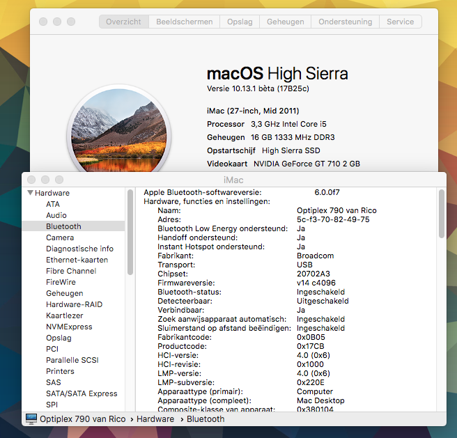

Guest ricoc90 Posted October 1, 2017 Share Posted October 1, 2017 I figured that in High Sierra I don't need the handoff patch anymore on my Asus BT400 bluetooth dongle, Handoff is supported OOB. Link to comment https://www.insanelymac.com/forum/topic/327625-pre-release-macos-high-sierra-10131/#findComment-2505994 Share on other sites More sharing options...
