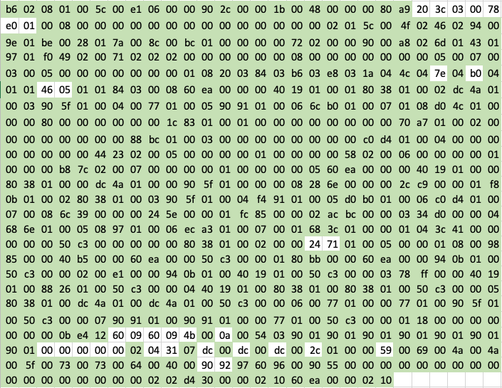

douirc Posted October 31, 2018 Share Posted October 31, 2018 7 hours ago, CMMChris said: Updated PPT Generator. More settings and issue fixed, got something wrong in the initial version. vega64-mac-pp_table-gen.xlsx Hi CMMChris, was doing more research and wanted to compare the powertable from win10 vs table in your XLS. Not sure if this is the same table in your VegaTab_64.kext but the results are very similar. Wanted to get your feedback. Link to comment https://www.insanelymac.com/forum/topic/325120-vega-frontier-edition-on-high-sierra/page/20/#findComment-2644270 Share on other sites More sharing options...

Pval2 Posted November 1, 2018 Share Posted November 1, 2018 (edited) 14 hours ago, CMMChris said: PP_Tables can look different depending on the card. The one inside my generator is extracted from my V64 Gaming OC BIOS. Hey Chris, I'm trying to modify the PP_Table of a liquid cooled Vega64, but the table is shorter and has different header, as far as I can see. How can I change your excel file to accommodate this? VGTab seems to generate the same length (shorter) as hellm's linked files. Thanks! PS. I inspected my PP_Table, extracted from my original bios, it's also shorter. offset 37254 : 669 bytes long Edited November 1, 2018 by Pval2 Link to comment https://www.insanelymac.com/forum/topic/325120-vega-frontier-edition-on-high-sierra/page/20/#findComment-2644368 Share on other sites More sharing options...
CMMChris Posted November 1, 2018 Share Posted November 1, 2018 (edited) Another new version of my Excel generator with ready to copy output to place inside the .plist files. (FILE DELETED, NEW VERSION HERE!) @Mike Ranger It's normal. Does the same on my card on Windows when controlling it with a PPT instead of Wattman. @Pval2 Try using the PPT generated by my Excel generator. Might still work. If it doesn't, you need to reverse engineer the PPT of your card and create your own generator for it. Edited November 2, 2018 by CMMChris Link to comment https://www.insanelymac.com/forum/topic/325120-vega-frontier-edition-on-high-sierra/page/20/#findComment-2644401 Share on other sites More sharing options...

Pval2 Posted November 1, 2018 Share Posted November 1, 2018 (edited) 1 hour ago, CMMChris said: You don't need a PPT for the cards officially supported by Apple. Dunno what's different with them. Would be interesting to extract a PPT from their VGA BIOS. You can simply get the BIOS with ioreg: ioreg -l -n display@0 -r | grep ATY,bin_image Might be at another display (@0 / @1 / etc), but you get the idea. From looking at mine, the PPT starts at offset 37254. The PP_PhmSoftPowerPlayTable, if you're using one is there as well, as is a PP_PhmSoftWTTable? I've adapted your excel-sheet, I can confirm my Accoustic Limit (RPM) is set to 1500, which is exactly the rpm I'm seeing in ioreg. And Throttling (RPM) is set to 2300. I have seen another issue though, my fan RPM drops under load, by up to 33%, tested with Luxmark, Furmark, etc. Only when I quit; remove the load, will the fan RPM rise again, even above 1500 RPM, until the card is cool again. I have a bug report open with Apple, but they haven't told me anything yet. Monitor fanspeed / other PerformanceStatistics: # Grab the column headers from ioreg's output: ioreg -l -n display@0 -r |grep \"PerformanceStatistics\" | cut -d '{' -f 2 | tr '|' ',' | tr -d '}' | tr ',' '\n'|grep 'Temp\|Fan\|%\|(W)\|Hz'|cut -d\" -f2|tr '\n' ',' && printf '\n' # Grab the values every second: while true do ioreg -l -n display@0 -r |grep \"PerformanceStatistics\" | cut -d '{' -f 2 | tr '|' ',' | tr -d '}' | tr ',' '\n'|grep 'Temp\|Fan\|%\|(W)\|Hz'|cut -d\" -f3|tr -d '='|tr '\n' ',' && printf '\n' sleep 1 done Edited November 1, 2018 by Pval2 1 Link to comment https://www.insanelymac.com/forum/topic/325120-vega-frontier-edition-on-high-sierra/page/20/#findComment-2644439 Share on other sites More sharing options...
