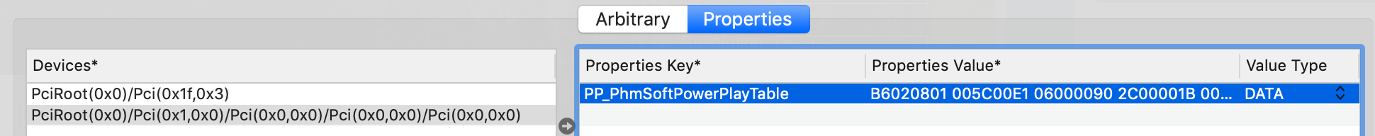

blouse Posted November 9, 2018 Share Posted November 9, 2018 On 10/8/2018 at 11:12 AM, max.1974 said: Basically you need use with your setting as you want, and insert PP_PhmSoftPowerPlayTable and codes on RadeonVegaLowFansSpeed.kext Try install with kext utility this: Silent Fan: already inserted settings... RadeonVegaLowFansSpeed.kext.zip After install and before restart your Mac run in terminal this command: sudo touch /System/Library/Extensions && sudo kextcache -u / Restart and enjoy... If not work or you need another settings, you can call me on pm !! I have two Sapphire Vega 64's (the regular 8GB HBM2 one, not FE/LE) and this works wonderfully to take the fan temps down. THANK YOU! I have my sanity back. However I am getting some crashes in C4D when rendering with ProRender, I think maybe I need to change the settings? Mojave 14.1 Sysdef: iMac14,2 Proc: i9 9900k Mobo: GB Aorus Z390 Pro Also, my OpenGL cinebench fps went from 190fps down to 120fps when I installed the second card. Not sure what that is all about I have attached the Sapphire cards' rated specs for reference (I have the 8GB HBM2) 1 Link to comment https://www.insanelymac.com/forum/topic/325120-vega-frontier-edition-on-high-sierra/page/23/#findComment-2646713 Share on other sites More sharing options...

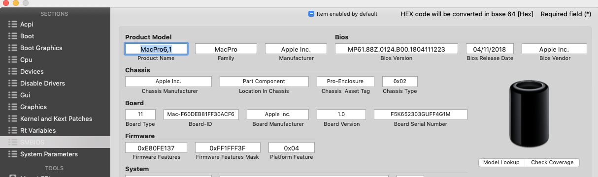

Pavo Posted November 9, 2018 Share Posted November 9, 2018 3 minutes ago, blouse said: I have two Sapphire Vega 64's (the regular 8GB HBM2 one, not FE/LE) and this works wonderfully to take the fan temps down. THANK YOU! I have my sanity back. However I am getting some crashes in C4D when rendering with ProRender, I think maybe I need to change the settings? Mojave 14.1 Sysdef: iMac14,2 Proc: i9 9900k Mobo: GB Aorus Z390 Pro Also, my OpenGL cinebench fps went from 190fps down to 120fps when I installed the second card. Not sure what that is all about I have attached the Sapphire cards' rated specs for reference (I have the 8GB HBM2) More than likely because you are using the wrong SMBIOs for your system specs, with a 9900k you should probably be using iMacPro1,1 instead of iMac14,2. One think it seems a lot of people are forgetting is SMBIOs matters for certain features to be enabled. Pretty sure eGPU setup isn't supported on iMac14,2. eGPUs are supported on any Thunderbolt 3-equipped Mac: MacBook Pro (2016) and newer1 iMac (2017) and newer iMac Pro Even though we aren't using eGPU setups we still have to apply the right SMBIOs in order for the OS to allow us to use the features in correct way. Link to comment https://www.insanelymac.com/forum/topic/325120-vega-frontier-edition-on-high-sierra/page/23/#findComment-2646720 Share on other sites More sharing options...
blouse Posted November 9, 2018 Share Posted November 9, 2018 18 minutes ago, Pavo said: More than likely because you are using the wrong SMBIOs for your system specs, with a 9900k you should probably be using iMacPro1,1 instead of iMac14,2. One think it seems a lot of people are forgetting is SMBIOs matters for certain features to be enabled. Pretty sure eGPU setup isn't supported on iMac14,2. eGPUs are supported on any Thunderbolt 3-equipped Mac: MacBook Pro (2016) and newer1 iMac (2017) and newer iMac Pro Even though we aren't using eGPU setups we still have to apply the right SMBIOs in order for the OS to allow us to use the features in correct way. That's very interesting. Yeah iMac14,2 seems verrry old to be using. I just tried iMacPro1,1 and it gave me the black screen at login. I wonder if I am missing something though? I tried it with the latest Lilu and Whatevergreen in EFI/CLOVER/kexts/Other, and without Whatevergreen as well. Also I should note, my Sapphire Vega 64's are plugged straight into the machine (not through eGPU). Thank you for the help Link to comment https://www.insanelymac.com/forum/topic/325120-vega-frontier-edition-on-high-sierra/page/23/#findComment-2646724 Share on other sites More sharing options...

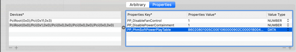

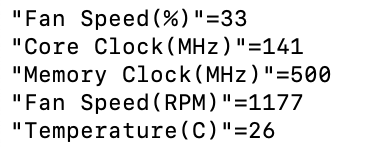

Pluskat5000Schiffe Posted November 9, 2018 Share Posted November 9, 2018 1 hour ago, CMMChris said: @Pluskat5000Schiffe What settings did you use? At the moment nothing. Just vanilla Mojave 10.14.1, Overall result stable, Fans behave normal (idle / stop / 0RPM) when booted and use system in 2D or watch some movies. Fans behave normal under serious load. Fans spin up as soon the temp becomes a certain value. After applying the load, (exit the game), the fans stays at 1500RPM and won't fall off to the standard boot values like 0RPM / IDLE. After sleep and a wake the settings are restored and the card becomes 0RPM and IDLE again. The values I used were: 1) Disable Fancontrol 0/1 only in clover settings (doesn't make a difference on above behaviour) 2) Used in the past just the kext "RadeonVegaLowFansSpeed.kext.zip" in clover\kexts\other 3) Used several clover device properties for powerplay settings. As soon as I have a "custom" powerplay setting the card becomes unstable and as you told a temperature protection mechanism is enabled by the card resulting black screen fans to 100% and necessary reboot. One of the latest powerplay settings I used was but without success. PowerPlay Settings GPU Clocks: 1150 / 1200 / 1250 / 1300 / 1350 / 1400 / 1450 / 1500 GPU Voltage: 950 / 975 / 1000 / 1025 / 1050 / 1075 / 1100 / 1125 HBM2 Clock: 1045 HBM2 Voltage / Voltage Floor: 950 Min. Fan Speed: 100 (= Stop) Idle Fan Speed: 100 (= Stop) Target Fan Speed: 2600 Max. Fan Speed: 3000 Temperature Target: 55°C Power Target: 100% Link to comment https://www.insanelymac.com/forum/topic/325120-vega-frontier-edition-on-high-sierra/page/23/#findComment-2646732 Share on other sites More sharing options...
Max.1974 Posted November 9, 2018 Share Posted November 9, 2018 22 minutes ago, Pluskat5000Schiffe said: At the moment nothing. Just vanilla Mojave 10.14.1, Overall result stable, (....) Maybe you should try Mojave 10.14.2 and use this settings on Clover: B6020801 005C00E1 060000EE 2B00001B 00480000 0080A903 00F04902 008E0008 00000000 00000000 00000000 00000201 5C004F02 46029400 9E01BE00 28017A00 8C00BC01 00000000 72020000 9000A802 6D014301 9701F049 02007102 02020000 00000000 08000000 00000000 05000700 03000500 00000000 00000108 84038403 B603E803 1A044C04 60047E04 01013304 01018403 000860EA 00000040 19010001 80380100 02DC4A01 0003905F 01000400 77010005 90910100 0650BD01 00070108 D04C0100 00008000 00000000 00448D01 00010000 00000000 0000DCC7 01000200 00000000 00000098 FC010003 00000000 00000000 D81B0200 04000000 00000000 00F44002 00050000 00000100 00001C64 02000600 00000001 00000068 81020007 00000000 01000000 000560EA 00000040 19010000 80380100 00DC4A01 0000905F 01000000 08286E00 00002CC9 000001F8 0B010002 80380100 03905F01 0004F491 010005D0 B0010006 38C10100 0700086C 39000000 245E0000 01FC8500 0002ACBC 00000334 D0000004 686E0100 05089701 0006B0AD 01000700 01683C01 00000104 3C410000 00000050 C3000000 00008038 01000200 00349801 00040000 01080098 85000040 B5000060 EA000050 C3000001 80BB0000 60EA0000 940B0100 50C30000 0200E100 00940B01 00401901 0050C300 000378FF 00004019 01008826 010050C3 00000440 19010080 38010080 38010050 C3000005 80380100 DC4A0100 DC4A0100 50C30000 06007701 00007701 00905F01 0050C300 00079091 01009091 01000077 010050C3 00000118 00000000 0000000B 0000BC02 48264600 0A005403 90019001 90019001 90019001 90010000 00000002 04310790 01900190 01900100 00590069 004A004A 005F0073 00730064 00400090 92976096 00905500 00000000 00000000 00000000 00000000 0202D430 00000210 60EA0000 0210 Link to comment https://www.insanelymac.com/forum/topic/325120-vega-frontier-edition-on-high-sierra/page/23/#findComment-2646735 Share on other sites More sharing options...

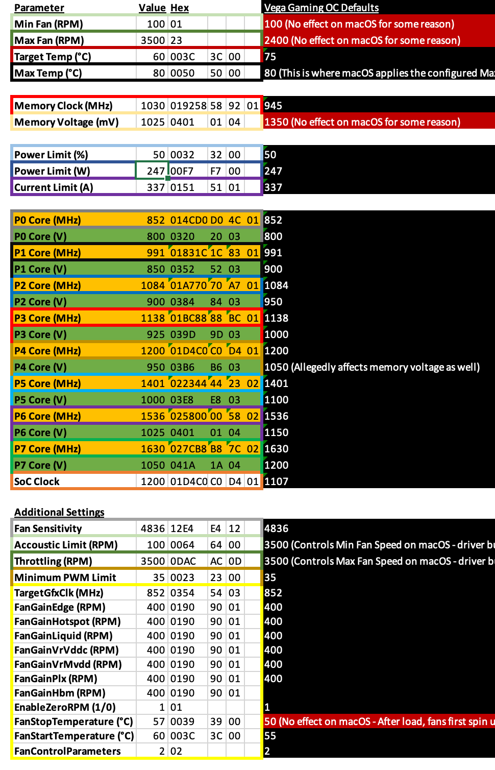

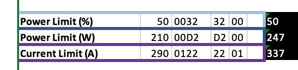

CMMChris Posted November 9, 2018 Share Posted November 9, 2018 @Pluskat5000Schiffe You used VGTab right? Please try it with my PPT generator and use the following settings: - P0 852 / 800 - P1 991 / 850 - P2 1084 / 900 - P3 1138 / 925 - P4 1200 / 950 - P5 1401 / 1000 - P6 1536 / 1025 - P7 1630 / 1050 - HBM 1030MHz - HBMV 1025 - SoC Clock 1199MHz - Power Limit 247W - Power Limit 50% - Current Limit 337A Remove the VGTab Injector Kext and inject the PPT with Clover and add the following parameters: PP_DisablePowerContainment = 1 PP_DisableFanControl = 1 Now test if card is stable and check if the fans are controlled automatically. If fans are not controlled you need to remove DisableFanControl and tune the Fan Curve by PPT. Link to comment https://www.insanelymac.com/forum/topic/325120-vega-frontier-edition-on-high-sierra/page/23/#findComment-2646737 Share on other sites More sharing options...

Pluskat5000Schiffe Posted November 12, 2018 Share Posted November 12, 2018 (edited) On 11/10/2018 at 12:34 AM, CMMChris said: @Pluskat5000Schiffe You used VGTab right? Please try it with my PPT generator and use the following settings: - P0 852 / 800 - P1 991 / 850 - P2 1084 / 900 - P3 1138 / 925 - P4 1200 / 950 - P5 1401 / 1000 - P6 1536 / 1025 - P7 1630 / 1050 - HBM 1030MHz - HBMV 1025 - SoC Clock 1199MHz - Power Limit 247W - Power Limit 50% - Current Limit 337A Remove the VGTab Injector Kext and inject the PPT with Clover and add the following parameters: PP_DisablePowerContainment = 1 PP_DisableFanControl = 1 Now test if card is stable and check if the fans are controlled automatically. If fans are not controlled you need to remove DisableFanControl and tune the Fan Curve by PPT. I used these values as you said, adjusted clover with these settings. Can you please verify if I did everything correct? Results: With DisableFanControl = 1 I have High IDLE fan speed about 1200 RPM. Under load Fan RPM stays same. looks stable though. With DisableFanControl = 0 I have 0RPM Idle fan speed. GUI and Gaming feels more smoother. But crashed. Not with full fan blow but now I experienced something totally different. I heard that the fans started to spin up under load. Also quite quick after te load was applied on the GPU. From one moment to the other I experienced a lag and it felt that the game was dropping from 40 fps in 4K to 10fps in 4K. Also the fans were dropped to idle at that point. Alt Tab so see what the temps were caused a system crash and had to reboot. Also noticed that sometimes GPU clocks are maxed out (1630Mhz heating up GPU Fans starts cool it down and the process starts all over in 10 sec) wYou need to power off system to restore the lower P states. It looks that the card stays in P7 mode after a reboot. Edited November 12, 2018 by Pluskat5000Schiffe Link to comment https://www.insanelymac.com/forum/topic/325120-vega-frontier-edition-on-high-sierra/page/23/#findComment-2647175 Share on other sites More sharing options...
CMMChris Posted November 12, 2018 Share Posted November 12, 2018 Fans should spin up with "DisableFanControl". How long did you put it under load to check it? Regarding the PPT fan control, something seems to be incompatible with your card. Try changing FanControlParameter to 0, 1 and 3 to see how it behaves. If nothing works out you can try removing the PPT and only inject "DisableFanControl". If that also doesn't help, ditch your card and try a MSI or XFX Vega 64. 1 Link to comment https://www.insanelymac.com/forum/topic/325120-vega-frontier-edition-on-high-sierra/page/23/#findComment-2647186 Share on other sites More sharing options...
Pluskat5000Schiffe Posted November 12, 2018 Share Posted November 12, 2018 (edited) 44 minutes ago, CMMChris said: Fans should spin up with "DisableFanControl". How long did you put it under load to check it? Regarding the PPT fan control, something seems to be incompatible with your card. Try changing FanControlParameter to 0, 1 and 3 to see how it behaves. If nothing works out you can try removing the PPT and only inject "DisableFanControl". If that also doesn't help, ditch your card and try a MSI or XFX Vega 64. Well its close. Tuning in the PPT looks to have impact though. Best result is now to lower the power limit to 215W and Amps to 275. There is also a in the yellow square in your PPT with value 2. I will check Disable Fancontrol but idle 1200RPM is too much for me. What about flashing MSI bios? I did it in HD and it had positive impact too. It showed temps native and CSM worked because clover had native resolution. Maybe to start all over with MSI bios? Edited November 12, 2018 by Pluskat5000Schiffe Link to comment https://www.insanelymac.com/forum/topic/325120-vega-frontier-edition-on-high-sierra/page/23/#findComment-2647191 Share on other sites More sharing options...
Pluskat5000Schiffe Posted November 12, 2018 Share Posted November 12, 2018 1 hour ago, CMMChris said: Fans should spin up with "DisableFanControl". How long did you put it under load to check it? Regarding the PPT fan control, something seems to be incompatible with your card. Try changing FanControlParameter to 0, 1 and 3 to see how it behaves. If nothing works out you can try removing the PPT and only inject "DisableFanControl". If that also doesn't help, ditch your card and try a MSI or XFX Vega 64. I have a possible breaktrough... and you won't believe it... See this: Thats wrong ... lol but it behaves much better than setting with 0 or 1 With 0 I have toggling fan due 1630Mhz clock which stays there heats up the card and start the fans cools it down and turns the fans down all in 10 sec so very annoying. With 1 I have 1200RPM steady in IDLE not working for me. With 3 yes three is works as it should. See attached PPT excel I used and Performance Statistics made during a Valley benchmark run (ended with 74fps). Can you confirm 3 is a valid option or did I just opened pandora's box ;-). Does it make sense to tune the PowerPlayTable? Thanks! temps.txt vega64-mac-pp_table-gen-V1.5.xlsx Link to comment https://www.insanelymac.com/forum/topic/325120-vega-frontier-edition-on-high-sierra/page/23/#findComment-2647201 Share on other sites More sharing options...
Pavo Posted November 12, 2018 Share Posted November 12, 2018 46 minutes ago, Pluskat5000Schiffe said: I have a possible breaktrough... and you won't believe it... See this: Thats wrong ... lol but it behaves much better than setting with 0 or 1 With 0 I have toggling fan due 1630Mhz clock which stays there heats up the card and start the fans cools it down and turns the fans down all in 10 sec so very annoying. With 1 I have 1200RPM steady in IDLE not working for me. With 3 yes three is works as it should. See attached PPT excel I used and Performance Statistics made during a Valley benchmark run (ended with 74fps). Can you confirm 3 is a valid option or did I just opened pandora's box ;-). Does it make sense to tune the PowerPlayTable? Thanks! temps.txt vega64-mac-pp_table-gen-V1.5.xlsx DisableFanControl is a Boolean value, it is either 0=No or 1=yes, setting to anything other than those 2 values will make it use the default value of 0. Link to comment https://www.insanelymac.com/forum/topic/325120-vega-frontier-edition-on-high-sierra/page/23/#findComment-2647206 Share on other sites More sharing options...
Pluskat5000Schiffe Posted November 12, 2018 Share Posted November 12, 2018 11 minutes ago, Pavo said: DisableFanControl is a Boolean value, it is either 0=No or 1=yes, setting to anything other than those 2 values will make it use the default value of 0. Yes man i know. I already double checked it. There is a difference. I will check it tonight once more... Link to comment https://www.insanelymac.com/forum/topic/325120-vega-frontier-edition-on-high-sierra/page/23/#findComment-2647207 Share on other sites More sharing options...
CMMChris Posted November 12, 2018 Share Posted November 12, 2018 (edited) I never tested this. Let me try it on my card You changed the wrong value tho. I was talking about my PPT generator. Edited November 12, 2018 by CMMChris Link to comment https://www.insanelymac.com/forum/topic/325120-vega-frontier-edition-on-high-sierra/page/23/#findComment-2647225 Share on other sites More sharing options...
CMMChris Posted November 12, 2018 Share Posted November 12, 2018 Yup, "DisableFanControl = 3" fixes the fan spin-up issue after load. Fans now retain their speed for a while and then start the spin down process. @Pluskat5000Schiffe you are my hero! I guess this is a bug, but it works well. Link to comment https://www.insanelymac.com/forum/topic/325120-vega-frontier-edition-on-high-sierra/page/23/#findComment-2647228 Share on other sites More sharing options...
Pluskat5000Schiffe Posted November 13, 2018 Share Posted November 13, 2018 (edited) 6 hours ago, CMMChris said: Yup, "DisableFanControl = 3" fixes the fan spin-up issue after load. Fans now retain their speed for a while and then start the spin down process. @Pluskat5000Schiffe you are my hero! I guess this is a bug, but it works well. I'm so glad that I yes I lol fixed the fan issue for once and for all hahaha well lets hope it! 8 hours ago, Pavo said: DisableFanControl is a Boolean value, it is either 0=No or 1=yes, setting to anything other than those 2 values will make it use the default value of 0. See above it looks its not a boolean. CMMChris acked it works for him too. Edited November 13, 2018 by Pluskat5000Schiffe Link to comment https://www.insanelymac.com/forum/topic/325120-vega-frontier-edition-on-high-sierra/page/23/#findComment-2647303 Share on other sites More sharing options...

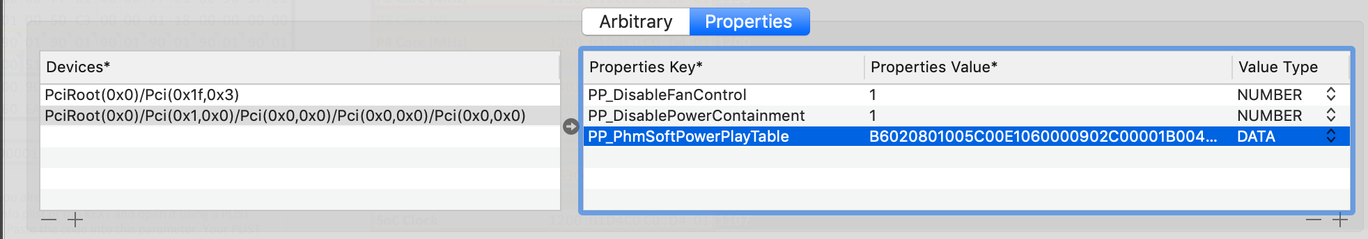

Pluskat5000Schiffe Posted November 13, 2018 Share Posted November 13, 2018 Well I was too optimistic still good news though. I tried to reproduce the behaviour without PP_DisableFanControl and without PP_DisablePowerContainment in my clover / device / properties. I found out that with the default power settings the card turns the fans to Idle too. The GPU core clock remains at 1630MHz which heats up the GPU fast and heats it up beyond 57 degrees Celsius starting the fans to spin up. The fans cools the GPU down quick because there is no load but this hole heating up cooling down spinning up spinning down takes place in 10sec. So that's really annoying. Lowering the PowerLimits keeps the clocks down after load. The result is that the card stops its fans right after quitting GPU load. And keep the clocks at about 270Mhz / 500Mhz memory. Temps remain 39 deg. Celsius. I think it's still not perfect. Link to comment https://www.insanelymac.com/forum/topic/325120-vega-frontier-edition-on-high-sierra/page/23/#findComment-2647306 Share on other sites More sharing options...
