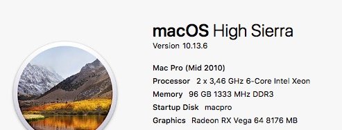

Indio Posted November 6, 2018 Share Posted November 6, 2018 (edited) 46 minutes ago, CMMChris said: Apple has responded to my bug report and demand a sysdiagnose from a real Mac. Anyone in here with a real Mac Pro + Vega 64 or Vega 64 as eGPU who is able to create a sysdiagnose? i can, but apple wrote before it starts: This tool generates files that allow Apple to investigate issues with your computer and help improve Apple products. The files might contain personal information found on your device or associated with your iCloud accounts, including but not limited to your name, serial numbers of your device, your device name, your attached peripheral devices, your user name, your email address and email settings, file paths, file names, your computer's IP addresses, and network connection information. This information is used by Apple in accordance with its privacy policy (www.apple.com/privacy) and is not shared with any other company. By using this tool and sending the results to Apple, you consent to Apple using the contents of these files to improve Apple products. so i have a problem to give out my personalinformation : -( there are many of this - the file has 250MB and i saw so much information of my network, macs, iphones, ipads and my server and the server from clients !!! it's terrifying what's in there !!!! so, how can i send it to apple direct in your bugreport? Edited November 6, 2018 by Indio Link to comment https://www.insanelymac.com/forum/topic/325120-vega-frontier-edition-on-high-sierra/page/22/#findComment-2645922 Share on other sites More sharing options...
Pavo Posted November 6, 2018 Share Posted November 6, 2018 I will file a report on my real Mac with a Asus STRIX OC Vega 64 1 Link to comment https://www.insanelymac.com/forum/topic/325120-vega-frontier-edition-on-high-sierra/page/22/#findComment-2645930 Share on other sites More sharing options...
Gen4ig Posted November 6, 2018 Share Posted November 6, 2018 25 minutes ago, Pavo said: I will file a report on my real Mac with a Asus STRIX OC Vega 64 I have same card with fan problem, but I have not eGPU and real Mac with thunderbolt 3 Link to comment https://www.insanelymac.com/forum/topic/325120-vega-frontier-edition-on-high-sierra/page/22/#findComment-2645937 Share on other sites More sharing options...
Pavo Posted November 6, 2018 Share Posted November 6, 2018 10 minutes ago, Gen4ig said: I have same card with fan problem, but I have not eGPU and real Mac with thunderbolt 3 Yeah I don’t have eGPU either, I can install the GPU inside the MacPro5,1 like normal PC. 1 Link to comment https://www.insanelymac.com/forum/topic/325120-vega-frontier-edition-on-high-sierra/page/22/#findComment-2645939 Share on other sites More sharing options...

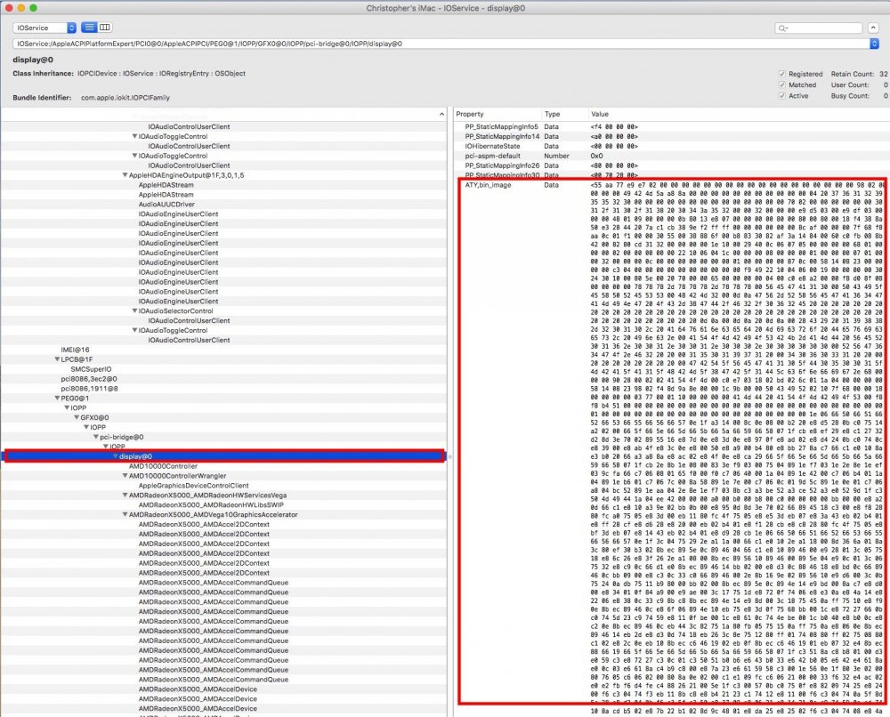

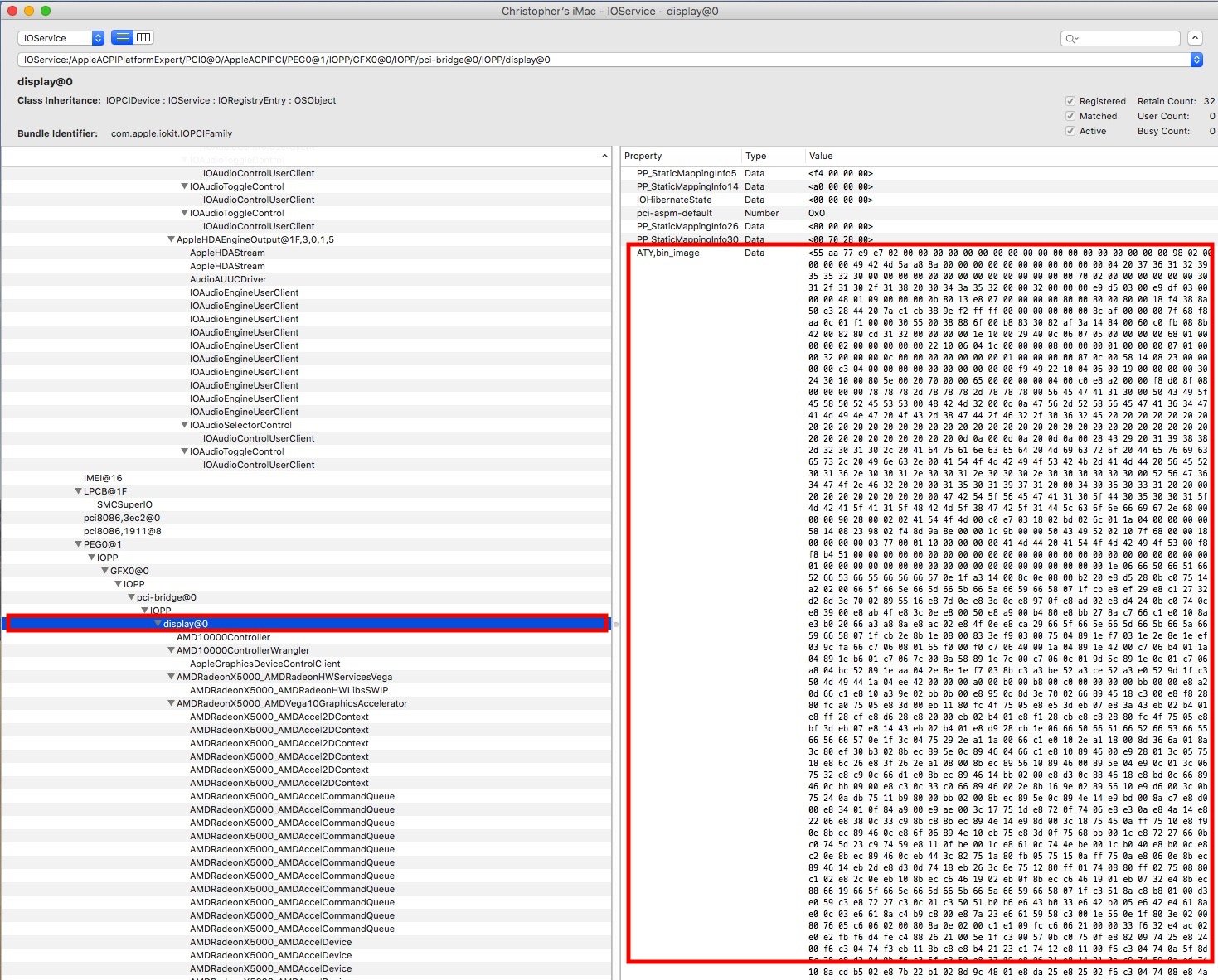

Pluskat5000Schiffe Posted November 7, 2018 Share Posted November 7, 2018 (edited) 3 minutes ago, meaganmargaret said: Hey, how did you get the Clover properties value? I got the DevicePath value, but not the Clover properties value. How did you get that value? Well I thought It had to be added like its mentioned here and I saw it in other forum / topics as well. But You are right only the first part is mentioned the device path. In my context it means that this is the value I use for the discovered value as devicepath with the addition of /Pci(0x0,0x0)/Pci(0x0,0x0)/Pci(0x0,0x0) Edited November 7, 2018 by Pluskat5000Schiffe Link to comment https://www.insanelymac.com/forum/topic/325120-vega-frontier-edition-on-high-sierra/page/22/#findComment-2645960 Share on other sites More sharing options...
Pluskat5000Schiffe Posted November 7, 2018 Share Posted November 7, 2018 8 hours ago, meaganmargaret said: So, the PciRoot(0x0)/Pci(0x1,0x0)/Pci(0x0,0x0)/Pci(0x0,0x0)/Pci(0x0,0x0) is a static value that you just entered? You didn't look it up in IOReg? Or anything else? Oops, my bad: Your value was determined by the result of your gfxutil: PciRoot(0x0)/Pci(0x1,0x0) and your addition of: Pci(0x0,0x0)/Pci(0x0,0x0)/Pci(0x0,0x0), which is an arbitrary value you pulled from one of Chris's posts? Yes exactly as described after "Oops my bad:" Link to comment https://www.insanelymac.com/forum/topic/325120-vega-frontier-edition-on-high-sierra/page/22/#findComment-2646000 Share on other sites More sharing options...
CMMChris Posted November 7, 2018 Share Posted November 7, 2018 (edited) Uhm, that's kinda wrong. To get your PCI-path open IORegistryExplorer or IOJones and look up your PEG0. Depending on the renames you use and the motherboards way of handling the graphics card it might be located under one those: - PEG0/GFX0 - PEG0/PEGP - PEG0/PEGP/display@0 - PEG0/PEGP/GFX0 - PEG0/GFX0/display@0 Check on which of those entries you find the "ATY,bin_image" and other "PP_" settings. This is where the controlling data needs to be injected. Now all you have to do is look up this entry with GFX Util. In my case it is "./gfxutil -f display". Now you have the correct PCI path. Edited November 7, 2018 by CMMChris Link to comment https://www.insanelymac.com/forum/topic/325120-vega-frontier-edition-on-high-sierra/page/22/#findComment-2646031 Share on other sites More sharing options...

Pluskat5000Schiffe Posted November 7, 2018 Share Posted November 7, 2018 (edited) 2 hours ago, CMMChris said: Uhm, that's kinda wrong. To get your PCI-path open IORegistryExplorer or IOJones and look up your PEG0. Depending on the renames you use and the motherboards way of handling the graphics card it might be located under one those: - PEG0/GFX0 - PEG0/PEGP - PEG0/PEGP/display@0 - PEG0/PEGP/GFX0 - PEG0/GFX0/display@0 Check on which of those entries you find the "ATY,bin_image" and other "PP_" settings. This is where the controlling data needs to be injected. Now all you have to do is look up this entry with GFX Util. In my case it is "./gfxutil -f display". Now you have the correct PCI path. I did indeed Ioreg to find name. I found it was peg0 so I got partly the PCI path with: sh-3.2# ./gfxutil -f PEG0 DevicePath = PciRoot(0x0)/Pci(0x1,0x0) sh-3.2# but indeed /gfxutil -f display reveals: DevicePath = PciRoot(0x0)/Pci(0x1,0x0)/Pci(0x0,0x0)/Pci(0x0,0x0)/Pci(0x0,0x0) So it's correct. Edited November 7, 2018 by Pluskat5000Schiffe Link to comment https://www.insanelymac.com/forum/topic/325120-vega-frontier-edition-on-high-sierra/page/22/#findComment-2646057 Share on other sites More sharing options...

Pluskat5000Schiffe Posted November 9, 2018 Share Posted November 9, 2018 Well, /gfxutil -f display reveals: DevicePath = PciRoot(0x0)/Pci(0x1,0x0)/Pci(0x0,0x0)/Pci(0x0,0x0)/Pci(0x0,0x0) what is the correct path. As soon as I apply any Table under clover device properties the card turns to black screen and blows the fans at 100% under extreme load after a while. I have to reboot. Without any settings applied my card stays stable under these same extreme conditions. Is there anybody who can tell me where to start? I tried "save" ones but also "extreme" ones with much lower voltages. I don't know where to start to get this solved because I think without these settings the card runs very inefficient (too high voltages) so I hope it can be solved. Link to comment https://www.insanelymac.com/forum/topic/325120-vega-frontier-edition-on-high-sierra/page/22/#findComment-2646706 Share on other sites More sharing options...
