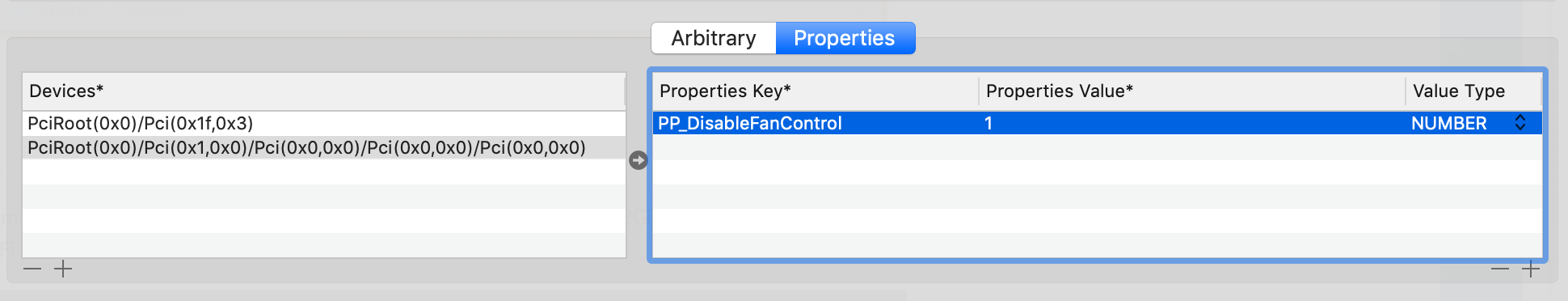

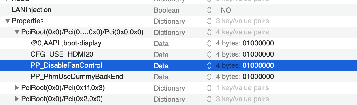

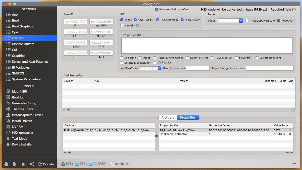

CMMChris Posted November 4, 2018 Share Posted November 4, 2018 (edited) Actually the vBIOS thing doesn't work reliable But I figured out one more thing: Add PP_DisableFanControl=1 to your Kext or inject via Clover and see what it does for you Edited November 4, 2018 by CMMChris Link to comment https://www.insanelymac.com/forum/topic/325120-vega-frontier-edition-on-high-sierra/page/21/#findComment-2645427 Share on other sites More sharing options...

CMMChris Posted November 5, 2018 Share Posted November 5, 2018 (edited) If your card turns off and fans go full blast this doesn't mean it crashed. It means that you hit the maximum temperature on some component and it turned off to prevent damage. Not good! Try without PowerPlayTable and only "PP_DisableFanControl". This will use the stock card settings and prevent macOS from messing with the fans. So the card will control itself. On my card this works fine. No Zero RPM tho. If you want to keep using a PPT you need to tweak your settings in order to prevent overheat. How did you generate your current PPT? Edited November 5, 2018 by CMMChris Link to comment https://www.insanelymac.com/forum/topic/325120-vega-frontier-edition-on-high-sierra/page/21/#findComment-2645545 Share on other sites More sharing options...
Pluskat5000Schiffe Posted November 5, 2018 Share Posted November 5, 2018 (edited) 25 minutes ago, CMMChris said: If your card turns off and fans go full blast this doesn't mean it crashed. It means that you hit the maximum temperature on some component and it turned off to prevent damage. Not good! Try without PowerPlayTable and only "PP_DisableFanControl". This will use the stock card settings and prevent macOS from messing with the fans. So the card will control itself. On my card this works fine. No Zero RPM tho. If you want to keep using a PPT you need to tweak your settings in order to prevent overheat. How did you generate your current PPT? Thanks for helping me man. At the moment I don't have any kext, any mod on AMD10000.kext and no PPT in clover. Under this condition the cards remains stable but doesn't turn to Zero RPM after heavy usage. Sleep wake enables 0RPM again. Can I add a device properties entry in clover call the property key "PP_DisableFanControl and put "1" in the DATA field to enable just PP_DisableFanControl? Edited November 5, 2018 by Pluskat5000Schiffe Link to comment https://www.insanelymac.com/forum/topic/325120-vega-frontier-edition-on-high-sierra/page/21/#findComment-2645549 Share on other sites More sharing options...
CMMChris Posted November 5, 2018 Share Posted November 5, 2018 Yes, like that 1 Link to comment https://www.insanelymac.com/forum/topic/325120-vega-frontier-edition-on-high-sierra/page/21/#findComment-2645565 Share on other sites More sharing options...
Pluskat5000Schiffe Posted November 5, 2018 Share Posted November 5, 2018 49 minutes ago, CMMChris said: Yes, like that This is what I have adjusted. Rebooted but fans are idle ... (0RPM) does that mean that it's not activated? Link to comment https://www.insanelymac.com/forum/topic/325120-vega-frontier-edition-on-high-sierra/page/21/#findComment-2645569 Share on other sites More sharing options...
CMMChris Posted November 5, 2018 Share Posted November 5, 2018 I don't know, every card behaves different. Put load on it and see what happens. Link to comment https://www.insanelymac.com/forum/topic/325120-vega-frontier-edition-on-high-sierra/page/21/#findComment-2645571 Share on other sites More sharing options...
Pluskat5000Schiffe Posted November 5, 2018 Share Posted November 5, 2018 1 hour ago, CMMChris said: I don't know, every card behaves different. Put load on it and see what happens. The behaviour is exactly the same as without the setting. Without GPU load system usage fans stay 0RPM. GPU usage starts spins up 3D apps are stable. After 3D usage fans fall off to 1500RPM. Sleep / Wake restores 0 RPM again. Link to comment https://www.insanelymac.com/forum/topic/325120-vega-frontier-edition-on-high-sierra/page/21/#findComment-2645589 Share on other sites More sharing options...

CMMChris Posted November 5, 2018 Share Posted November 5, 2018 @Pluskat5000Schiffe Make sure your PCI path is correct. You can generate it with GFX Util. Link to comment https://www.insanelymac.com/forum/topic/325120-vega-frontier-edition-on-high-sierra/page/21/#findComment-2645607 Share on other sites More sharing options...
