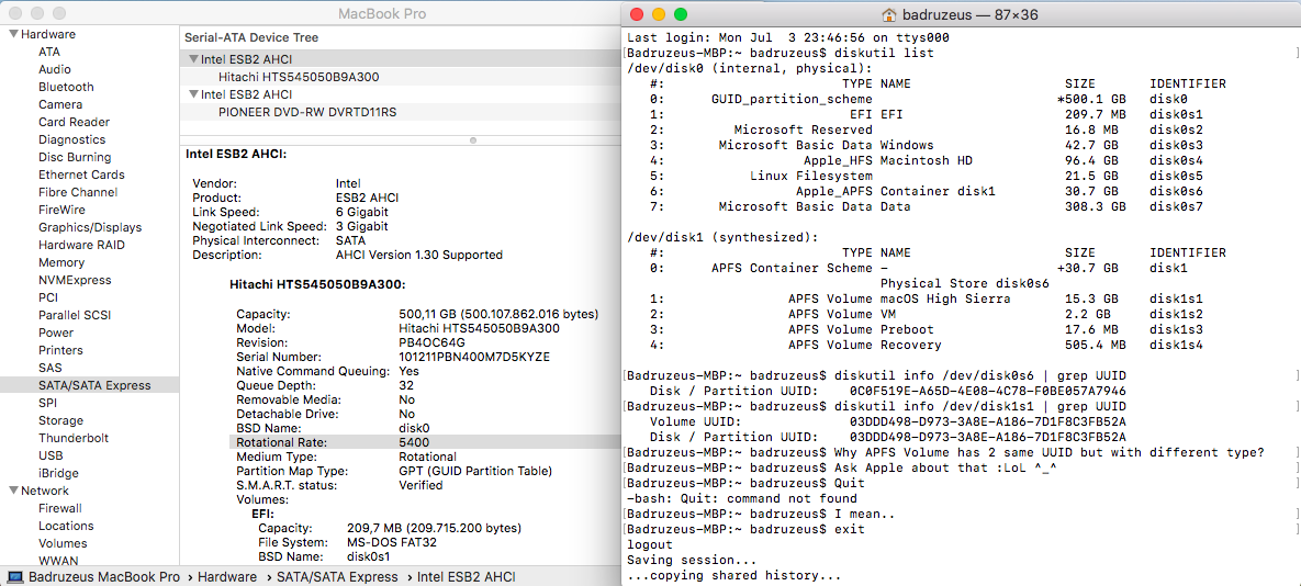

Badruzeus Posted July 3, 2017 Share Posted July 3, 2017 You're welcome, let me know if it worked out for you or not OK, since I have only 5400rpm mechanical SATA.. I think it's better install using HFS+.. also APFS a little bit confusing me while creating Custom Entry under Clover GUI. On my case is "Recovery HD" which has same UUID as MainOS (10.13) as seen on Bootscreen, but prisoned within it's own container (\VenMedia); it appears there if using "Auto Scan" though.. I remember @arshadu ever discussed this here, but can't find that. Whoaa.. this thread is blazing fast since 1st created, 8x pages till date. Thanks again @fantomas Link to comment https://www.insanelymac.com/forum/topic/324194-pre-release-macos-high-sierra/page/64/#findComment-2456444 Share on other sites More sharing options...
Cyberdevs Posted July 3, 2017 Share Posted July 3, 2017 OK, since I have only 5400rpm mechanical SATA.. I think it's better install using HFS+.. also APFS a little bit confusing me while creating Custom Entry under Clover GUI. On my case is "Recovery HD" which has same UUID as MainOS (10.13) as seen on Bootscreen, but prisoned within it's own container (\VenMedia); it appears there if using "Auto Scan" though.. I remember @arshadu ever discussed this here, but can't find that. Whoaa.. this thread is blazing fast since 1st created, 8x pages till date. Thanks again @fantomas APFS on a mechanical HDD is still a disaster. HFS is better for now, maybe in the next updates it will work ok on mechanical HDDs but not yet. If you have a 7200 RPM with 6GB/s SATA III port you might find it tolerable but definitely not on 5400 RPM Link to comment https://www.insanelymac.com/forum/topic/324194-pre-release-macos-high-sierra/page/64/#findComment-2456462 Share on other sites More sharing options...
