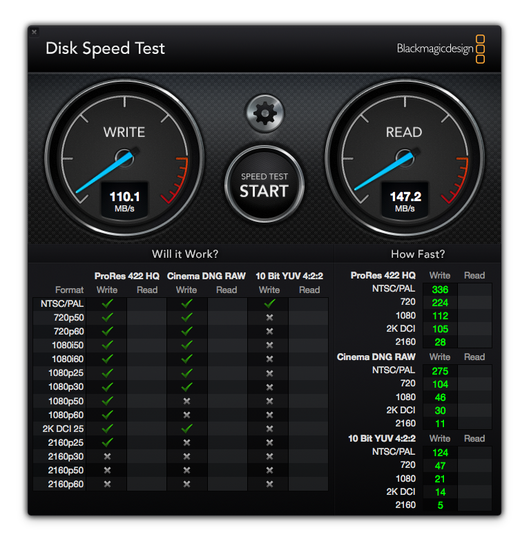

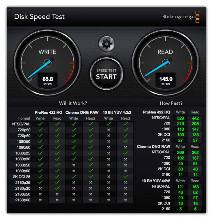

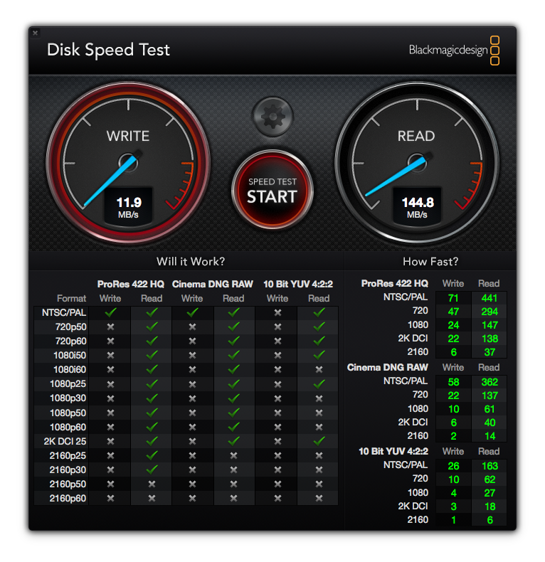

Yeah... I was about to say: that is clearly a symptom of flash-based devices. If your speed initially starts looking OK, then that means the USB 3 bus speeds is fine. And can handle that bandwidth - all is OK with the USB 3 chipset performance.
Yup I zeroed out the flash disk and in few minutes the extended test will be done and then I'll check the disk again and if it's the same I just need to replace it ;)
Thanks, but how long did you let the test run?
Around 5 minutes i think.
Running it again now, Read speeds stay nice and high, around 144 MB/S but yeah while watching write speeds do drop to around 30 MB/s and the lowest i saw was 28 but it stays around 40 alot.
