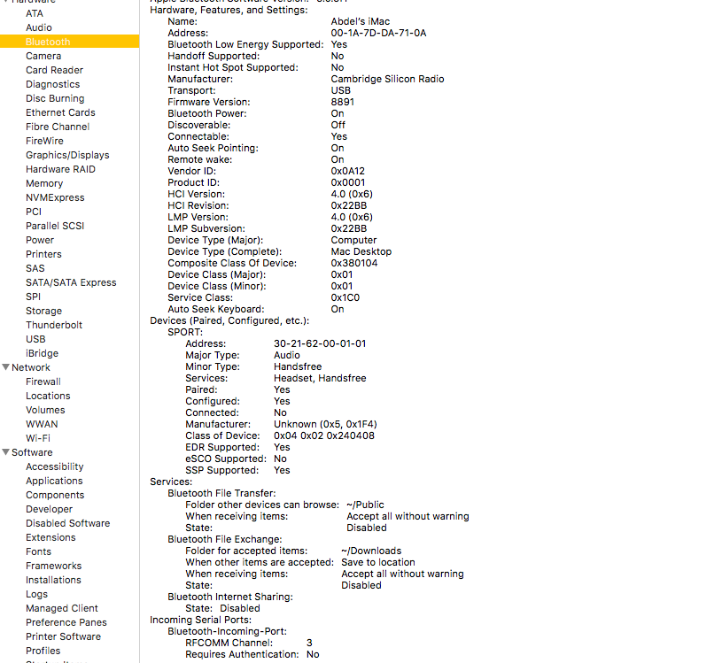

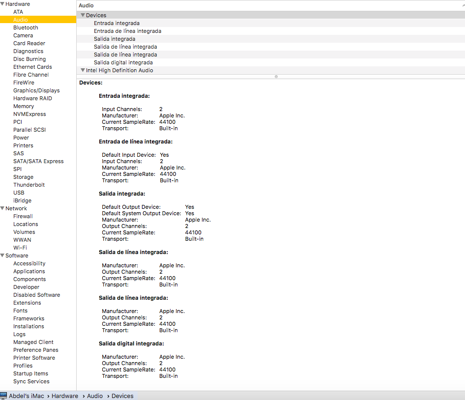

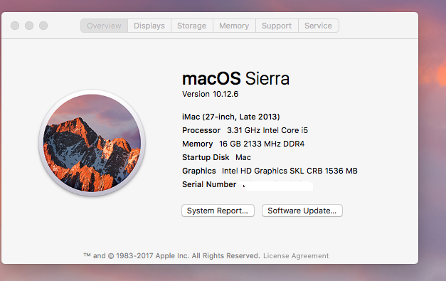

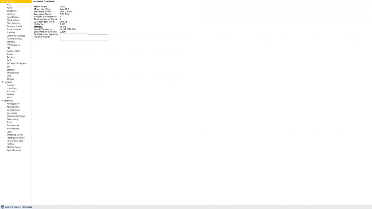

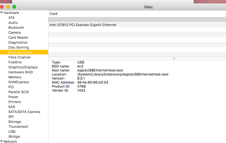

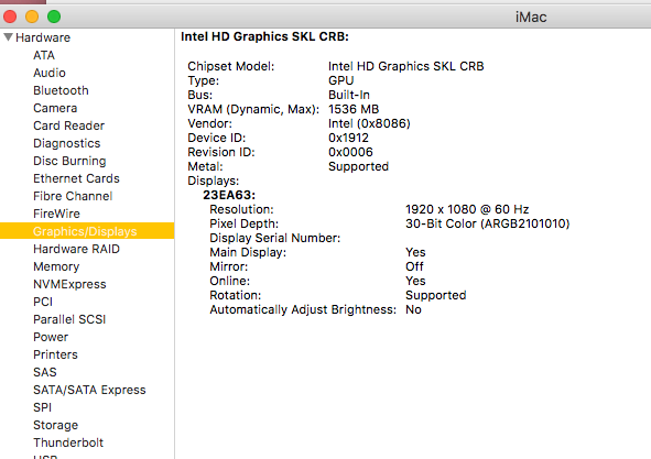

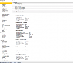

Hi guys
just built the system yesterday (run out of CPU paste and used Toothpaste instead temp is currently  49-53 c  until Monday :)     )
 Everything is working fine  except Audio which i then used Voodoo audio  Kext  v.2.8.8 and works fine with no interference.
If anyone has issues please use the attach plist if using HD530 only
Thanks

You had better not be seriously using toothpaste as cooling compound. If you are shut down now and leave it off until you get thermal compound.
As for audio AppleALC.kext and Lilu.kext with the right layout id should have sound working without issue.
Again I stress turn your system off if using toothpaste on your cpu.

Yup. Using toothpaste is a bad idea. I urge you to do what SavageAUS suggested ASAP. :no:
Toothpaste conducts electricity.
And I have a question how did you ran out off thermal paste? you only need a small amount of thermal paste to apply on the CPU if you don't want to choke the CPU with thermal paste. Applying lots of thermal paste doesn't necessarily mean you'll have more effect.
I have seen your config.plist and you have the Toleda's audio patches and you use the voodooHDA as well. You don't need them both. You can remove all the patches and only use voodooHDA or as SavageAUS suggested it's better to use AppleALC and Lilu. The Audio Layout ID is already set to 1 which is correct for lots of Audio components.
Also note that iMac14,2 is not suitable for SkyLake it' better to use the iMac17,1 SMBIOS. The CPU Power Management work be accurate with iMac14,2 on SkyLake processors.
