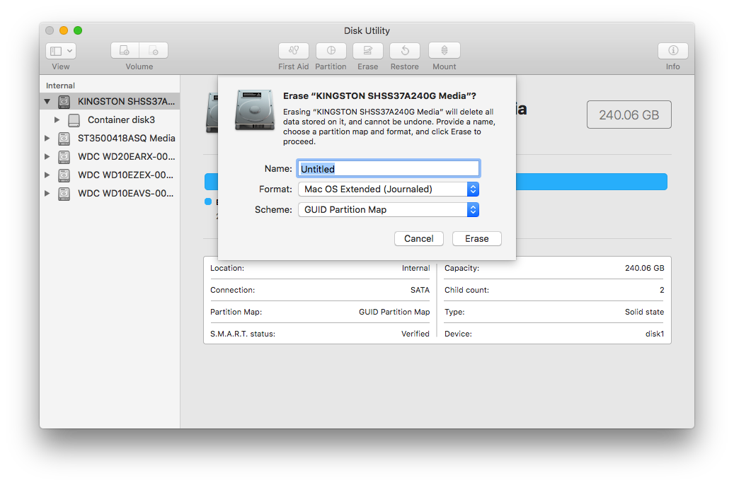

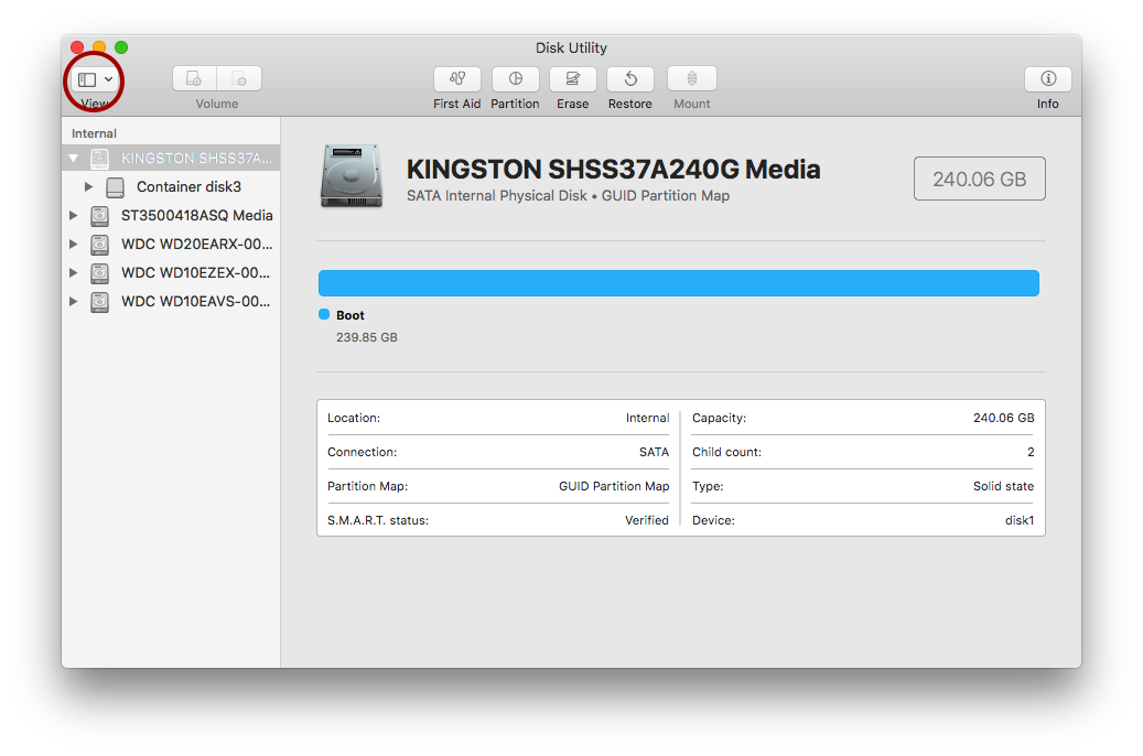

If your hard disk is brand new:
Open "Disk Utility" from the top left cornet click "View" and then select "Show All Devices"
Your HDD should be there and then Select the disk and Erase it using Mac OS Extended (Journaled) with GUID Partition Map then you can select it and Install macOS.
Oh thank.. now that working.

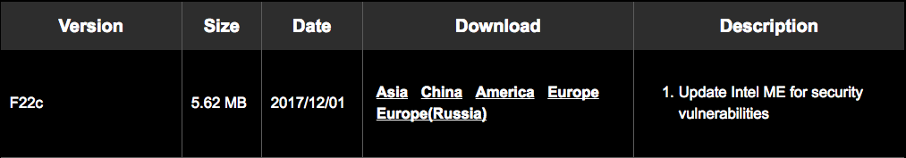

S.O.S HELP… Computer won't POST after BIOS downgrade. :(
So I upgraded my BIOS from F22a to the latest Version (F22c). I did backup the previous Bios. But after the update the System wouldn't load clover. I got an error message from Wndows Boot Manager instead. Background: I previously had a second SSD with windows 10 installed in the System which I removed because I needed it for another Computer. But the computer worked fine the and booted to Clover without problems.
Since I didn't know how to get to clover again I decided to downgrade the BIOS to 22a again. The downgrade went through as supposed. The System restarted but it does not POST anymore and just restarts all over again. I removed the CMOS Battery and unplugged power. This reanabled the LEDs again (which I had disabled) but the System still does not POST. Do you think the BIOS chip is bricked?
