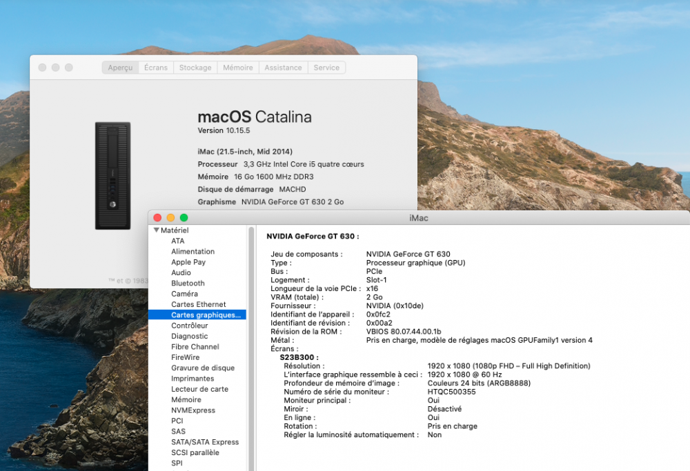

chris1111 Posted July 3, 2020 Share Posted July 3, 2020 (edited) Big News I just receive my GefOrce 630 today from USA California Works native Big sur and Cata EDIT *** Change my 630 for a GeForce GT 710 2 gig Works better Edited July 8, 2020 by chris1111 Change my 630 for a GeForce GT 710 2 gig Works better 1 Link to comment https://www.insanelymac.com/forum/topic/323180-ventura-monterey-big-sur-catalina-mojave-high-sierra-on-hp-800-g1-usdtsff-and-tower-pcs/page/14/#findComment-2728486 Share on other sites More sharing options...

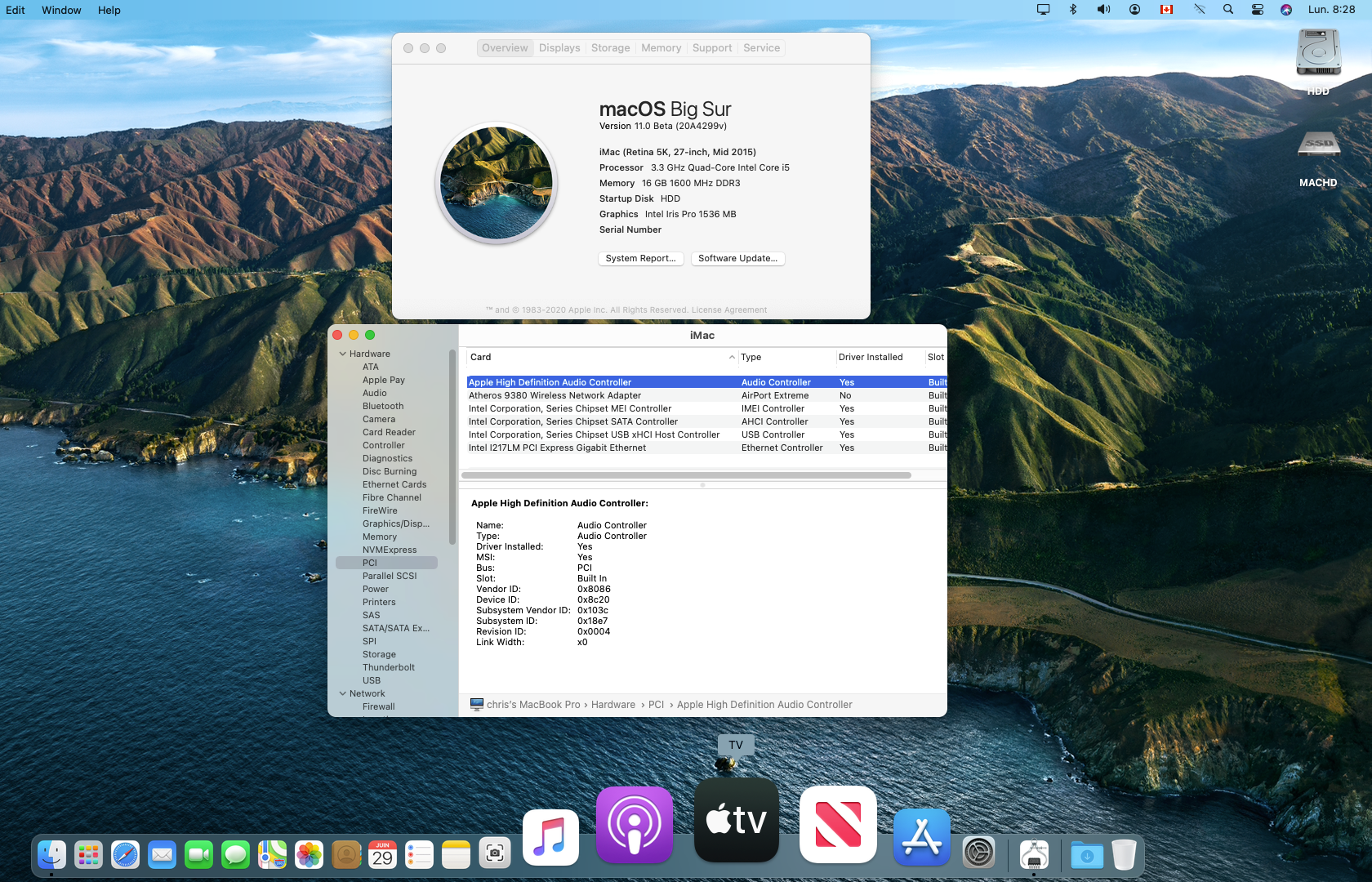

mohamed1 Posted July 20, 2020 Share Posted July 20, 2020 On 6/29/2020 at 5:44 AM, chris1111 said: EDIT *** I try my self its boot perfectly after IOConsoleUsers: gIOScreenLockState the Apple arrives no progress bar running Stuck with a beautiful apple no progression EDIT *** Ok done Fresh Install Create Install Media from My Mac Book Pro I find why is not working for 3 days On 7/7/2020 at 8:55 PM, chris1111 said: Hi @Donw35 do you have an issue wit the front USB 3.0 ? I have always disconnect Low power notification On 7/7/2020 at 8:55 PM, chris1111 said: Hi @Donw35 do you have an issue wit the front USB 3.0 ? I have always disconnect Low power notification Link to comment https://www.insanelymac.com/forum/topic/323180-ventura-monterey-big-sur-catalina-mojave-high-sierra-on-hp-800-g1-usdtsff-and-tower-pcs/page/14/#findComment-2731130 Share on other sites More sharing options...

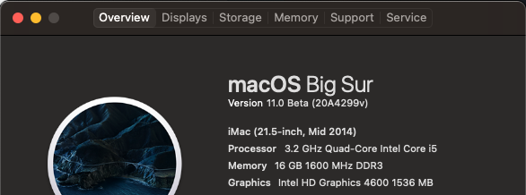

Donw35 Posted August 21, 2020 Author Share Posted August 21, 2020 (edited) Big Sur Beta 5 installed without issues, I uploaded my latest EFI using OpenCore 6.1.0 and the latest kexts to the main post, useful for making a USB installer, this EFI folder is the most current but will be out of date once Big Sur is officially released, I will post that EFI folder at that time. Enjoy everyone Edited August 21, 2020 by Donw35 Link to comment https://www.insanelymac.com/forum/topic/323180-ventura-monterey-big-sur-catalina-mojave-high-sierra-on-hp-800-g1-usdtsff-and-tower-pcs/page/14/#findComment-2734976 Share on other sites More sharing options...
