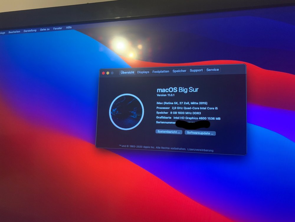

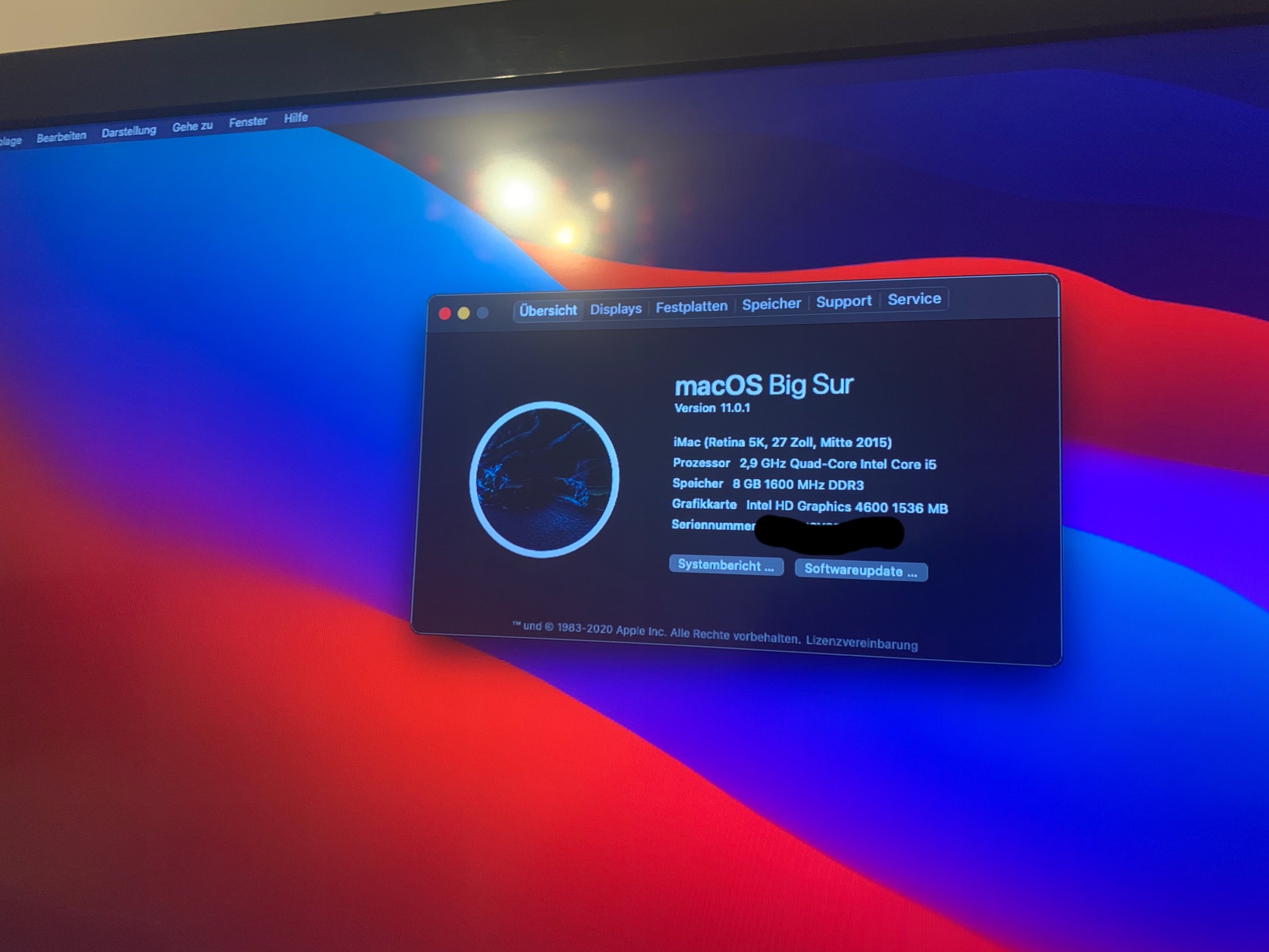

can confirm this works on the GM / Release of Big Sur.
Added my EFI folder which can be used for the install as well as after the instal.
However - for obivous reasons - all Serial Numbers and Boardnumbers have been replaced with "123" so if you want to have working iCloud , iMessage and all the other stuff - make sure to add your working Serials after installation!
Simple Install Instruction:
make usable USB stick with gibMacOS of BigSur
Place Efi into USB Efi partition
Install
add efi of USB into your Hackintosh EFI partition
Edit SMBIOS / Serialnumber settings to get working Apple Services
Edit: added screenshot as proof:
https://imgur.com/udPJhCK
EFI.rar
Edited by MrDodi

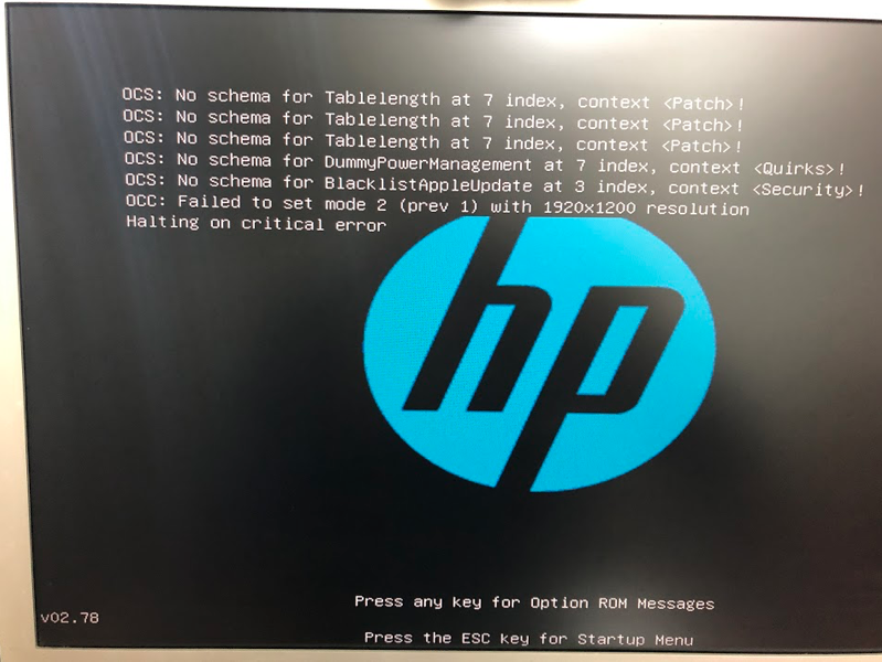

Hello,
I'm on an HP 800 G1 SFF which I'm using with a dual monitor setup.  My primary display is an Apple Cinema HD Display (23") and my Secondary Display is a Dell P2214Hb.
If I have only the Cinema HD Display connected and use HP_800_G1_OC063.zip then Catalina 10.15 boots normally.  If I plug in both the Cinema HD Display and the Dell at boot time then I get the attached image.  This looks like a low level OpenCore error - not sure how to proceed.
For now I have gone back to 10.13 (which is working with my dual monitor config) using this guide (via Clover): https://hackintosher.com/guides/high-sierra-install-full-guide/
If anyone could give me some hints/tips that would be appreciated.

@Donw35: Sure are - both are Display Port (i.e. not VGA etc).  Also no dGPU installed into this HP 800 G1 SFF box, i.e. only using the onboard iGPU (via the 2 Display Port connectors).

I have the same issue but fewer differences. When the 800G1 box inserted 2 DP ports (whatever is iGPU or dGPU AMD WX4130), the system will keep crash and rebooting during the last step to activate the video card.
After I connect only one screen and get the system to boot, a 'report problem' window occurs.

well, we know the computer can do in Windows, I am thinking we would need to adjust the frame buffer and memory allocation, if I can get some time during the holiday break I will do some testing.
A tip may help you to analyze this problem. Below link is a guide about how to patch Haswell HD4x00 framebuffer, but I can't get points. ToT
https://osxlatitude.com/forums/topic/8723-enabling-dvidphdmi-and-increasing-vram-with-intel-haswell4th-gen-hd420044004600etc-igpu/

Some progress/changes/observations:
If I downgrade from HP_800_G1_OC063 to HP_800_G1_OC_58 then I can get past the boot screen problem above, but with Catalina (10.15) and dual DisplayPort Monitors - I get the spontaneous reboot just at the point where macOS tries to change from text mode (verbose boot) into the GUI.  If I have a single monitor connected then everything is fine.
If I use HP_800_G1_OC_58 in combination with Mojave (10.14.6) then everything is perfect, even with dual monitors!  So actually my workaround right at the moment is to use Mojave in conjunction with HP_800_G1_OC_58.  (Loving Dark mode.)
