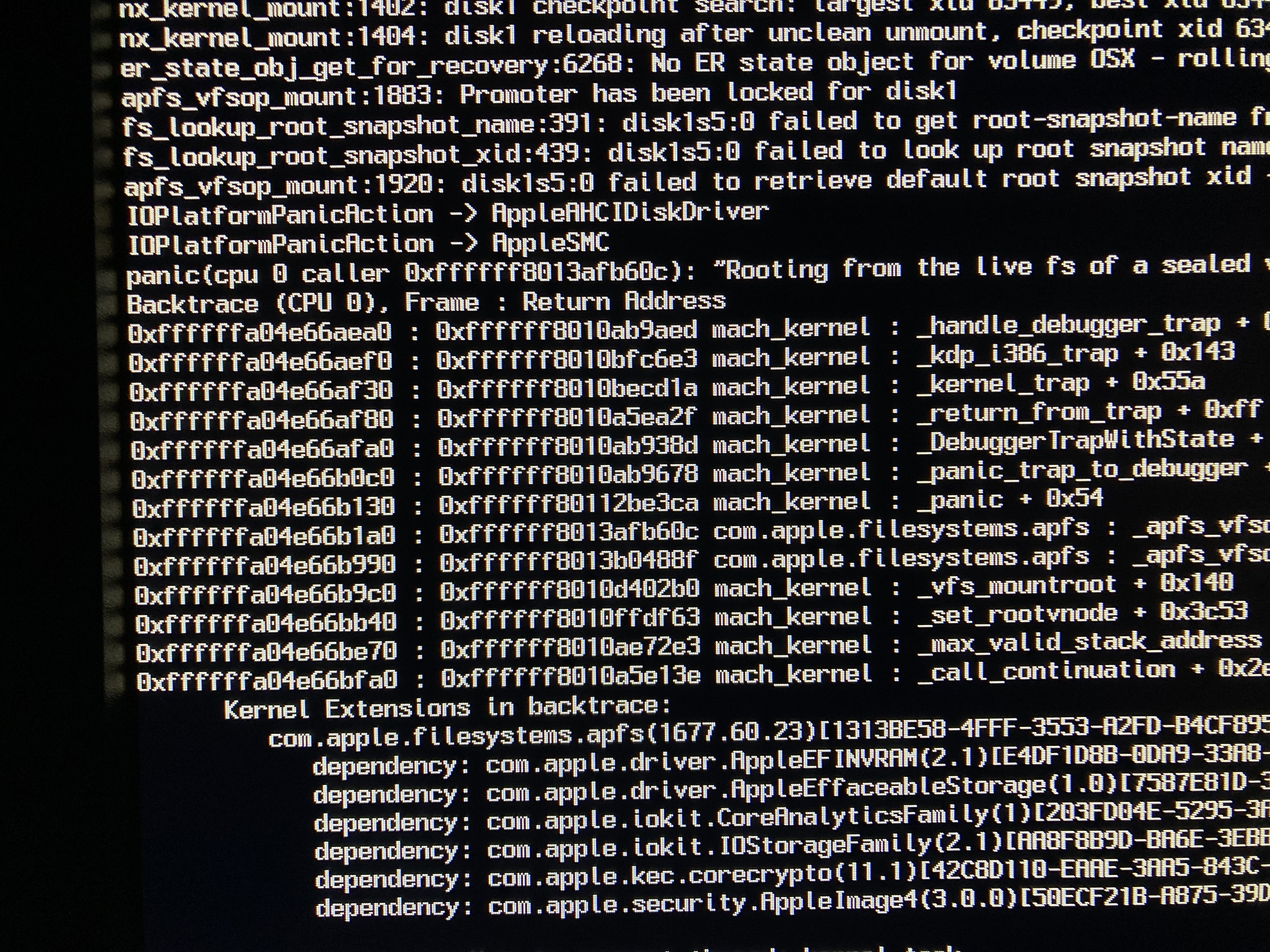

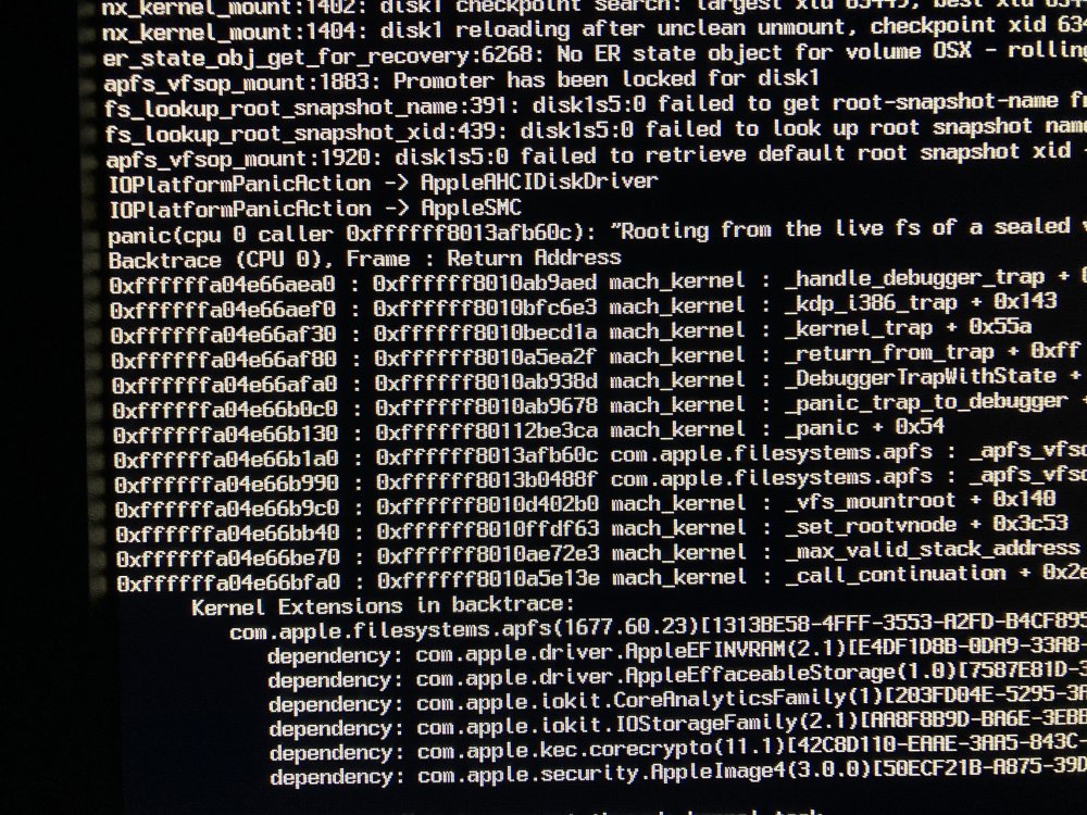

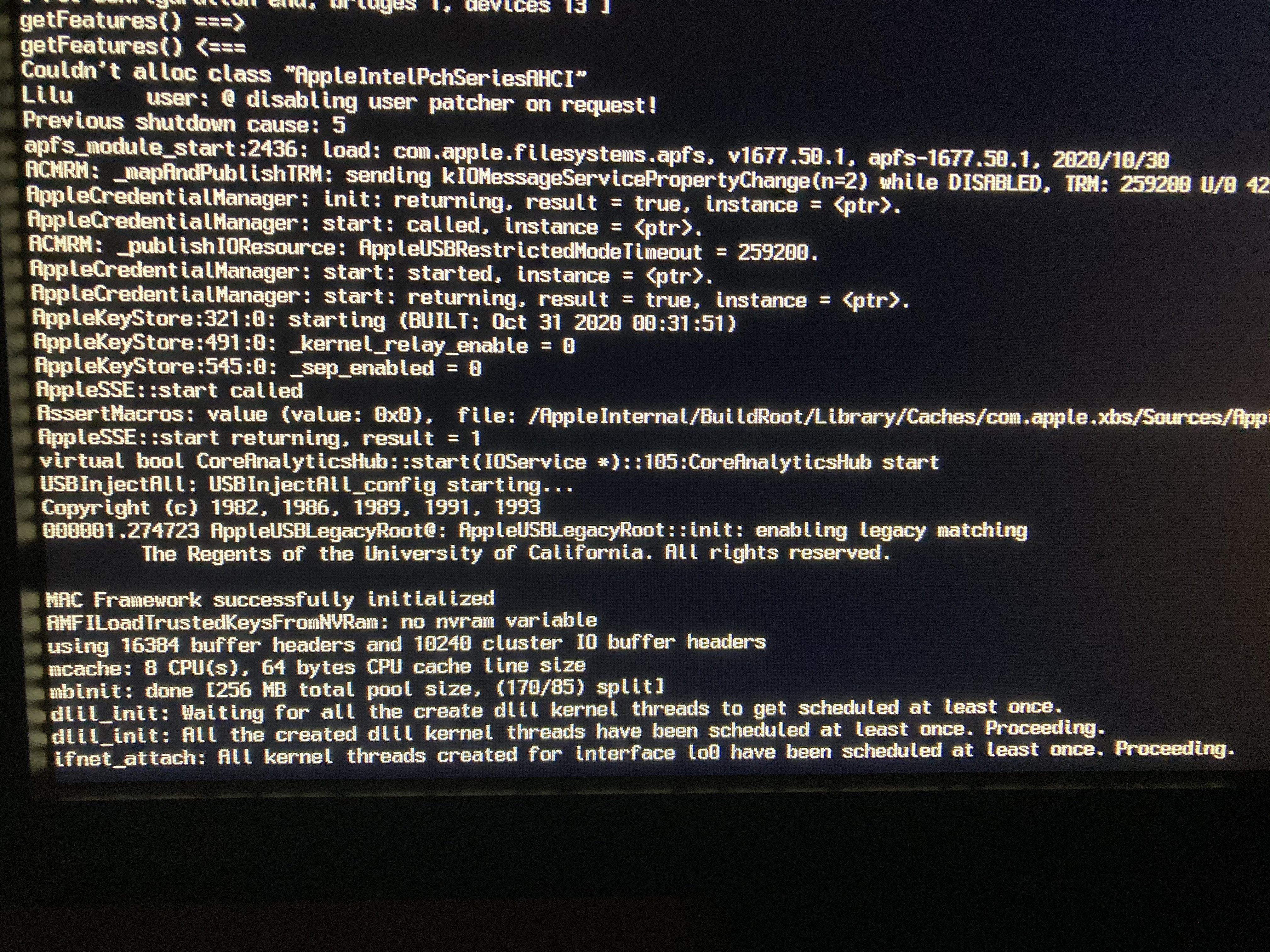

prynhart Posted November 23, 2020 Share Posted November 23, 2020 (edited) Also - when Catalina crashes (in conjunction with HP_800_G1_OC_58), a kernel panic is written into the root of the EFI partition. Interestingly the text is very similar to what was displayed at the BIOS screen (when HP_800_G1_OC063 is used). The traceback is attached. opencore-2020-11-23-074926.txt Edited November 23, 2020 by prynhart Link to comment https://www.insanelymac.com/forum/topic/323180-ventura-monterey-big-sur-catalina-mojave-high-sierra-on-hp-800-g1-usdtsff-and-tower-pcs/page/16/#findComment-2745168 Share on other sites More sharing options...
swanduron Posted November 23, 2020 Share Posted November 23, 2020 @prynhart, could you compare the differences between 'config.plist' files in OC63 and OC58 folder? Link to comment https://www.insanelymac.com/forum/topic/323180-ventura-monterey-big-sur-catalina-mojave-high-sierra-on-hp-800-g1-usdtsff-and-tower-pcs/page/16/#findComment-2745169 Share on other sites More sharing options...
prynhart Posted November 23, 2020 Share Posted November 23, 2020 @swanduron: I have extracted the two config.plist files - they're attached. There's quite a lot of diffs. I found it easiest to compare the changes via: diff -W 150 --side-by-side HP_800_G1_OC_58_EFI_OC_config.plist HP_800_G1_OC063_EFI_OC_config.plist HP_800_G1_OC063_EFI_OC_config.plist HP_800_G1_OC_58_EFI_OC_config.plist Link to comment https://www.insanelymac.com/forum/topic/323180-ventura-monterey-big-sur-catalina-mojave-high-sierra-on-hp-800-g1-usdtsff-and-tower-pcs/page/16/#findComment-2745171 Share on other sites More sharing options...

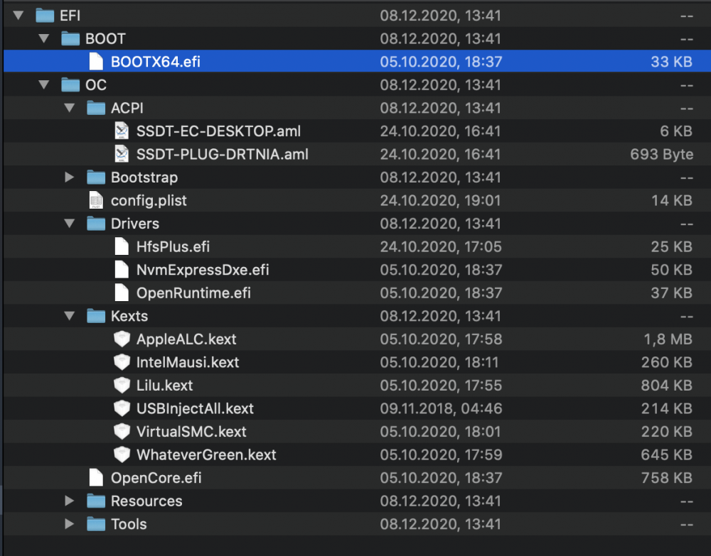

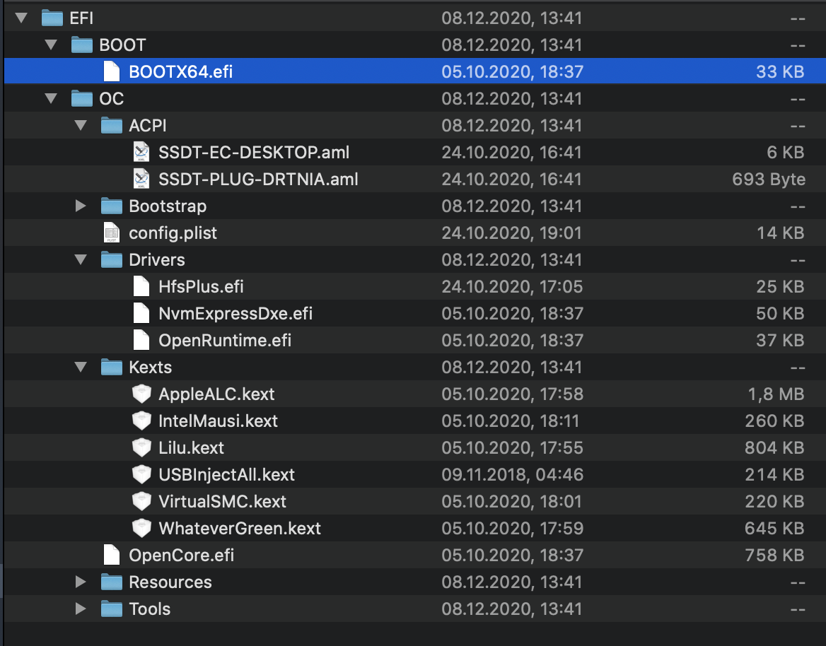

mondial Posted December 9, 2020 Share Posted December 9, 2020 (edited) Hi guys, ladies, proteges & geeks! Still can't get it run, neither CATA nor BSUR ... what I did: 0. BIOS (v 2.33) is set to default bios with bootorder to USB prim 1. created usb by commandline: by createinstallmedia of CATA or BSUR, then 2. mapped EFI by OC configurator and tried several EFIs (Donw35, MrDodi,...) you provide for 800g1 by copying into EFI partition. ==> 2 partitions: hidden EFI (MBR,FAT32) & Install of CATA or BSUR (GUID) do I miss or forget something? thx Mondi Edited December 16, 2020 by mondial Link to comment https://www.insanelymac.com/forum/topic/323180-ventura-monterey-big-sur-catalina-mojave-high-sierra-on-hp-800-g1-usdtsff-and-tower-pcs/page/16/#findComment-2746629 Share on other sites More sharing options...
swanduron Posted December 10, 2020 Share Posted December 10, 2020 14 hours ago, mondial said: Hi guys, ladies, proteges & geeks! Still can't get it run, neither CATA nor BSUR ... what I did: 0. BIOS (v 2.33) is set to default bios with bootorder to USB prim 1. created usb by commandline: by createinstallmedia of CATA or BSUR, then 2. mapped EFI by OC configurator and tried several EFIs (Donw35, MrDodi,...) you provide for 800g1 by copying into EFI partition. ==> 2 partitions: EFI & Install of CATA or BSUR , then 3. do I need the MBR for EFI by bootinstall_x64.tool .... always or not ? ..... now can't even install any version of any do I miss or forget something? thx Mondi Which CLIs do you use to create the USB drive? Link to comment https://www.insanelymac.com/forum/topic/323180-ventura-monterey-big-sur-catalina-mojave-high-sierra-on-hp-800-g1-usdtsff-and-tower-pcs/page/16/#findComment-2746669 Share on other sites More sharing options...
mondial Posted December 10, 2020 Share Posted December 10, 2020 (edited) Hi Swanduron, I use the terminal from osx under catalina or bigsur (both) for the install partition (GUID part To the mounted EFI partition I copied one of your EFI therein. I don't know if I must use native or UEFI ... cause I thought uefi is not supported for hp800g1 bios (v2.33) and I didn't want to experiment with any kexts, drivers and acpi modifications yet, just tried all your provided EFIs ... thx Mondi Edited December 10, 2020 by mondial Link to comment https://www.insanelymac.com/forum/topic/323180-ventura-monterey-big-sur-catalina-mojave-high-sierra-on-hp-800-g1-usdtsff-and-tower-pcs/page/16/#findComment-2746686 Share on other sites More sharing options...
Donw35 Posted December 10, 2020 Author Share Posted December 10, 2020 I am not sure what the issue is here. lets start with how I did it downloaded Big Sur from App Store. created a USB installer using the command below sudo /Applications/Install\ macOS\ Big\ Sur.app/Contents/Resources/createinstallmedia --volume /Volumes/MyVolume using the EFI_HP_800_G1.zip file above, mount the EFI partition on the USB stick and place the EFI folder into the EFI partition on the USB Reboot the HP G1 and hit F9 to select the USB boot device and it should boot into the installer Make sure to format the target drive using the Disk Utilities from the installer menu once done, install Big Sur onto the target drive, make sure to hit F9 between reboots to continue installation this worked for me 1 Link to comment https://www.insanelymac.com/forum/topic/323180-ventura-monterey-big-sur-catalina-mojave-high-sierra-on-hp-800-g1-usdtsff-and-tower-pcs/page/16/#findComment-2746701 Share on other sites More sharing options...
mondial Posted December 10, 2020 Share Posted December 10, 2020 (edited) 53 minutes ago, Donw35 said: I am not sure what the issue is here. lets start with how I did it downloaded Big Sur from App Store. created a USB installer using the command below sudo /Applications/Install\ macOS\ Big\ Sur.app/Contents/Resources/createinstallmedia --volume /Volumes/MyVolume using the EFI_HP_800_G1.zip file above, mount the EFI partition on the USB stick and place the EFI folder into the EFI partition on the USB Reboot the HP G1 and hit F9 to select the USB boot device and it should boot into the installer Make sure to format the target drive using the Disk Utilities from the installer menu once done, install Big Sur onto the target drive, make sure to hit F9 between reboots to continue installation this worked for me Did it the same ... several times. But good to know, that your description works ... will change my HDD cause an EFI selection always refers to the cloverpartition of the HDD and the new Install over OC doesn't work... maybe the BIOS settings are also not ok. another try ... stay tuned :-) & thx Mondi Edited December 10, 2020 by mondial Link to comment https://www.insanelymac.com/forum/topic/323180-ventura-monterey-big-sur-catalina-mojave-high-sierra-on-hp-800-g1-usdtsff-and-tower-pcs/page/16/#findComment-2746705 Share on other sites More sharing options...
mondial Posted December 14, 2020 Share Posted December 14, 2020 (edited) Now at boot the process hangs at: see attach my EFI partition (MS-DOS, FAT32 formatted) : see other attachment network if ? any idea? Edited December 14, 2020 by mondial Link to comment https://www.insanelymac.com/forum/topic/323180-ventura-monterey-big-sur-catalina-mojave-high-sierra-on-hp-800-g1-usdtsff-and-tower-pcs/page/16/#findComment-2747032 Share on other sites More sharing options...
mondial Posted December 14, 2020 Share Posted December 14, 2020 now success! ... took a new EFI config (I think it was that one: BigSur Beta5 + OC63) and now I could install to HDD Link to comment https://www.insanelymac.com/forum/topic/323180-ventura-monterey-big-sur-catalina-mojave-high-sierra-on-hp-800-g1-usdtsff-and-tower-pcs/page/16/#findComment-2747070 Share on other sites More sharing options...
