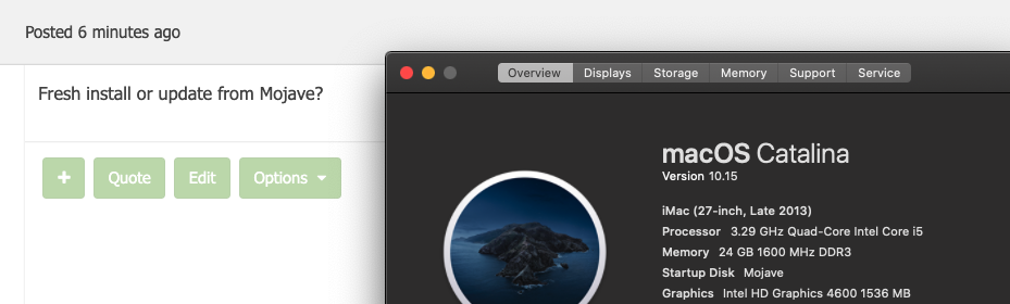

I updated my 800 G1 USDT to OSX 10.15 Catalina yesterday - the upgrade itself went fine and afterwards I updated the various kexts to the latest versions.  My wireless card however is no longer working - it is an AzureWave AW-CE123H which is a Broadcom BCM94352HMB.  I had it working on Mojave by running the installer from here:
https://www.insanelymac.com/forum/files/file/844-azurewave-aw-ce123h/
After updating to Catalina the wireless seemed to work intermittently and the boot took a lot longer than usual and my PC kept locking up or restarting so I removed the various kexts it installed.  So my install now boots fine but of course no wireless - currently using the Intel Ethernet which works.  Is there any way to get this wireless card working in Catalina?  One of the problems was the installer tries to put the kexts in S/L/E which is now read-only in Catalina - I did try installing them in L/E but the card doesn't seem to be recognised.
I also have the problem with the USB3 ports not working - the two at the front don't work and only one of the rear USB3 ports works.  I have the USBInjectAll.kext installed - should I try the USBMap.kext linked to above?
UPDATE: I used the Hackintool program and mapped all of the USB2 and USB3 ports - I then exported the USBPorts.kext and SSDT-EC.aml files - all of my USB2 and USB3 ports are now working.
UPDATE2: Now got the wifi and BT working - installed the latest AirportBrcmFixup.kext for the wifi and found a Catalina version of BrcmPatchRAM3-V2.3.0d2.zip which seems to work as well.

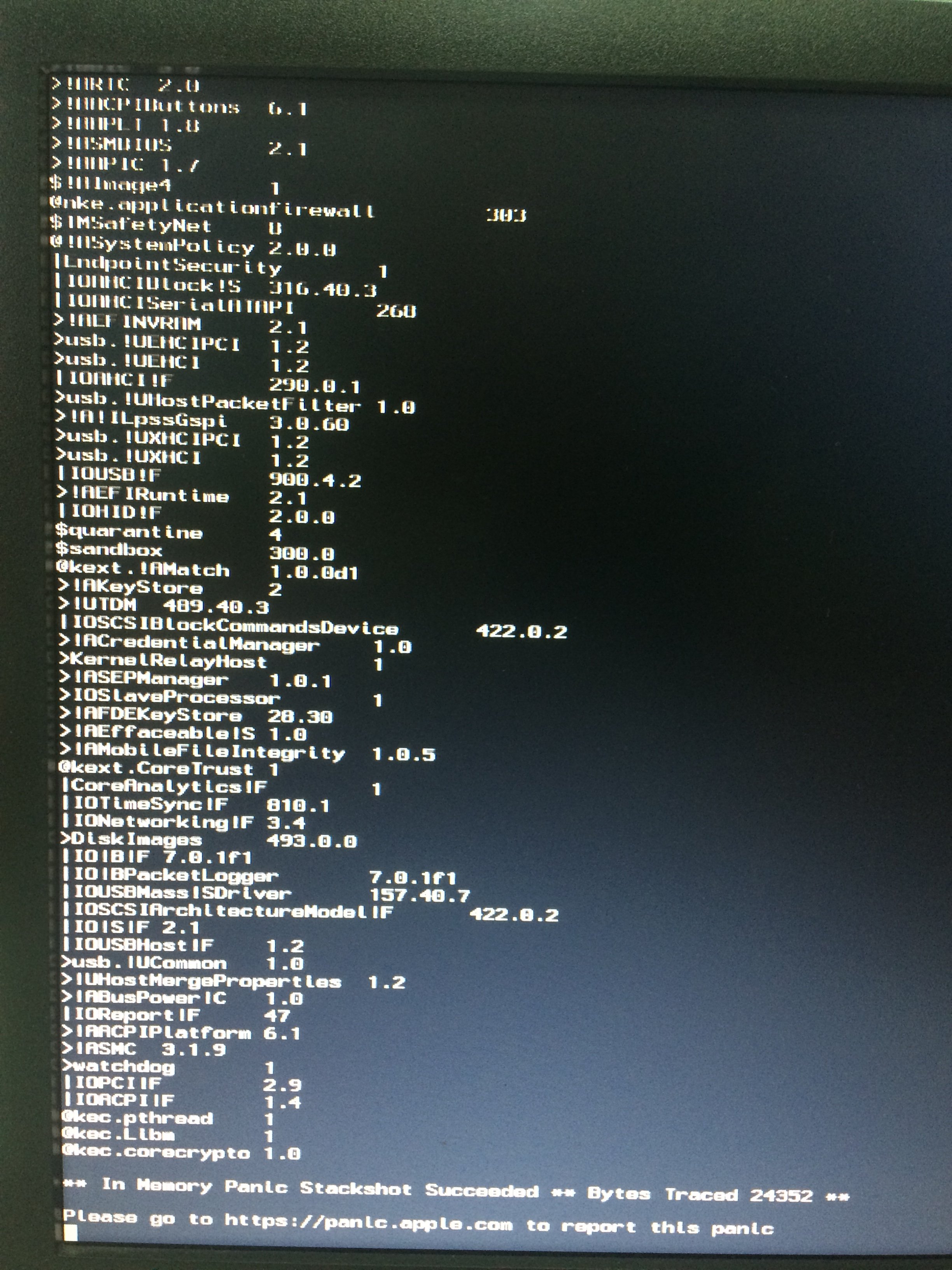

so the USDT is working but the SFF is not, interesting. are we sure its not hardware causing the rebooting. most rebooting problems are caused by GFX issues or memory, are you using display port ?

hi guys, does any one experience unexpected freeze while using catalina? i also have some wired experience with intel fix graphic. after each reboot/boot the display port which is connected doesn't work properly and i should change the port to work it with out graphic bug. any one can help me?
