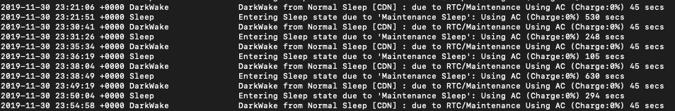

unfortunately no change with the slimmed down driver folder or removal of sensor kexts. Just switched to VirtualSMC to see if that makes any difference.. will report back. Its such a tedious process as it always sleeps fine the first night to start doing the same tonne of darkwakes on the 2nd night

VirtualSMC no different here either. Also unplugged optical drives and wifi card just in case- Same result - goes all night to from 22:47 - 6:56am every few minutes.

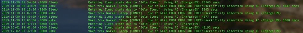

Extract from my brand new install onto new Hdd attached - no wakes overnight and the couple in the day was me touching keyboard. Will see again tonight if it stays asleep.

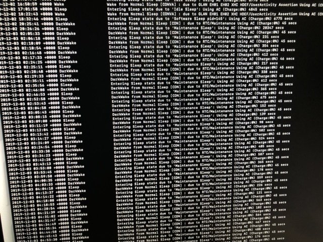

Unfortunately the clean install is doing the same again . 1st night fine then second night turns into an insomniMac ! May try the voodooHDA Kext next else just switch back to Mojave .. don’t like admitting defeat though.

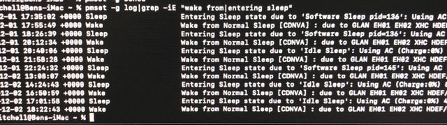

I've just been playing with the log and using
pmset -g log|grep -e " Sleep " -e " Wake " -e " DarkWake "
reveals a bit more info.

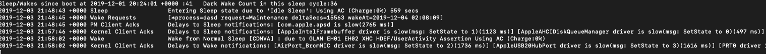

A bit of googling found this https://www.tonymacx86.com/threads/catalina-odd-wake-behavior.286554/ and https://discussions.apple.com/thread/250859699 which is the exact same issue.
[*process=dasd request=Maintenance ... seems to be the issue
- no resolution yet but restarting everyday seems to stop it occurring. I'm thinking this is a Catalina bug rather than EFI problem.
