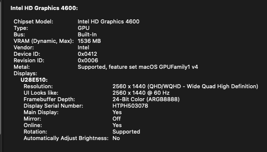

Donw35 Posted April 8, 2020 Author Share Posted April 8, 2020 (edited) So I did some quick testing, I connected my machine to a 4k Monitor and was able to get 2560X1440x60hz in OS X and 4k in Windows 10. Be sure you are using a quality DP cable, cheap ones or adapters can cause issues with OS X including crashing. Actually I was able to get 4k and bump the ram to 2gb. I think you have either a bad cable or bad RAM Edited April 8, 2020 by Donw35 Link to comment https://www.insanelymac.com/forum/topic/323180-ventura-monterey-big-sur-catalina-mojave-high-sierra-on-hp-800-g1-usdtsff-and-tower-pcs/page/13/#findComment-2716060 Share on other sites More sharing options...

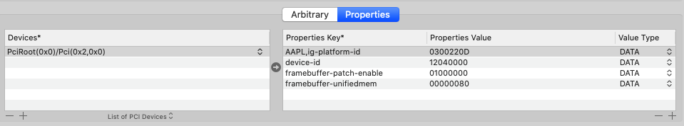

Pluskat5000Schiffe Posted April 8, 2020 Share Posted April 8, 2020 (edited) I have interesting information .... Revert back latest LILU +WEG and I had to do this: Add PciRoot entry for iGP, platform was ig-platform-id=0x0d220003 byte swapped 0300220d and device ID was device-id 12040000 byte swapped 00000412 Now I have install GUI installing Catalina right now. Installed and Gui is working... I do however only have 14MB VRAM config kopie.plist Edited April 8, 2020 by Pluskat5000Schiffe Link to comment https://www.insanelymac.com/forum/topic/323180-ventura-monterey-big-sur-catalina-mojave-high-sierra-on-hp-800-g1-usdtsff-and-tower-pcs/page/13/#findComment-2716258 Share on other sites More sharing options...

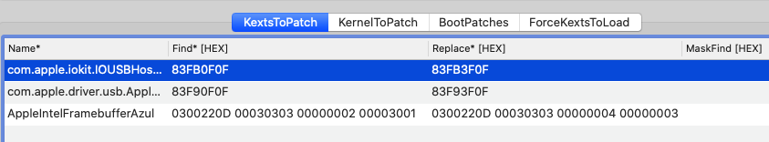

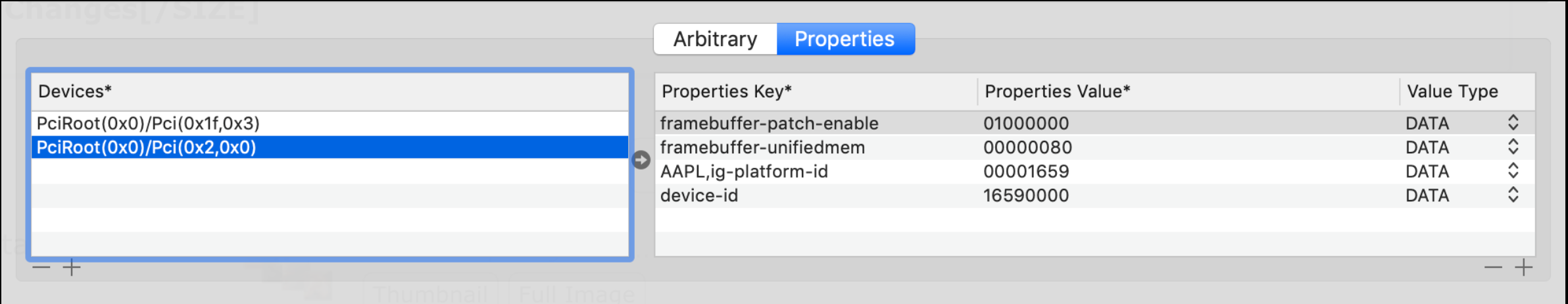

Donw35 Posted April 9, 2020 Author Share Posted April 9, 2020 (edited) Here is how I did it, 2GB ram and 4k support Kernel and Kext patches Name: AppleIntelFramebufferAzul Find: 0300220D 00030303 00000002 00003001 replace: 0300220D 00030303 00000004 00000003 Devices - Properties Devices PciRoot(0x0)/Pci(0x2,0x0) Properties Key Properties Value AAPL,ig-platform-id 0300220D device-id 12040000 framebuffer-patch-enable 01000000 framebuffer-unifiedmem 00000080 Edited April 9, 2020 by Donw35 added info Link to comment https://www.insanelymac.com/forum/topic/323180-ventura-monterey-big-sur-catalina-mojave-high-sierra-on-hp-800-g1-usdtsff-and-tower-pcs/page/13/#findComment-2716267 Share on other sites More sharing options...
Pluskat5000Schiffe Posted April 9, 2020 Share Posted April 9, 2020 thx man I will try tomorrow ... again a 03:00 at night ... I still think I have DVMT issue. 32MB wont work anymore. Due a circumstance I have only 32MB and you have probably more... Link to comment https://www.insanelymac.com/forum/topic/323180-ventura-monterey-big-sur-catalina-mojave-high-sierra-on-hp-800-g1-usdtsff-and-tower-pcs/page/13/#findComment-2716272 Share on other sites More sharing options...

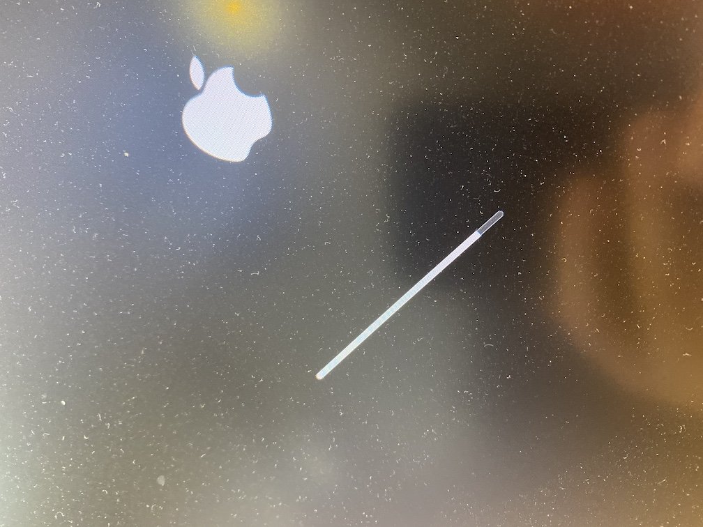

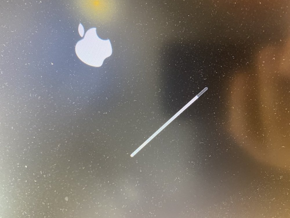

Pluskat5000Schiffe Posted April 9, 2020 Share Posted April 9, 2020 I tried it. With these settings it won't load the 2nd apple graphic or 2nd boot phase. Can you verify my Bios settings to prevent I did something wrong here? BIOS screens.zip Link to comment https://www.insanelymac.com/forum/topic/323180-ventura-monterey-big-sur-catalina-mojave-high-sierra-on-hp-800-g1-usdtsff-and-tower-pcs/page/13/#findComment-2716309 Share on other sites More sharing options...
