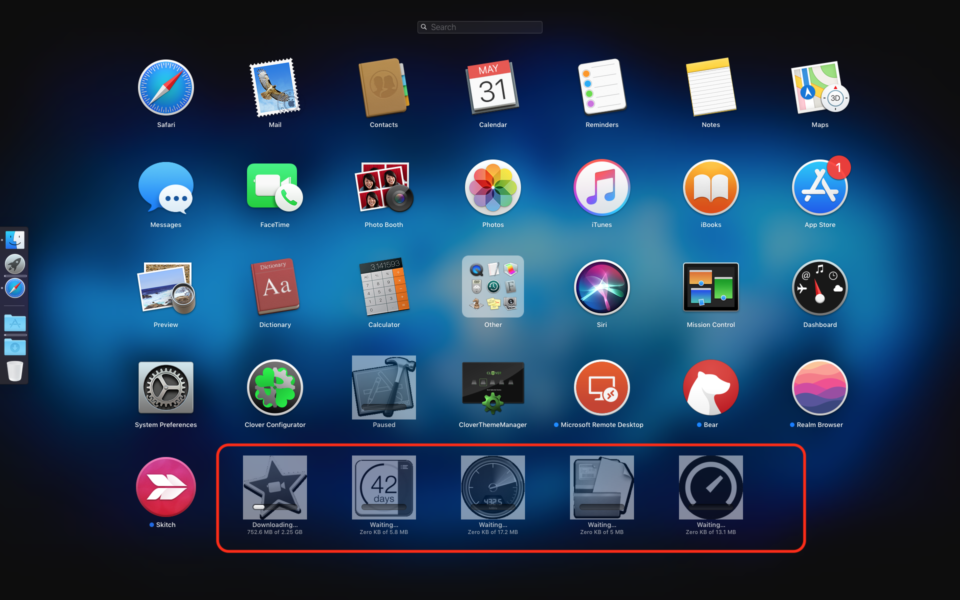

PS: See below picture, I think this is a problem, any idea?. Because in real Mac, when downloading anything, icon transparent with background.
thanks,
Edited by phucnguyen.2411
37 minutes ago, phucnguyen.2411 said:
Yeah, injector already install by kext of Rehabman. But I don't have any idea. Bluetooth icon already appear in status bar.
PCI 1x, in Bios very simple, don't have any option to turn off or something else.
When I sleep, full usb device turn off and can't press any key or mouse to wake machine.
thanks,
use power button for wake

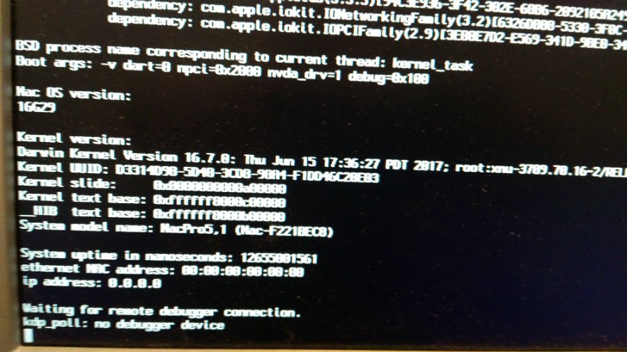

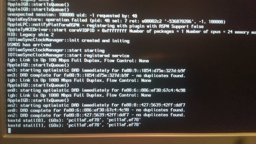

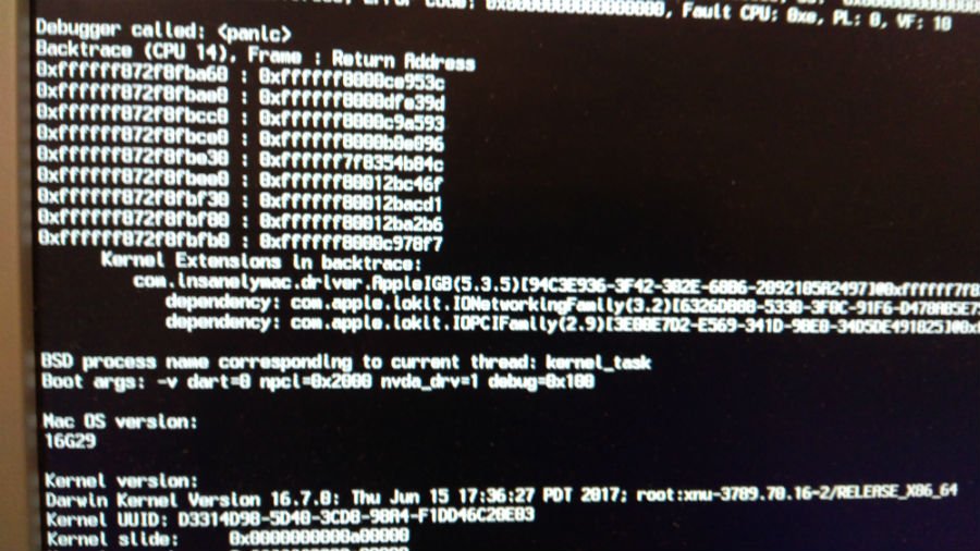

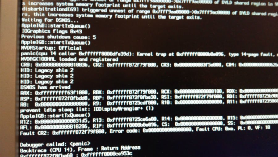

I installed Sierra 12.6 on Supermicro x9dr3-ln4f + to work with sound on Avid Pro Tools with HDX card. However, after installing the Avid HD Driver for HDX card, the system sometimes kernel panic or stop here:  busy timeout[0], (60c), kext wait(0): 'pci11af,ef70'
May be You can help me.
Send me mix1.cpig.ru.zip
6 hours ago, Shiposha said:
Hello,
CLOVER.zip
7 hours ago, Shiposha said:
Thank you very much! But I can't boot now with this panic:imageproxy.php?img=&key=c17464ef1b1b51c7panic1.jpg.f658d37b99191b1dd7484e53dc0e68f3.jpgpanic2.jpg.71fe0e6c27a824e943a9a06beac5e3e7.jpgpanic3.jpg.331b60790194d90acdd86439aa3682b4.jpg
press barspace in clover boot screen and block kexts, block AppleIGB, use ur old version of this kext
