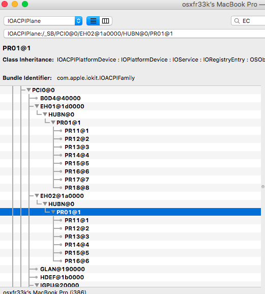

On 5/24/2018 at 4:31 PM, oSxFr33k said:
Unfortunately it did not help, My EH01 ports are not working and if you look over the Ioreg EH01 is missing.  What other reasons could there be besides what I mentioned about the ACPI breaking because of the EC registers over 8 bits.   I am still working on modifying an existing battery patch to fully patch my EC register, that is the only other thing I can think of, it seems that clover ACPI fixes are enough for the DSDT and of course the battery and PNOT patch otherwise I prefer hot-patches (SSDT) and clover ACPI fixes as well as Kernel and Kext patching in clover config.
Edited 5-27-2018
I finally made the battery patch for the DSDT and I still have no ports for EH01.  Either a USB injector is needed or USBInjectall and SSDT needed for this USB and that doesn't help either.  Something happening in CLover causing this.
try without rename EC, create a one device EC and EC0 stay untouched

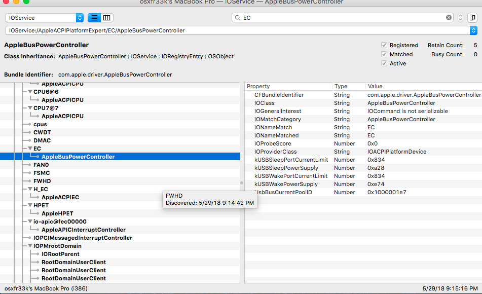

20 minutes ago, oSxFr33k said:
I can try that but I have H_EC not EC0.  I used clover to rename H_EC to EC.  But I will remove that from clover to see if it brings back EH01 ports.   My battery will stop working because DSDT has H_EC everywhere and battery patch references to H_EC.  Are you saying use a hot patch SSDT-EC.aml instead of rename in clover?
Yes
u can create one device, Just need a simple EC device and AppleBusPowerController is load, into device name_adr 0x001F0000 without rename H_EC to EC
  • Like 3

26 minutes ago, oSxFr33k said:
Isn't 0x001F0000 Device (LPCB)?  Anyhow I inserted FAKE EC with SSDT-EC.aml and now AppleBusPower with EC and H_EC with AppleACPIEC and is that how it should be?  See screenshot.
2 USB ports still not working but I am confused why is EH01/EH02 sharing same HUB/Ports names?  See screenshot.
oh
u try rename? serie 6/7 dont have any SSDT dependencies, just rename in DSDT and drop all OEM
  • Like 3
