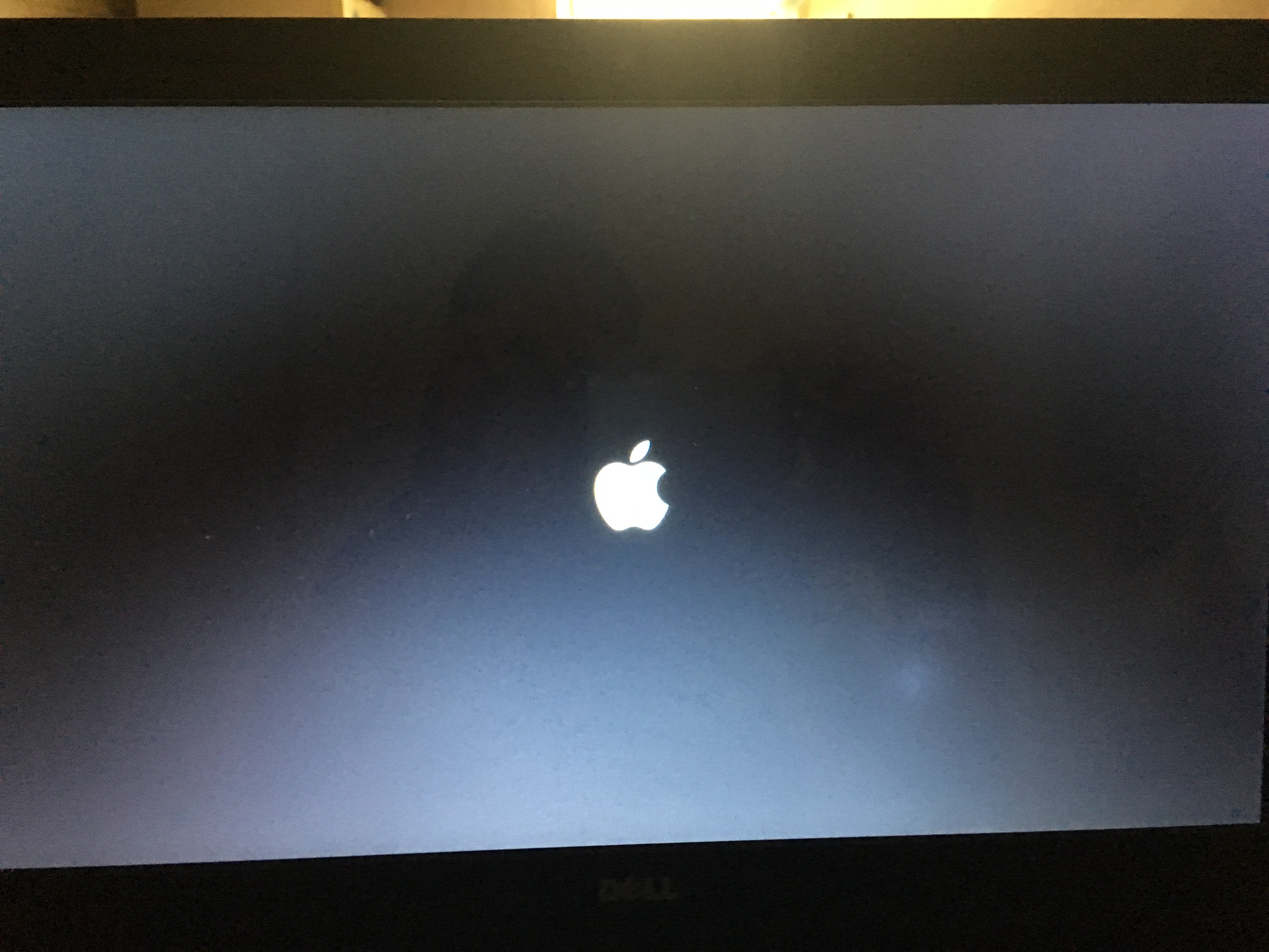

matgeo Posted June 18, 2018 Share Posted June 18, 2018 1 hour ago, MaLd0n said: post one photo It justs stays here , without any progress indicator. Link to comment https://www.insanelymac.com/forum/topic/323052-guide-el-capitan-sierra-high-sierra-mojave-catalina-on-intel-5-6-7-8-9-chipset-series-nehalem-sandybridge-ivybridge-haswell-broadwell/page/70/#findComment-2620473 Share on other sites More sharing options...

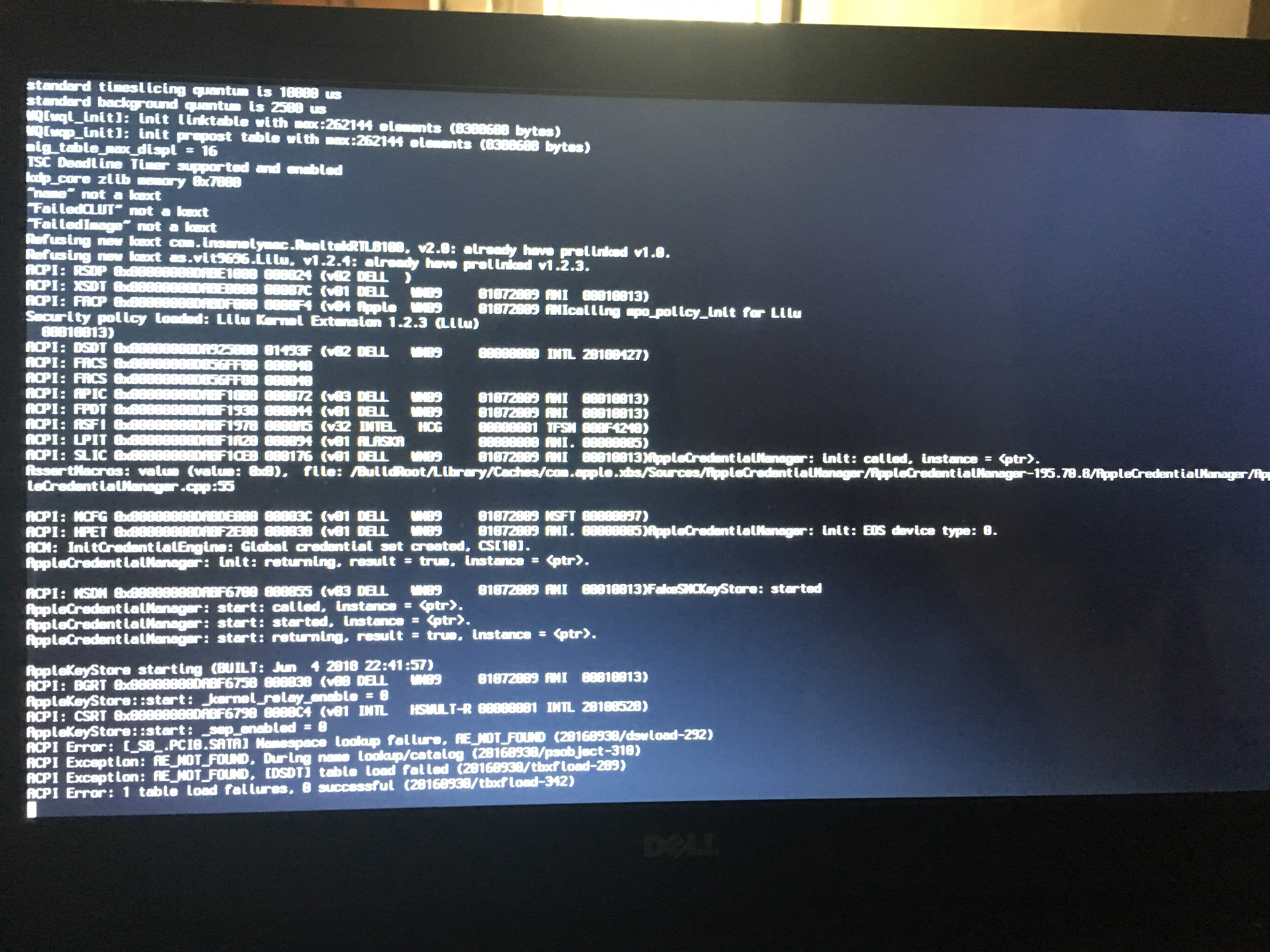

MaLd0n Posted June 18, 2018 Author Share Posted June 18, 2018 use -v Link to comment https://www.insanelymac.com/forum/topic/323052-guide-el-capitan-sierra-high-sierra-mojave-catalina-on-intel-5-6-7-8-9-chipset-series-nehalem-sandybridge-ivybridge-haswell-broadwell/page/70/#findComment-2620474 Share on other sites More sharing options...

matgeo Posted June 18, 2018 Share Posted June 18, 2018 11 hours ago, MaLd0n said: use -v Should i try anything else ? Link to comment https://www.insanelymac.com/forum/topic/323052-guide-el-capitan-sierra-high-sierra-mojave-catalina-on-intel-5-6-7-8-9-chipset-series-nehalem-sandybridge-ivybridge-haswell-broadwell/page/70/#findComment-2620664 Share on other sites More sharing options...

matgeo Posted June 20, 2018 Share Posted June 20, 2018 (edited) 30 minutes ago, MaLd0n said: i think u use some, same klext in 2 foldersat same time, i see many refusing kexts, use a clean install and start again I tried with clean install , but doesn't work. Installer doesn't boot at all. Stays at apple logo as the photo. We are so close. The first clover you sent me worked. The second not at all. It just needs your magic touch. Edited June 20, 2018 by matgeo Link to comment https://www.insanelymac.com/forum/topic/323052-guide-el-capitan-sierra-high-sierra-mojave-catalina-on-intel-5-6-7-8-9-chipset-series-nehalem-sandybridge-ivybridge-haswell-broadwell/page/70/#findComment-2621320 Share on other sites More sharing options...
MaLd0n Posted June 20, 2018 Author Share Posted June 20, 2018 23 minutes ago, matgeo said: I tried with clean install , but doesn't work. Installer doesn't boot at all. Stays at apple logo as the photo. We are so close. The first clover you sent me worked. The second not at all. It just needs your magic touch. use first clover folder, bow i don't have some time for long edits, some works here Link to comment https://www.insanelymac.com/forum/topic/323052-guide-el-capitan-sierra-high-sierra-mojave-catalina-on-intel-5-6-7-8-9-chipset-series-nehalem-sandybridge-ivybridge-haswell-broadwell/page/70/#findComment-2621329 Share on other sites More sharing options...

matgeo Posted June 21, 2018 Share Posted June 21, 2018 18 hours ago, MaLd0n said: use first clover folder, bow i don't have some time for long edits, some works here Ok , @MaLd0n. I tried again the clover you send me and i added those lines : change EHC1 to EH01 change EHC2 to EH02 change GFX0 to IGPU change HECI to IMEI change SAT0 to SATA and it worked !!! Here is my new dumb : https://mega.nz/#!iN42yQBC!cA4QVy-sVh5brurE98Kum0X0c3rcgIxNI6rwOiWS-Tc (for some reason i cannot attach anything) Link to comment https://www.insanelymac.com/forum/topic/323052-guide-el-capitan-sierra-high-sierra-mojave-catalina-on-intel-5-6-7-8-9-chipset-series-nehalem-sandybridge-ivybridge-haswell-broadwell/page/70/#findComment-2621486 Share on other sites More sharing options...
MaLd0n Posted June 21, 2018 Author Share Posted June 21, 2018 1 hour ago, matgeo said: Ok , @MaLd0n. I tried again the clover you send me and i added those lines : change EHC1 to EH01 change EHC2 to EH02 change GFX0 to IGPU change HECI to IMEI change SAT0 to SATA and it worked !!! Here is my new dumb : https://mega.nz/#!iN42yQBC!cA4QVy-sVh5brurE98Kum0X0c3rcgIxNI6rwOiWS-Tc (for some reason i cannot attach anything) u need ever thsi patches, if we rename devices in dsdt, need rename in ssdt too, have many dependencies enjoy Link to comment https://www.insanelymac.com/forum/topic/323052-guide-el-capitan-sierra-high-sierra-mojave-catalina-on-intel-5-6-7-8-9-chipset-series-nehalem-sandybridge-ivybridge-haswell-broadwell/page/70/#findComment-2621497 Share on other sites More sharing options...
