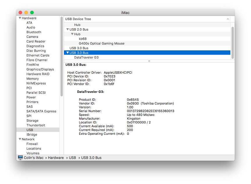

On 4/26/2018 at 8:20 PM, nylock10 said:
Got an install working on an ASRock Z68 Extreme4 Gen3 with an i5 2500K. Generated my own config.plist and used kexts specific for my system. Here's everything if you don't mind looking at it. Thanks.
send me new files after reboot, test all usb ports with device usb3
CLOVER.zip

All USB 2.0 ports work. However, nothing connected to the USB 3.0 ports work. System Report recognizes when something is plugged but nothing mounts (see attachment).
37 minutes ago, nylock10 said:
Thank you! Here are newly generated files after adding your changes and patched DSDT.
ur usb3.x is not Intel, u need check if have support
