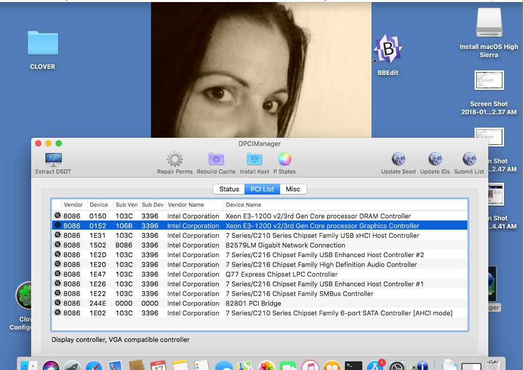

use DPCI Manager and take a Screenshot in PCI List
DPCIManager.app.zip

OK, I've generated the SSDT and after replacing my Clover directory put it into the appropriate spot.  Upon reboot I get hung at IOConsole.  This is what my initial USB did until I happened upon changing my ig-platform-id to the unheard of 0x01660005.  With that, I can boot but have 1024x768 res.  I tried putting this back to the same value on boot and a few other ids but no dice.  I gave up and booted from my usb, set the id to 0x01660005 and took the screenshot as requested.  Thank you for your help!

patch hd 2500 removed, i think this GPU dont work full enable in HS
