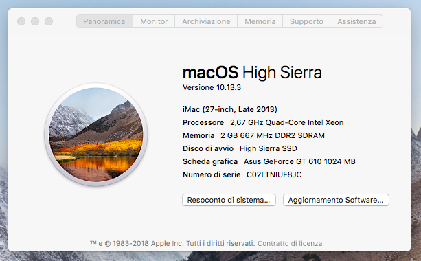

hershebmx Posted January 26, 2018 Share Posted January 26, 2018 Hi everyone, sorry for my English, finally the geforce GT 610 works with High Sierra, the attached kexts apply the fixes at shutdown, restart, and mouse pointer. Unfortunately, there are still problems, the system crashes if you set non-standard resolutions, if you turn on the screen saver and log out. Tested with Asus GT610, High Sierra 17A360a, Clover 4189 and smbios iMac14.2. Copy kext to System / Library / Extensions. Scatto.jpg Hello m1g2, can you help me with the settings that you used to make the graphics card work? I downloaded your kext, but nothing happened. My specification: Core i7 3.99 Ghtz Motherboard: Gigabyte GA-H61M-S1 RAM memory: 12 GB Graphic card: EVGA Geforce GT 610 2 GB Please, thank you very much Link to comment https://www.insanelymac.com/forum/topic/326924-geforce-gt610-works-in-high-sierra/#findComment-2577284 Share on other sites More sharing options...
m1g2 Posted January 27, 2018 Author Share Posted January 27, 2018 Hello, I can confirm that it works with High Sierra 10.13.3, use clover 4392,enable in clover Inject nvidia true, use smbios imac 14.2 and install the attached kext,I also attach my clover config.plist if you want to try it config.plist.zip NVDAResman.kext.zip 4 1 Link to comment https://www.insanelymac.com/forum/topic/326924-geforce-gt610-works-in-high-sierra/#findComment-2578081 Share on other sites More sharing options...

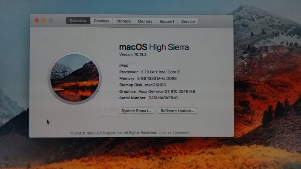

Insanelymacnong Posted December 21, 2018 Share Posted December 21, 2018 (edited) On 1/27/2018 at 9:28 PM, m1g2 said: Hello, I can confirm that it works with High Sierra 10.13.3, use clover 4392, enable in clover Inject nvidia true, use smbios imac 14.2 and install the attached kext, I also attach my clover config.plist if you want to try it config.plist.zip NVDAResman.kext.zip Thanks m1g2 for the workaround. I use the NVDAResman.kext and it works in High Sierra 10.13.3 with my Asus GT610 2GB silent version gfx. I use Clover r4428, InjectNVidia & SMBios iMac 14,2 in clover setting. I noticed a few problem same as above with addition; 1. Cannot change standard resolution (Freeze) 2. Cannot restart (Freeze/stuck at black screen) 3. Wake up from turned off display & sleep. (Freeze) My hackintosh build: 1. ASRock H61M-VS R2.0 2. 6GB 1333MHz DDR3 RAM 3. ASUS nVidia GT610 2GB Silent 4. 250GB HDD Edited December 21, 2018 by Insanelymacnong Link to comment https://www.insanelymac.com/forum/topic/326924-geforce-gt610-works-in-high-sierra/#findComment-2654902 Share on other sites More sharing options...
