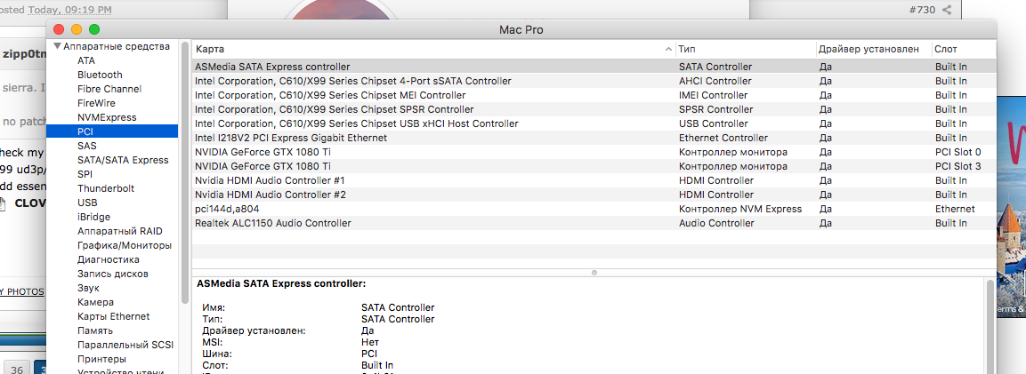

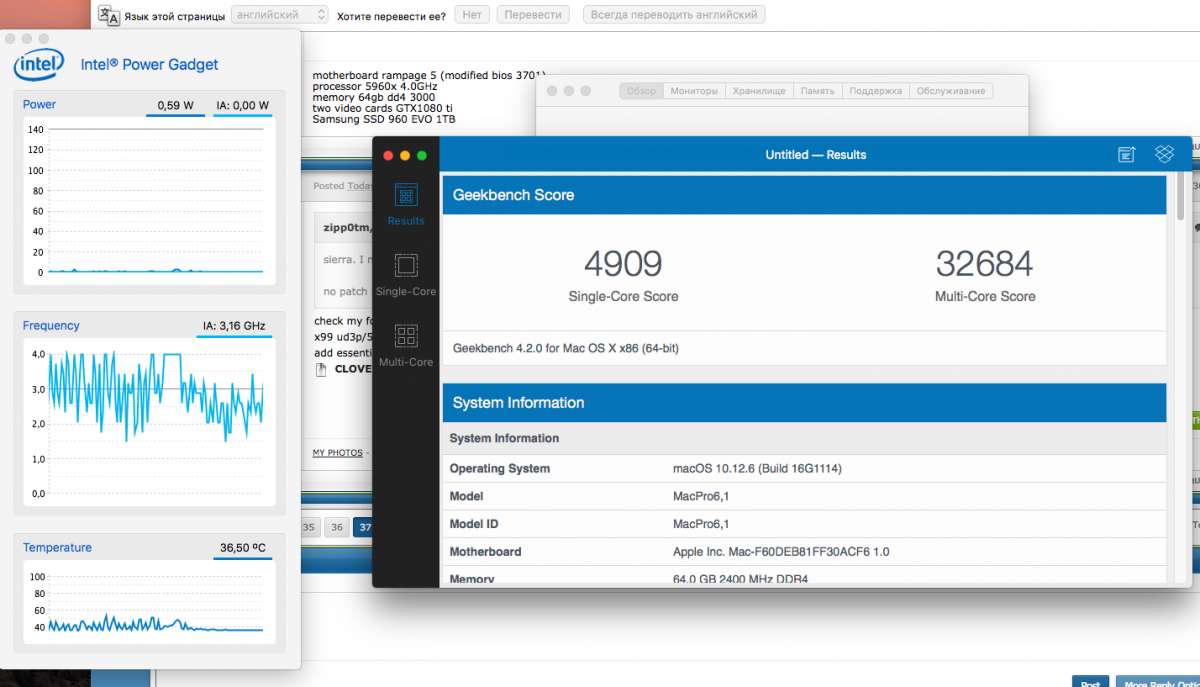

zipp0tm Posted January 2, 2018 Share Posted January 2, 2018 check my folder to sierra/high sierra x99 ud3p/5820k add essentials things for ur processor, i think is a fakecpuid CLOVER.zip x99 ud3p / 5820k the clover does not work It was possible to get on the first variant. Added by KernelToPatch . Here is the result only trouble((Samsung 1 TB EVO 960 M.2 SSD external became The NVMe patch causes kernel panic and still can not update to 10,13,2 1 Link to comment https://www.insanelymac.com/forum/topic/323052-guide-el-capitan-sierra-high-sierra-mojave-catalina-on-intel-5-6-7-8-9-chipset-series-nehalem-sandybridge-ivybridge-haswell-broadwell/page/30/#findComment-2560471 Share on other sites More sharing options...
MaLd0n Posted January 2, 2018 Author Share Posted January 2, 2018 u need go to sierra, Native NVME support, same folder work for sierra and high sierra, dont update, use fresh install in other hdd/sdd for test dont forget remove/disable nvme patch Link to comment https://www.insanelymac.com/forum/topic/323052-guide-el-capitan-sierra-high-sierra-mojave-catalina-on-intel-5-6-7-8-9-chipset-series-nehalem-sandybridge-ivybridge-haswell-broadwell/page/30/#findComment-2560502 Share on other sites More sharing options...

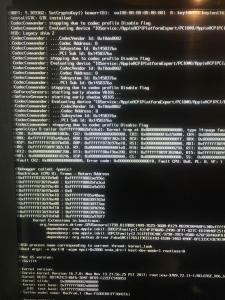

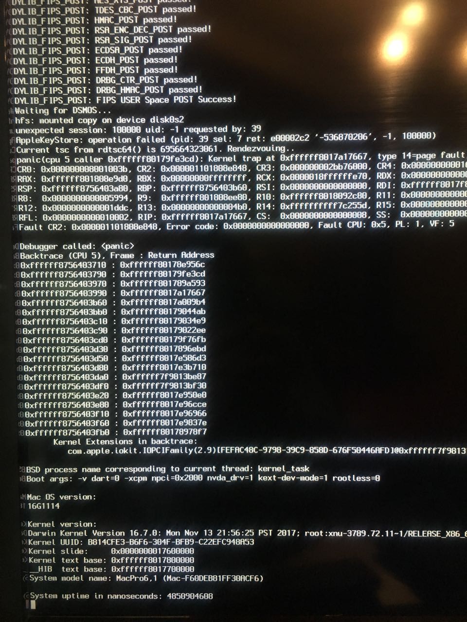

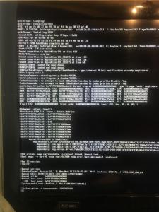

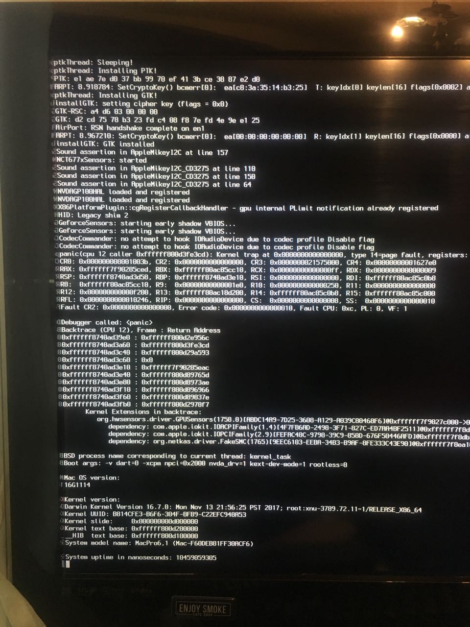

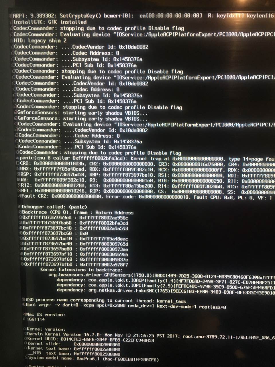

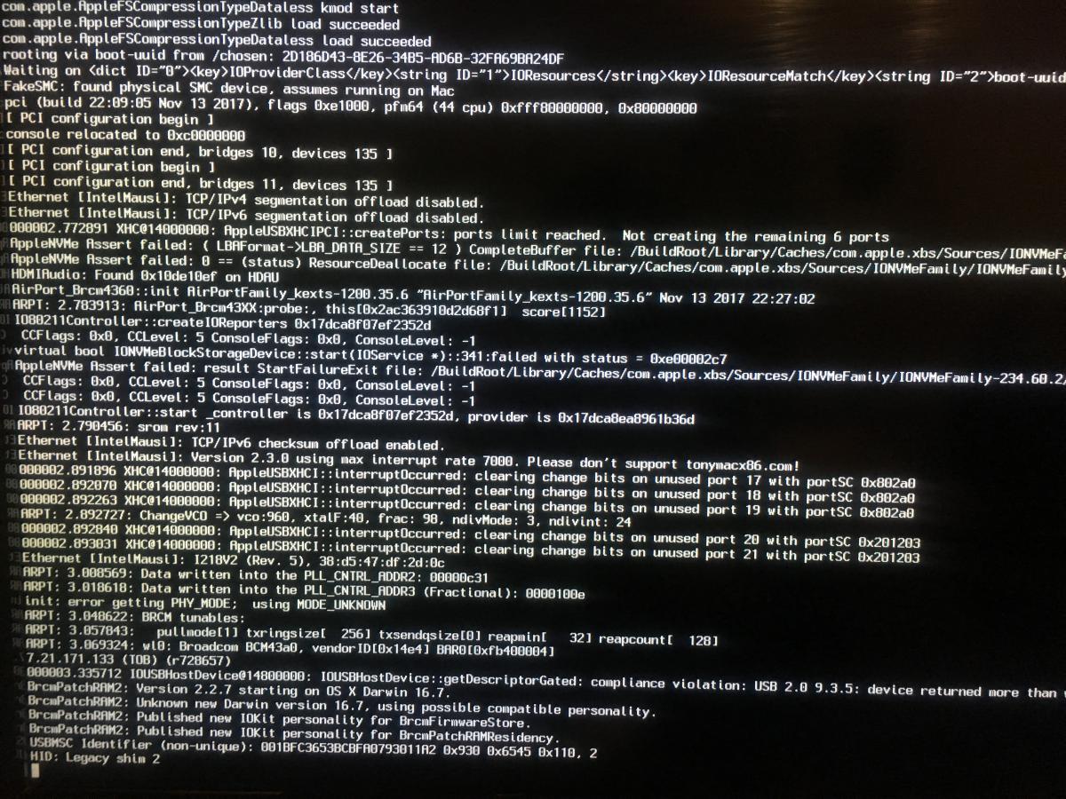

zipp0tm Posted January 3, 2018 Share Posted January 3, 2018 u need go to sierra, Native This support, same folder work for sierra and high sierra, dont update, use fresh install in other hdd/sdd for test dont forget remove/disable nvme patch Good morning. Yesterday the computer was loaded and it was all good , nvme internal. This morning it does not load. It produces such errors. I'm desperate Link to comment https://www.insanelymac.com/forum/topic/323052-guide-el-capitan-sierra-high-sierra-mojave-catalina-on-intel-5-6-7-8-9-chipset-series-nehalem-sandybridge-ivybridge-haswell-broadwell/page/30/#findComment-2560729 Share on other sites More sharing options...
MaLd0n Posted January 3, 2018 Author Share Posted January 3, 2018 Good morning. Yesterday the computer was loaded and it was all good , nvme internal. This morning it does not load. It produces such errors. I'm desperate Avoid use FakeSmc Sensors, in many cases cause problem, ur problem is GPU sensors Link to comment https://www.insanelymac.com/forum/topic/323052-guide-el-capitan-sierra-high-sierra-mojave-catalina-on-intel-5-6-7-8-9-chipset-series-nehalem-sandybridge-ivybridge-haswell-broadwell/page/30/#findComment-2560765 Share on other sites More sharing options...
zipp0tm Posted January 3, 2018 Share Posted January 3, 2018 Avoid use FakeSmc Sensors, in many cases cause problem, ur problem is GPU sensors removed Fake Sensors all and hwmonitor now this is a mistake HWSensors.6.26.1440 - loading problem resolved Please tell me about which patch 2gpu. How to make it? Thank you in advance 1 Link to comment https://www.insanelymac.com/forum/topic/323052-guide-el-capitan-sierra-high-sierra-mojave-catalina-on-intel-5-6-7-8-9-chipset-series-nehalem-sandybridge-ivybridge-haswell-broadwell/page/30/#findComment-2560778 Share on other sites More sharing options...
